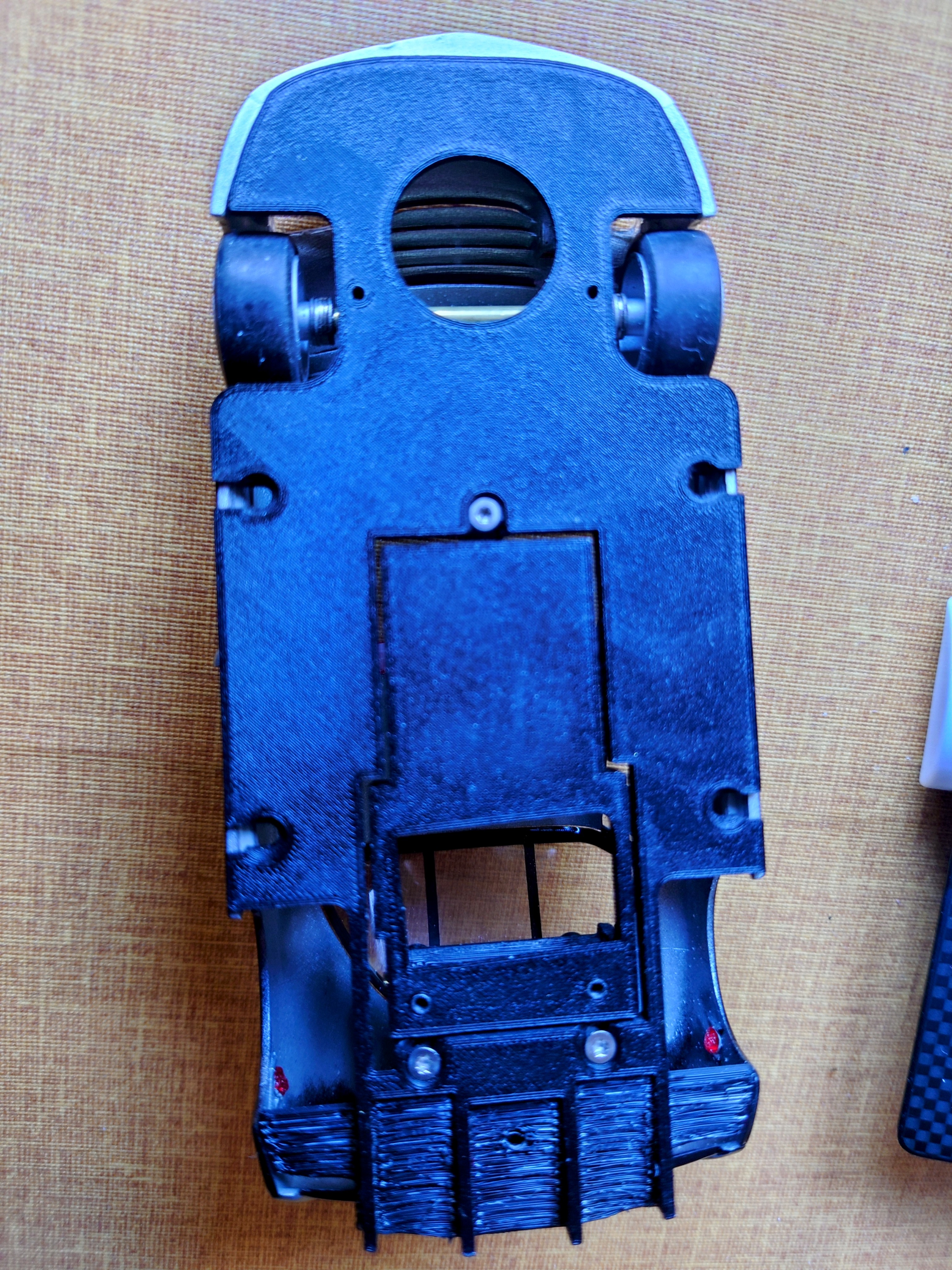

Fly Corvette C5R build.
You never get a 3D chassis perfect first time no matter how well you measure, print one, see what needs tweaking (usually the wheelbase and extremities of the chassis as I like a chassis to fit properly)
The chassis in the pics is MK2...MK3 final is in the box (the body mounts had to be moved inwards nearly 2mm and the guide is moved forwards 4mm)

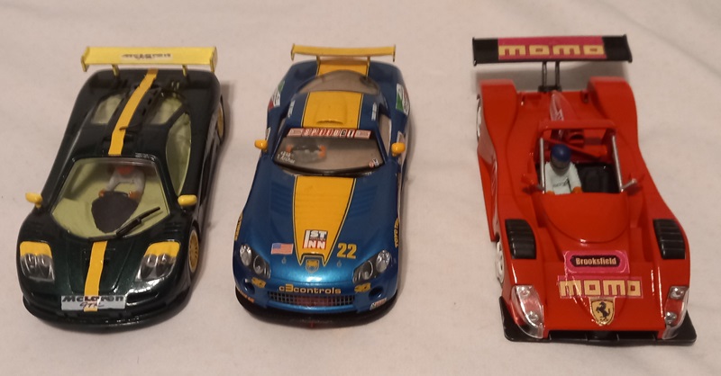

My three are all ready.
Track test on Thursday at NERCS to make sure they are slow enough to keep up my reputation.
Revoslot White Kit McLaren F1 GTR
Dodge Viper - Scaley Body, Amato Chassis, Slot it motor.
Revoslot White Kit Ferrari 333SP
Gerry
