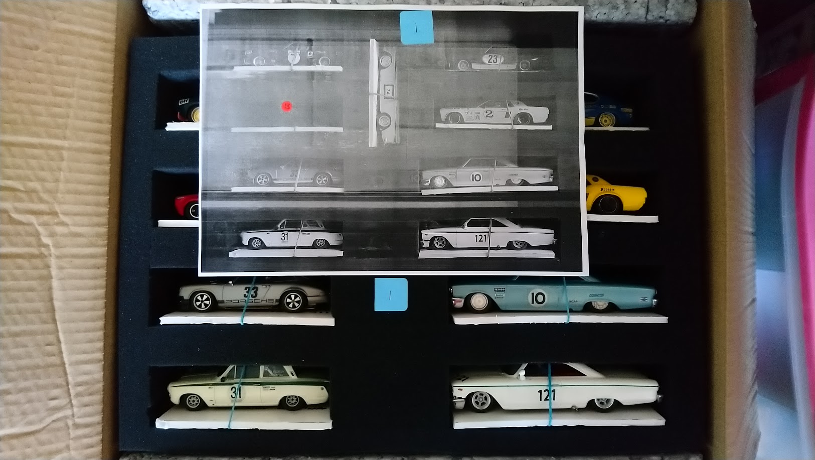

Hi Graham/other hosts
I've taken the liberty of printing a photo of each layer, sadly only have a black laser printer that's running low on toner.
Each layer has a photo of the car layout, each layer and photo has a layer number.
A couple of cars didn't print so they have their unique numbered colour sticker like in Layer 1 where Ade's Mk1 Escort isn't showing.
N.B. Graham, Ade's Escort is labelled Red 13, the base plate is marked S13...but the score sheet is marked Red 12.  Do you want me to change the sticker on that car to Red 12 and change S13 to S12 on the base plate?

Hi Kevan,
yes it should be S12, please change the sticker number to 12 and the baseplate accordingly..........it was very lucky to have got in the box at all to be honest with 30mins between receiving and packing it.

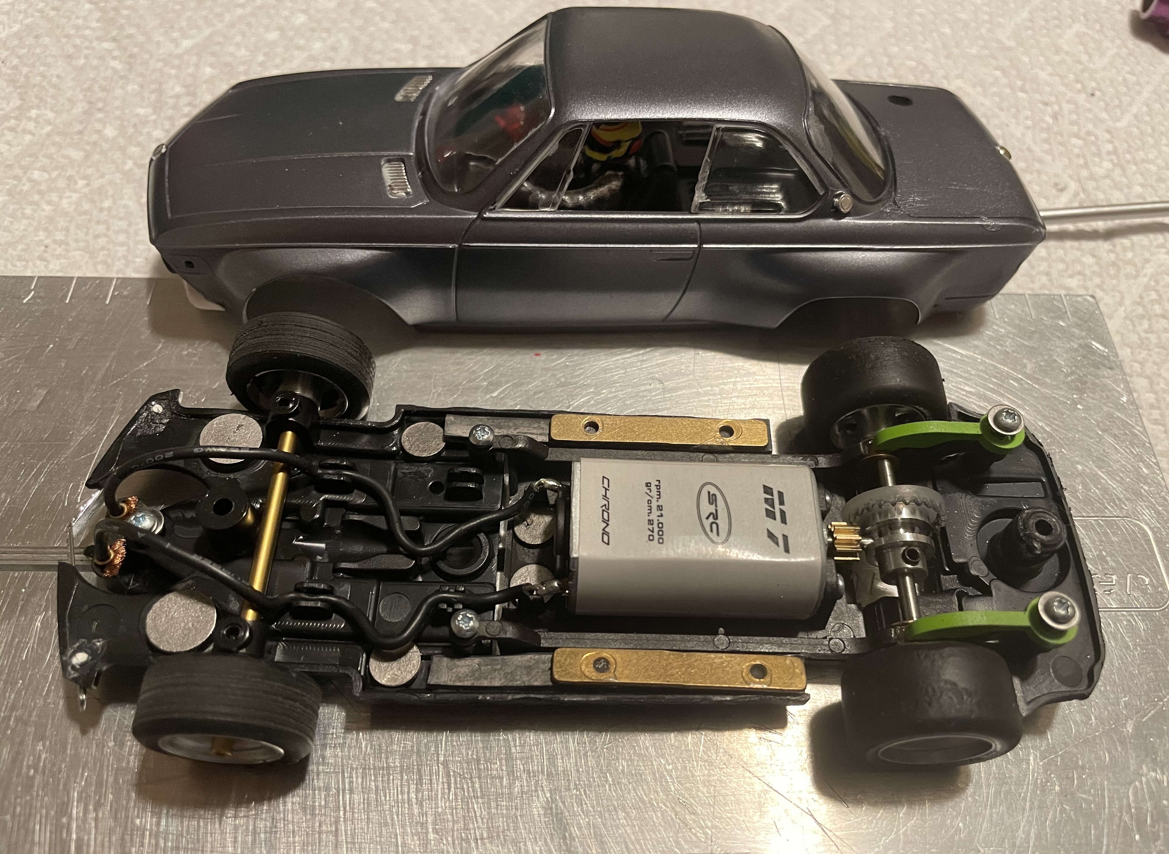

  • the most concerning of which is Brumos RSR BMW 2.8  The gearmesh sounds awful yet there isn't an excess of backlash BUT the car left a trail of aluminium dust all round the track that we called the 'silver dust of death' as it coats the tyres and reduces grip.  It's second race was gingerly finished but this car isn't going to finish the proxy without work.  We had to run cars of our own round for a few laps to clean up the silver dust before the next proxy heat.

  • the most concerning of which is Brumos RSR BMW 2.8  The gearmesh sounds awful yet there isn't an excess of backlash BUT the car left a trail of aluminium dust all round the track that we called the 'silver dust of death' as it coats the tyres and reduces grip.  Its second race was gingerly finished but this car isn't going to finish the proxy without work.  We had to run cars of our own round for a few laps to clean up the silver dust before the next proxy heat.
The motor shaft on the SRC is fairly large, my guess is it is rubbing.  If it’s ok with our Race Director, Graham, I would be ok with minor work being done.  If power can be applied and lightly filed on the inside
 to reduce friction it would be greatly appreciated, I accept all penalties assessed by our Race Director for the repair.
