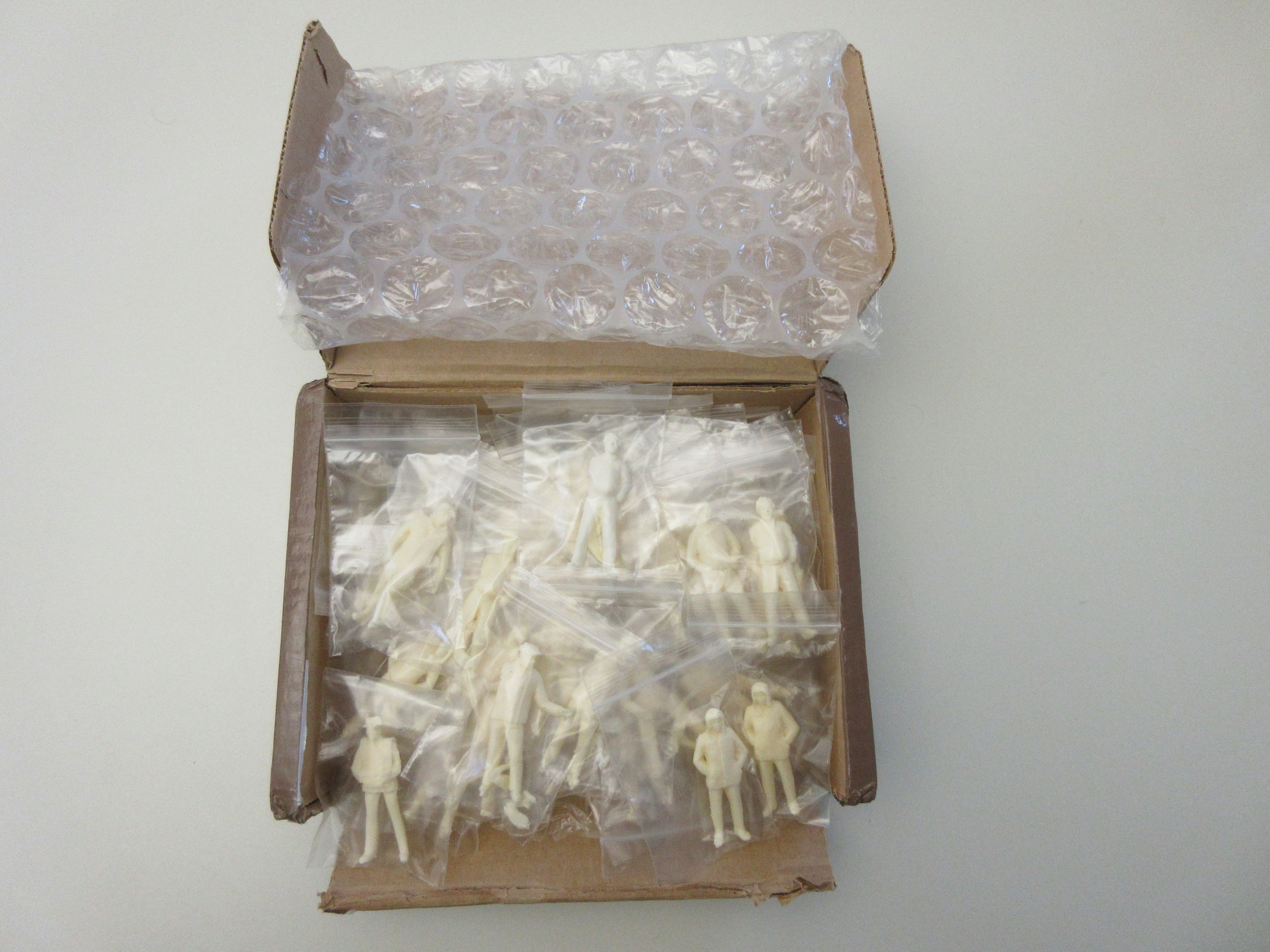

My batch of R&R figures arrived with 1:32 scale speed from the UK to me in the Netherlands. Their trip lasted six weeks.

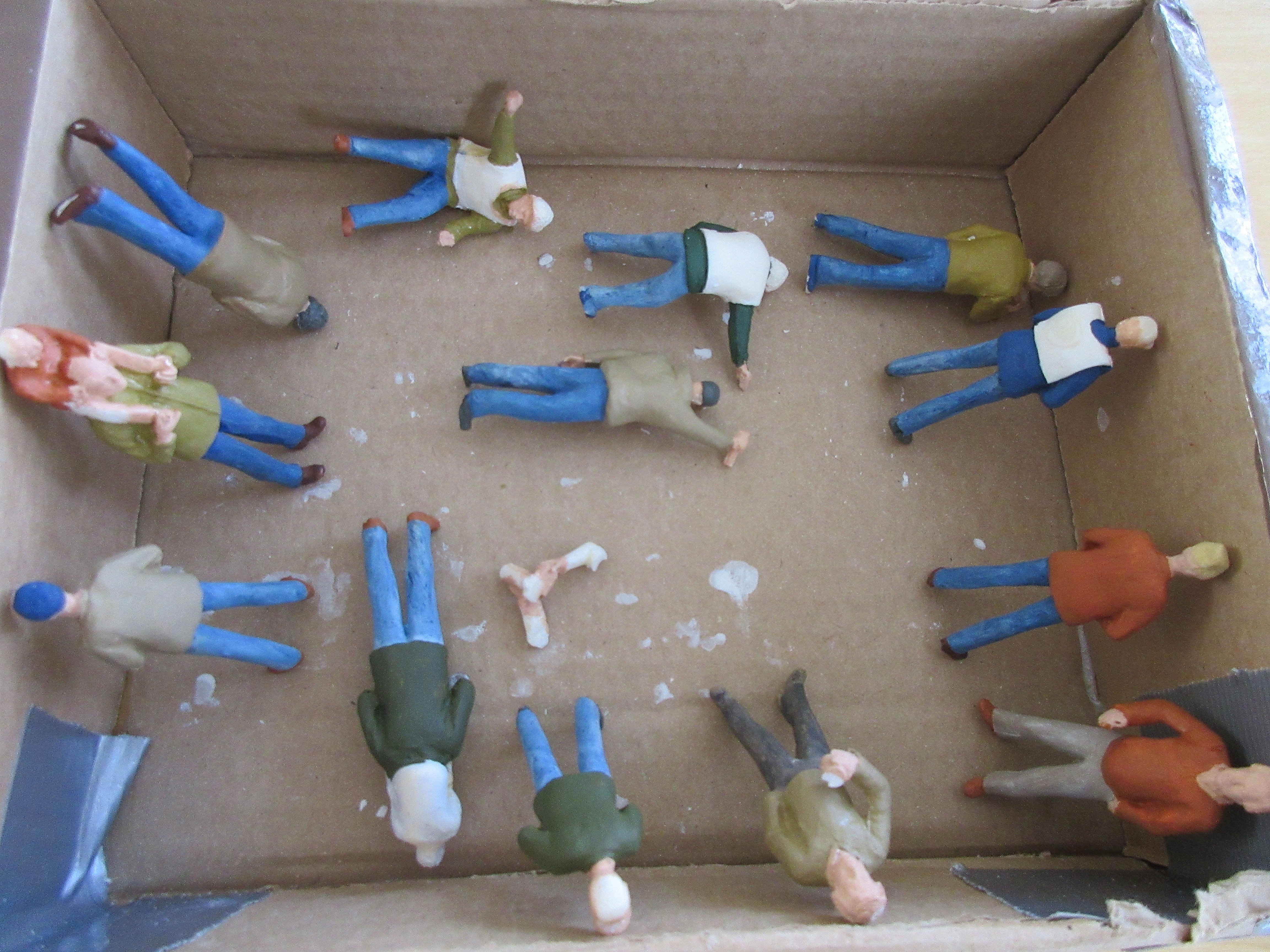

First I sanded their feet to keep them upright. In contrast to 3D figures, these resin figures must be deburred well.
Air bubbles also need to be filled. Next,  I'll start painting all skin surfaces followed by the rest.
[+] 6 members Like rallyhub's post
Made some progress yesterday:
Skin and pants painted.                                                                                                                 Some colours mixed. Still a long way to go.

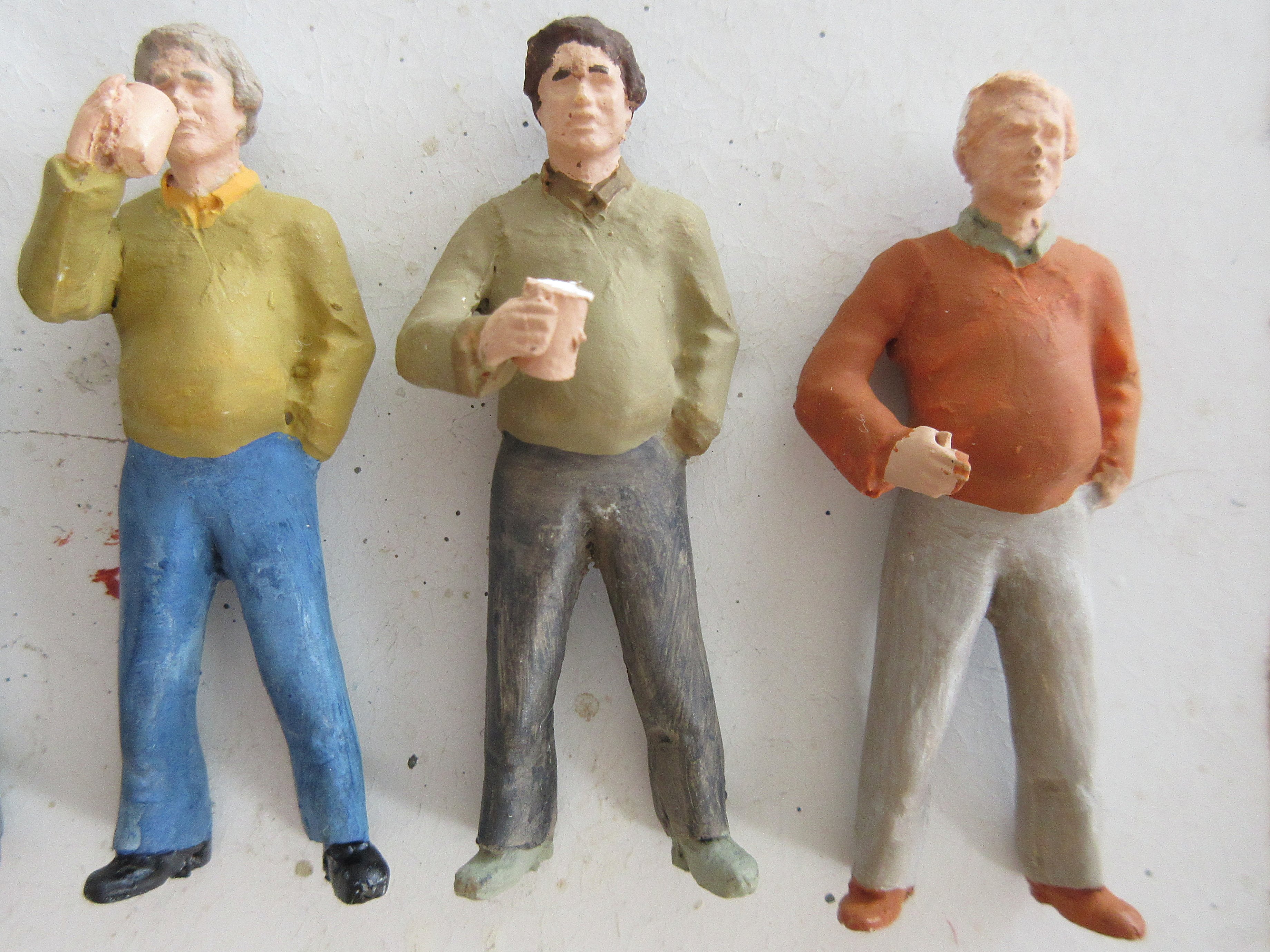

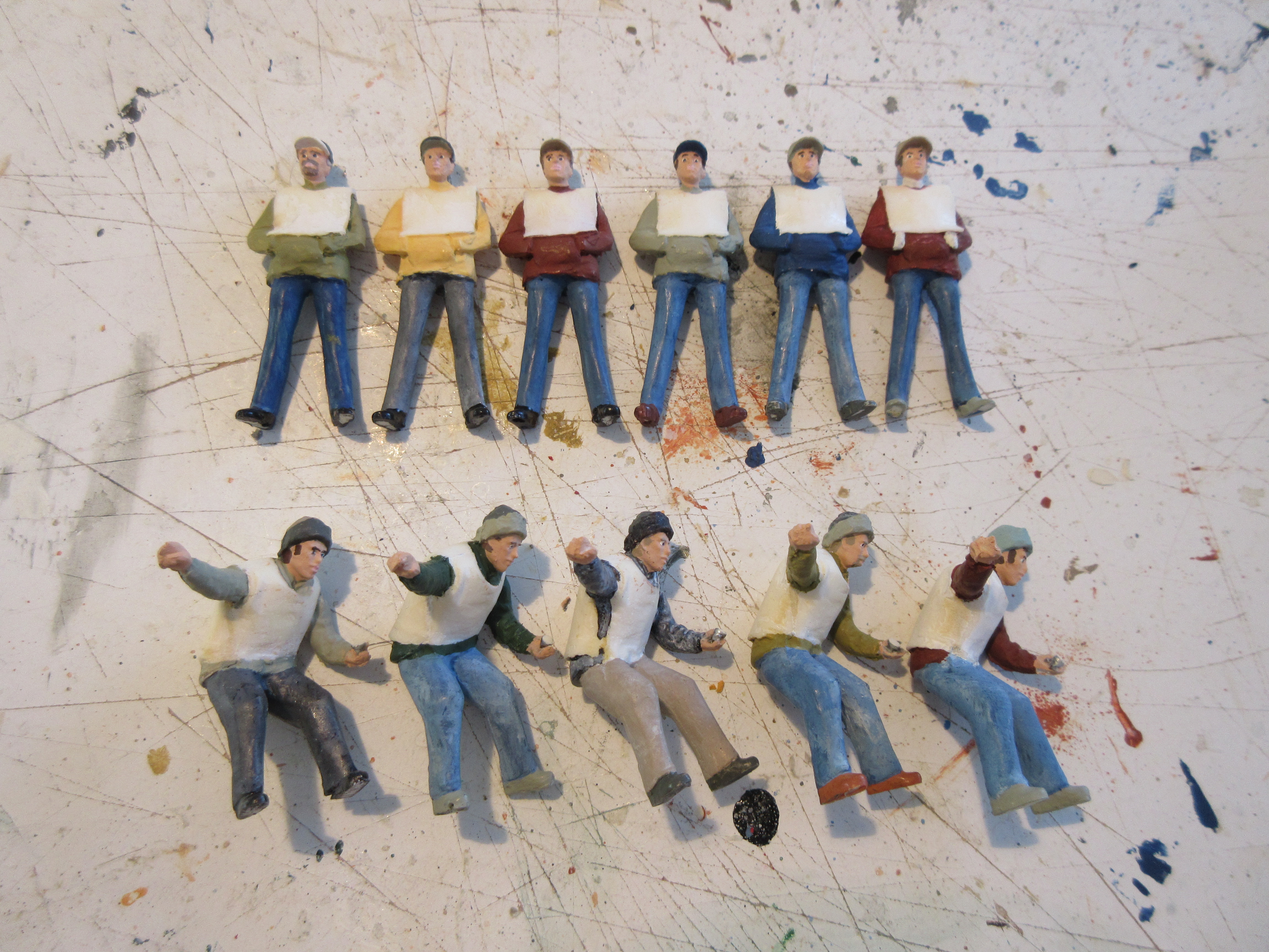

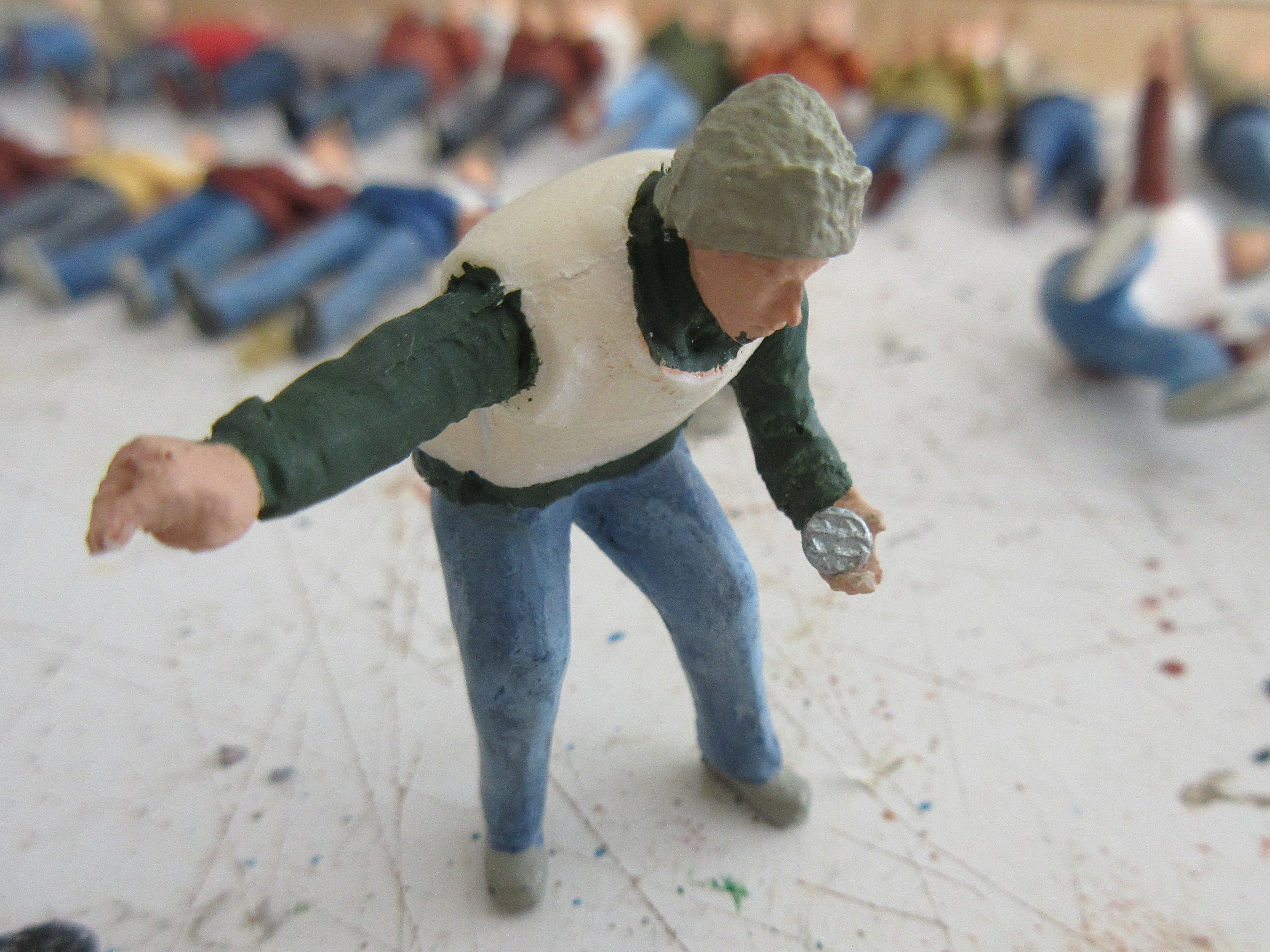

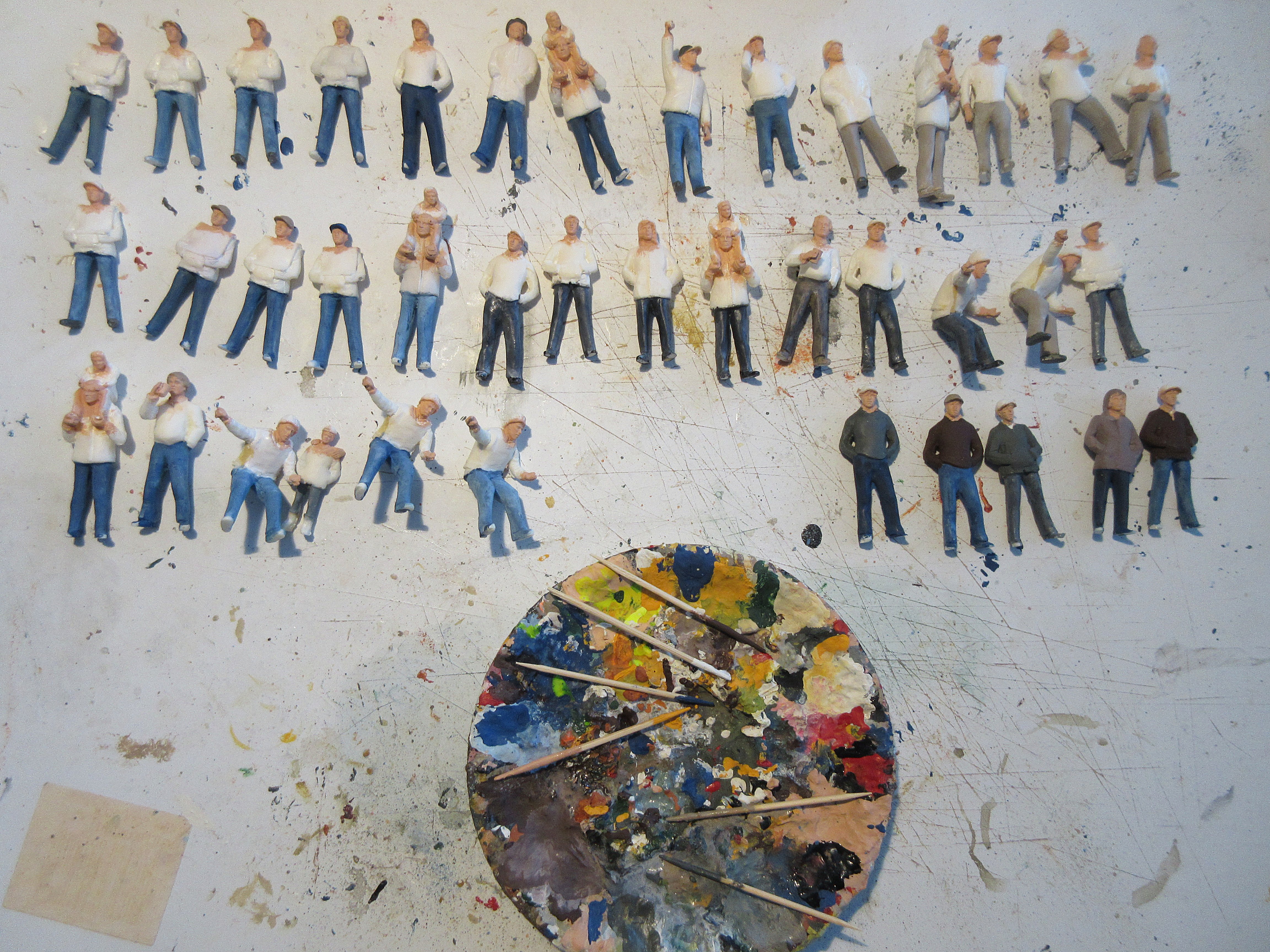

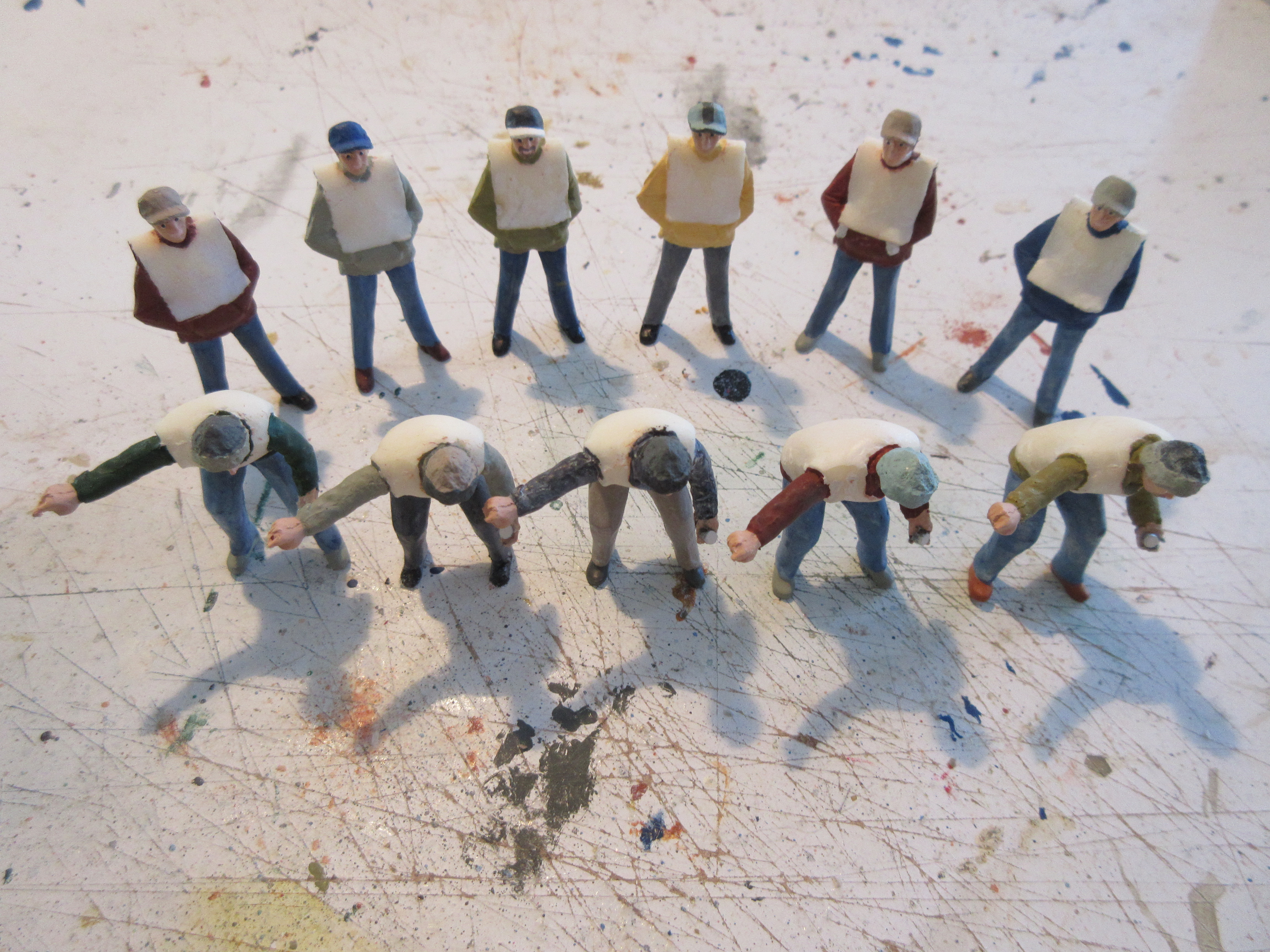

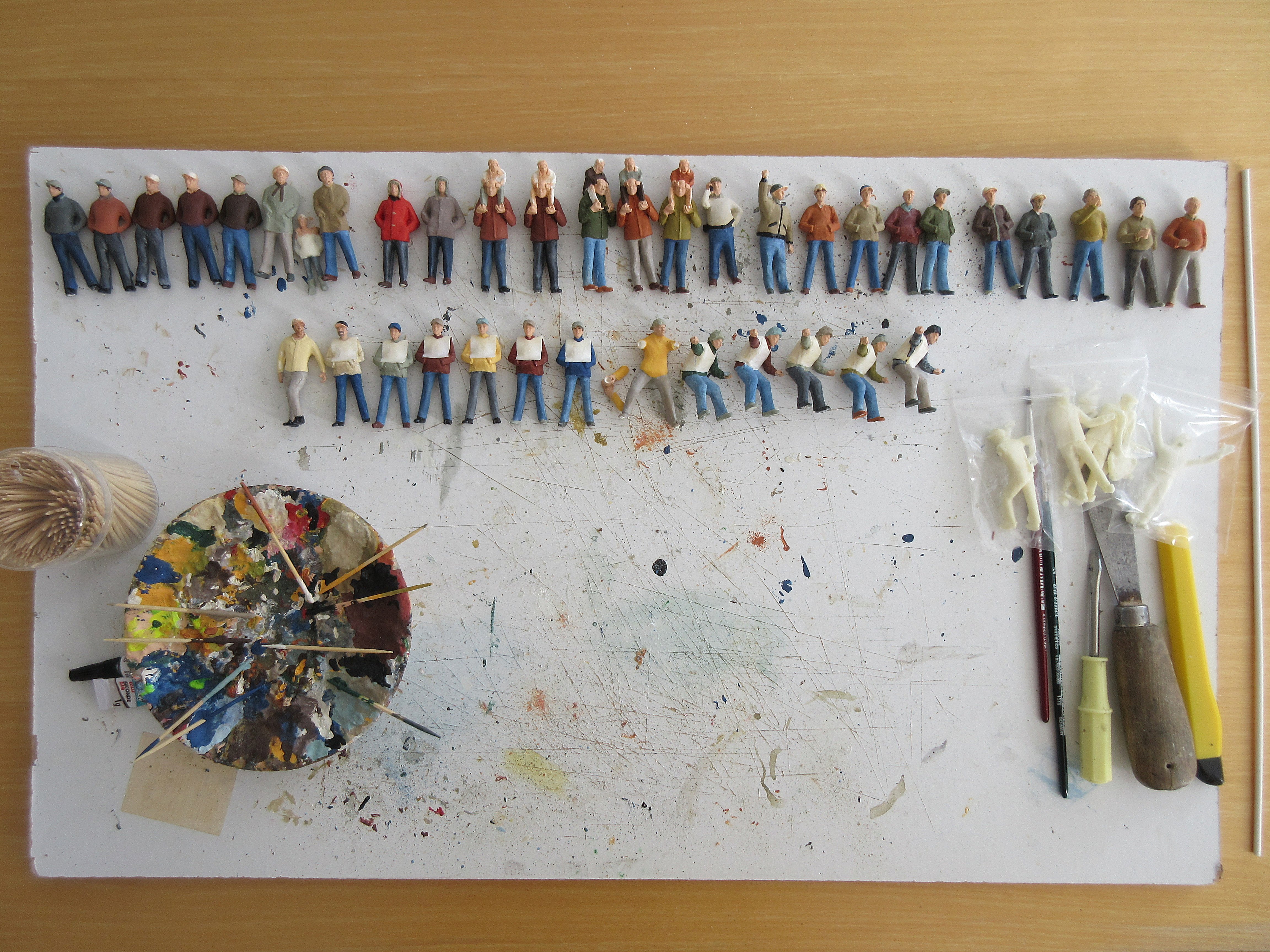

Here are a few pictures of my progress so far:
The "dry box".                                                                                                                                     The progress so far. Still a lot detailing to do.
A close-up of some unfinished figures.                                                                                    The head of a nail is the basis for a 1:32 scale stopwatch.

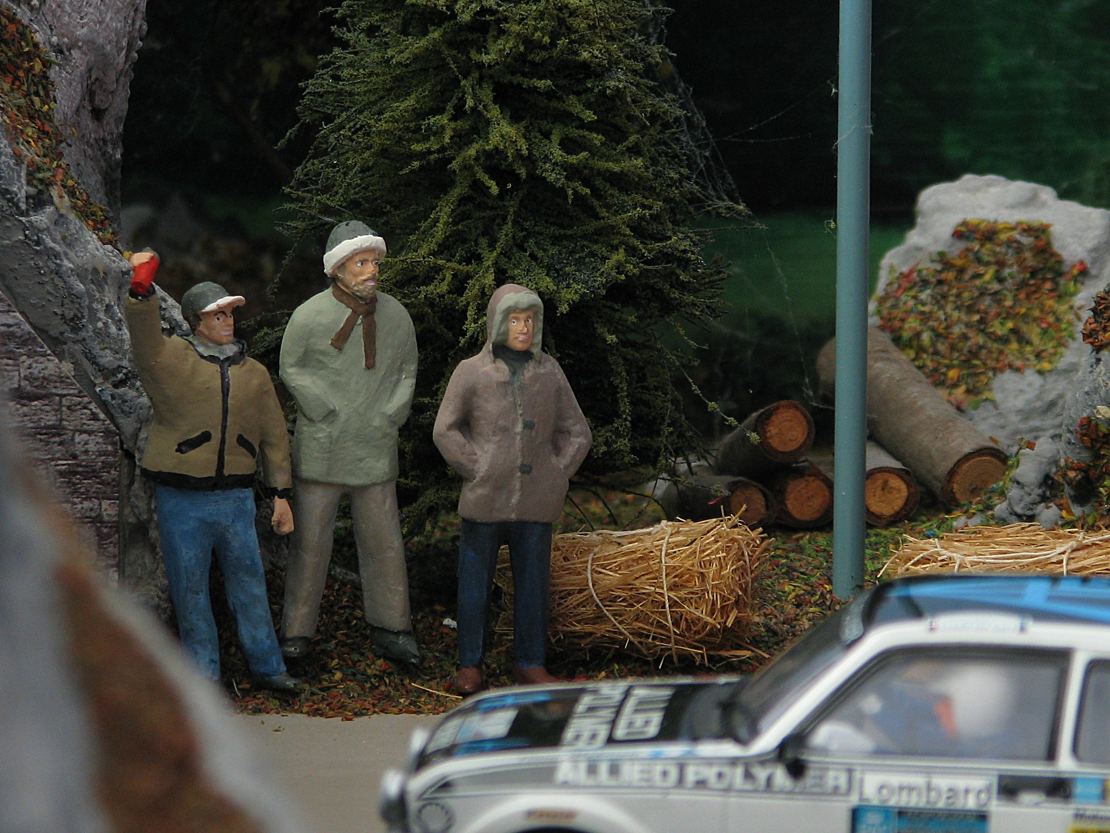

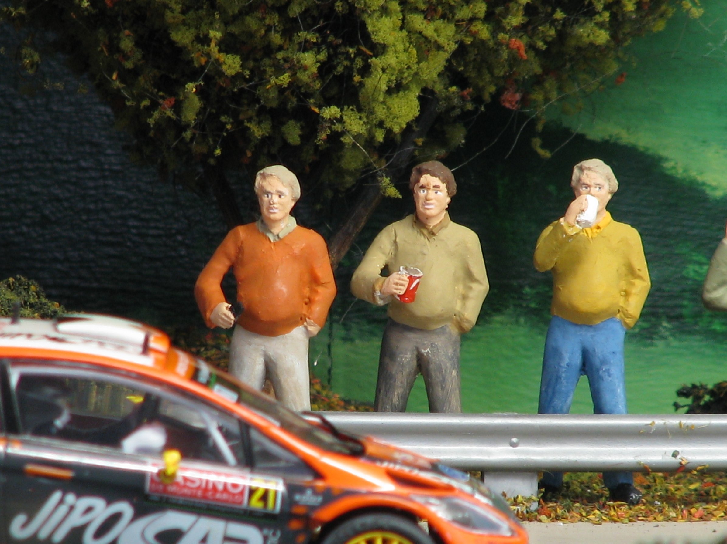

A few figures are finished now:
Watching the action...The businessman on the left is holding his balsa wooden smartphone. The man in the middle has a Coke and on the right a man drinks his hot coffee.

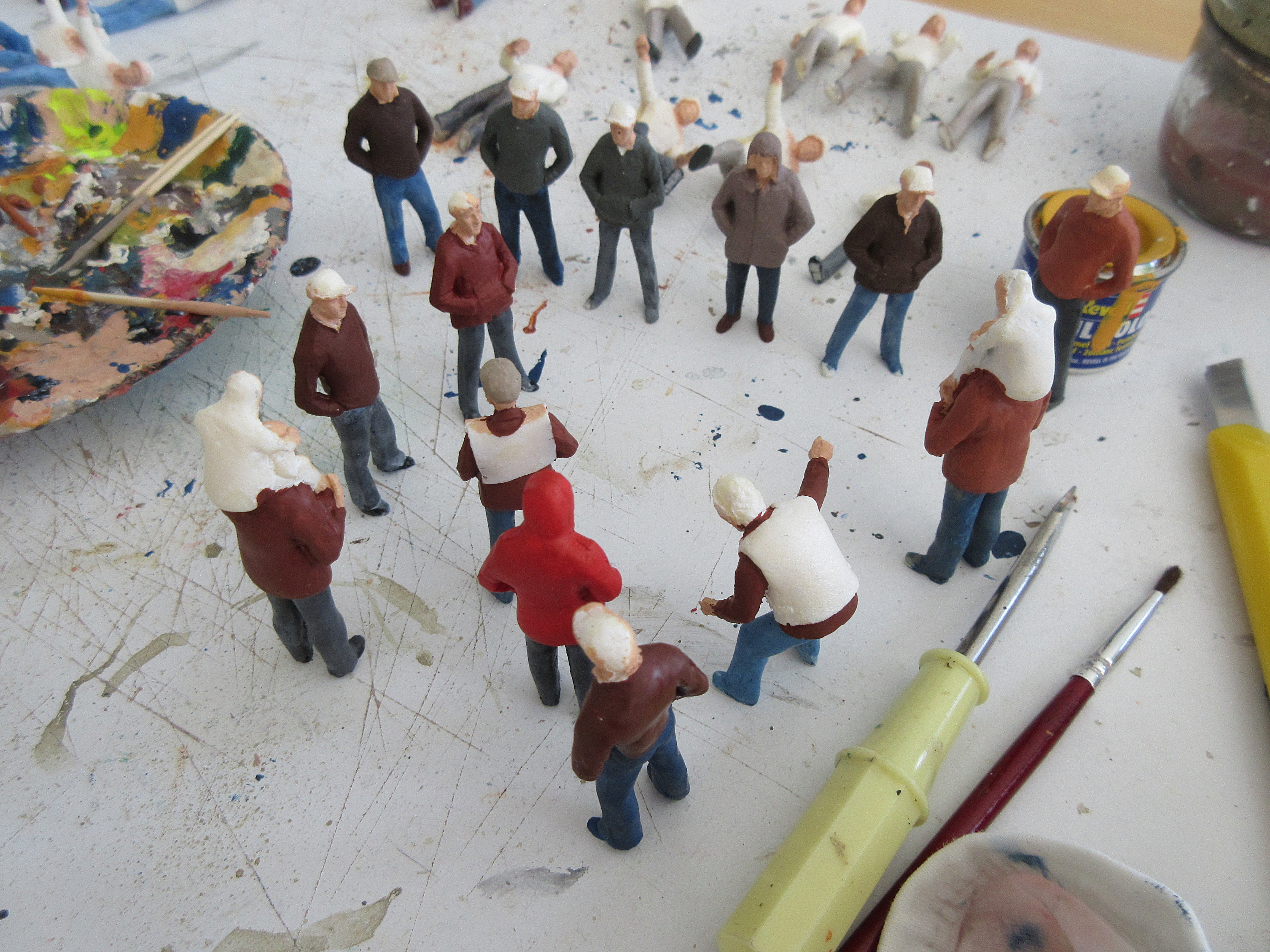

A few more to paint and then all the figures are ready:
A few Marshalls still need some paint.
