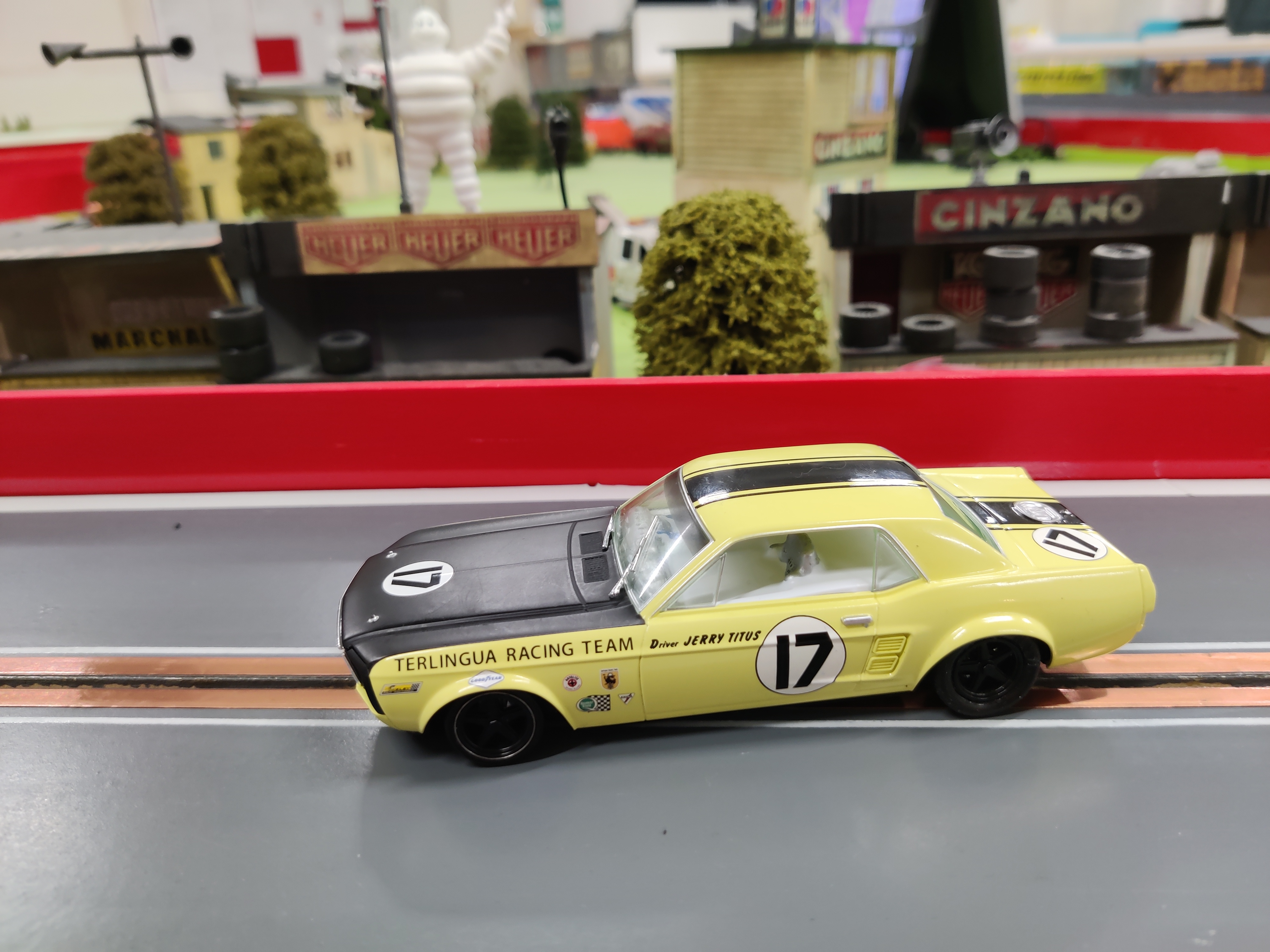

Last update and some tech specs before cars get posted tomorrow. I managed to get a quick shakedown in at SMSRC on Thursday.
The mustang continues to be a lovely thing of wonder, I might get a few more transam cars and build them up it's been very rewarding, although it was fighting me at first, getting the right combination of pod and wheel diameter to meet the ground clearance rules but not foul the body was a tedious experience!
Pioneer mustang body, generic large saloon lexan interior
Amato chassis
0 offset slot.it inline pod
10/24 slot.it gears (probably a bit long for twisty tracks)
Nsr front 16*8 hubs glazed zero grips
Nsr rear  16*10 air hubs,ultragrips 19*10
Revoslot shallow guide
Sideways baby raptor motor (approx 17400)

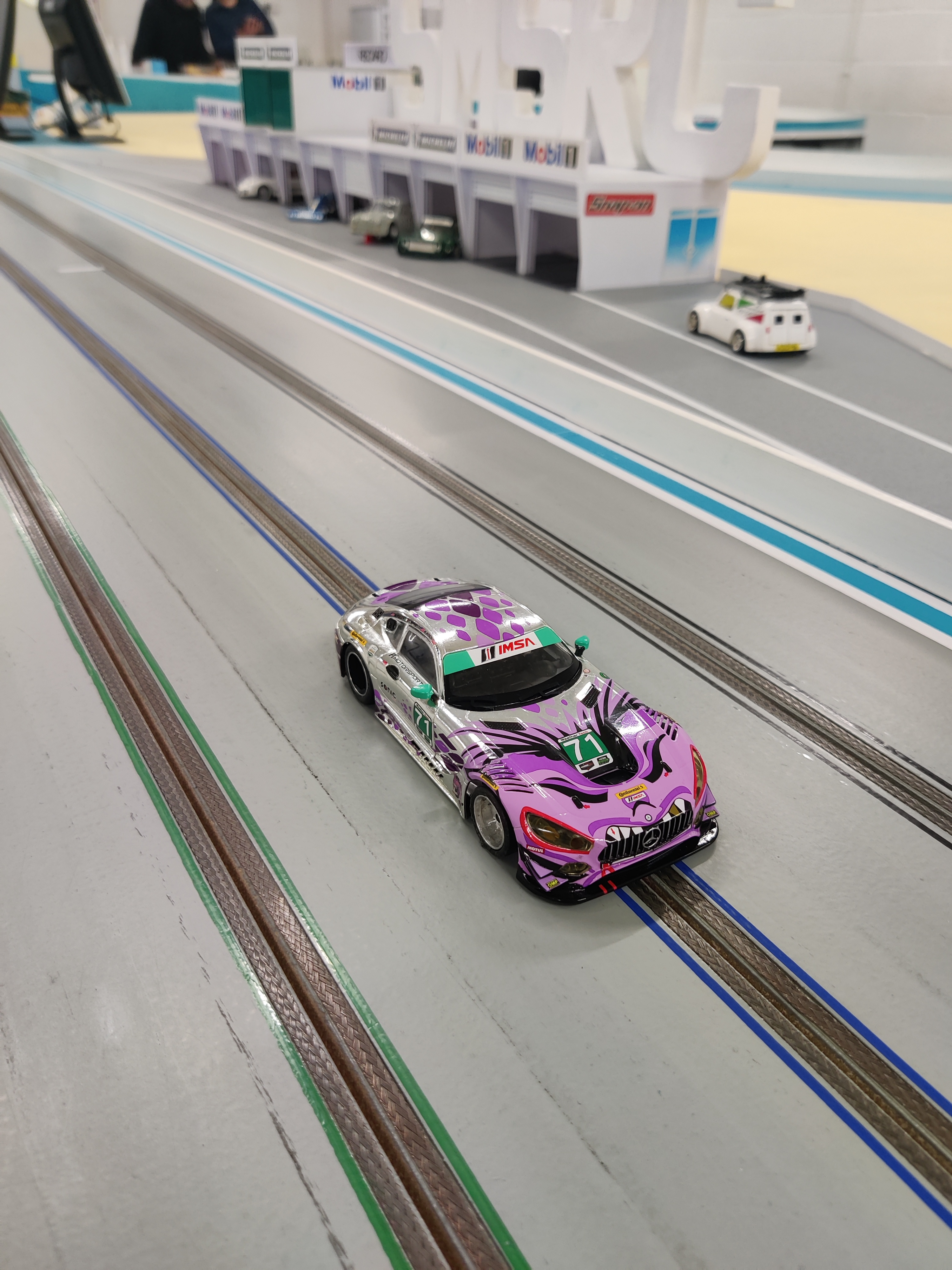

The AMG continued to frustrate, feels like the motor couldn't pull the skin off a rice pudding but the tacho tells me the motor is quick. Too late I have guessed that the tyres are just too wide/sticky, they were nsr supergrips doped with 3 in 1 oil until tacky to the touch. Instinct tells me to make the tyres as sticky as possible but after recently  coming unstuck (pun intended) using ultragrips on an nsr F1 I have decided to swap the wheels/tyres out for the pair that were used (and did quite well) on a slot.it r8 in the le mans proxy. I haven't had chance to test this combo so it's pure blind luck if it goes well!
Scalextric AMG body/interior and chassis and motor.
Slot it 17.3 * 8 alloy wheels, nsr zero grips on the front brm f15 on the rear.
Lights and that strange thing on the motor removed.
Guide adapted with brass rod to take a scaleauto guide, trimmed to be within the rules.
Slot.it pinion and gear
Chassis sanded to remove any binding.
