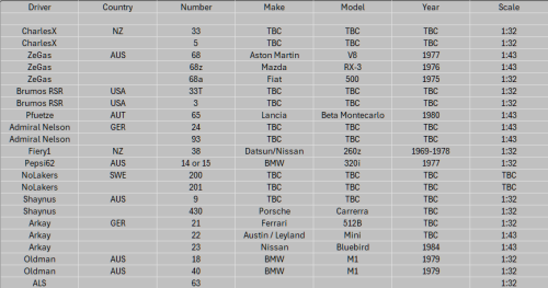

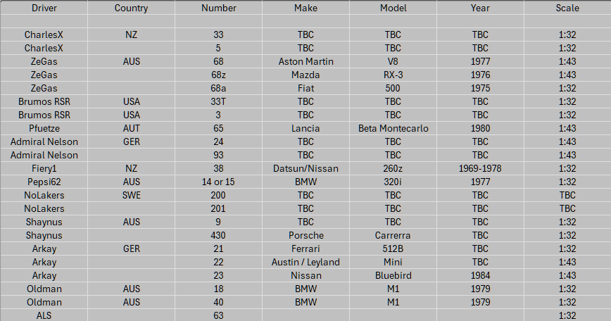

[+] 2 members Like ZeGas's post

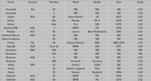

I was initially seriously considering entering this one but have too many cars to get ready for other proxies but will follow with eagle eyed interest...hopefully videos will be available too  Thumbup
Initial post driver list updated

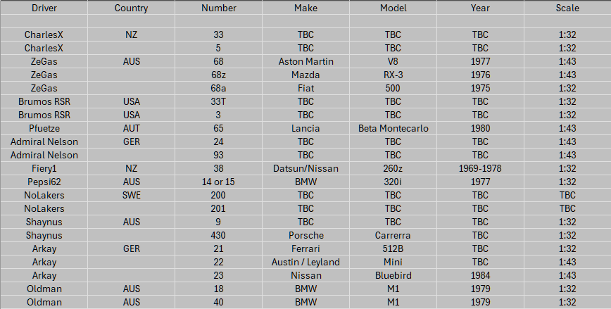

Looking forward to this and would like to change my number to 33T and reserve 3 in the event of a second car if that’s ok.
[+] 2 members Like Brumos RSR's post
Still the M1?
Cheers Grant
