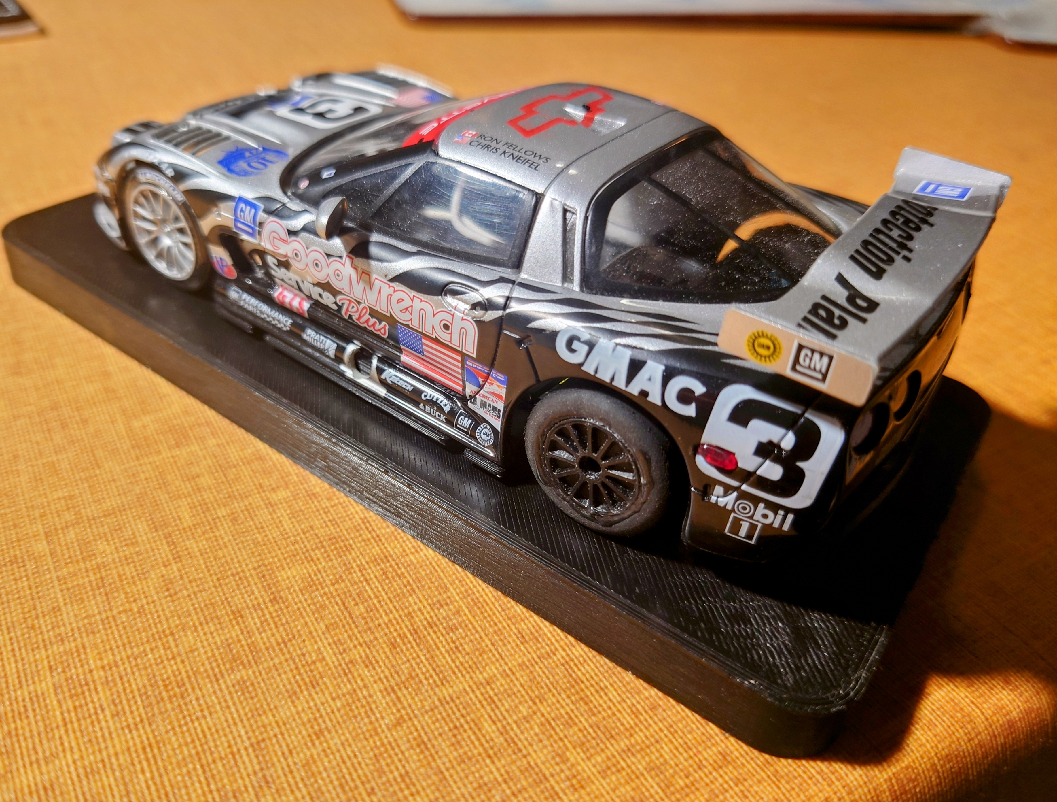

It's a runner and drives nicely around my little Scaley Sport test track...not sure about the rear tyres though, might be Evo Ultras (which ball-up for fun) but not labelled as Evos...
...Oh the rear wheels are 3D printed in PLA Tough with a M2 brass collet in the middle...much testing to follow at the club

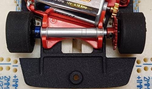

Here is the drive train of my GT2 entry...
...fully balanced!
I love puttering with gears
Posts: 3,910
Threads: 131
Likes Received: 2,610 in 1,570 posts
Likes Given: 3,532
If that was mine I'd glue the tube into the pod where the bearings normally go.

I've printed another set of wheels and put standard wide Revoslot tyres on...
.. .testing tonight, not just the two rubber compounds I've got on these new wheels but also the durability of the wheels themselves and whether the grub screw will stay tight or whether the plastic stretches (that won't be a good thing as the wheels will come loose).
Posts: 3,910
Threads: 131
Likes Given: 3,532
Testing last night with Revoslot tyres and NSR Ultragrips showed they weren't going to be competitive and too inconsistent...put a set of 10mm wide normal original Ultragrips on from another car and it was at least 2 tenths faster and much more consistent...
...but the 3D printed wheels didn't come loose
The NSR Ultras I bought a year ago, 11.5mm wide, not labelled as Evos but I was suspicious because the original Ultragrips were shiny, these weren't which made me believe they're Evos but purposely labelled without the 'Evo' bit (possibly to fool me into buying them believing they were original tyres)...they're crap!...ball-up for fun.
But the good thing is the car (Fly Corvette C5R) is really nice to drive with real original NSR Ultragrips.
Going back to Revo tyres, they seem to work really well with the heavy Revo cars, I just didn't want to add loads of ballast to make the car that heavy.
