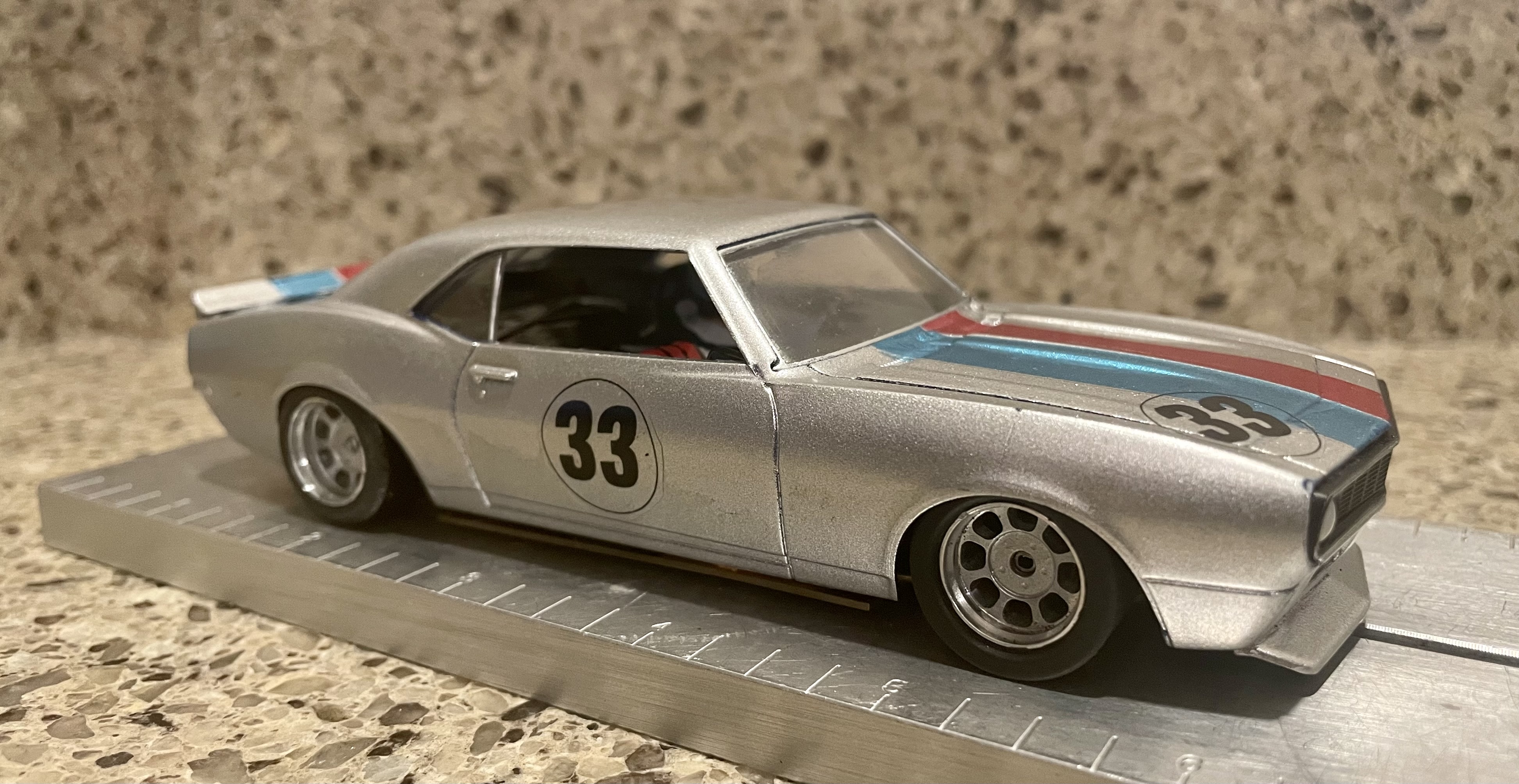

Camaro 1
This one has ground clearance of 1.5mm high versus my original 1.15mm ride height Sunoco Camaro 1 which I ran a few years ago.  The body has also been raised since this picture to 1.0mm above the wheel to the top of fender opening although it was not built for the US TA proxy.  It’s a little porky at 103 grams so I still have a little work to do.
9/32 gearing, this will change
22.5k Predator motor
Brass chassis :
CBD wheels 15x8 all around
NSR Rubber on the rear
Slot it Zero Grip fronts
Camaro 1 if you remember, ran a few years ago at 1.15mm ground clearance with a Shark 20 on a hybrid brass chassis with a Slot It pod.  #6 won 5 or 6 races and has become the new Camaro 1 standard for me with my Camaros going forward.  This one weighs in at 89.5grams. Although it will not compete in this proxy, I’m looking to shed some weight and add a Cohoza 21 motor for just that little bit more.

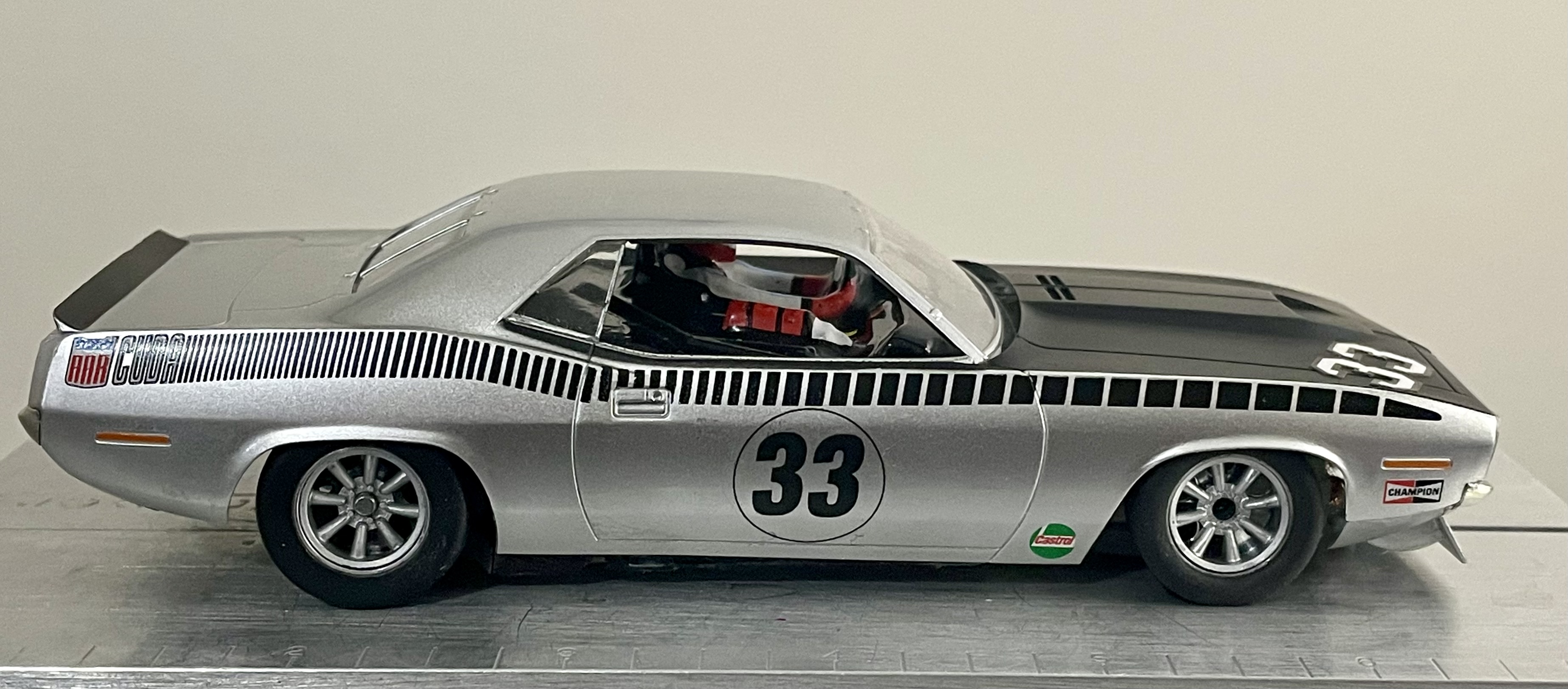

The Cuda is close to done I’m considering swapping out the rear window with the hopes of dropping the CG  just a little more.  10x21 rear tires are taller than my Porsche 904 tires!! Fronts are also 21mm tall.  This of course creates an extremely high ride height at 2mm as it was built for the US TA Proxy where there  is a 1.5mm of tire showing between the wheel and top center of the fender.
At 59mm wide at the rea and 58mm wide at the front it’s better than the Thunderslot Shelby at 59mm rear and 55mm at the front.  It’s 40mm at its highest point versus 38.5mm for the Mustang so hopefully the front width makes up for the difference and potentially a rear and side window change. The weight is down from 103grams to 94grams, I will need to find 5 more grams for better handling, braking and acceleration.  The goal is for it to handle somewhat like a big Thunderslot Can Am car.

(17th-Oct-23, 03:21 PM)Brumos RSR Wrote:  The Cuda is close to done I’m considering swapping out the rear window with the hopes of dropping the CG  just a little more.  10x21 rear tires are taller than my Porsche 904 tires!! Fronts are also 21mm tall.  This of course creates an extremely high ride height at 2mm as it was built for the US TA Proxy where there  is a 1.5mm of tire showing between the wheel and top center of the fender.
Looks absolutely fabulous  Sun  you will  need all round glazing to avoid penalties, but of course you can use lightweight replacements. I guess the body is a repainted Scalex, and with a B&W chassis ?
