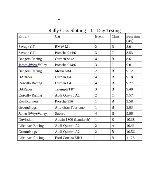

Wavegreen Good Morning
I thought I would complete yesterday testing session with this table
My first thought was that looking at the results, just how good the Alfa Romeo could be in Event 1, shame that the motor kept cutting out on track for the other laps.
Hope we can get it repaired.
Also looks like Savage GT are in full Race mode from the start  Bigsmile
