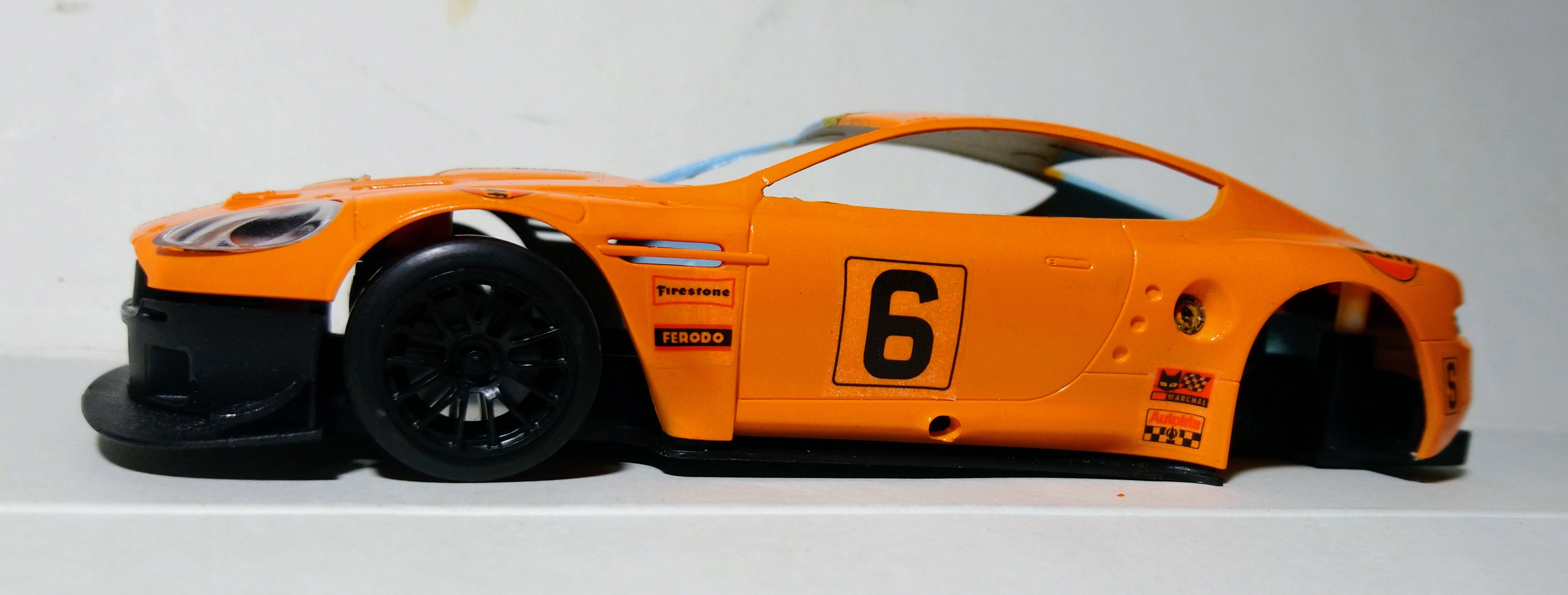

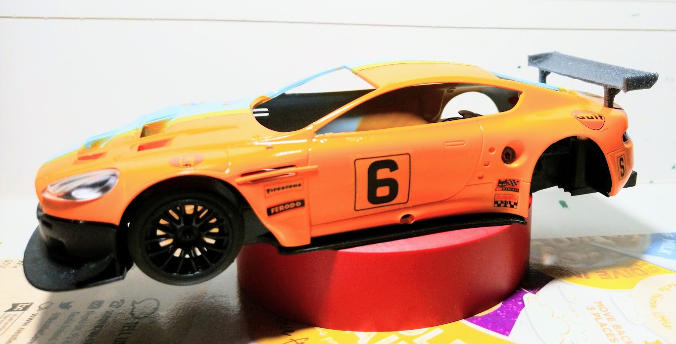

I needed a rear wing so modified a file I had then printed it in nylon so it's flexible and be very very difficult to break, the body will probably break first.
Now I'm not 100% sure which class to go in with this, I quite like the idea of a Class A car but also like the idea of drawing up a 3D chassis for it similar to the Audi A5 as a Class B car.
I'll have to build it as a standard car and test it first but I know it won't be as quick as a Class B version which will hinder competing for the Event prize.
We recently created a 'Back to Basics' class based on Grahams Class A rules, basic cars with basic mods and lower performance motors so I will get chances to test it in racing conditions.
#39

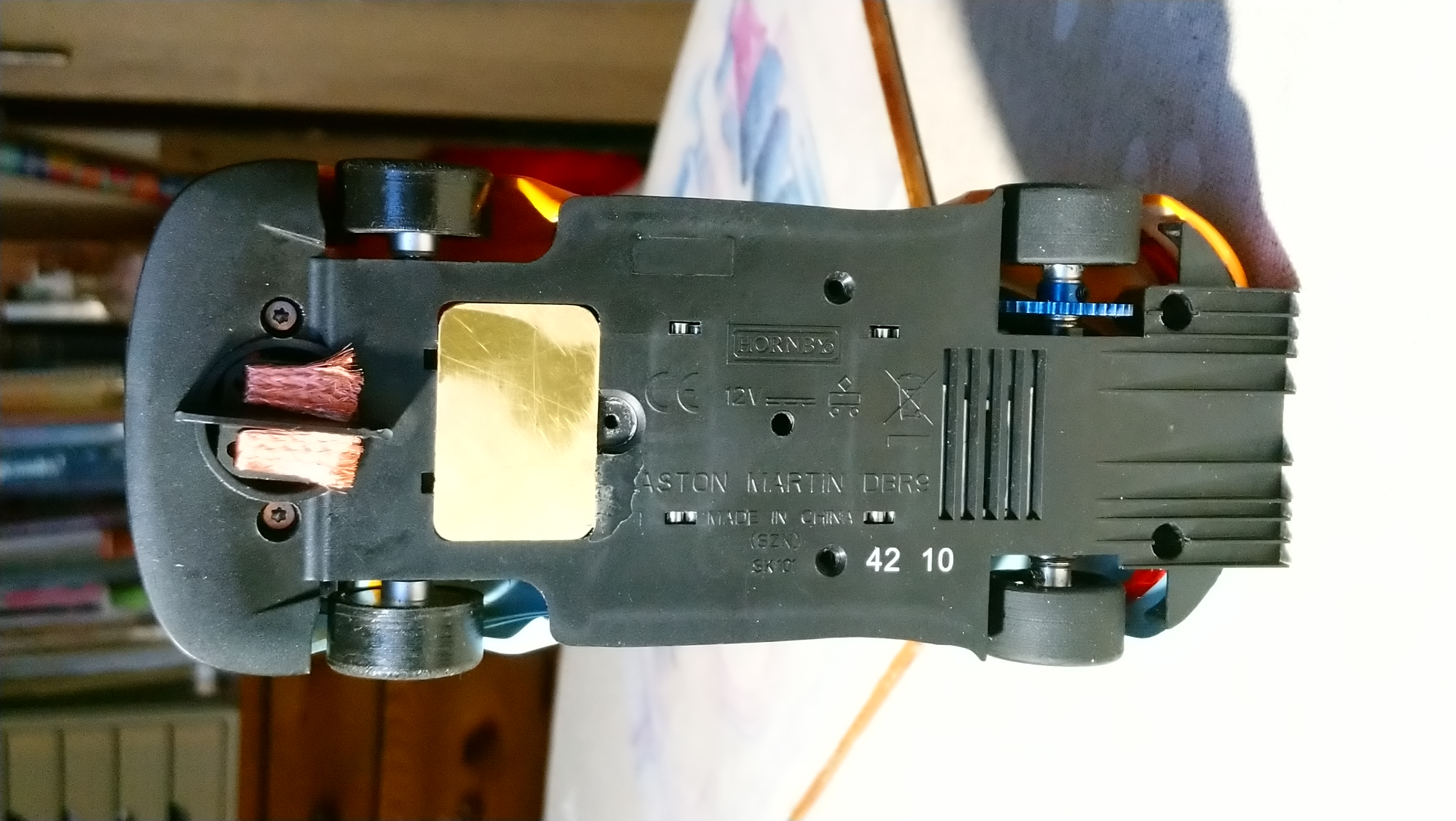

Ready for testing...
.  Revoslot standard rear tyres (solid)
.  NSR Shark 22 motor
.  12/34 gearing
.  Brass plate to replace the plastic hatch
.  Tungsten TIG rod pieces filling the two magnet pockets
.  Slotingplus 002 guide
. Plastic front wheels at the moment because I had a set glued and trued the right size but probably be replacing with alloys

Ahh, a modification of the chassis. So that makes it a Class B or possibly Class C…I think
