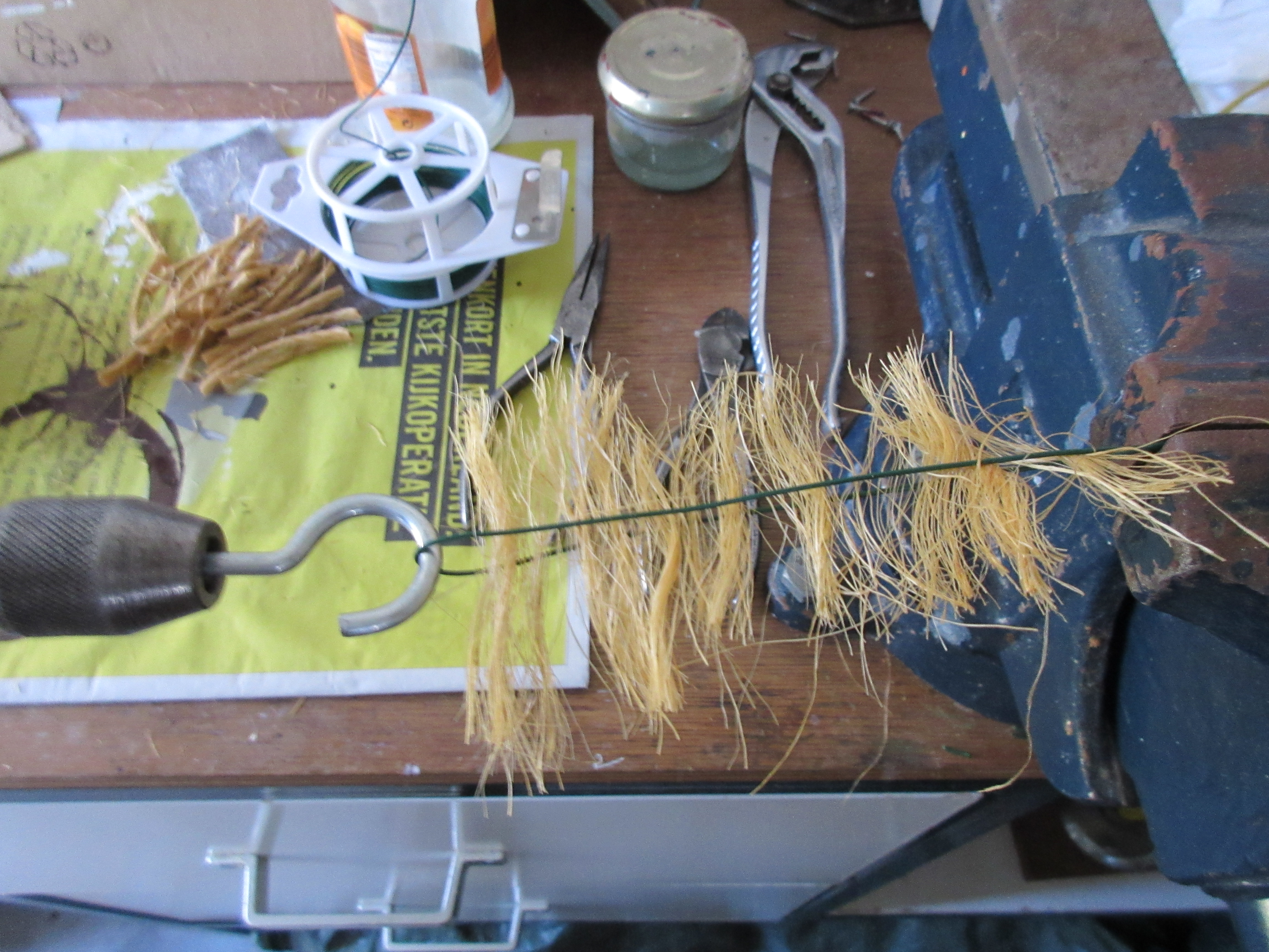

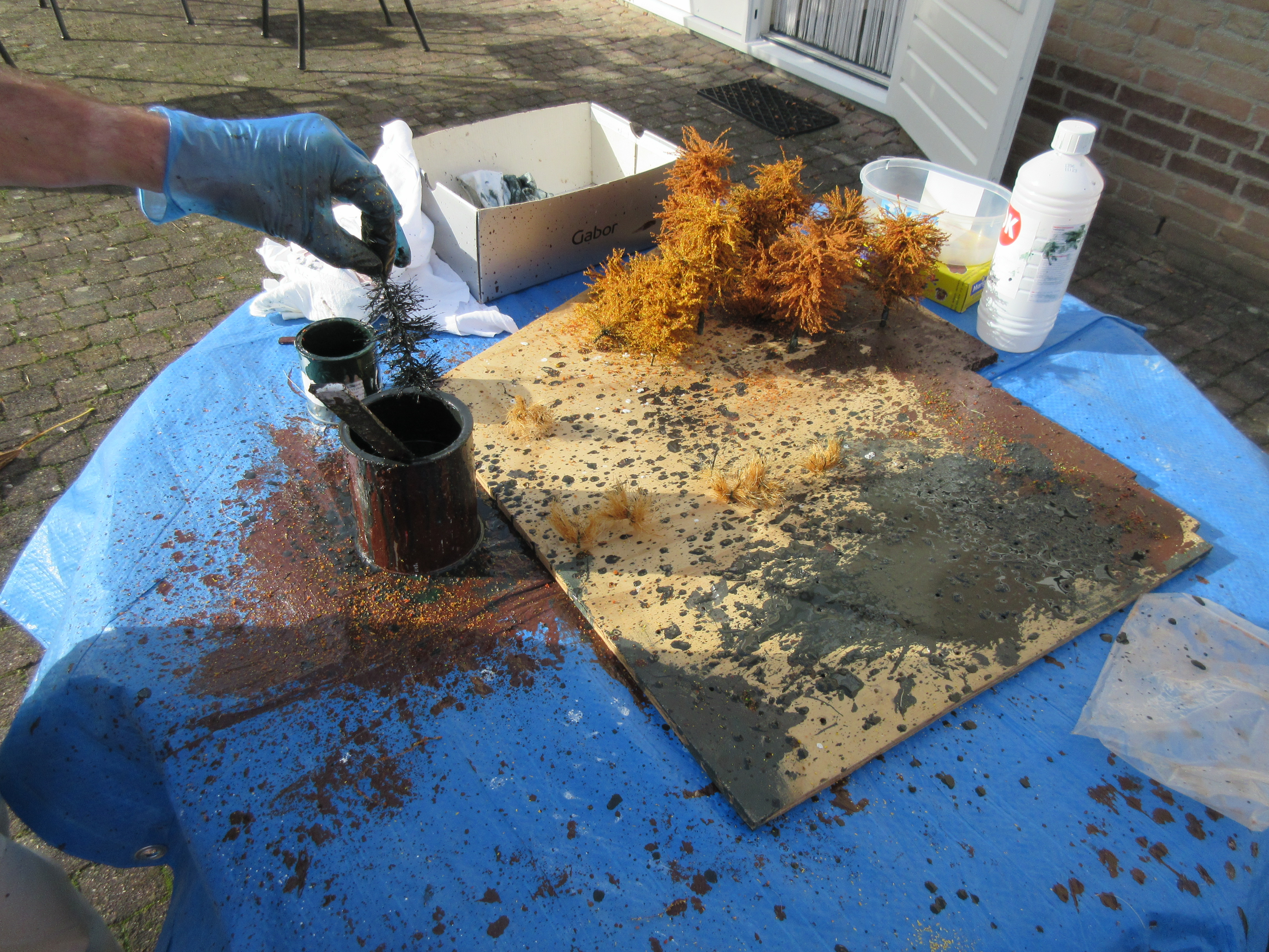

Here you can see how I made the shrubs:
Hub Thumbup

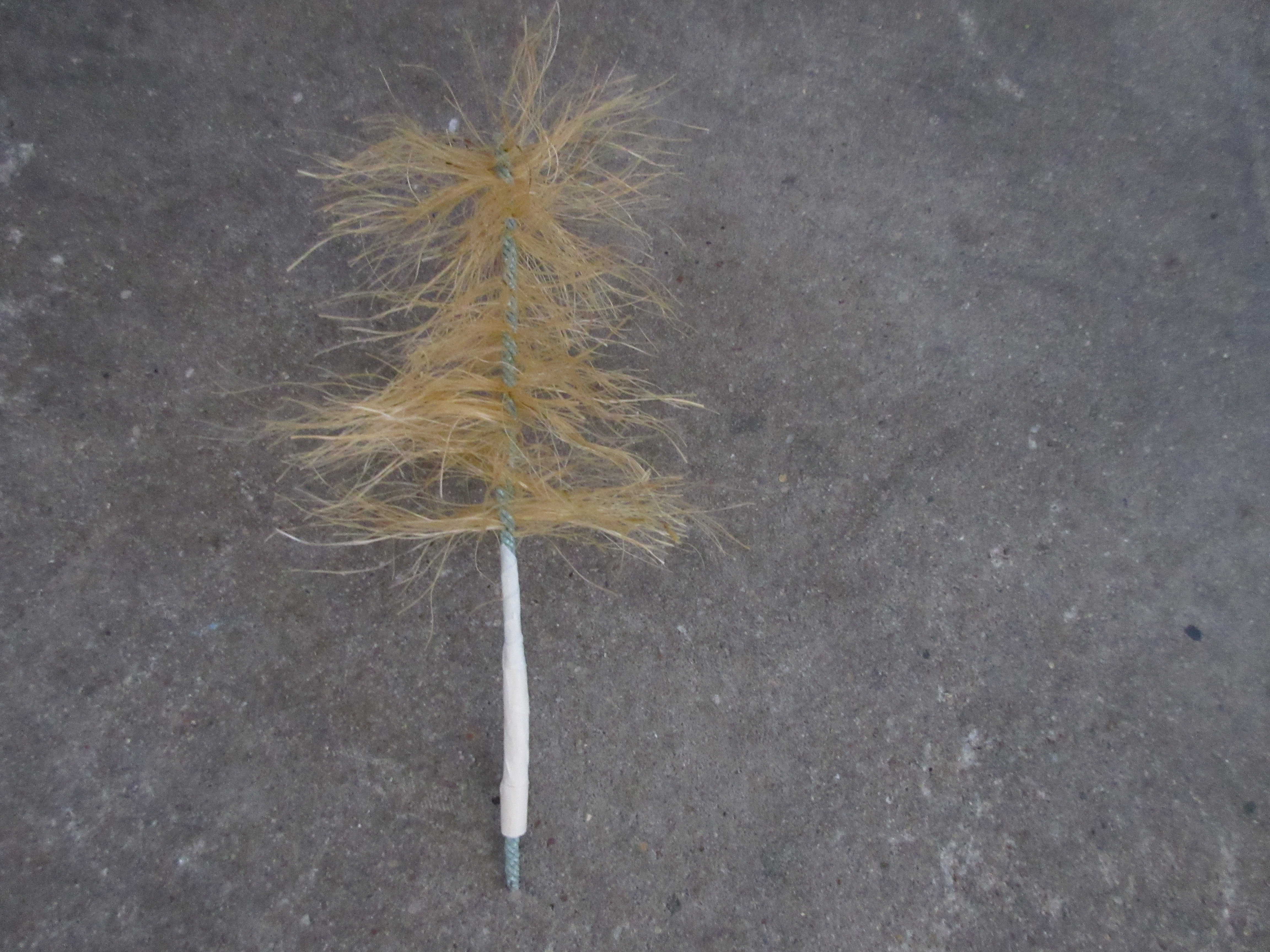

Twist iron binding wire with a hand drill with strips of sisal rope in between.      Masking tape on the trunk of a small tree before covering it with wall paint.

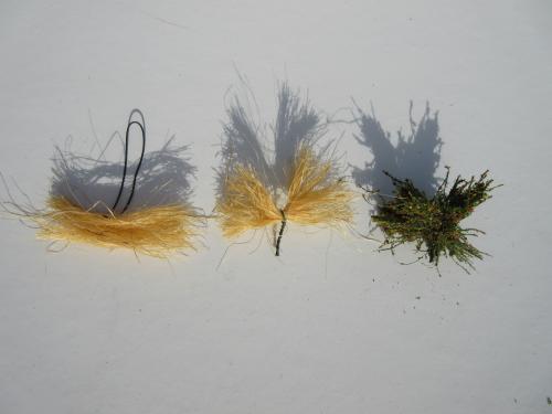

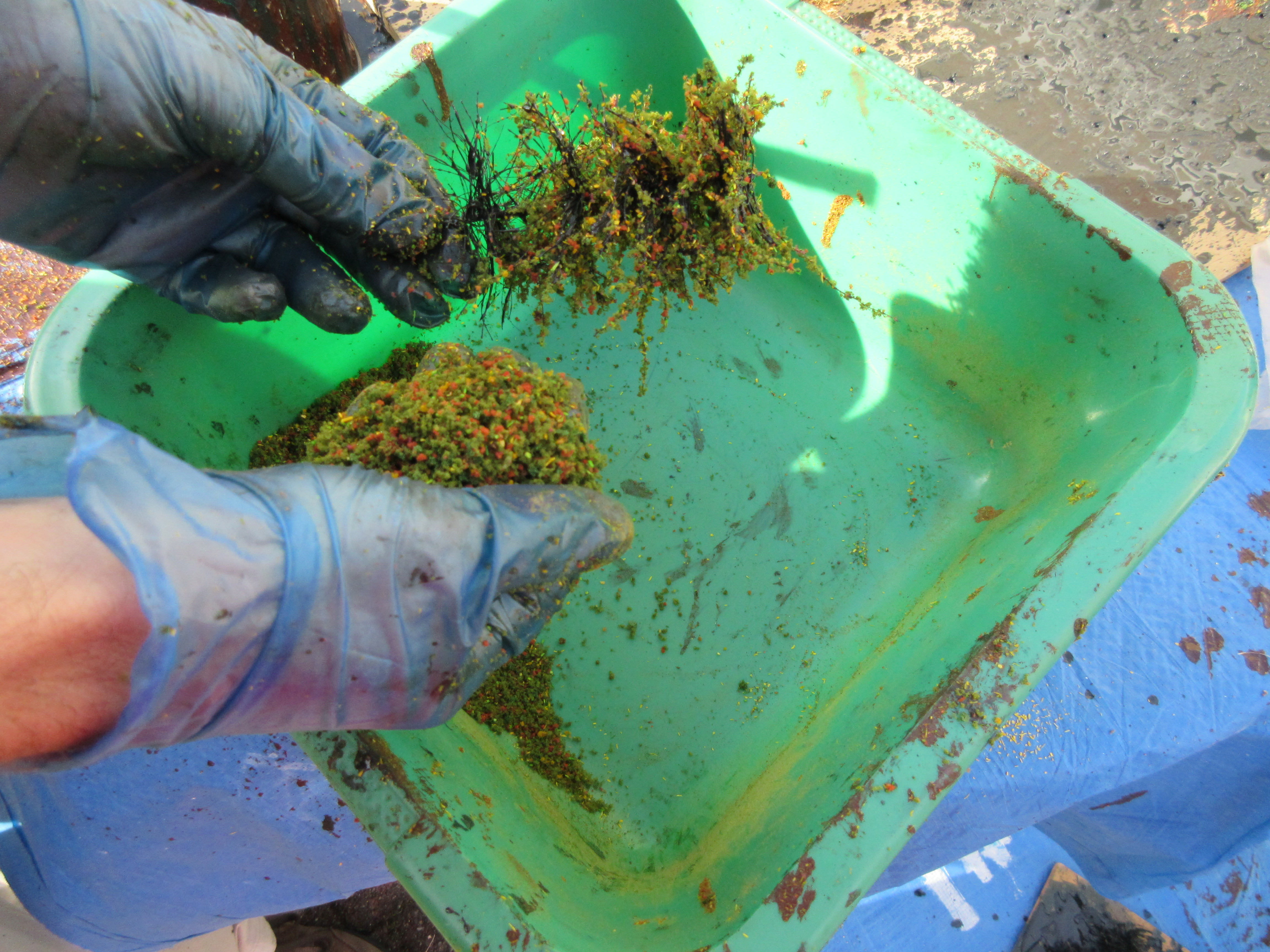

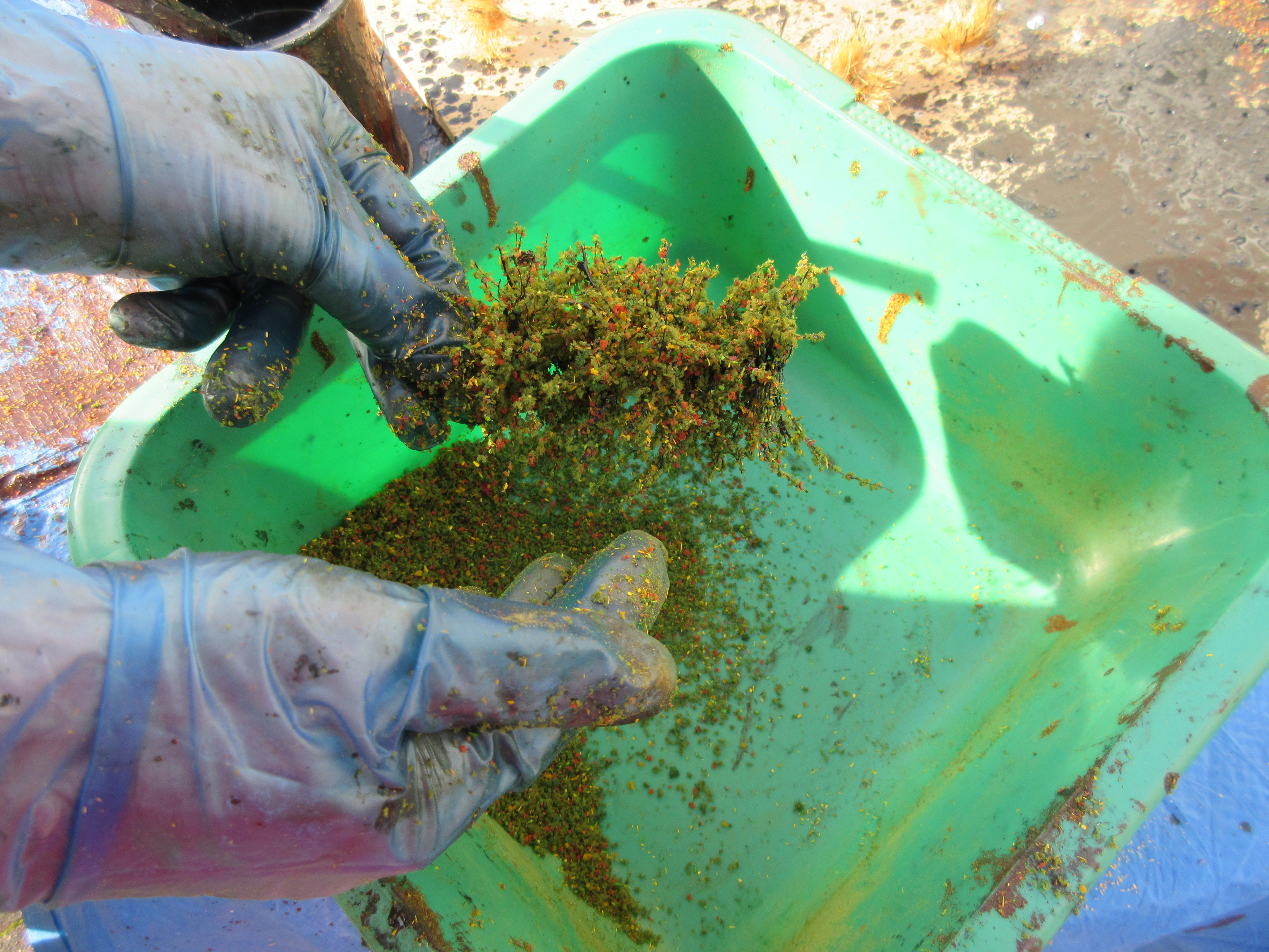

Dipping the shrub in turpentine-based paint.                                                                     The sprinkling of the shrub with a mixture of grits from the model train shop.

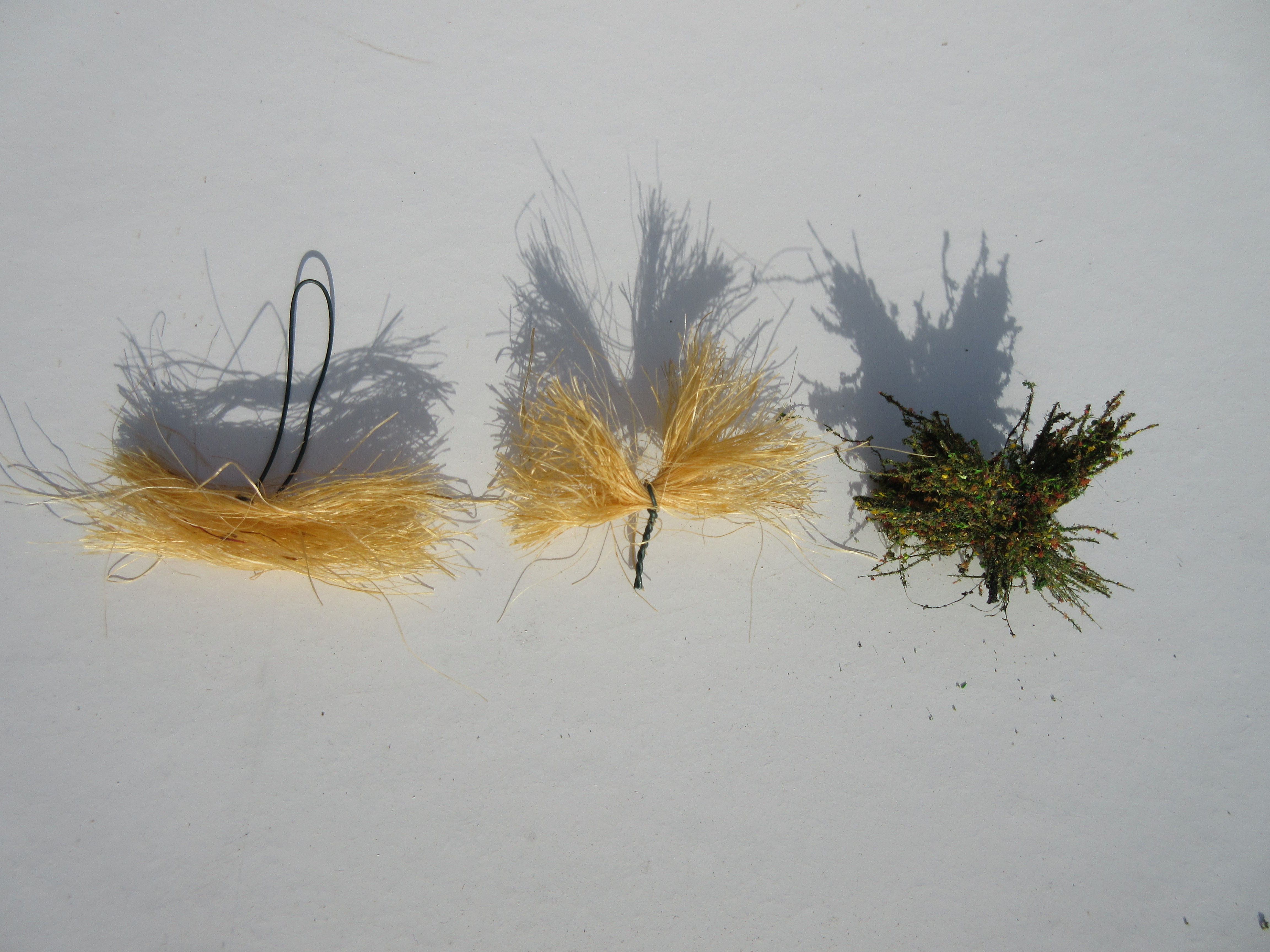

Shaking off the excess grit from the shrub.                                                                          Three steps how to make small shrubs.

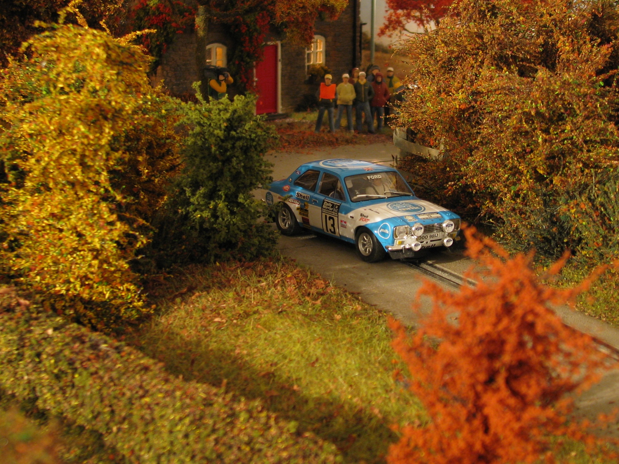

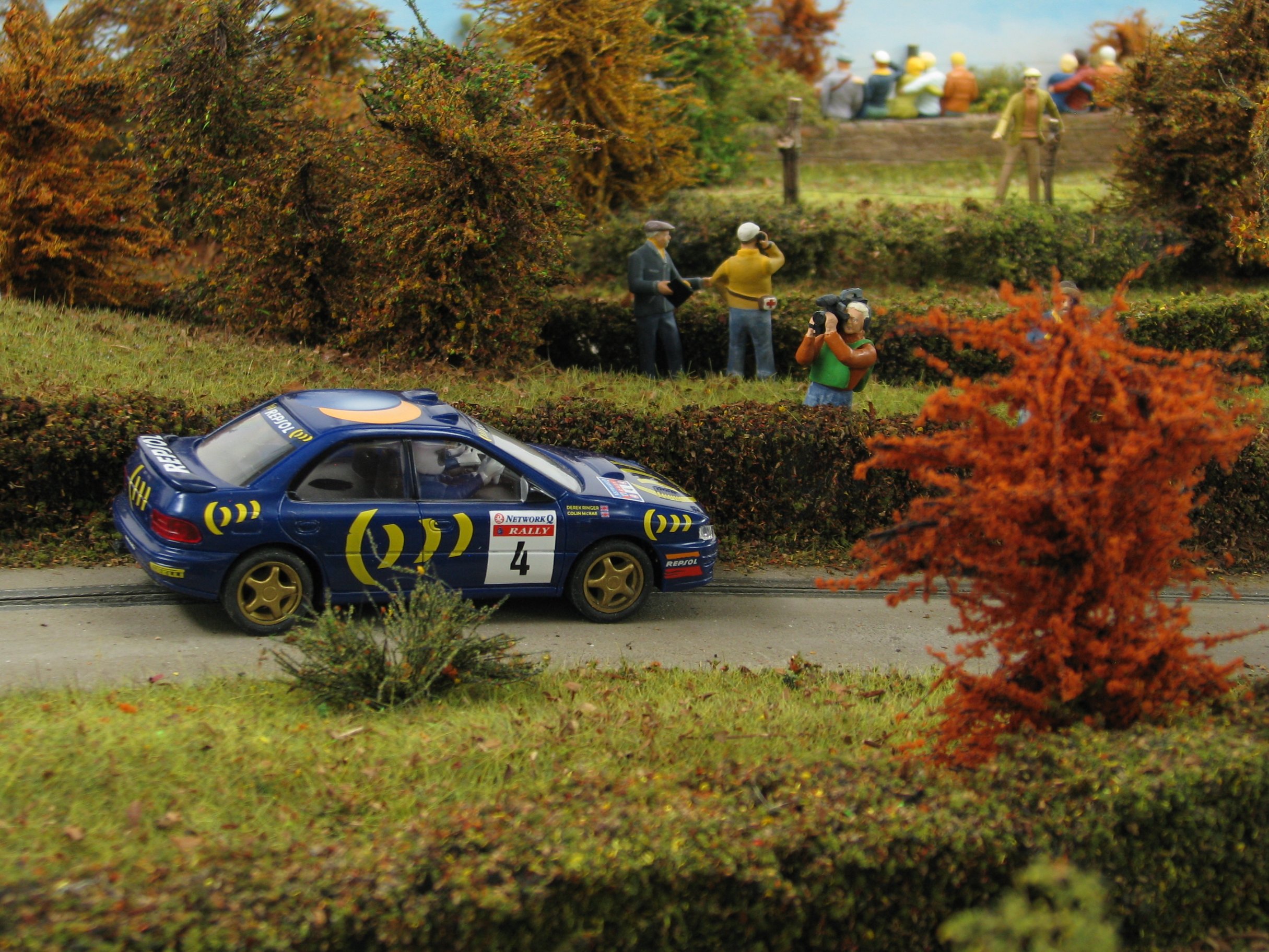

The result on the track. A small shrub in front of the Impreza.                                     A combination of different coloured shrubs.

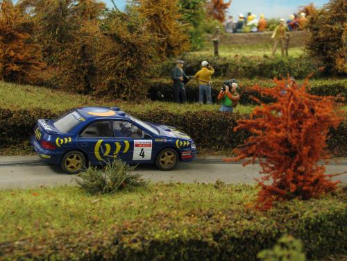

[+] 8 members Like rallyhub's post

2 questions hub:  Why turpentine paint- I assume to dip and then sprinkle foliage? not after foliage is on surely?
Then you talk about wall glue/paint - do you mean the glue used for wall paper?
#37
Hi Anthony,
Correct. First the shrub is dipped into the paint.
After letting it drip out, it's sprinkled with a mixture of grits from the model train shop.
Turpentine paint is thinner than latex/wall paint and good to dilute (with turpentine). It keeps the details of the branches better visible after the dipping and prevents clumping of the whole shrub.
I am talking about "wall paint", as you can see under the second photo of my copper wire trees.
Hub Thumbup
