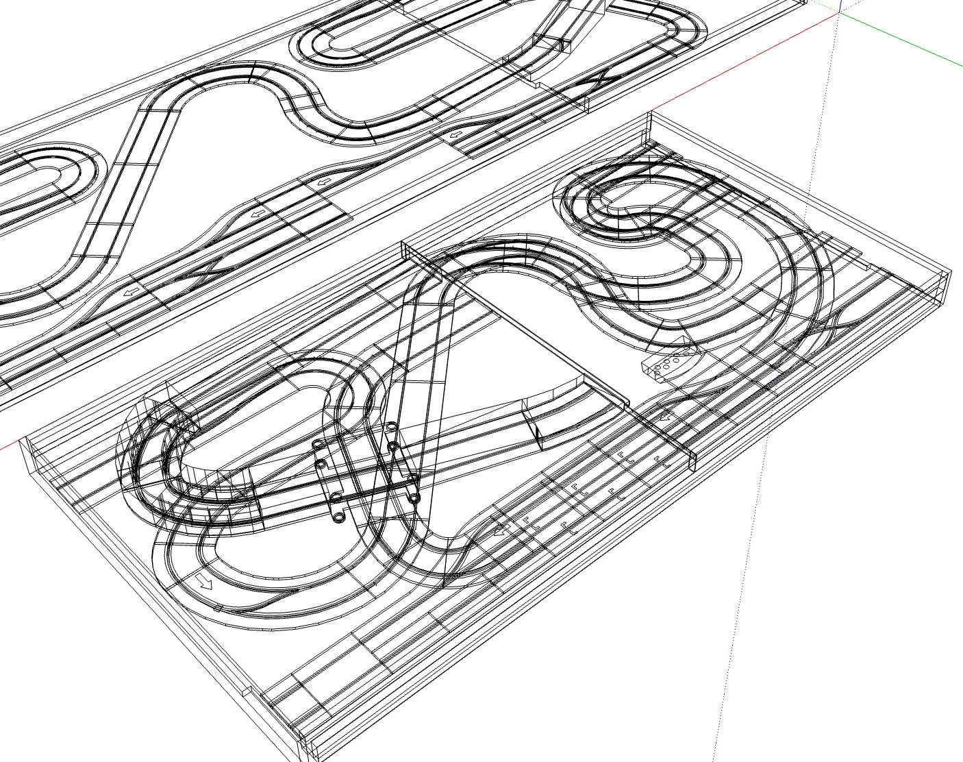

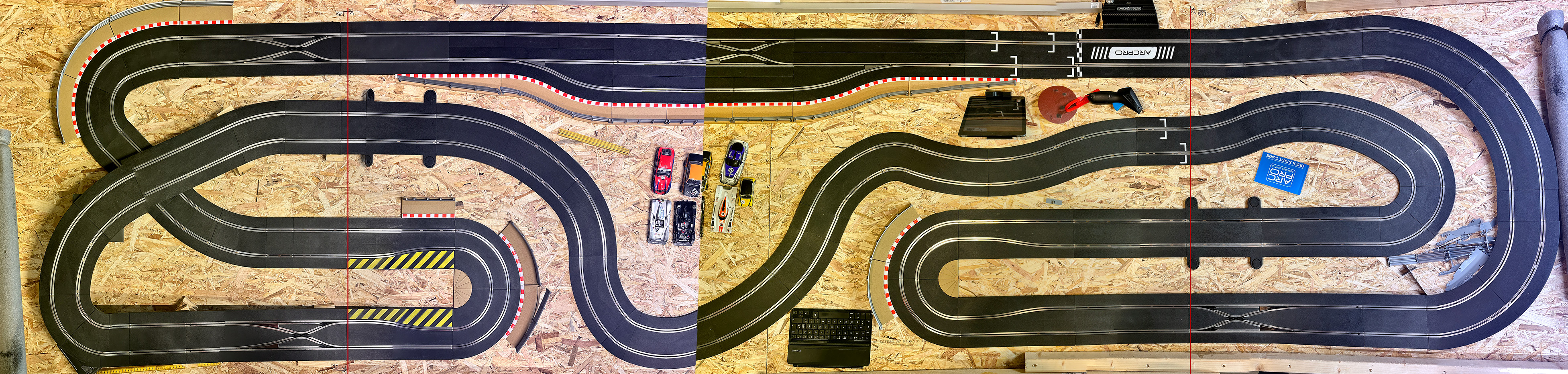

First post for me. I have been planning this track for a long time and I have been collecting parts for a long time. I recently managed to finally find a 2nd hand ArcPro for about €200 including lots of track pieces and three worn out F1 cars. So now I am getting ready to make this finally happen for real! I've attached in progress image of my plan using SketchUp. I have almost all pieces needed apart from the pit lane.
Open for feedback!

It's a nice track design, but personally I would be worried about making a track with no borders, or run off areas.
Hello nicolasw - great track Thumbup
Like Jason, I think having ample run-off for cars to slide out on corners is important - the easiest option is the Scalextric borders. Even running cars with traction magnets, the rear will slide - running with magnets removed, the run-off is absolutely essential.

Thanks a lot for the welcome and the feedback! (It's niklas not nicolas :) Run off space I am hoping to counter with proper fencing around the track. The plan is to create a track that can be folded up and hang vertically on the wall when not in use ;-P Don't know if it makes any sense but I attached an image of it folded up.

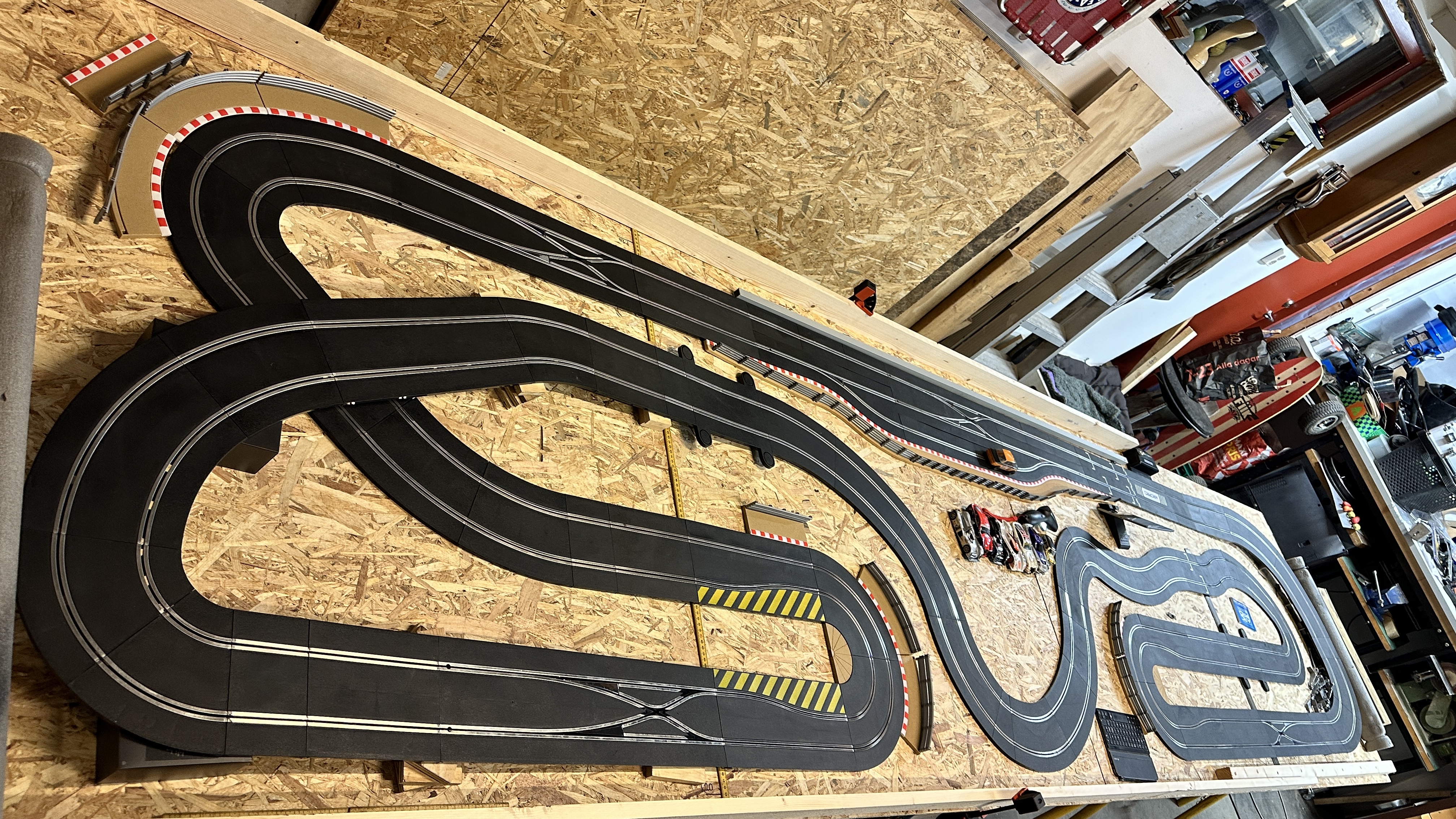

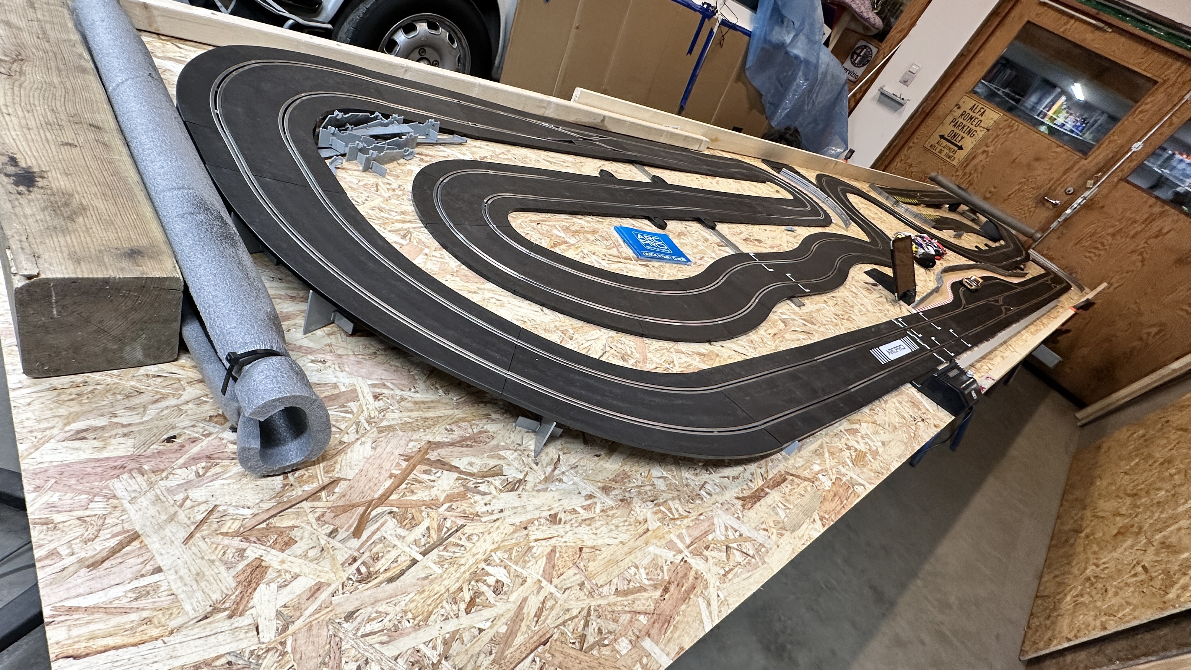

Current status. Proof of concept build. Will be adding pit stop, som more lane changers and banked curves :)

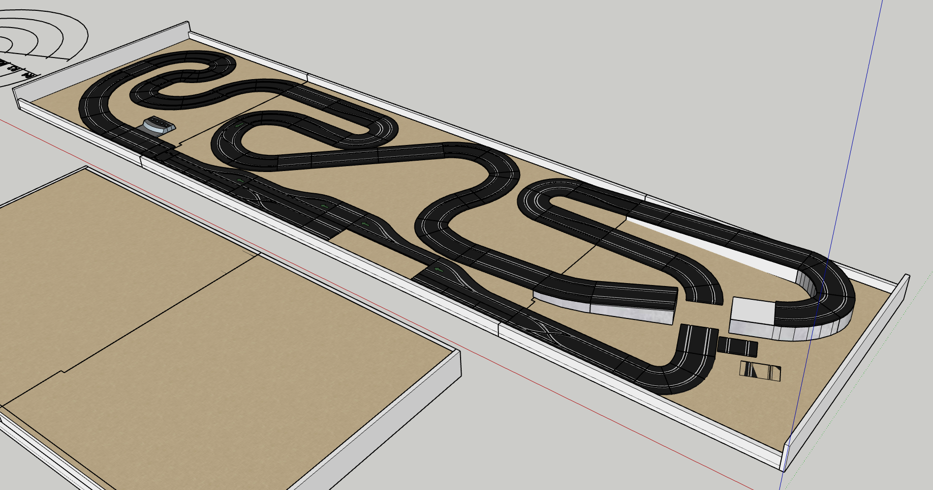

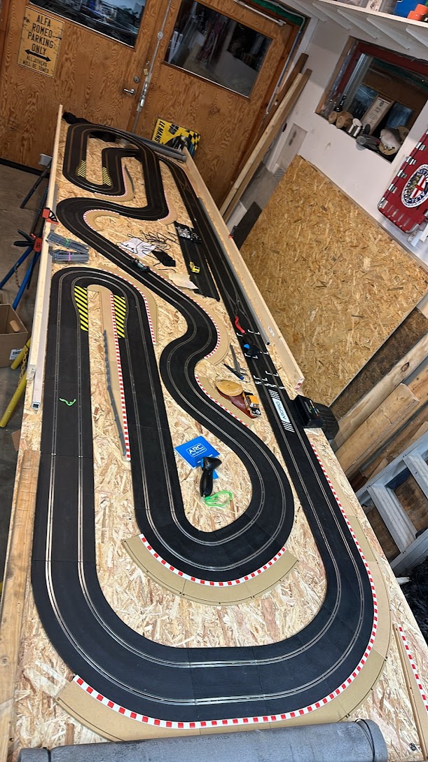

Final layout finsihed! Not sure what I should do in regards to rumble strips going forward. I know I want them but not sure if I will use Scalextric original or create my own in scenery creation process  Sun
A big challenge has been to fit it within the 1200x2400mm while also having one long straight with a proper pit area, a banked curve, a technical section that feels organic all that while also being able to divide it along the red lines for folding away when not in use.
But I am very happy with this - really fun to drive!
Oh, and can you spot the workshop dog in the photos? :D

I like that, a good mix and the 'drive by eye' feels better in a clockwise direction.

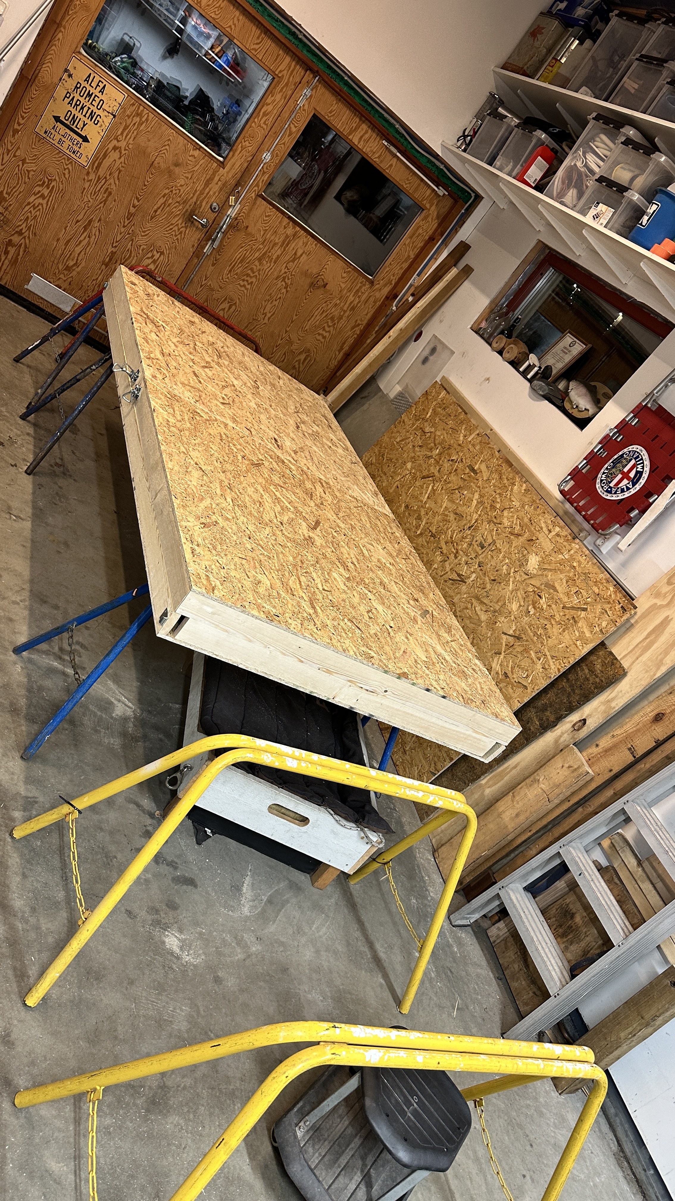

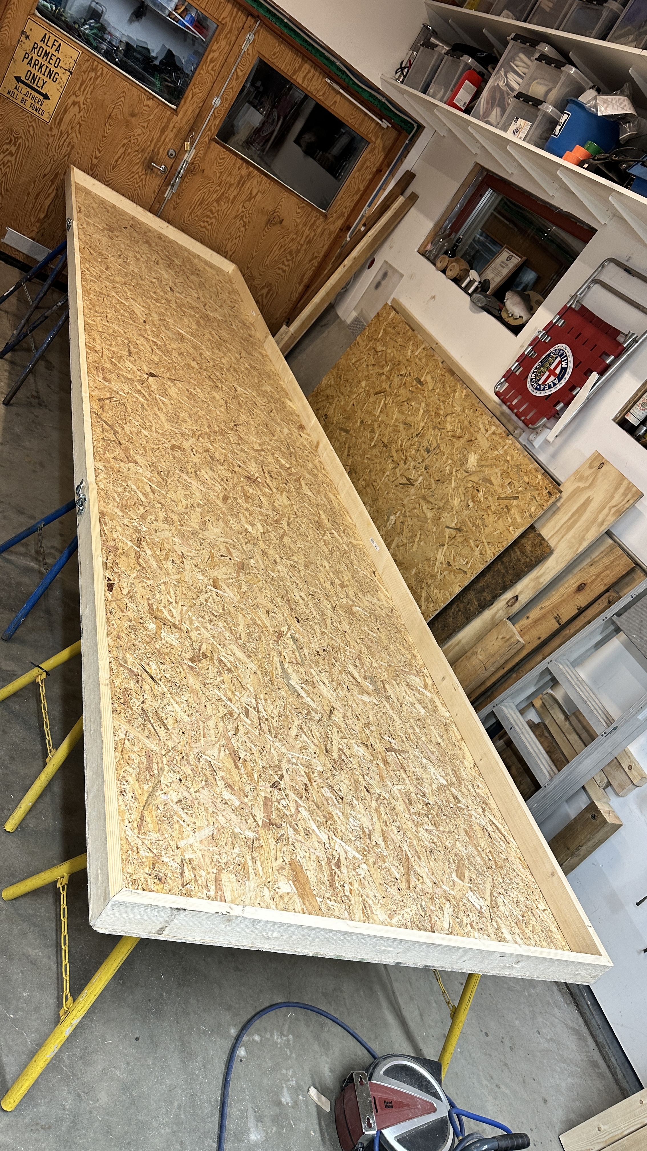

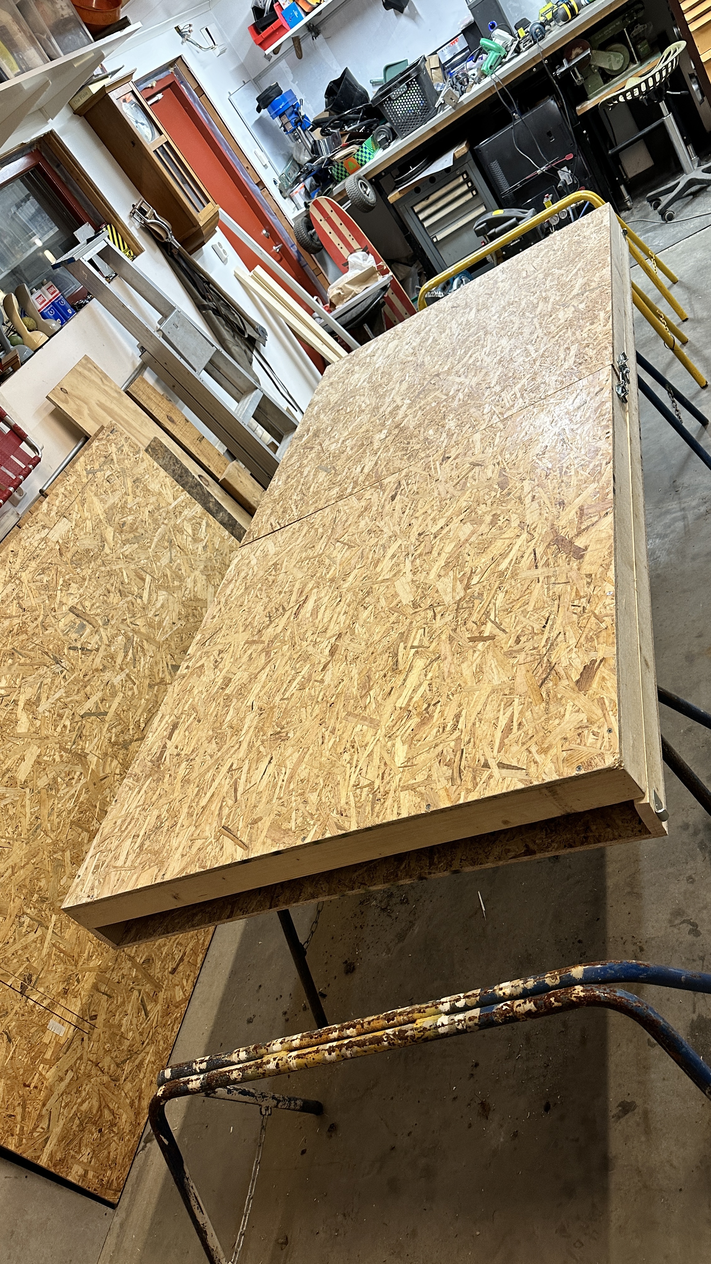

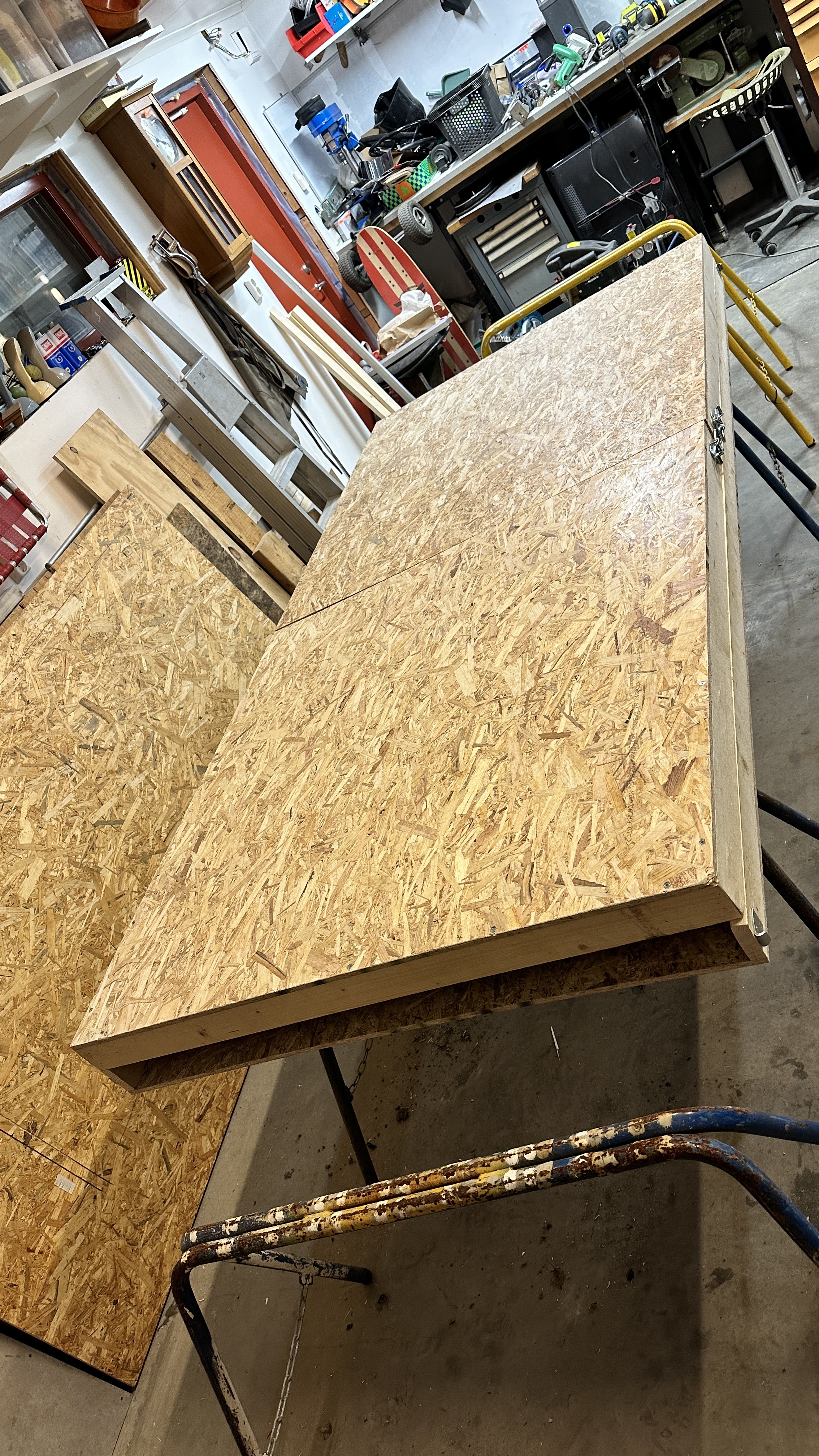

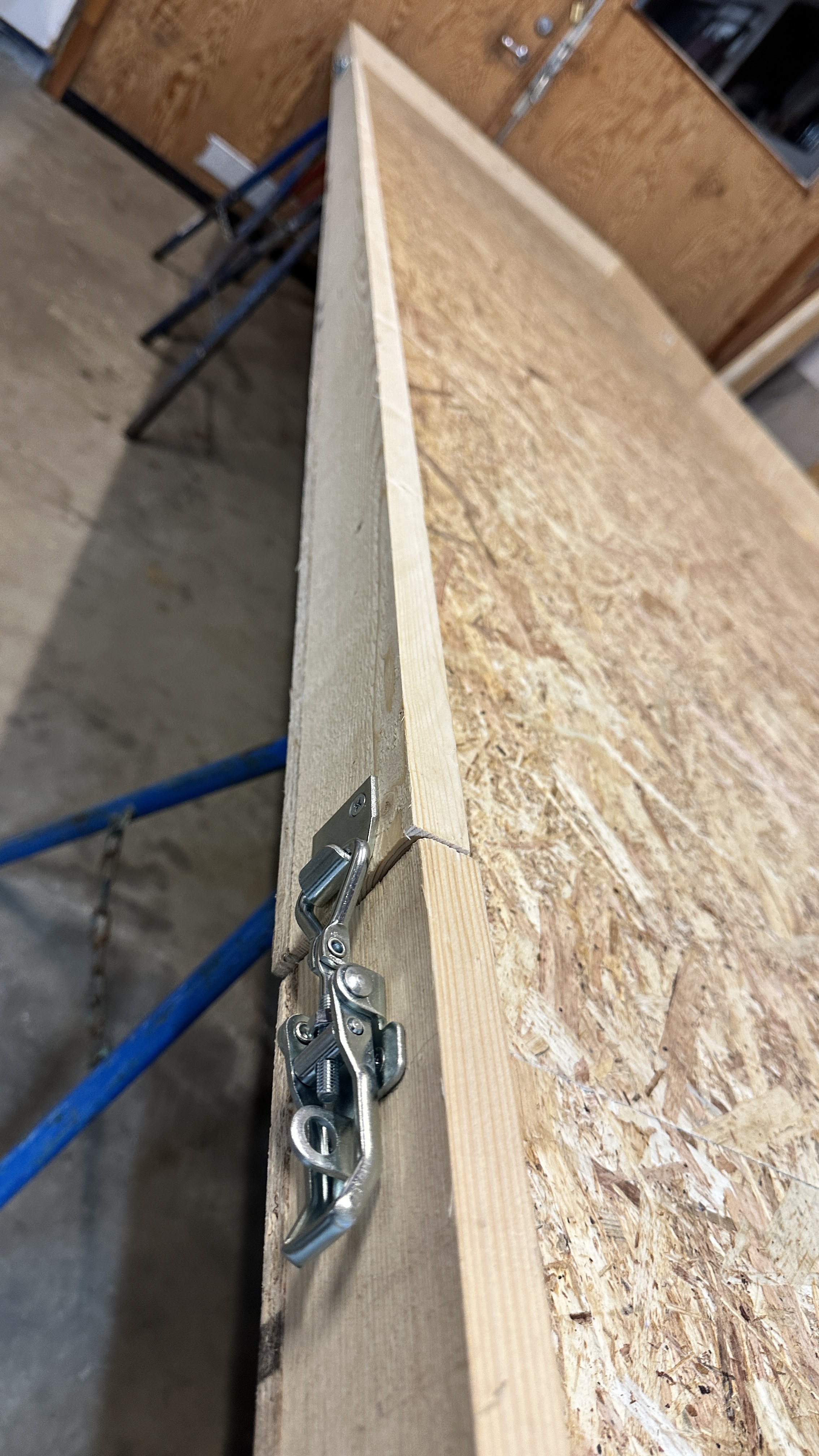

Latest update: Built the actual "box" to hold the whole thing.
