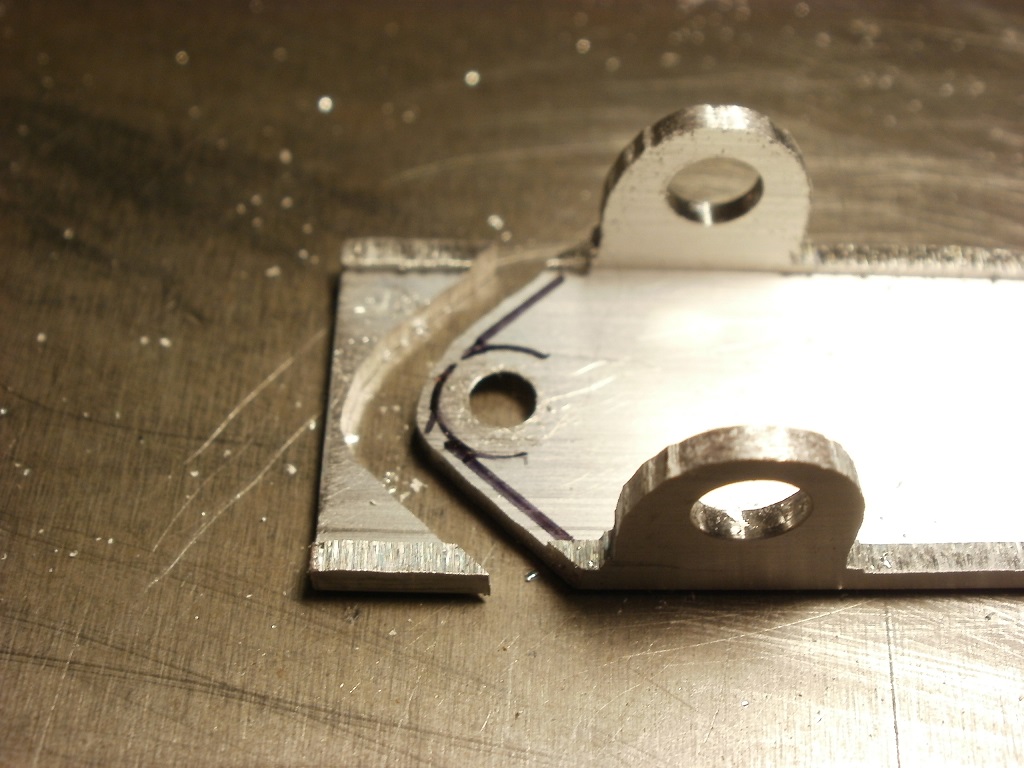

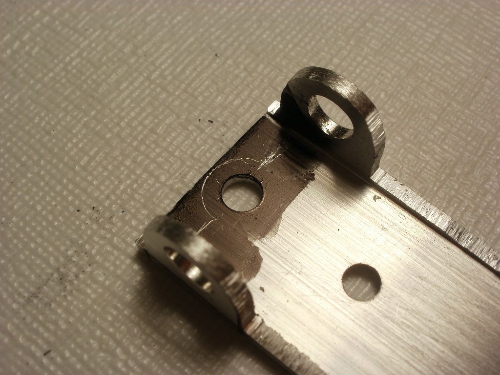

I mark the area around the guide hole with a large permanent marker. Then set my callipers to 1.65mm and scribe a line around the guide hole. This is my safety zone. Cut too close to this line and the chassis is scrap. I've already scrapped several chassis that were 95% finished. Oops.
Take your time with this area. I use a combination of bandsaw for rough cuts, and a quality hand file to finish it off.
