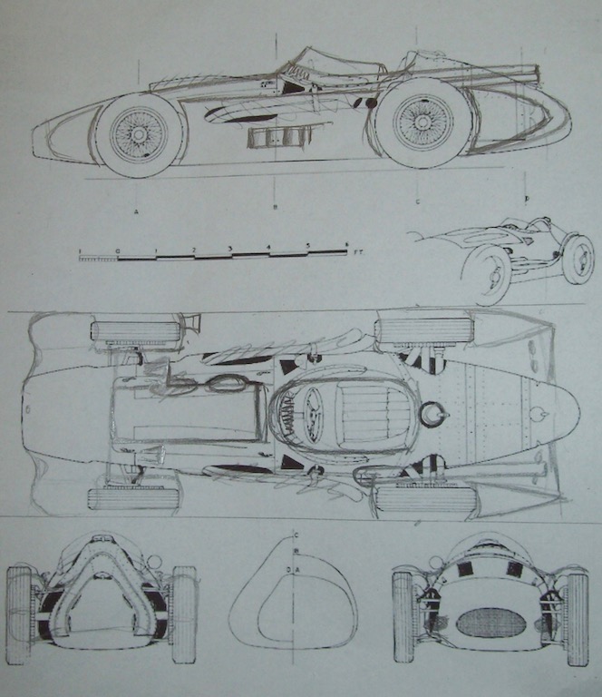

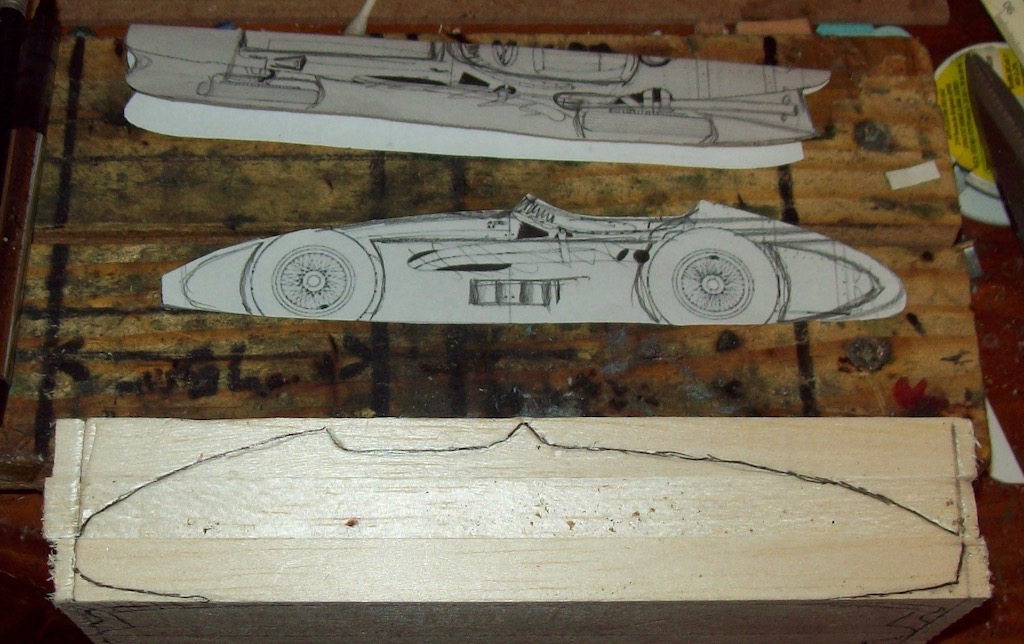

The method will be the same whatever wood is chosen. First, a drawing is needed. I’ve posted quite a few on this forum but there are a few sites around that have them. Some for sale and some free. The free ones are usually low resolution but that doesn’t really matter for our purposes.

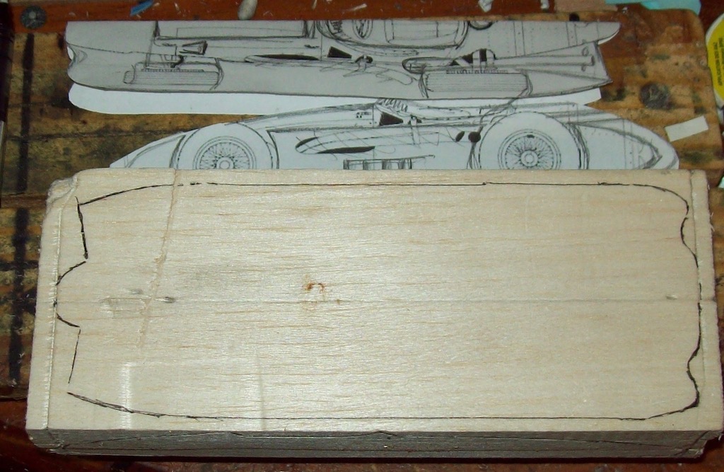

I’ve chosen to do a Maserati Streamliner in 24th scale. No drawing that I could find but as the original is based on the 250F that is a good starting point. The first thing is to make it the right size! Most of the drawings are 32nd scale. I used Adobe InDesign to increase the size and then print out the result. I just drew the streamlined body over the original.

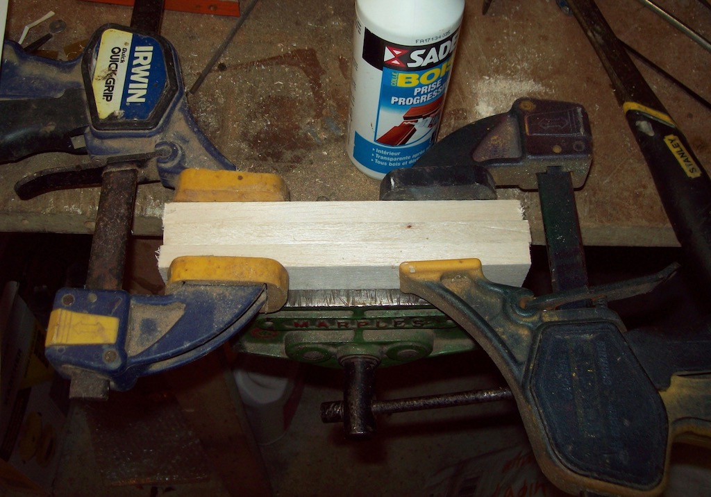

I used PVA woodworking adhesive to join the sheets of balsa. It’s important to clamp the properly as the soft wood can curve and the join wouldn’t be strong.

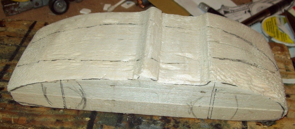

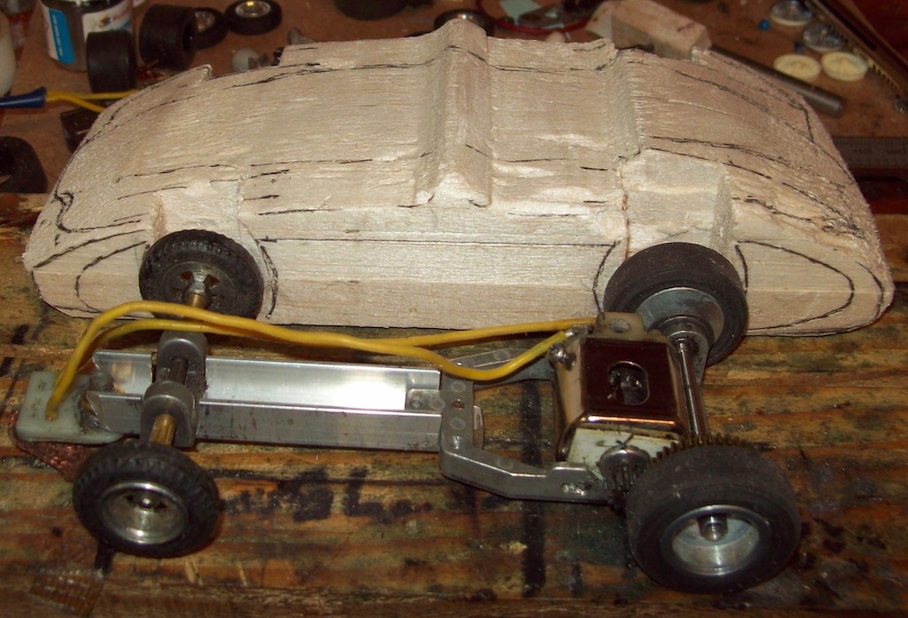

The side and top profiles are cut out and the side outline traced onto the wood. In this case, the size dictated that I use solid wood although it would save material to try and build up the sides separately.

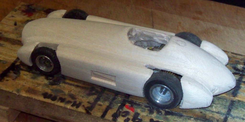

If you have a bandsaw, it’s the easiest way of cutting. Cut just outside the line. Sanding will reduce balsa quite quickly. Once the side shape is done repeat the cutting out for the top profile. Mine isn’t working so this was done with a Japanese pull saw.

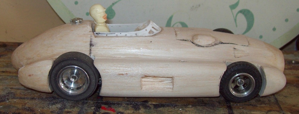

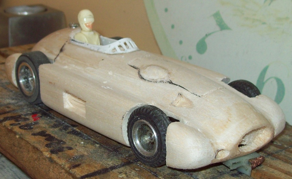

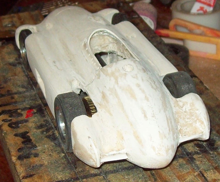

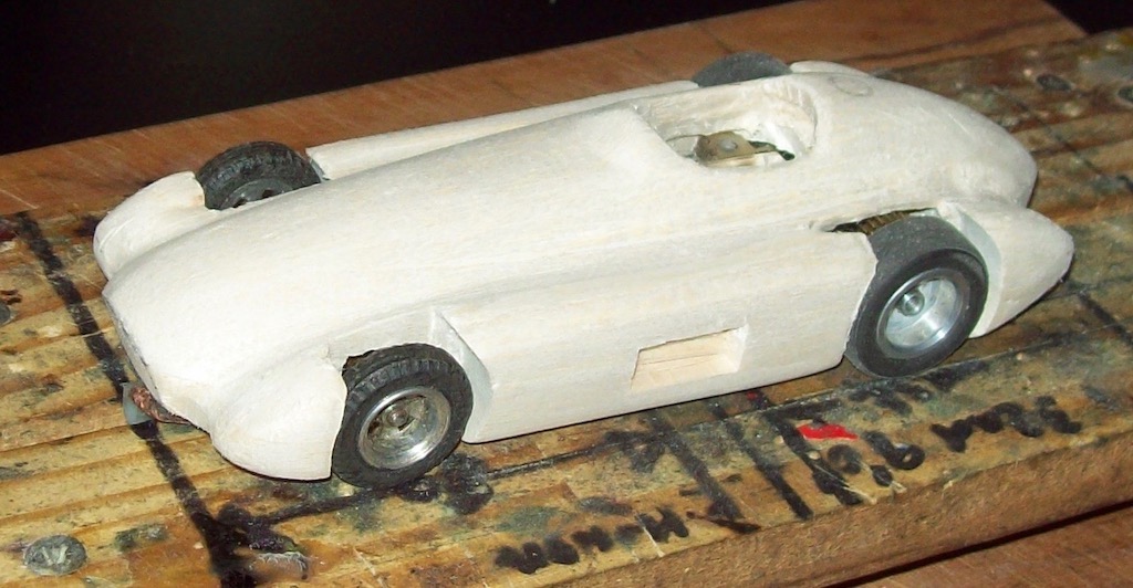

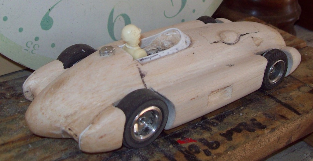

From here on in, you are pretty much on your own as the shape will have to be arrived at by carving and sanding. I use a scalpel, rasp and file. Constant reference to photos is essential. As balsa is so brittle, I insert plasticard where there is likely to be a problem such as the quite thin edges at the rear. Also, the raised lip in front of the cockpit has quite small vents and there is no way that the wood would survive those details. Plasticard is also useful if you want small details such as door handles. It’s very easy to cut a slot and superglue the plastic in. By the way, whenever using plastic, always wet it before using superglue. It will then grab - the same way it grabs the moisture in your skin - and hold much better.

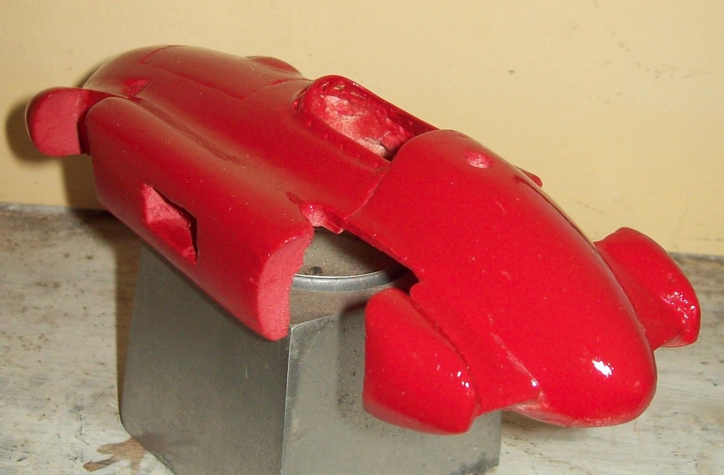

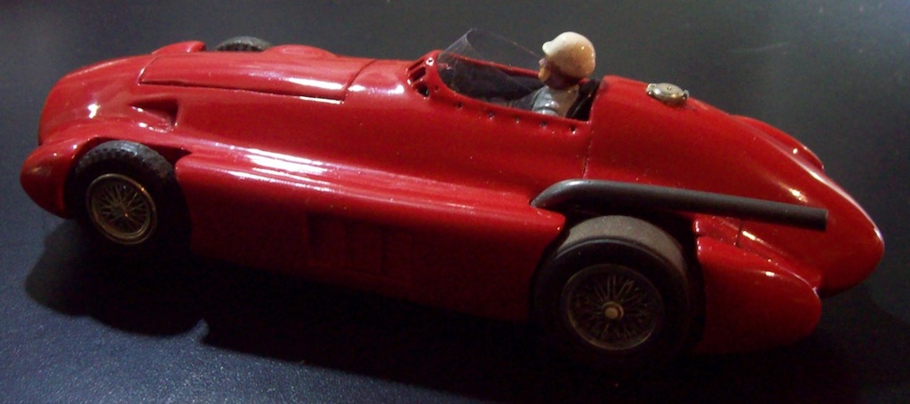

Once you are satisfied with the shape, the car has to be sealed and painted. My method is to soak the balsa in superglue. It goes on reasonably smoothly if you rub it with the tube as you go along.
One thing to be careful of - no two things. The first is that the combination of superglue and balsa gives off fumes. Best not to lean directly over the body as you put the glue on. It also gives off heat and, although very unlikely, it could catch fire so just keep an eye on it.

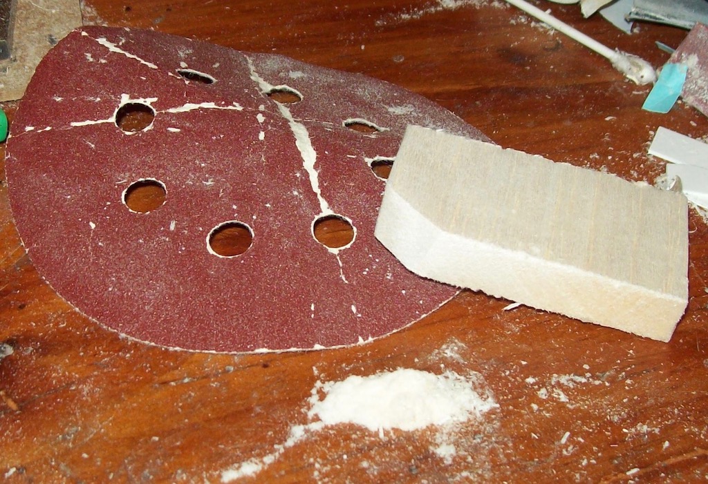

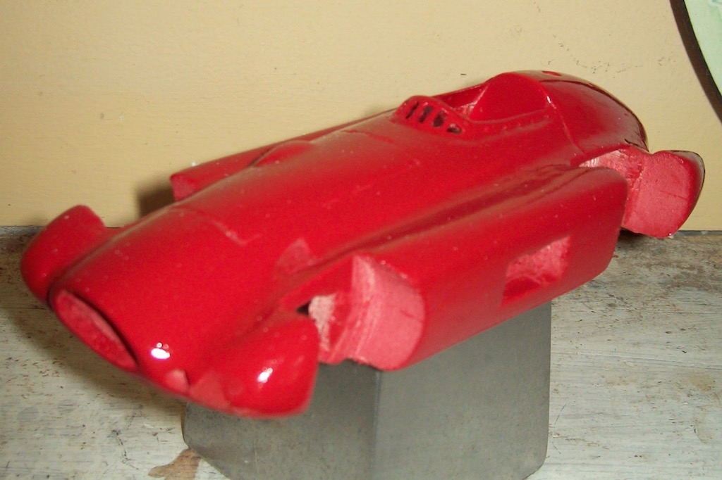

Next, it’s all rubbed smooth and will look horrendous and patchy. I use 120 grade for the first sand. Another coat of glue, rubbed down again and then a first coat of colour. This will show up every imperfection. Any deep ones will need filler. Two sorts I use. The quick way is to sand some balsa - end grain on, it cuts quicker - and use the dust as filler. Drop some superglue onto the hole and drop some sawdust over it. It will go solid immediately. Then be very careful with the sanding as that patch of filler will be harder the the surrounding surface and it will be easy to lower that too much. A slower and safer method is to use Milliput. I lack patience and find waiting for it to cure rather a pain.

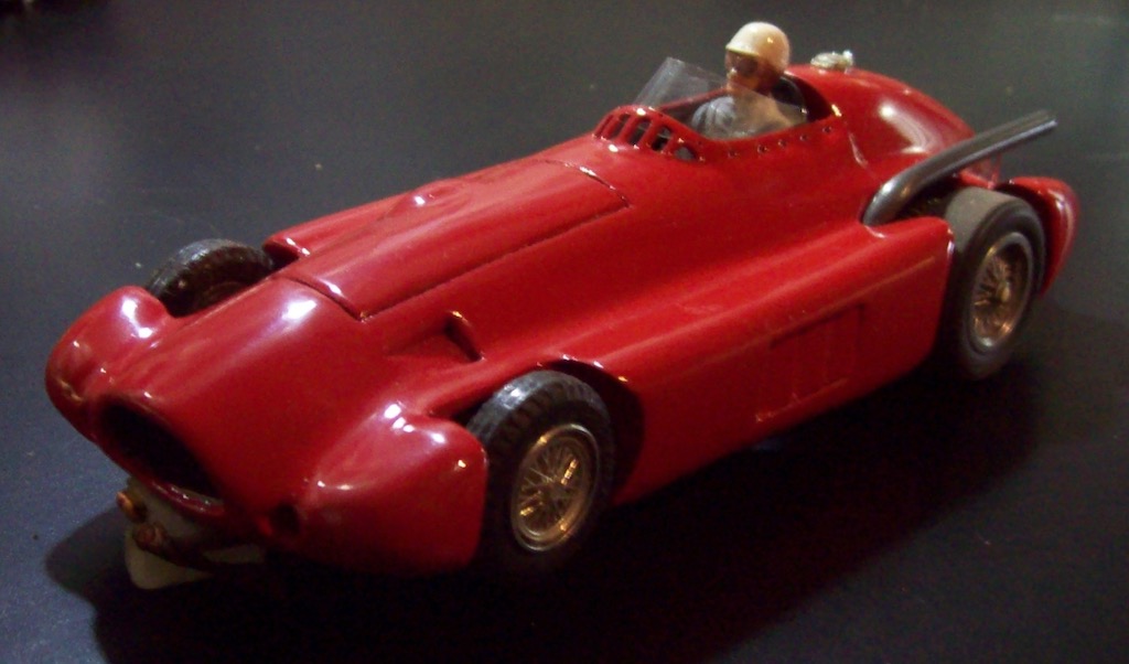

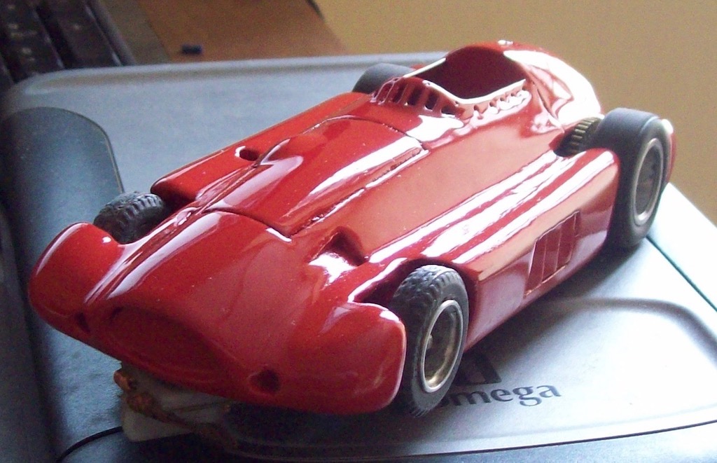

Most people will want to use an undercoat but, being a cheapskate, I use cheap paint cans from our local builder’s merchant and just rub away until it’s smooth.

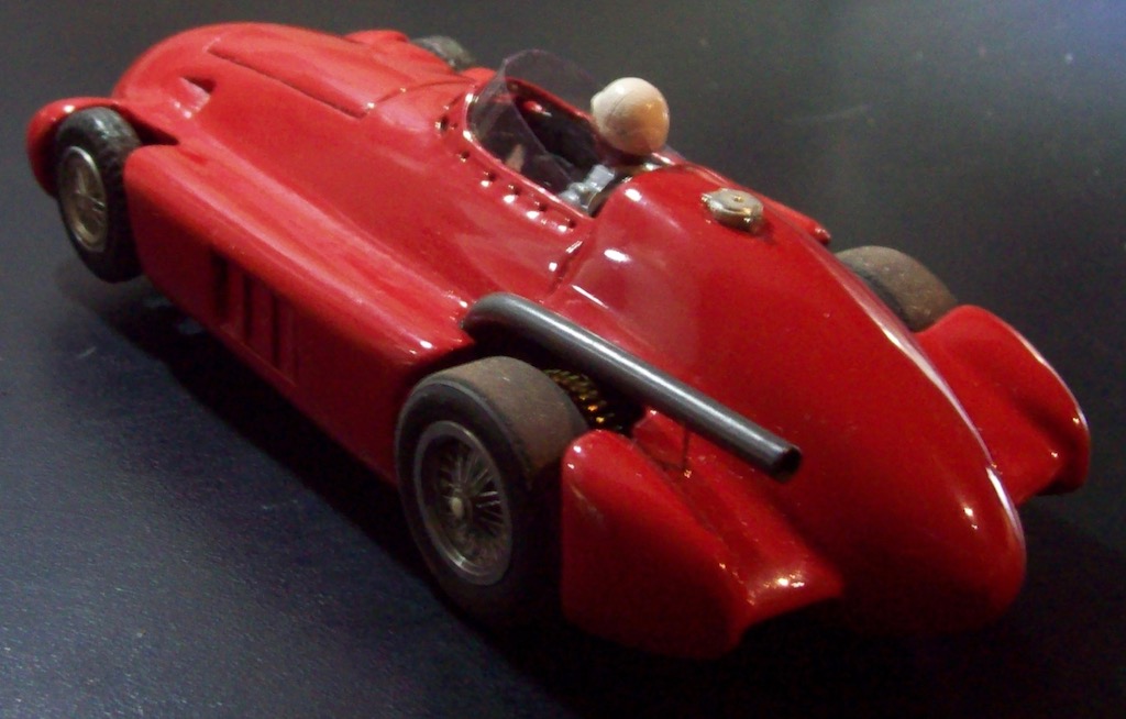

Once the surfaces are smooth and flat, then top coats can be applied. I won’t go into that as I’m sure we all have our own ways of achieving a decent finish. My secret is elbow grease.

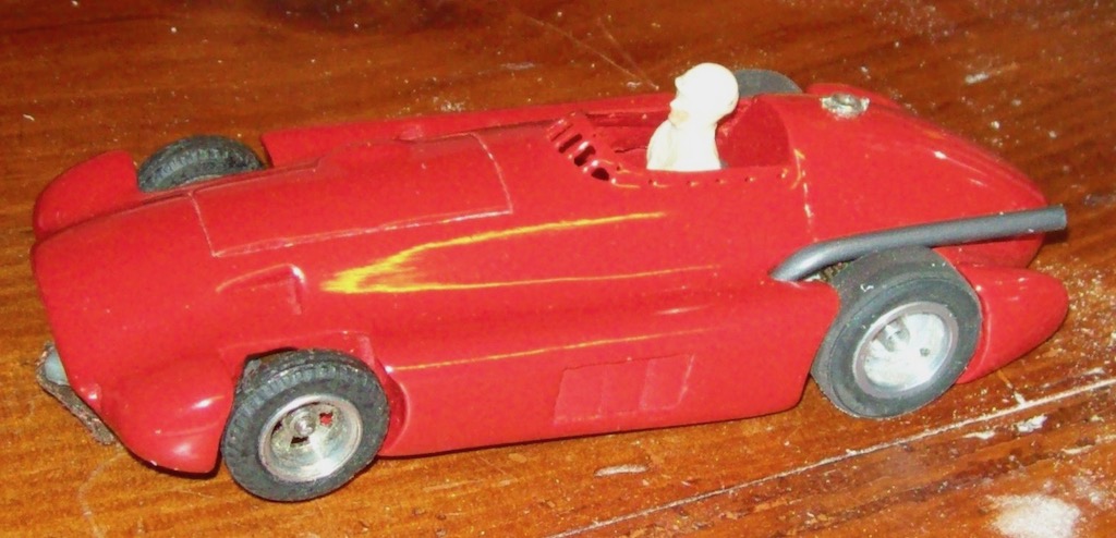

The one thing I always have trouble with is the glazing. Fortunately, on the one, the glass fits inside rather than flush so it was easy just to use some contact adhesive. The glazing in this case was part of the packaging from the contact adhesive!
How you fit the chassis is another subject. Being a woodworker, I use a hardwood block glued in and wood screws.
