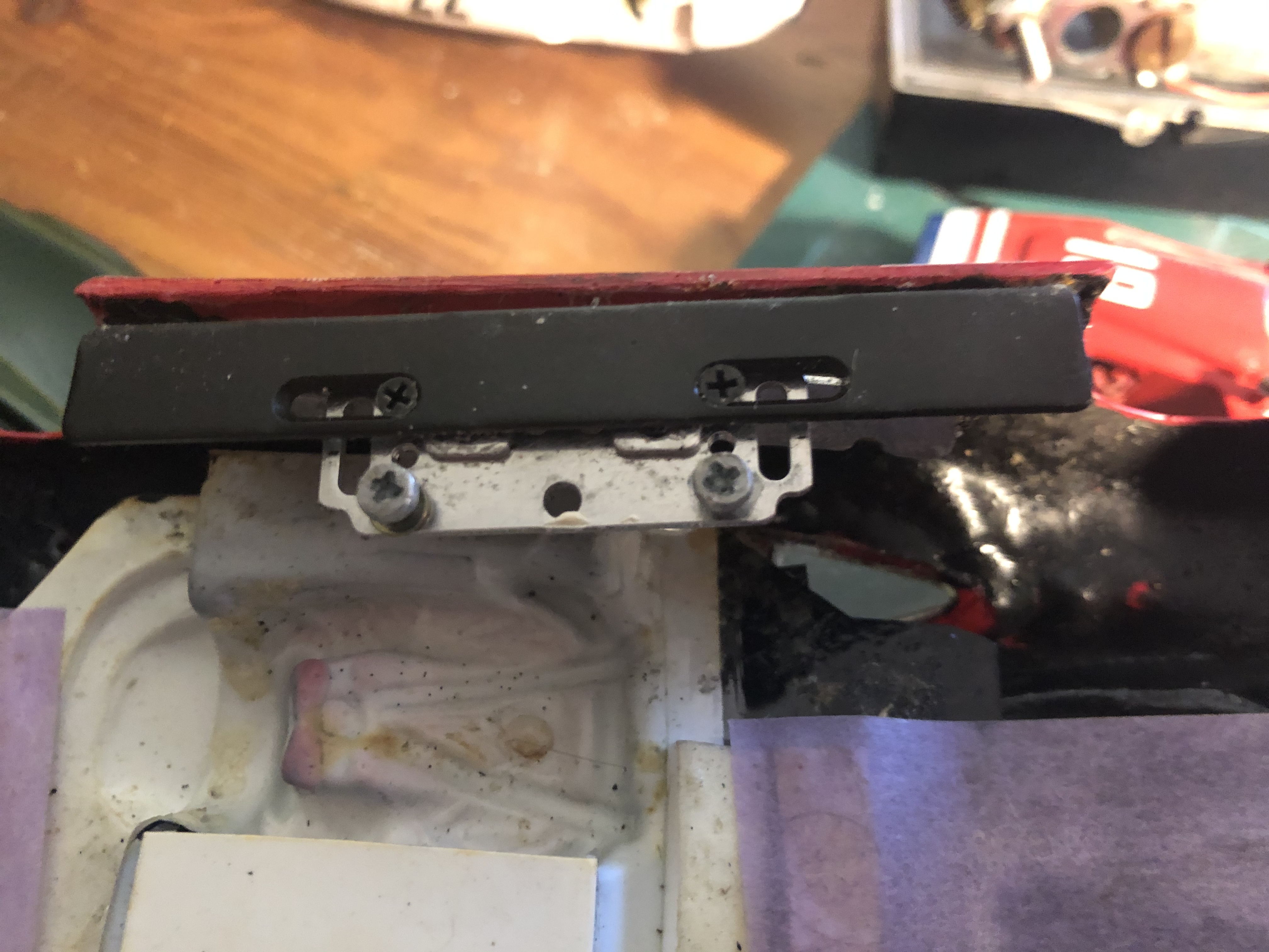

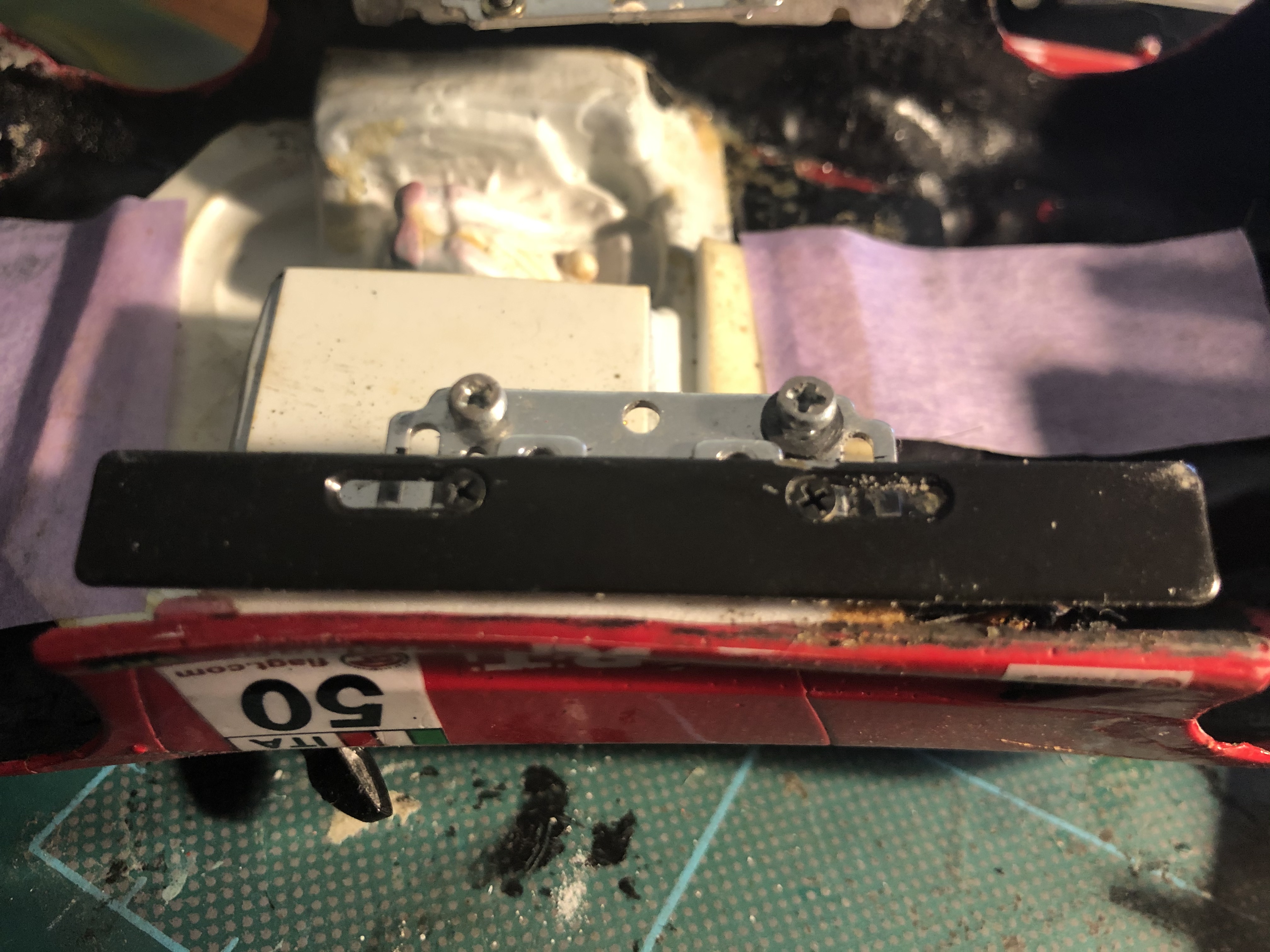

A basic question...how do you attach bodies to them, for example, a Scaleauto GT3 1/32nd scale with 2 central body posts?

Quote:A basic question...how do you attach bodies to them, for example, a Scaleauto GT3 1/32nd scale with 2 central body posts?
You attach a connecting piece to each side of the body, usually connected to a softish piece of foam rubber that you glue to side of body. This then attaches to the chassis with 4 screws. I will take a pic of one I used in the IMCA worlds to show how it is done...

Sorry forgot to come back with pics. Hope they help.
You will see a white line between the metal Attachment and the body. This is a strong double sided tape that holds it to the side of the body. If size allows as has been said you can use foam rubber which will give isolation to the chassis.
