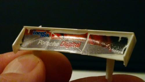

Going to apply some spare decals to the spare rear wing and see how the three different clear coats I bought work.

So I applied some spare decal onto the spare rear wing and applied three different clear coats...
Good news, nothing disintegrated or melted into mush!
Bad news, I cannot tell the difference in finish between Alclad II Aqua Gloss, Klear Kote Gloss or Klear Kote semi-matte.
Has anyone used any of these before? Do you have a favourite?
I love puttering with gears
#53
The Aqua gloss and clear cote gloss should give you the brightest gloss, but you will need to apply/build up several layers before they will start to shine.
The semi matte will be exactly that, semi matte or semi gloss depending on how you look at it, so here the multiple layers are just for "protection".
What I normally do is cover the whole car with the high gloss, advantage Alcladd is that you can apply it by brush and/or airbrush.
I then use a fine brush to tone down the parts that need to be semi matte (window frames, clips, mirrors, antenna's, exhaust tips etc etc)
It's the contrast between the different shines that brings the best out of a good paint & decal job.
For which you have...for your first try....done an excellent job  Thumbup

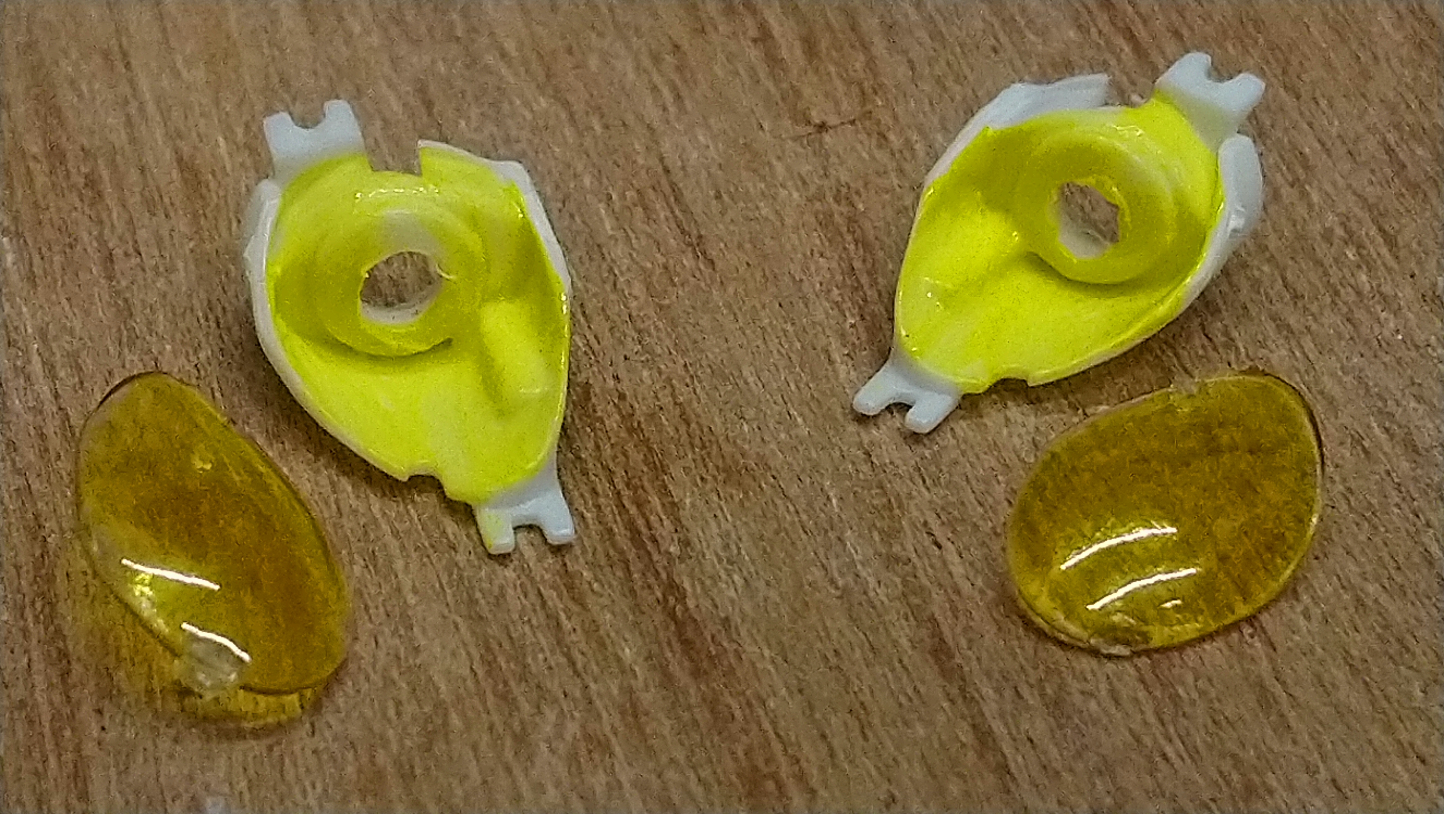

Painted the headlight inners, and coloured the lenses with a pen, for GT class compliance...
Managed to eventually fit the cabin glass (without leaving any gluey fingerprints!) and have prepared the lexan interior for final fitting...
