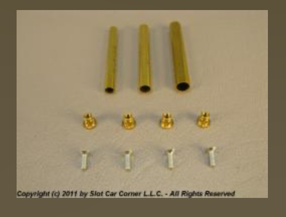

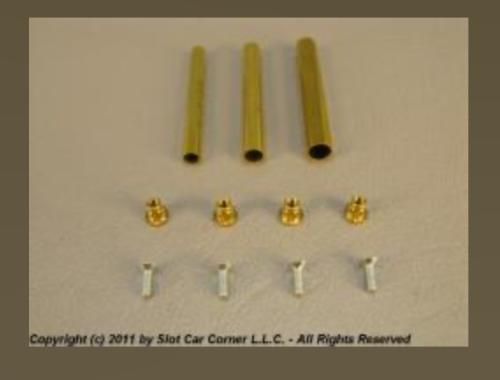

If the post is toast (cracked or stripped beyond hope, Slot Car Corner in the US sells these repair kits. You can easily make your own. Brass tubing to slip over post, flanged, threaded receiving thingie and screws.
