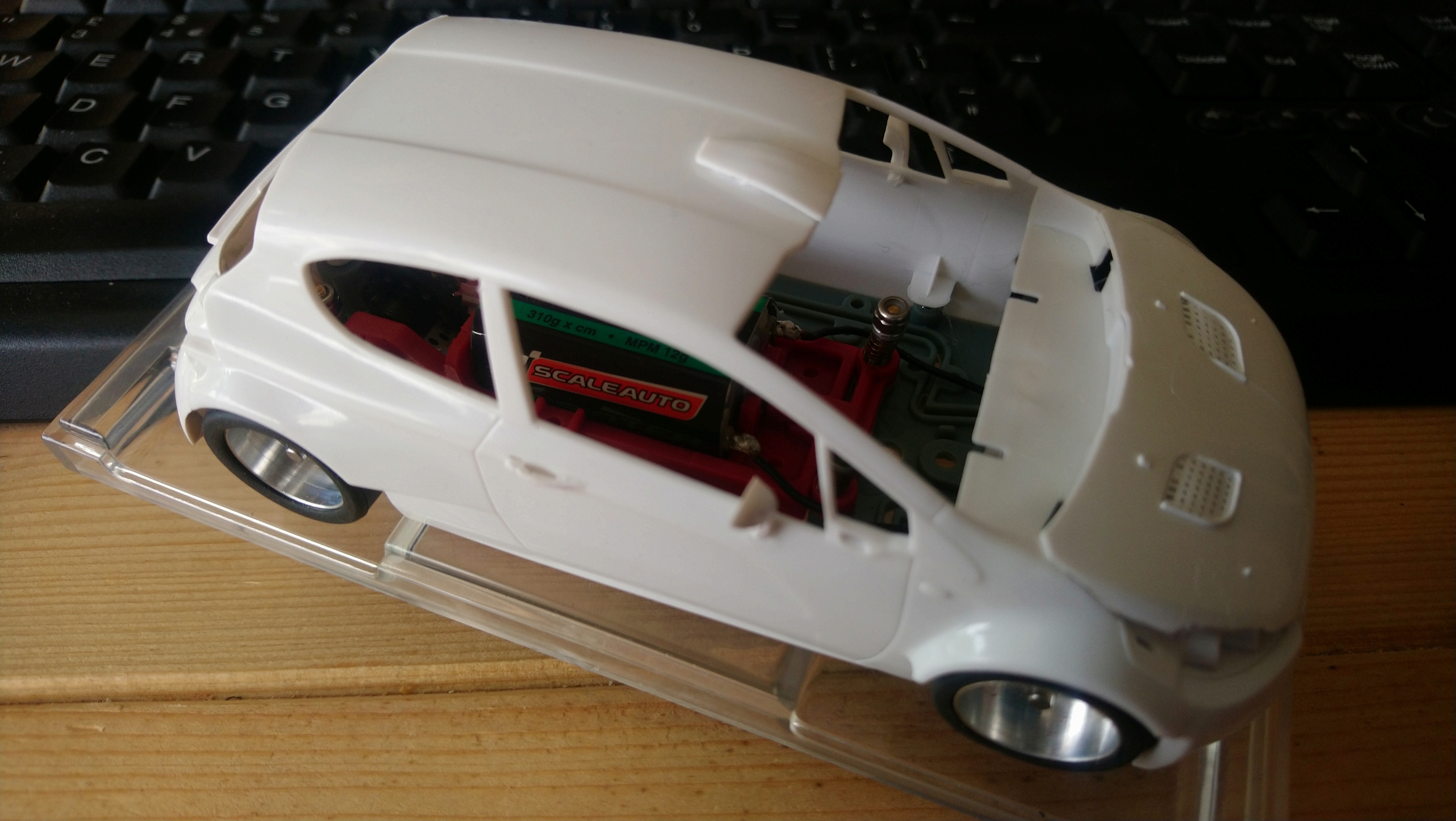

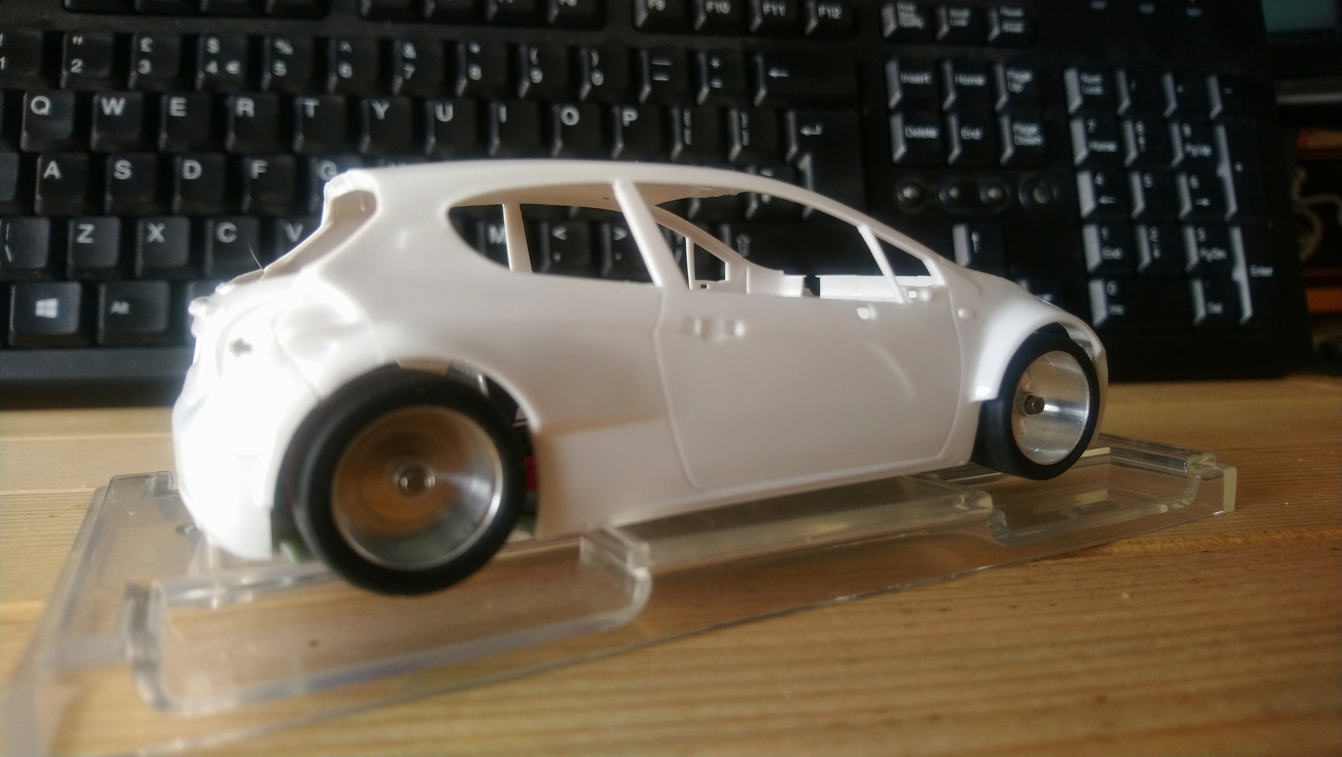

Having asked the question about 4wd vs 2wd on here, and looking at the 4wd set up on the car, I have opted to go with 2wd. So replaced the plastic front wheels with metal, and removed the pulleys and belt. It all seemed very basic, so I thought I would start with what I am familiar with, but maybe add 4wd back at a later date should I feel like experimenting.
Off to Halfords at the weekend for some primer and paint.
Decals are on their way from 'rallye-miniature' in France.
Wheel inserts are going to be borrowed from my Scaleauto Z4 white kit.
Was going to keep the tyres as provided to see how they perform.
Have upgraded to a SRC sprung guide.
Lexan interior sorted.

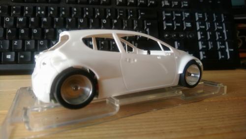

Only 11 pieces of plastic to glue together to get the body shell ready for painting (and that includes door handles and mirrors).
That's my kind of kit!

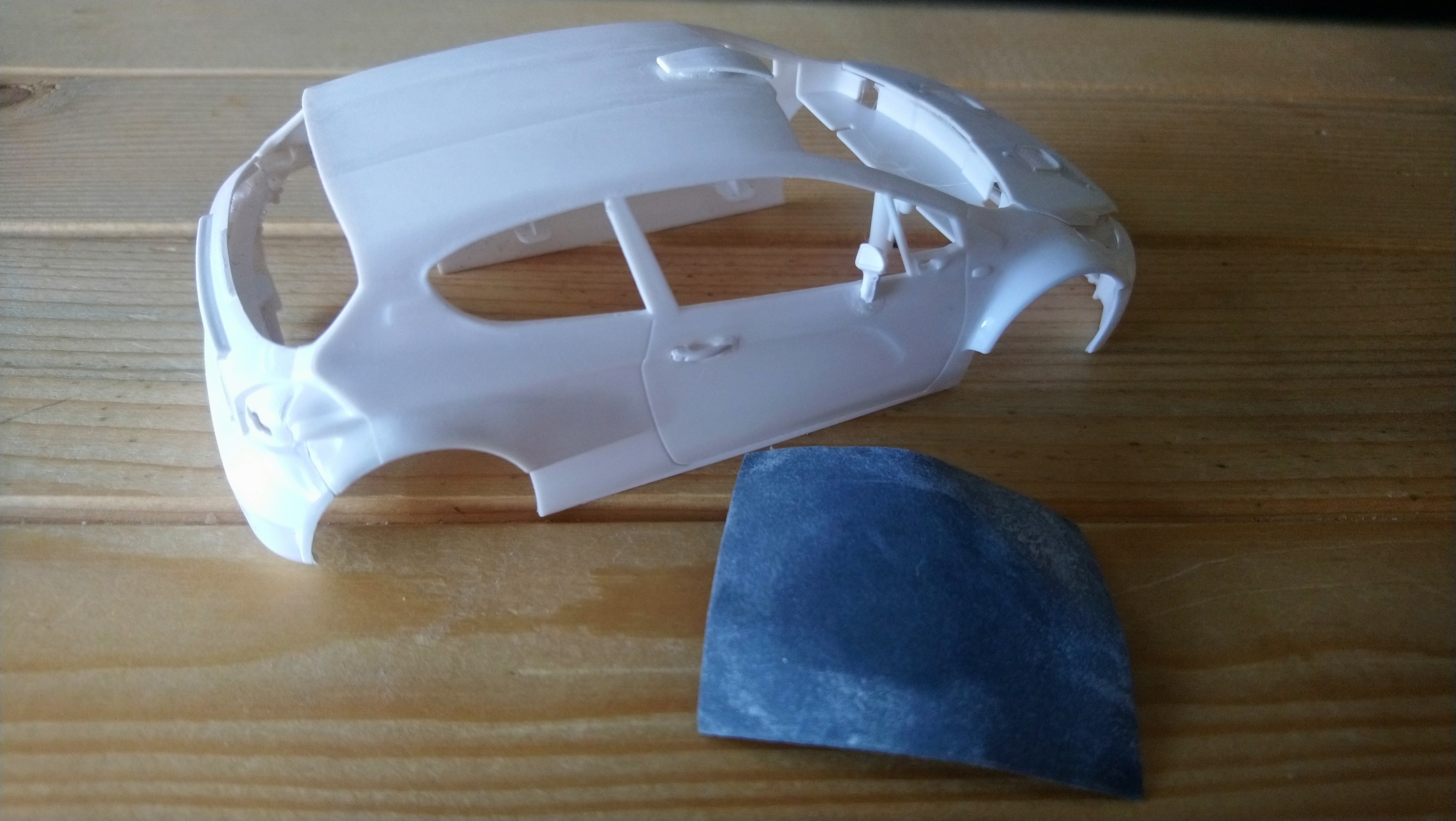

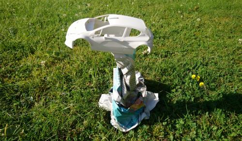

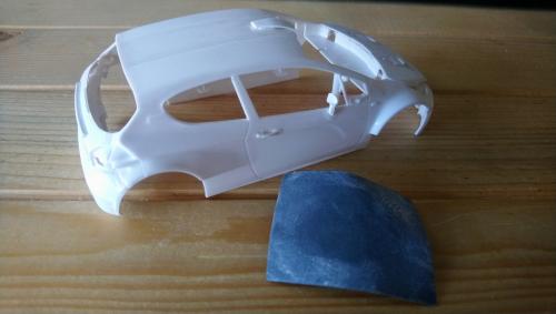

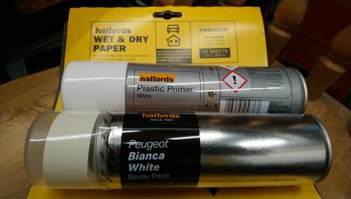

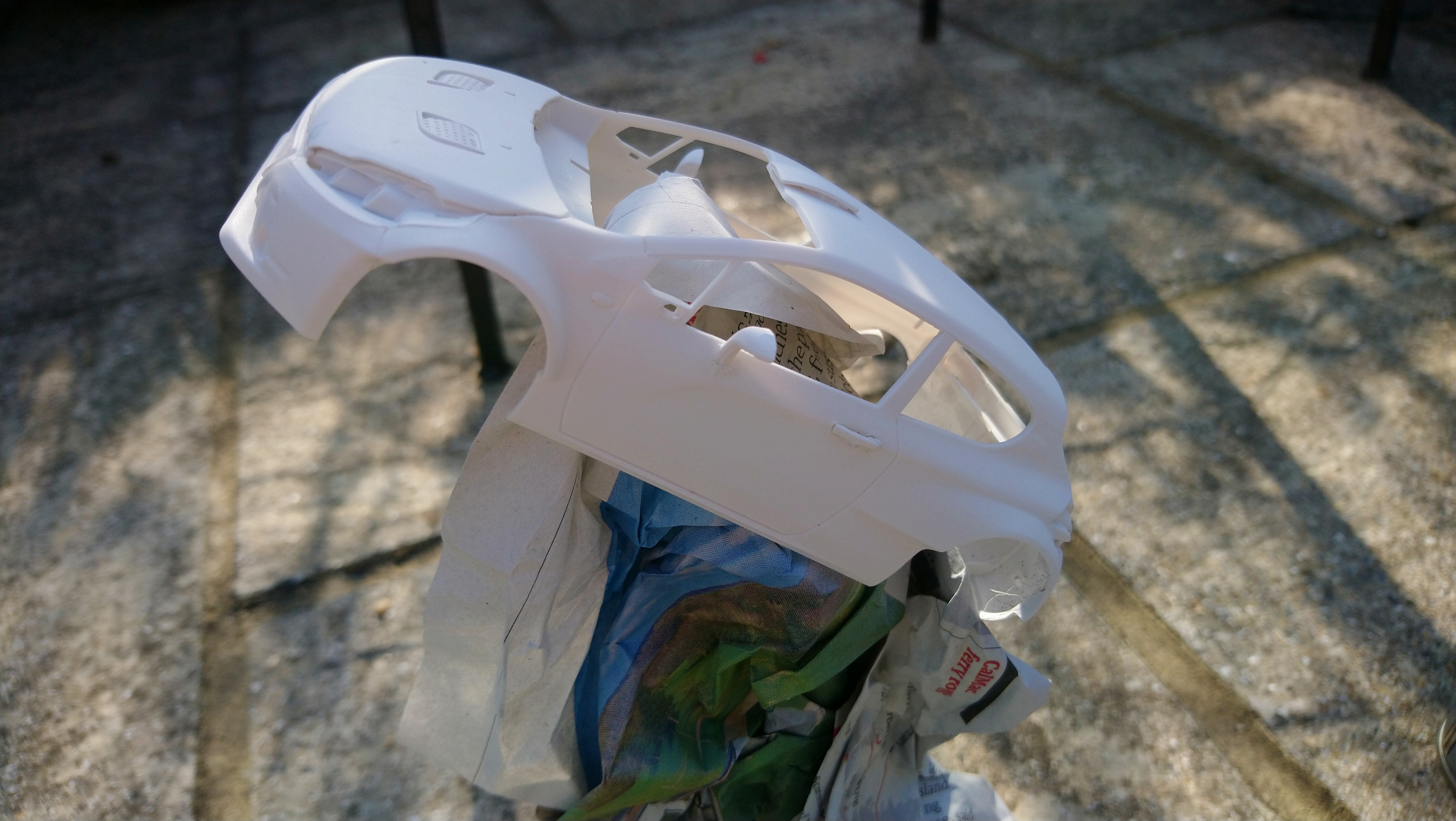

Rubbed down the body with some 800 grit wet and dry to form a key for the primer

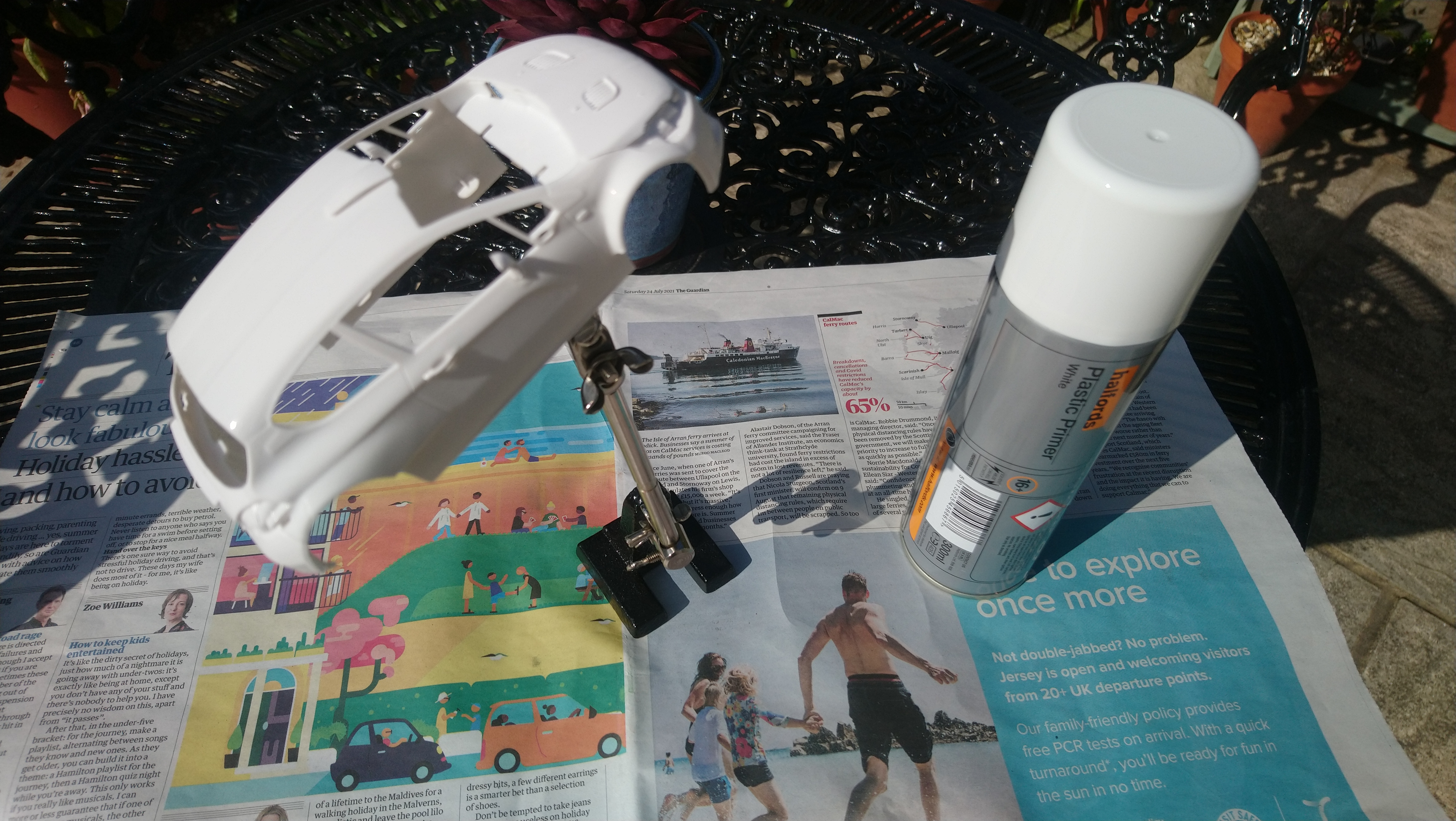

I bought one of these crocodile clip stands in anticipation of using it to hold a body whilst painting it.
Wrapped the stand in newspaper to reduce the paint going on it, held it at arms length and gave the body a first coat of primer.

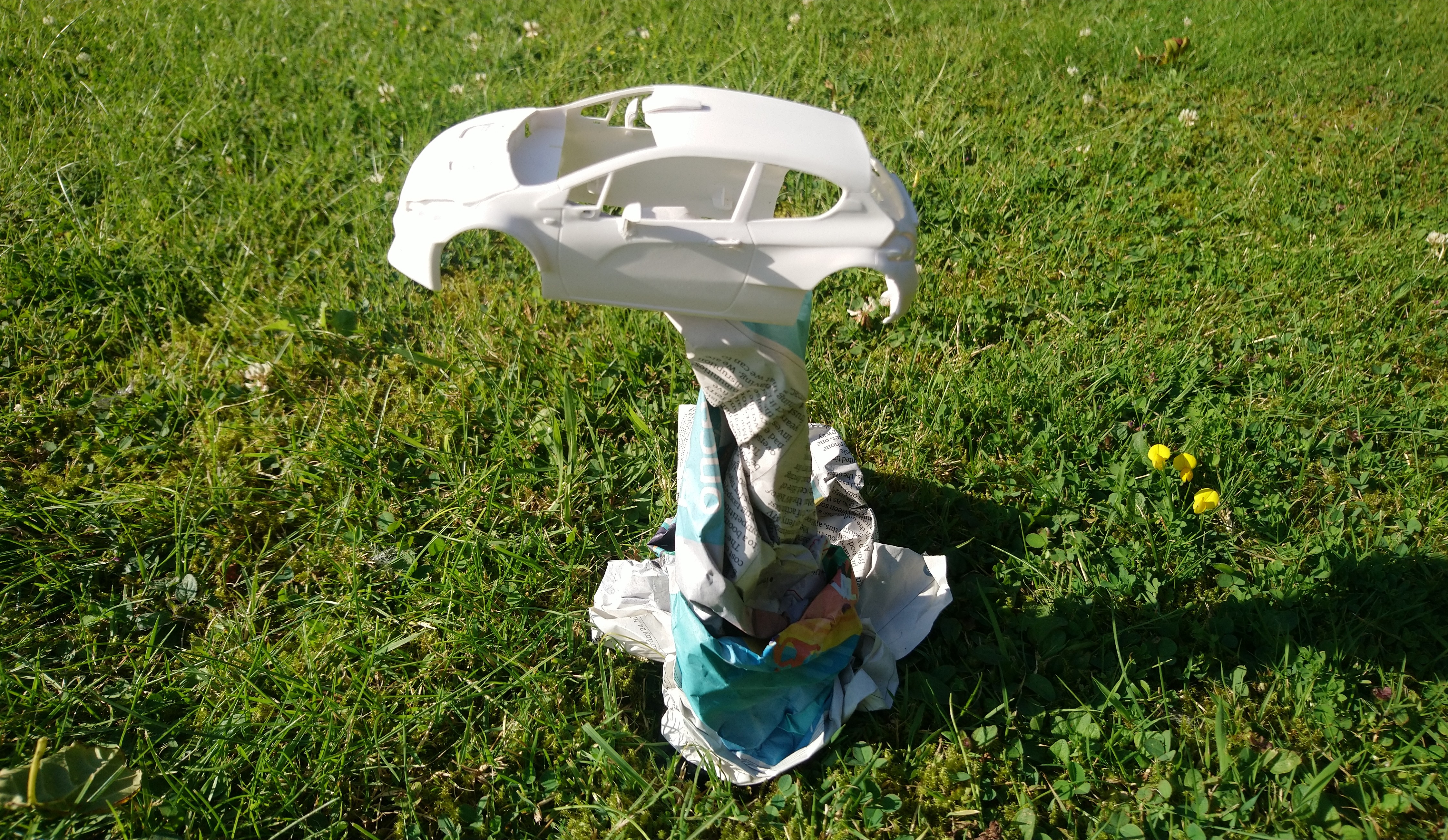

For the second coat of primer, I put the stand on the lawn to avoid getting primer all over my hand...
So now I leave it a day before doing the top coats tomorrow evening.
