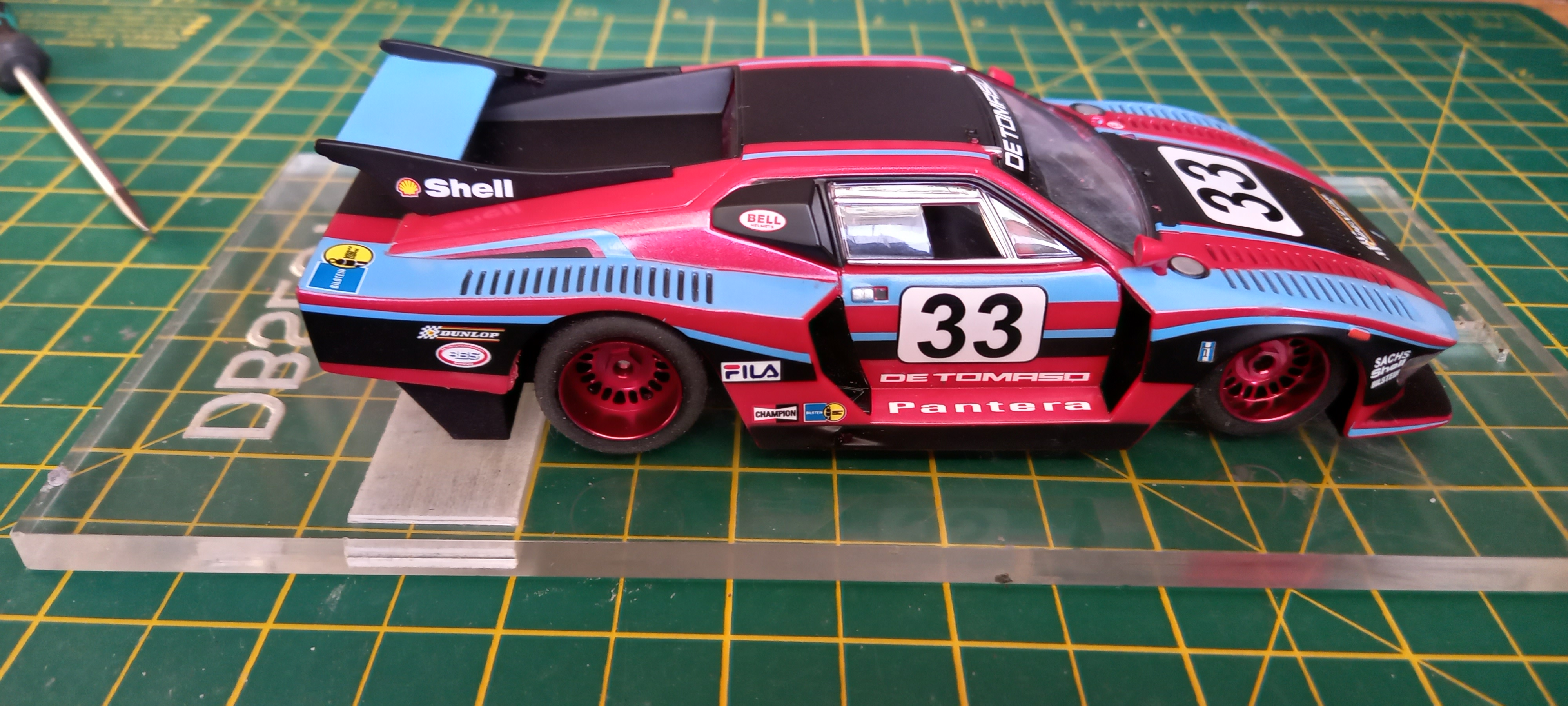

Well my De Tomaso Gr5 is about ready for action, just a little work on those front tyres etc to do. But it looks great with those Staffs wheels on.
The 3d Chassis is a little flimsy, would have preferred a more rigid one.

Looks like there's room to space those front wheels out nearly 1mm per side which will improve handling.

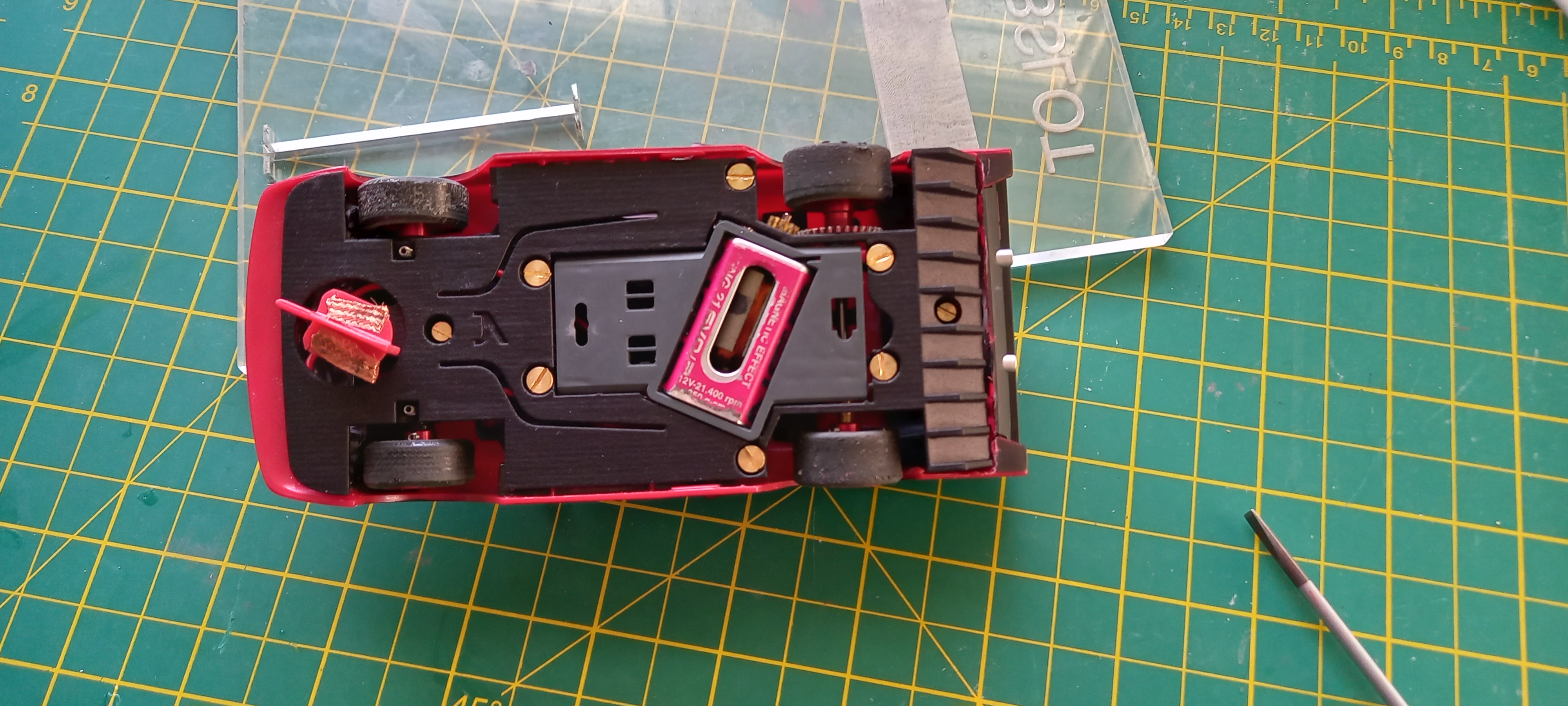

So I decided to go with the Alan Mann Ford GT & the Giant De Tomaso , little & large
I just need to get the wheel inserts for the GT40 and do abit more work on the tyres.
The De Tomaso is almost as big as the Nissan Skyline and weighs 100gms without any weight, so I don't think it is going to beat any track lap records, but should be fun to drive.

Posts: 4,562
Threads: 147
Likes Received: 3,084 in 1,831 posts
Likes Given: 4,254
I like it, is that a Carrera bodyshell (Pantera)
