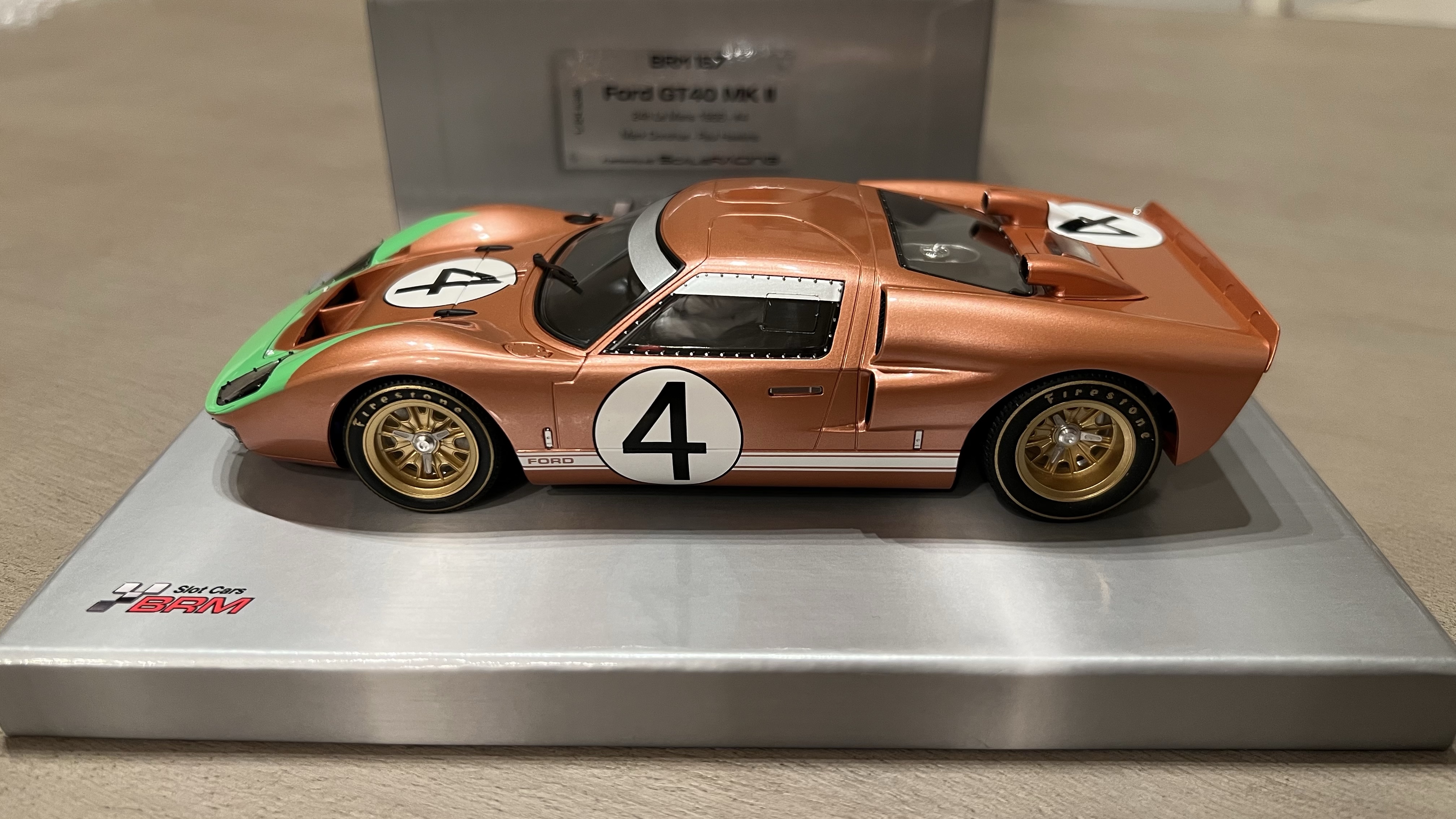

Here's my first of the year - a BRM GT40
