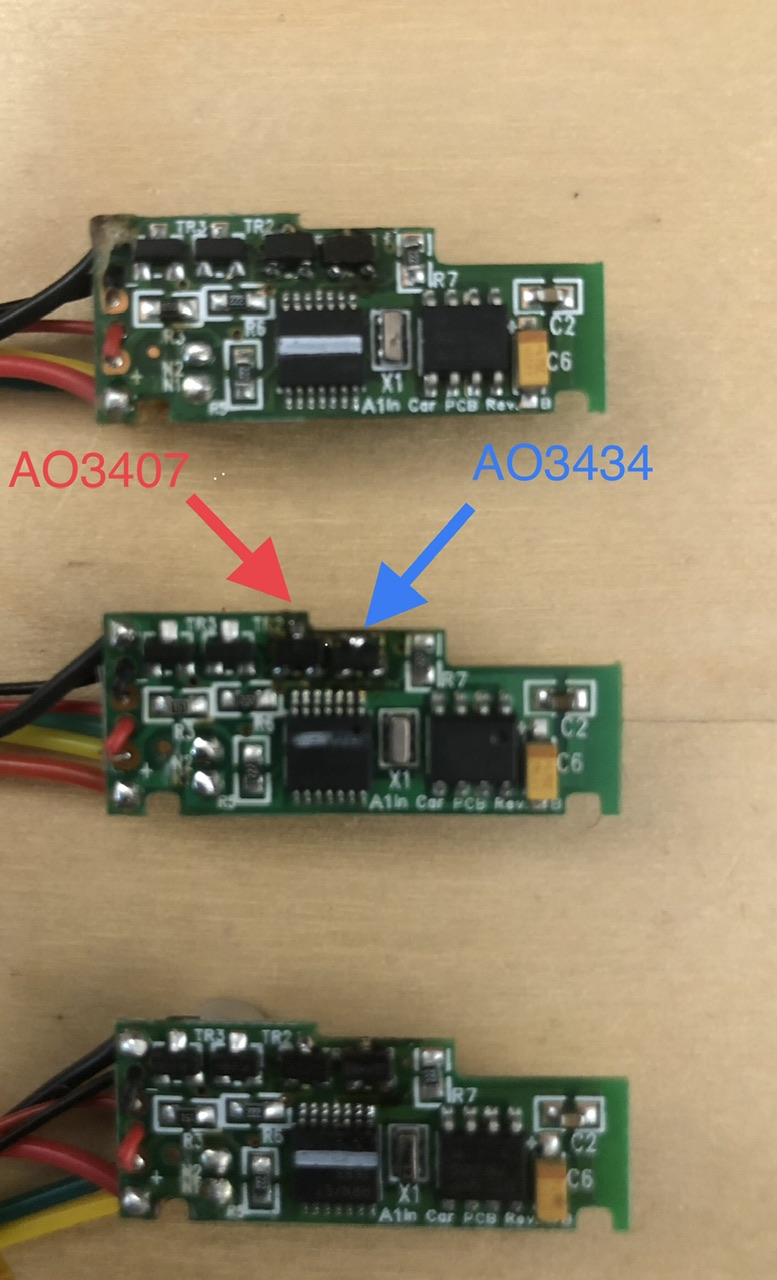

1/ MOSFETs
For the n-channel MOSFET I recommend replacing with the AO3434. Here you are replacing the part labelled NO2.
For the p-channel MOSFET I recommend replacing with the AO3407. Here you are replacing the part labelled PO3.

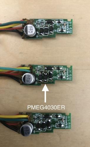

2/ DIODES
Here I recommend replacing the 1Amp silicon diodes with 3Amp Schottky diodes. These carry higher currents and run cooler.
I recommend replacing with Schottky diodes type PMEG4030ER - and of course you need 4.

I typically upgrade in two stages. First I replace the two MOSFETs and test for correct function of the decoder. I test motor control, braking and motor coasting.
I then replace the diodes and again test as above. Note the diodes conduct current in one direction only, so are polarity sensitive. The polarity is marked by a series of lines at one end of the diode. Make sure you fit the new diodes with precisely the same polarity as the diodes you are removing - and here some diagrams/sketches will help!

Above photo showing replacement MOSFETs in place
Above photo showing replacement Schottky diodes in place

As the AO3434 and AO3407 become more difficult to source - the readily available AO3434A and AO3407A can be used instead. These are current production versions.
