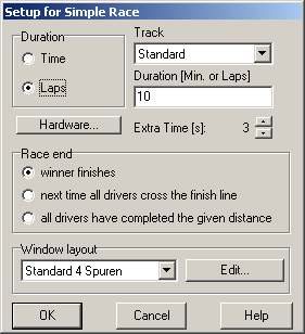

This function starts a simple race. This means a single timed run without changing lanes. There cannot be more drivers than lanes for this timing mode. The following dialog presents the options for the simple race:
Duration
This option is for setting the duration of the race. This limit may be a time or lap-limit. The race lasts for the amount of time (or laps) given in the field below (or until the Esc.Key is pressed).
Track
The track on which the race takes place. If the race has been started from within the track layout editor, the current track is preset here. Otherwise the last used track is preset.
Hardware
This button opens the dialog Timing Options2Y73VN.
Click “Cancel” to close the dialog without any further action or “OK” to Start the Timing SessionRXP1UZ.
Extra Time [s]
Here you can define the amount of time in which input signals are accepted AFTER the session has already ended. This is only useful if you have configured a signal to the parallel port after race end which turns off track power. So cars that slide over the start/finish line when the power is already off are accepted. The extra time only applies for races that are limited by time. It is also used for the beginning of track call periods.
Race End...
Choose what ends the race:
Winner finishes
The race is terminated immediately after the winner completes the last lap or the time given has expired.
Next time all drivers cross the finish line
“Real world”-mode. The race ends when all contenders have crossed the finish line after the winner.
All drivers have completed the given distance
The race ends when all drivers have completed the given distance. If the race is limited by time, this option is identical to the first option (“Winner finishes”).
Window Layout
Choose the desired window layout here or open the dialog Timing Window Layout Setup5D3UIV by clicking “Edit”. The window layout last used for a practice session is preset.
Click “OK” to enter the lane setup1DBRIVW.
