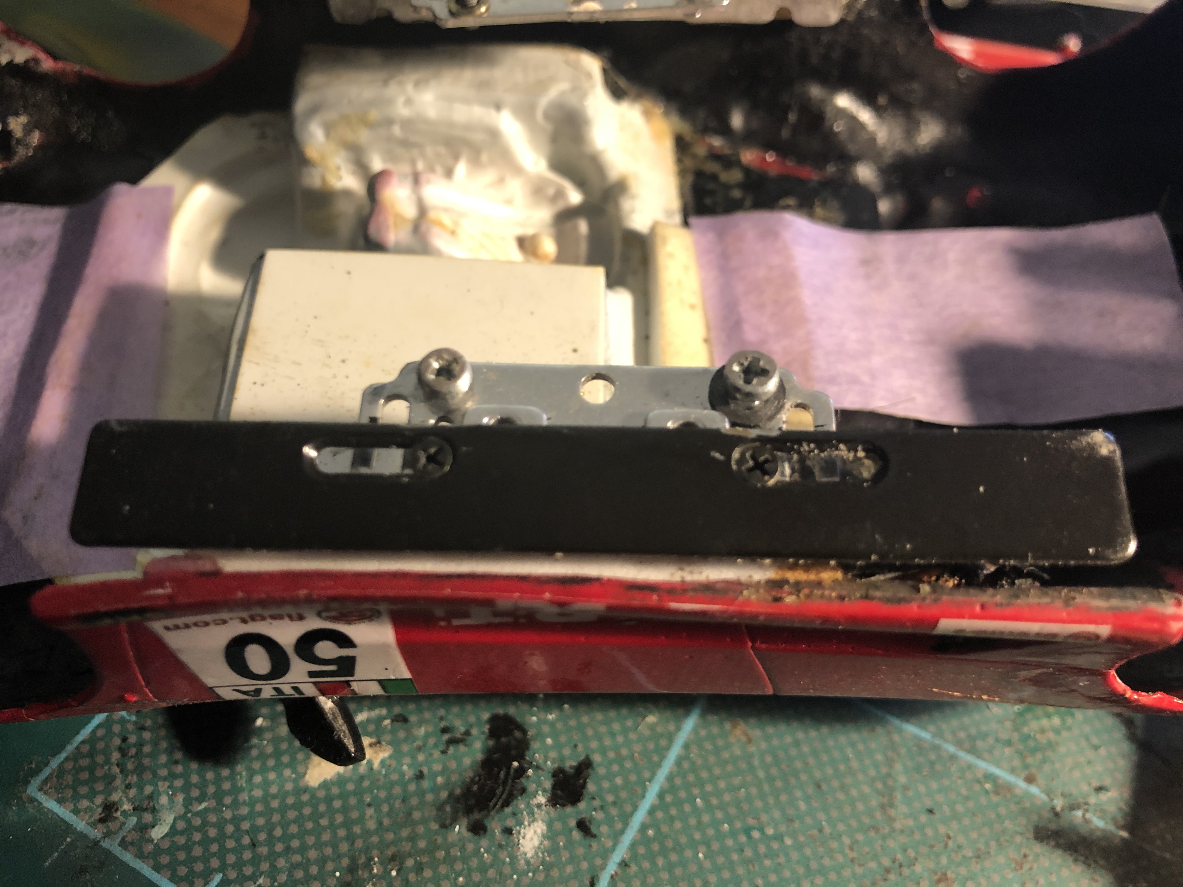

A basic question...how do you attach bodies to them, for example, a Scaleauto GT3 1/32nd scale with 2 central body posts?

Quote:A basic question...how do you attach bodies to them, for example, a Scaleauto GT3 1/32nd scale with 2 central body posts?
You attach a connecting piece to each side of the body, usually connected to a softish piece of foam rubber that you glue to side of body. This then attaches to the chassis with 4 screws. I will take a pic of one I used in the IMCA worlds to show how it is done...

Sorry forgot to come back with pics. Hope they help.
You will see a white line between the metal Attachment and the body. This is a strong double sided tape that holds it to the side of the body. If size allows as has been said you can use foam rubber which will give isolation to the chassis.

Use the side packing mounts, they are lighter, you attach to the body with foam and screw the lower weights to them.
You typically will want to keep the guide spring tight, lower the rear a little more than the front to create grip, raise to lower grip. Opposite of course of what we have been taught. Once you’re fully set they run VERY well. Camber won the Group 5 Proxy (current GT3) proxy. I’ll post pics when I get a chance if it will help.
