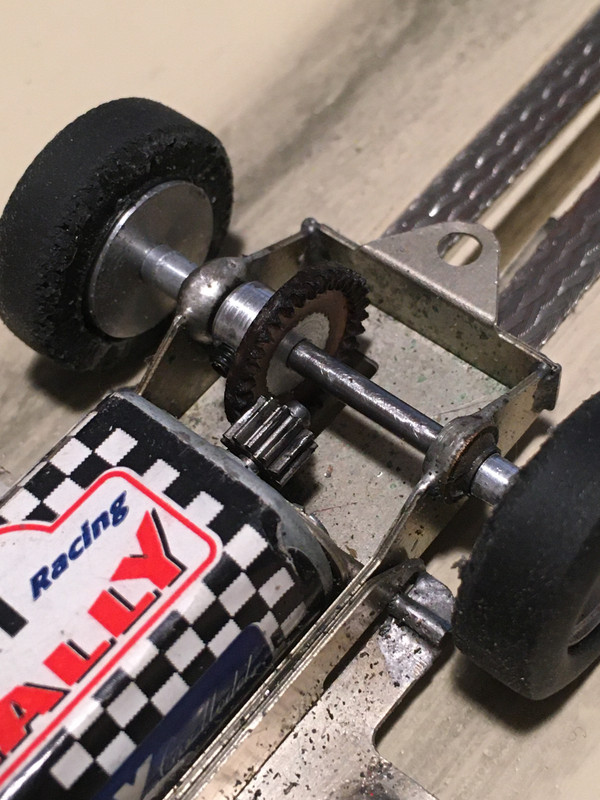

I have one of these chassis. I bought it out of interest and have built it up. There have been a couple of motor changes from wild to mild.
Wheel changes too from wide to narrow but there is a question I have that puzzles me.
Why are the body mounting holes on the central chassis piece when the outer pans are hinged? this is a plumber design ie the outer pans are hinged from the front. To me the body should be mounted to the pans so I did that.
I made some changes as I built mine....front axle tube, central cross brace, pans drilled and counter punched/sunk, all joins soldered.
Another issue I faced was if the body was mounted at a scale height the chassis sides would be visible (I dont like that) so it had to be low.

(18th-May-20, 09:17 PM)munter Wrote:  Another issue I faced was if the body was mounted at a scale height the chassis sides would be visible (I dont like that) so it had to be low.
[Image: 1-EE6-E91-D-45-A9-4-AC0-BF32-365372-FE11-A1.jpg]
Larger dia. (Scale) sized tires would fix that problem John....... Bigsmile

Thanks Steve, I think you may be correct....but any holes for body mounting using the pans?
That was my main point...getting the body floating with the outer pans. It would work using the two central positions (not an arrangement I like) but there is no lateral/sideways tilt control for the body unless you built that in.
The weight of the PP chassis is an advantage though.
