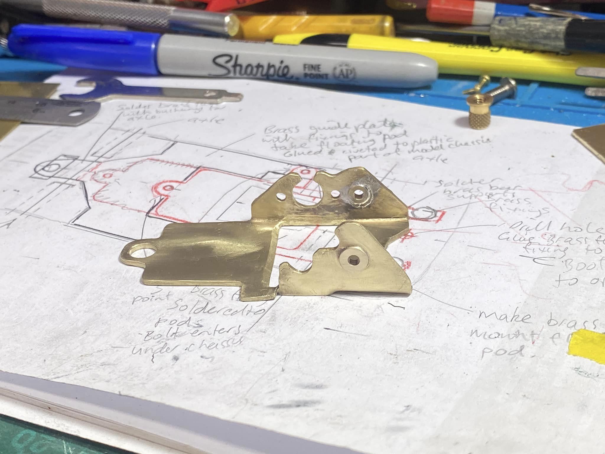

I'd like to try and keep as much of the model as possible so I've decided to build a brass chassis inside.
I have a Racer Sideways BMW M4 white kit to make up and saw the floating chassis and am trying to make a brass sidewinder motor mount that floats similar to that.
I drew up a plan to the wheel base of the model and cut out the brass motor mount.
I thought it'd be easier to drill the axle hole before bending but I soon found out once I got the bushes in, I should of figured a way of drilling afterwards.
I eventually got them soldered in so the axle turns nice and freely, very good learning curve.
A little bit of fettling the motor mount screw holes and she fits nicely.
Next was a thinner brass plate to fix on to the plastic chassis and solder a guide tongue to that.
I found some brass inserts I've had for a long time and thought I could some how use these as the floating part which attaches the motor mount to the rest of the chassis.

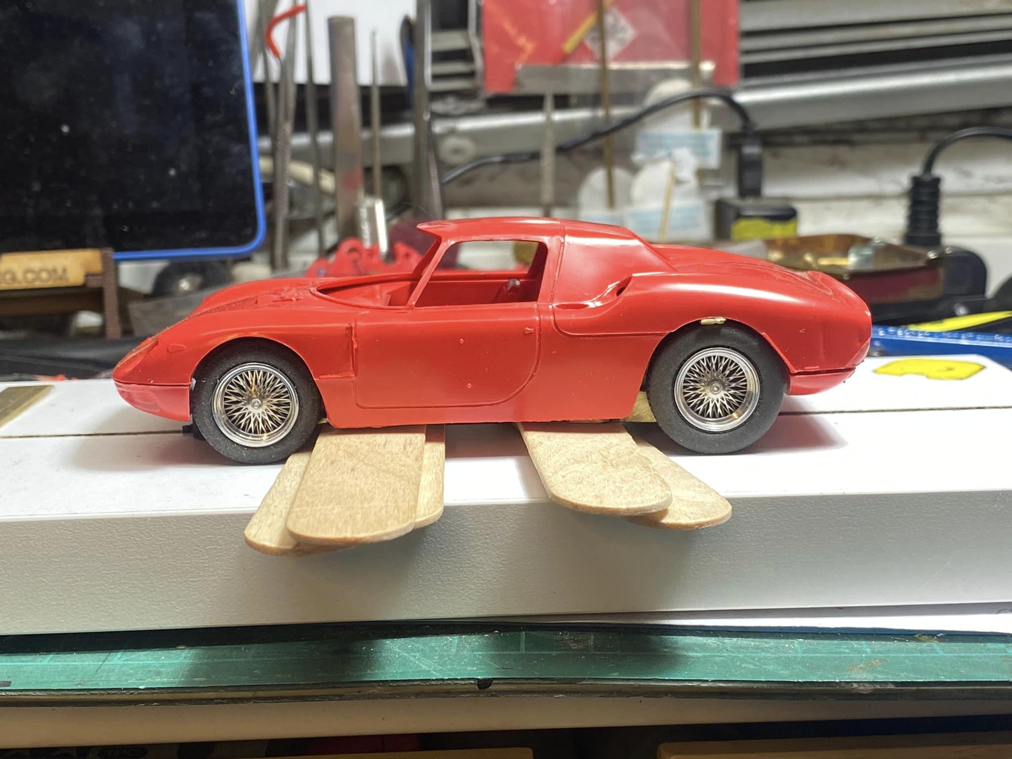

She's got a nice stance this lovely little car.
