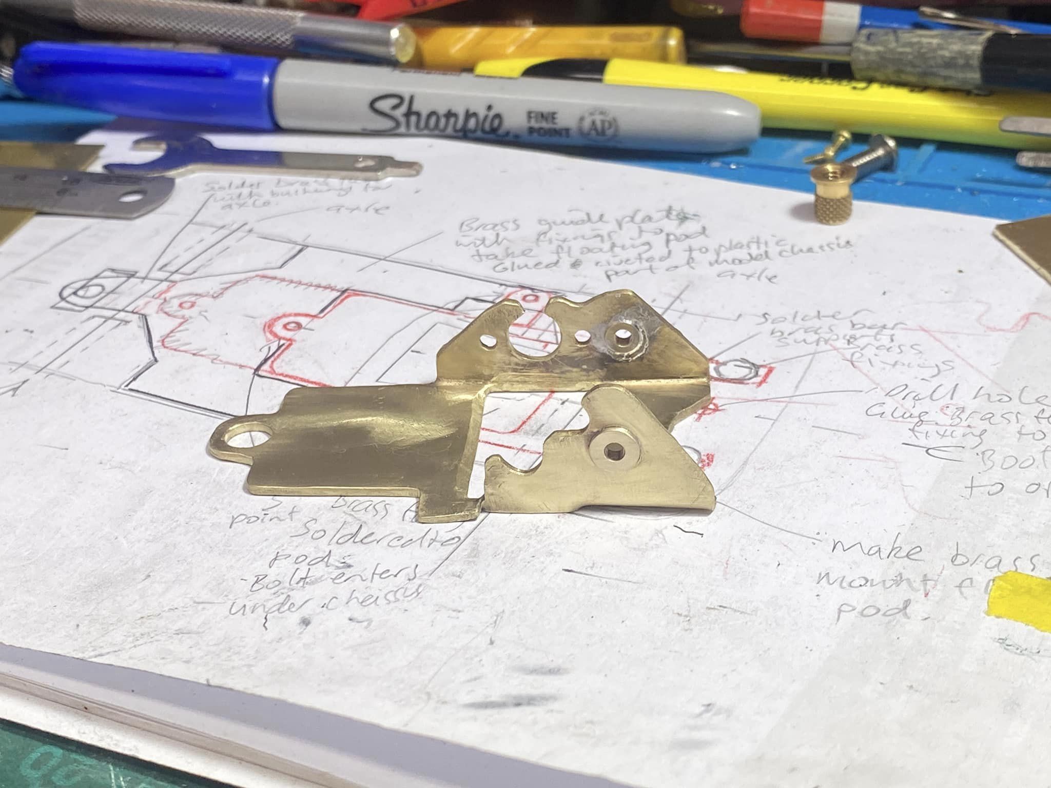

I'd like to try and keep as much of the model as possible so I've decided to build a brass chassis inside.
I have a Racer Sideways BMW M4 white kit to make up and saw the floating chassis and am trying to make a brass sidewinder motor mount that floats similar to that.

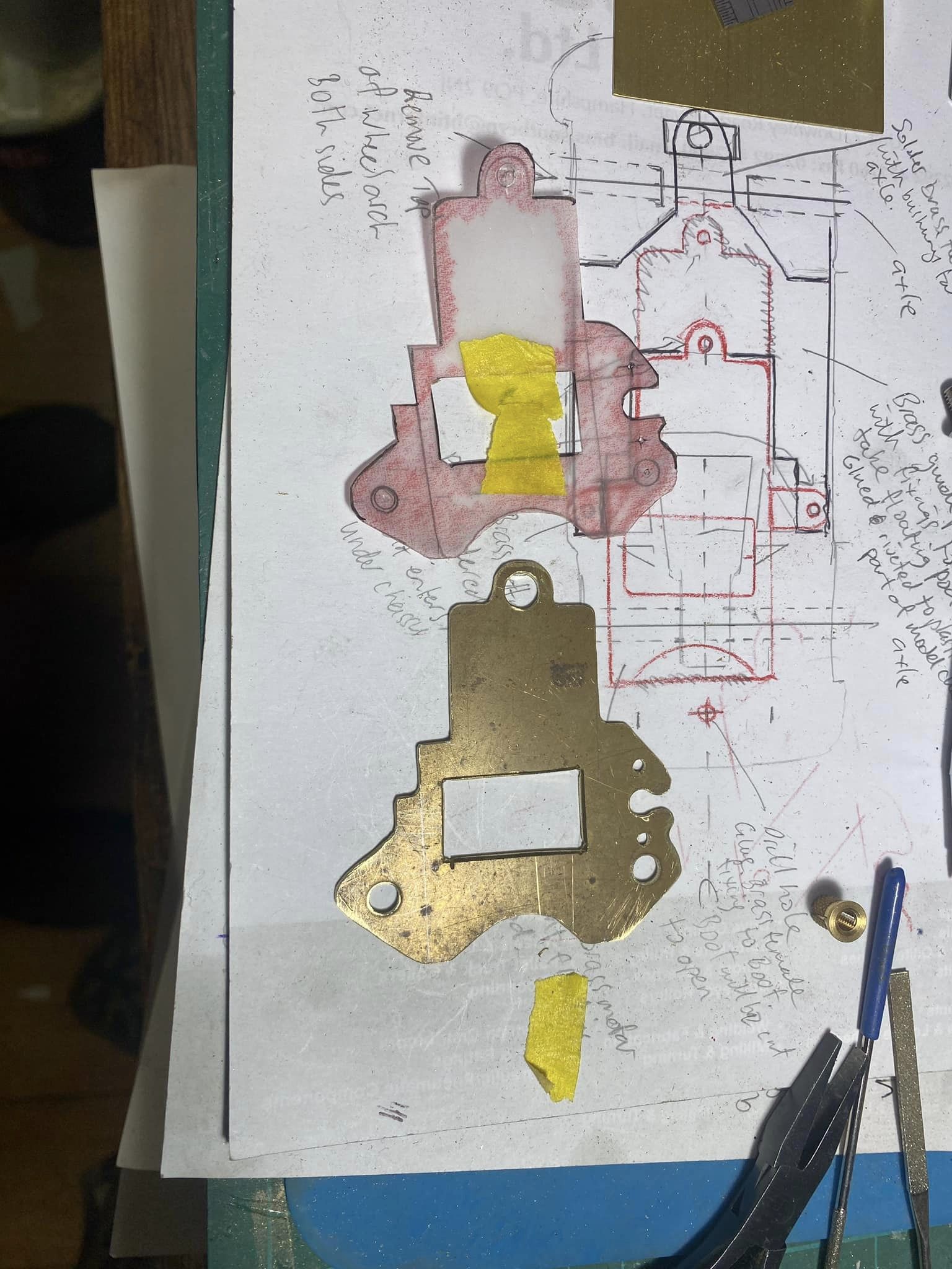

I drew up a plan to the wheel base of the model and cut out the brass motor mount.
[attachment=37445]

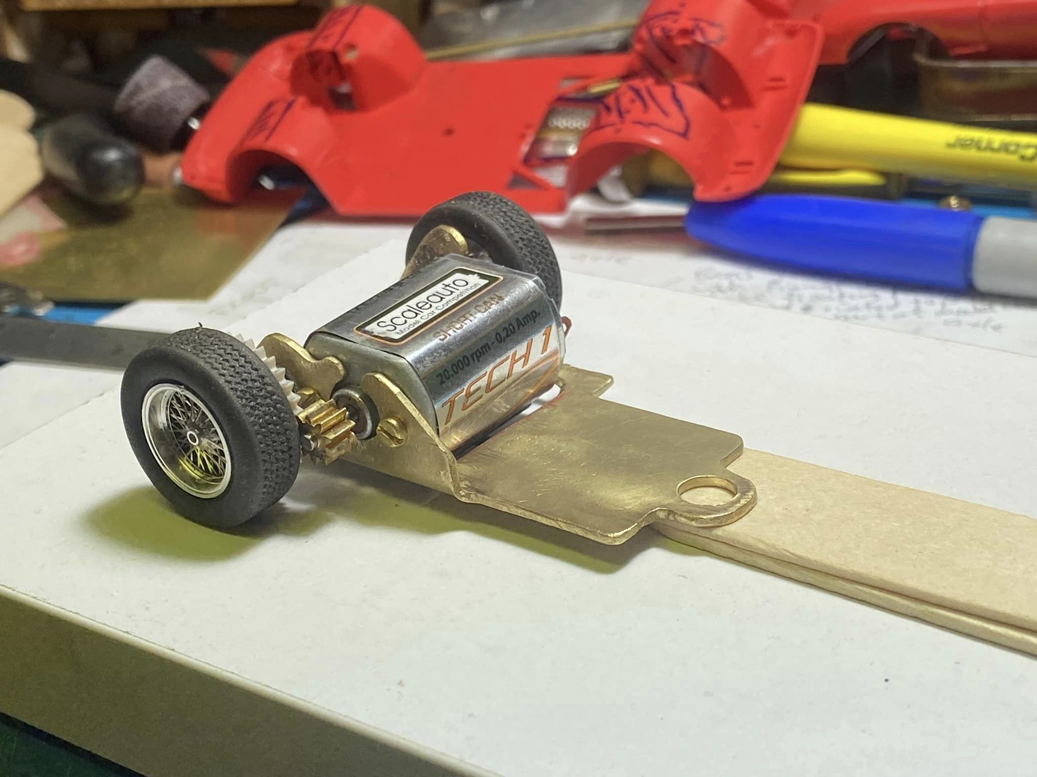

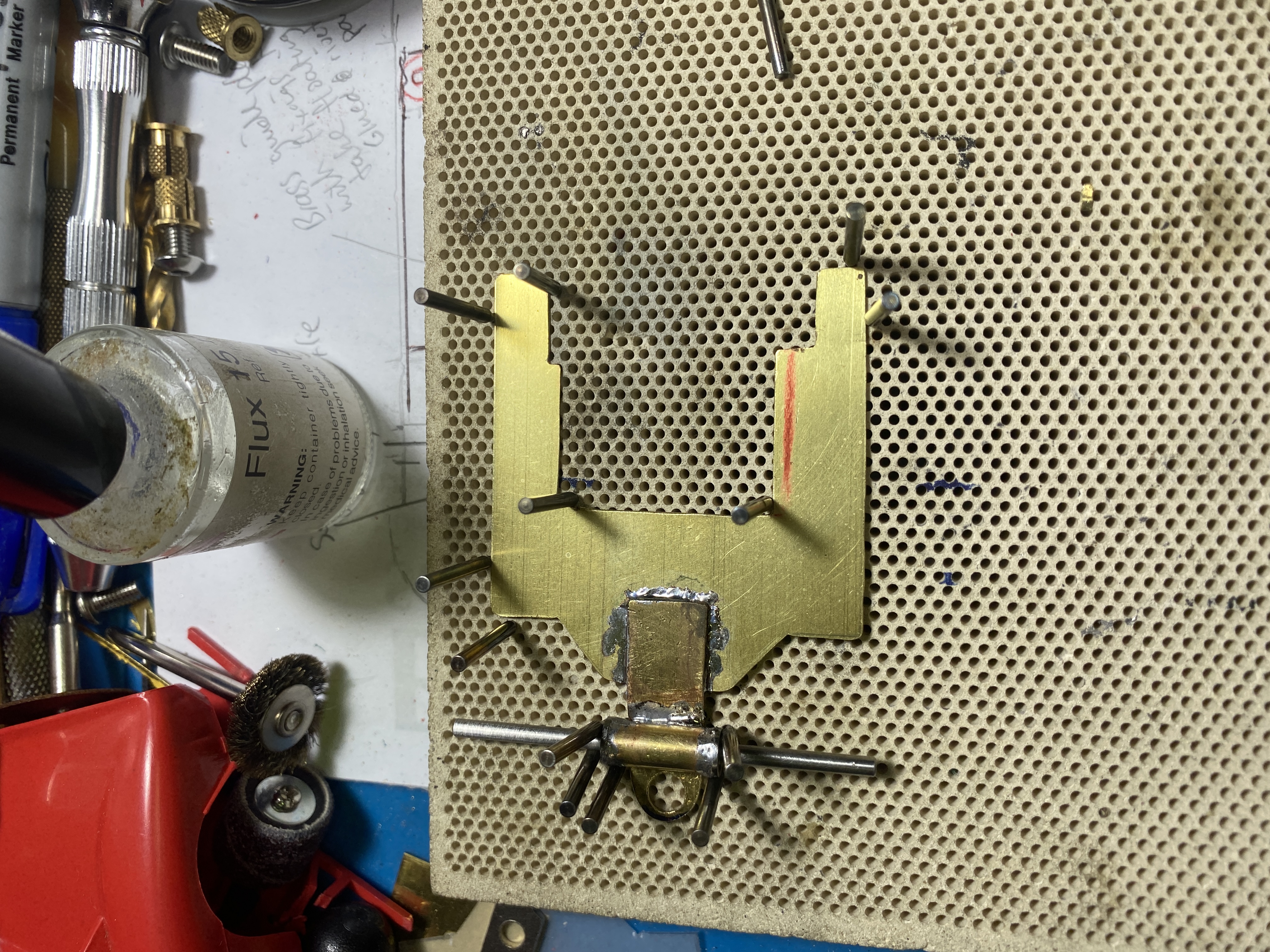

I thought it'd be easier to drill the axle hole before bending but I soon found out once I got the bushes in, I should of figured a way of drilling afterwards.
I eventually got them soldered in so the axle turns nice and freely, very good learning curve.
[attachment=37446]
A little bit of fettling the motor mount screw holes and she fits nicely.

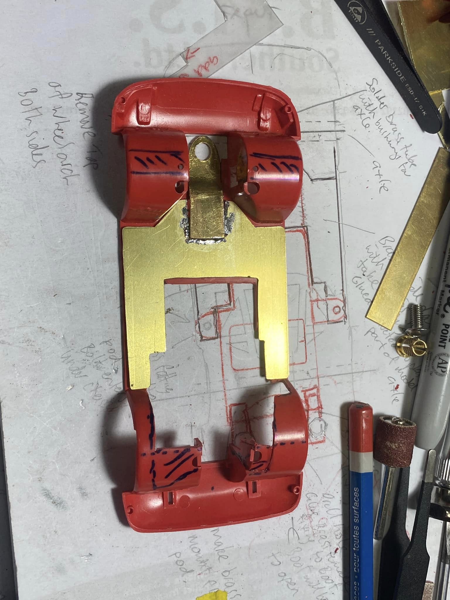

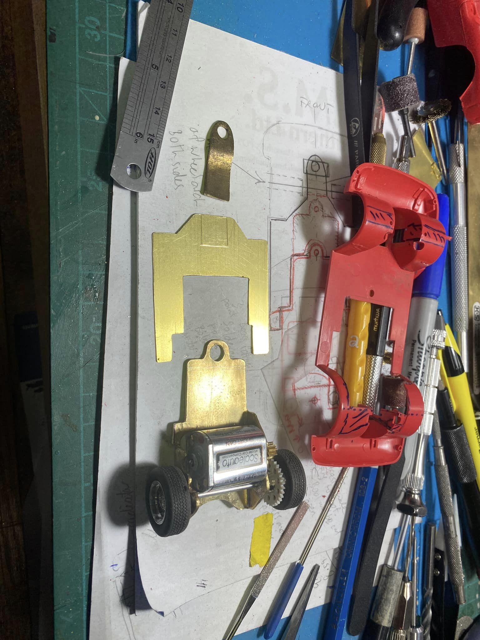

Next was a thinner brass plate to fix on to the plastic chassis and solder a guide tongue to that.
[attachment=37452]
[attachment=37449]

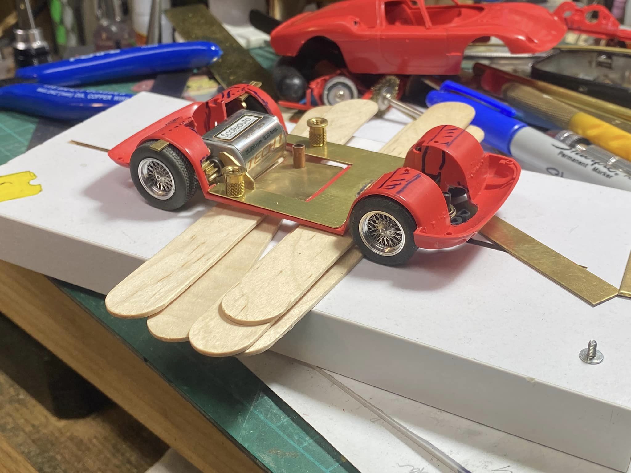

I found some brass inserts I've had for a long time and thought I could some how use these as the floating part which attaches the motor mount to the rest of the chassis.

[attachment=37453]

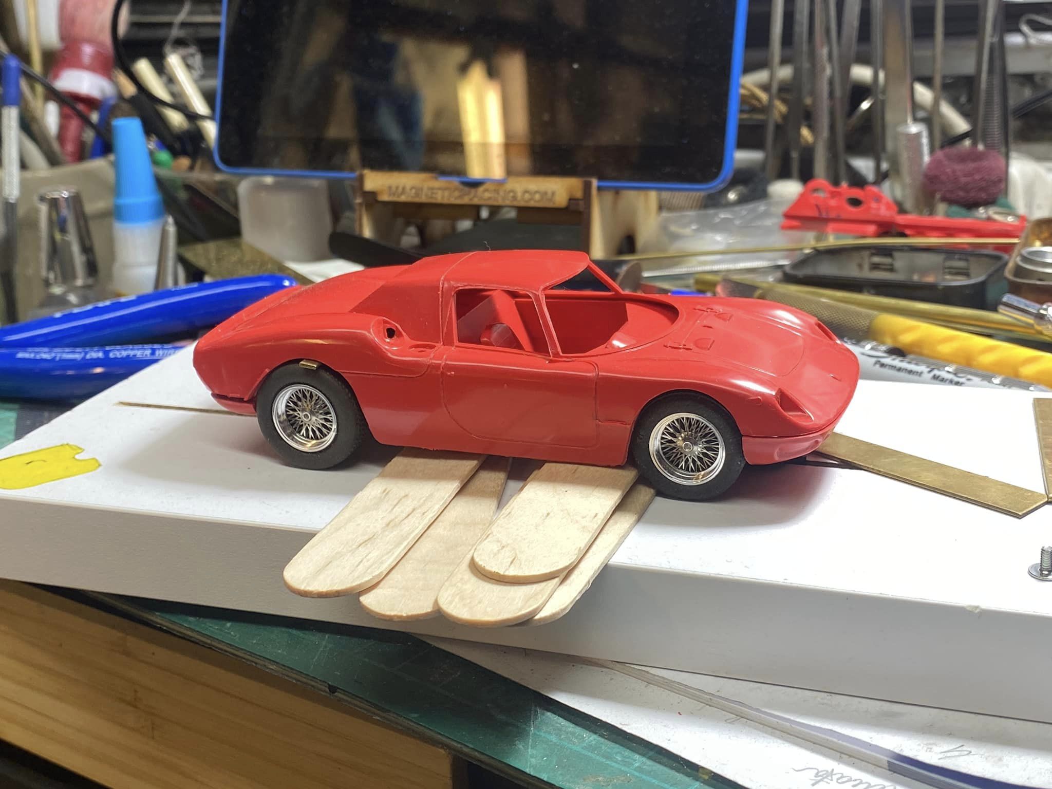

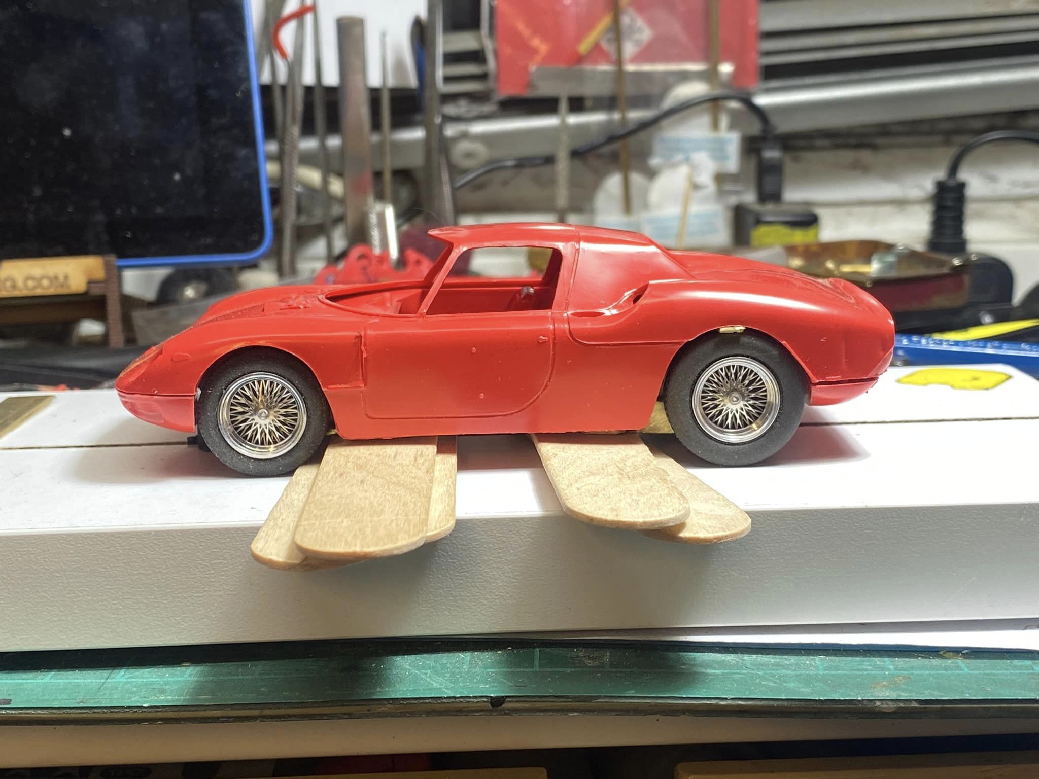

She's got a nice stance this lovely little car.
[attachment=37454]
[attachment=37455]

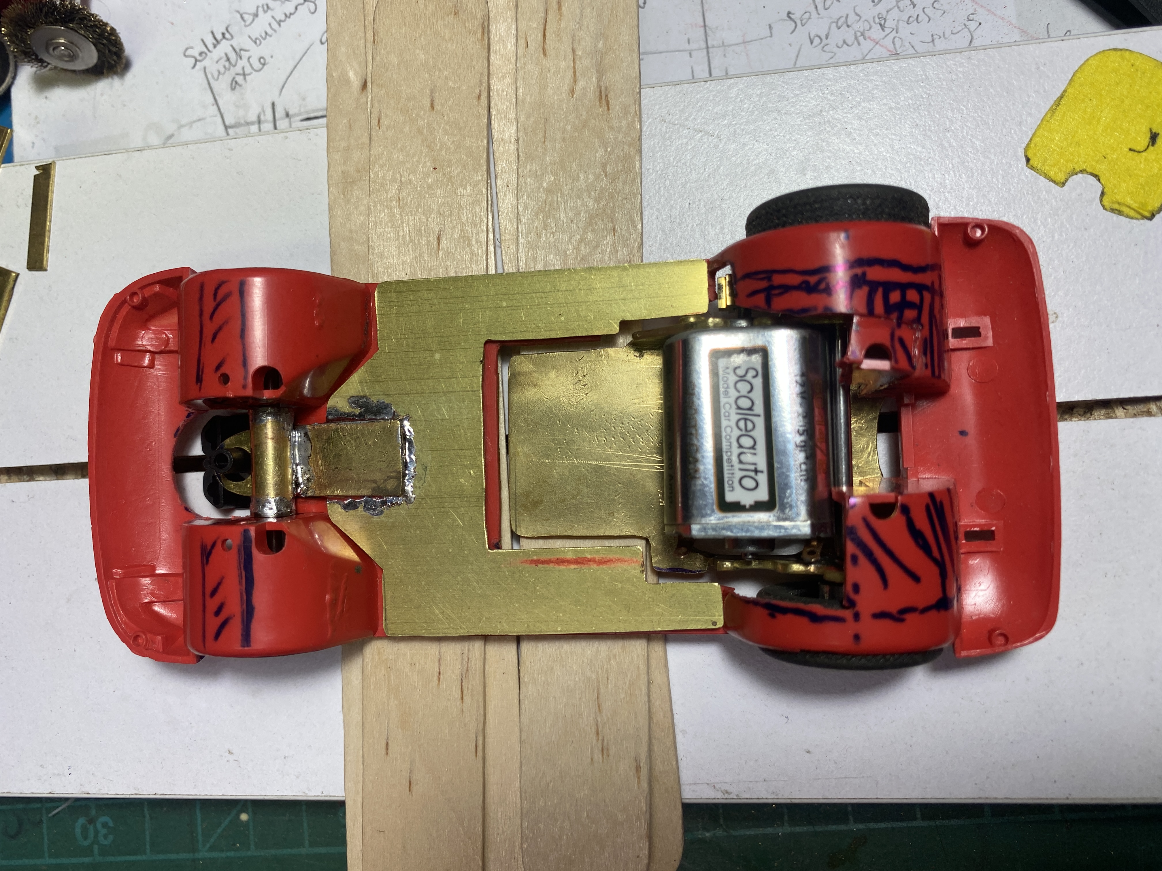

Hi All, a little bit of progress.
I was originally going to cut through the wheel arches to be able to slide the front axle tube in.
But I decided to try cutting and soldering a shorter tube to fit the little gap between the wheel arches.
It has worked quite well, so that means I won't weaken the wheel arches.
I've had to cut the back a lot, but I'm going to strengthen that with some solid brass tube I can bend. I'll post pics once done, easier than explaining.
