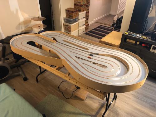

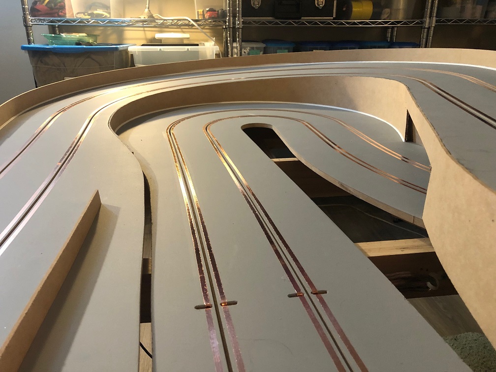

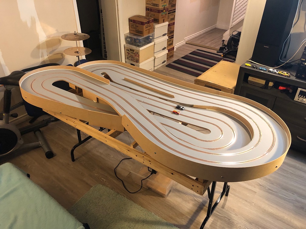

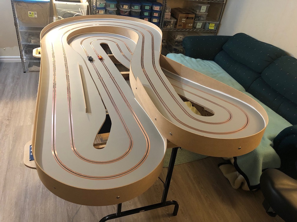

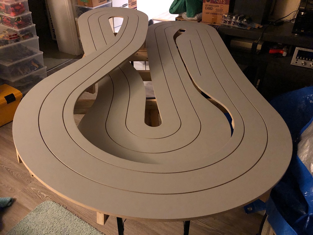

This is on a 3' by 7' foot base. The track is 3/8" inch MDF. Burnishing is next followed by wiring and power.
The track should have power later today. I look forward to running a few laps. MicroScalex cars with braids will be the first test cars. I need to install braids on everything that doesn't already have them. HO proxy racing here with Andy got me started installing braids on HO cars.
Ken

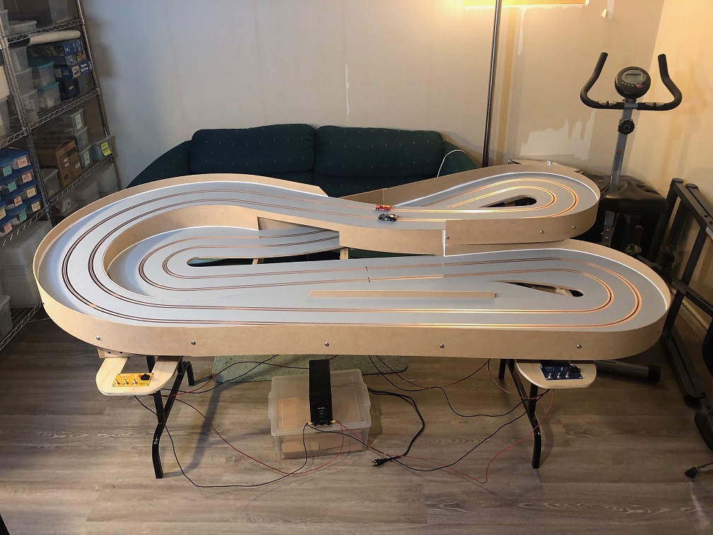

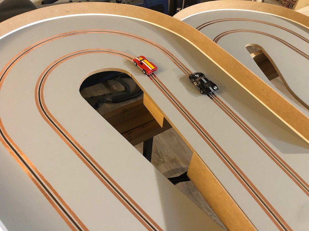

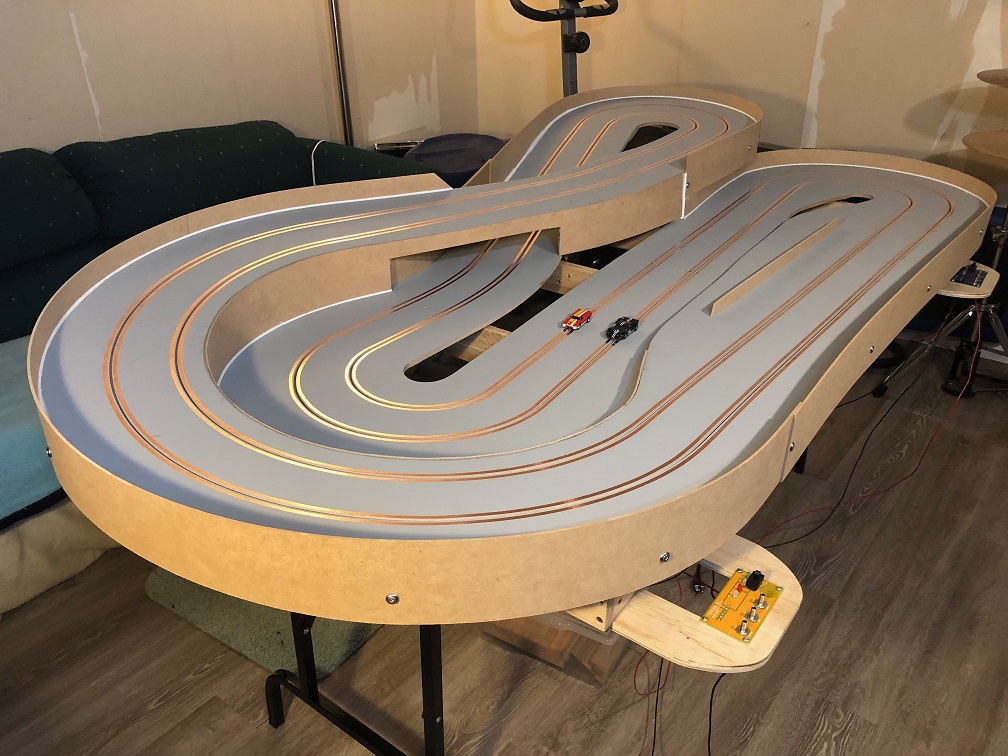

The track lives!
I asked the builder for a bit more lane spacing than regular HO. You can still take the other guy out in a corner if needed.

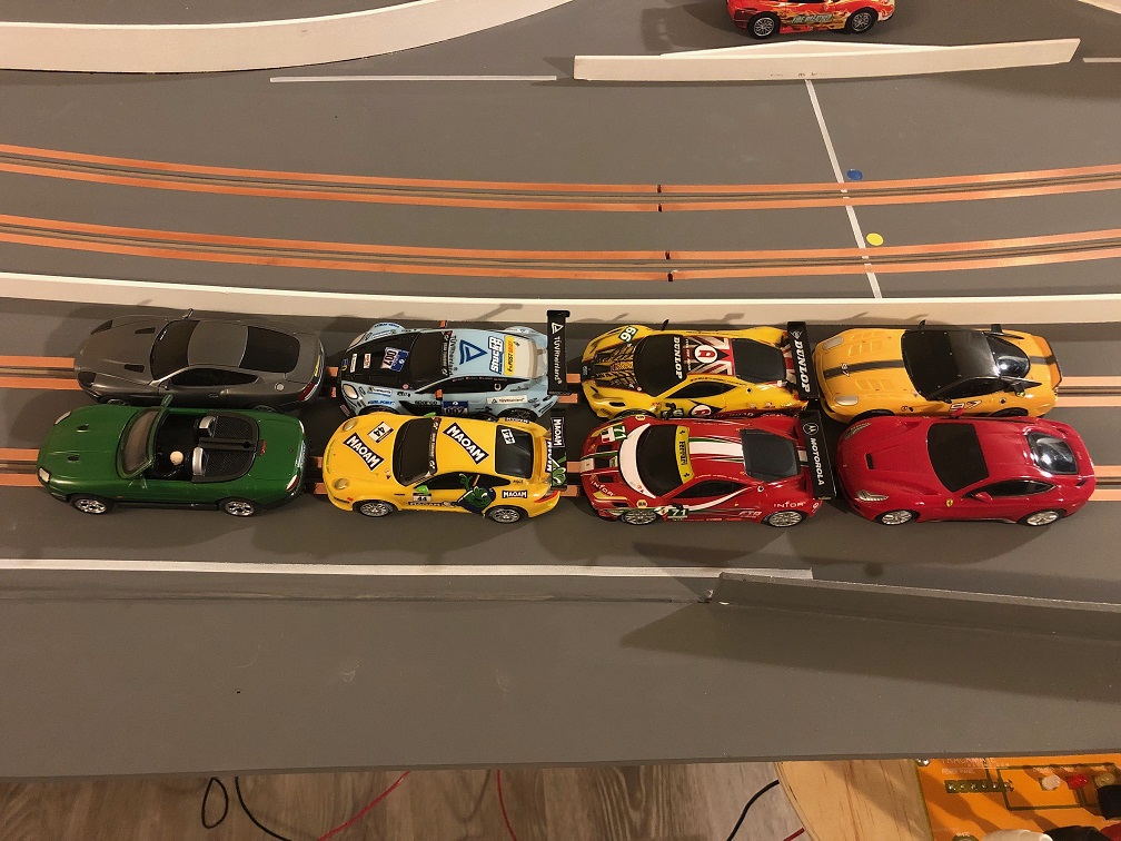

1/43 cars are about an 1/8th of an inch apart. It doesn't get any closer. It's NUTS!

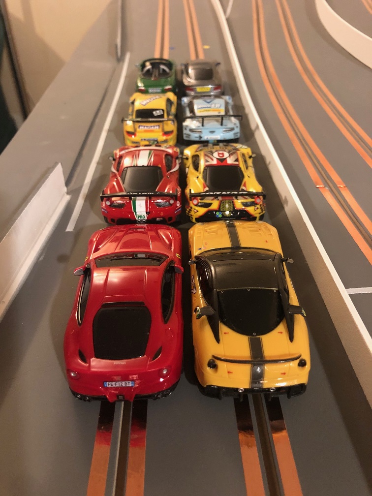

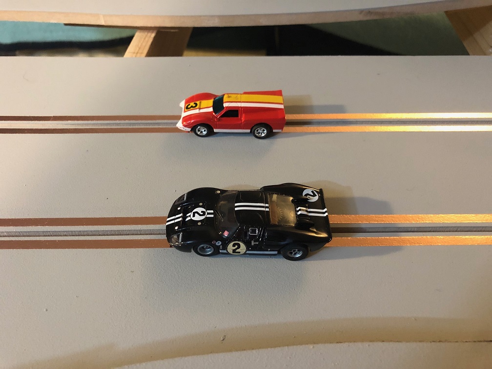

Here's how the 1/43 cars look on the track. Spacing is close. However, you can pass if you don't mind clipping the guy next to you a little.
I had to change the plastic guide pins to 3/32" dia steel rod. I also had to add lead weight since the magnets don't do anything. Now the cars are fast(er)!
