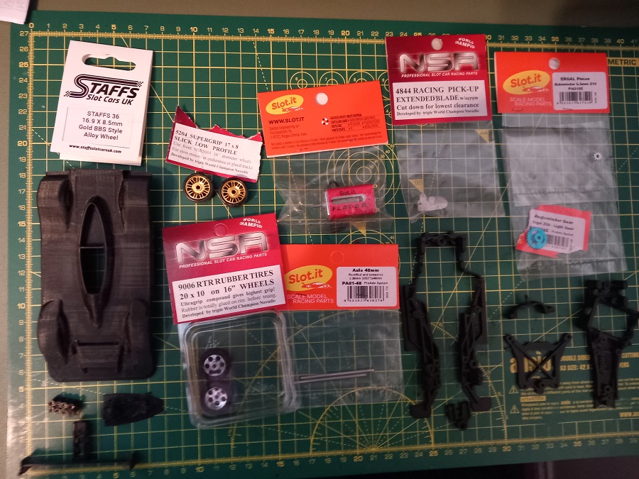

Progress for the GT Proxy 2024.
Dodge Viper finished and ready to go.
Just about to start work on Wolf Dallara Can Am car
JS Body and Anglewinder chassis with built in pod.
Slotit Ergal 10/26 gearing
Slotit Flat-6-R motor
NSR rears
Staffs wheels and NSR tyres front
High hopes this one may not be last Bigsmile

That should be a very interesting car to drive Thumbup Thumbup

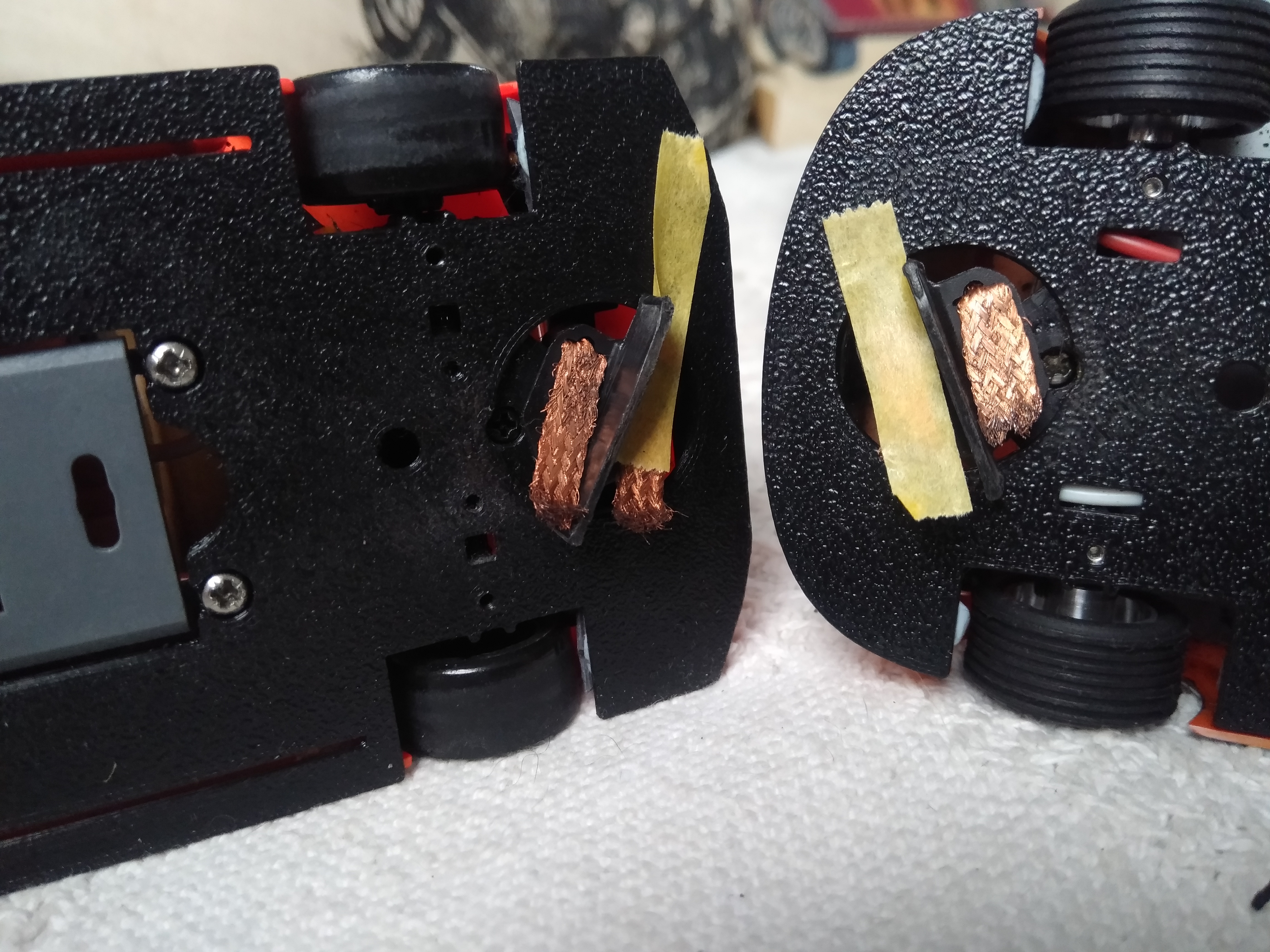

    I have found a problem regarding the rule whereby the body screws must be secured by tape or Blu Tac.
One of the cars I am entering, has the front body screw in the recess for the guide. Putting anything visible, in this area will severely restrict the movement of the guide.
This car is a Ninco and it is not the only car which would have this problem. I have attached to photo's to show where the screw is.
Due to its location, it is highly unlikely that the screw would drop out, if it was loose. The guide would act as a stop, severely restricting its exit. Worst case, it may jam the guide at 45 deg, after a tight turn, or "tank slapper!"
I have no problem in putting a small amount of Blu Tac inside the body post, to give resistance to the screw backing off.
Surely, the tracks which insist on taped screws, must have seen this situation in the past?
Cheers Chris

A tight one for sure. I guess if there is no room for a small piece in the hole, your option would be effective, like you say its not likely to fall out without jamming the guide !
#30
(2nd-Dec-23, 10:04 AM)Savage GT Wrote:  In such a case Chris, a small piece of Blu tack is indeed the best option.
I generally only use tape when there is not enough of a recess for Blu-Tack to be effective
The only issue is that I expect the track will want it visible. There's no space for Blu Tac on the screw head. It would stick against the guide.
Yes, I use Blue Tac inside the body post, but only I know it is there, unless the car is disassembled!!
