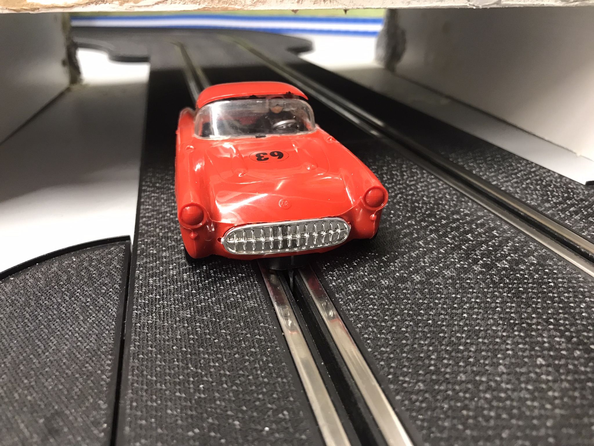

The Policar track is very grippy , so those who choose not to glue there tyres to the wheels were at an disadvantage as the rubber slips off very slight but enough to effect the times. I found that the difference  of a car not being glued to one that was , was in the .5 to a whole second advantage to the glued tyre.
The other point of the Policar track is the space between the rails is bigger so after the unboxing ( the braids on several of the cars had curled Despite the paper fitted between the car and foam) we spaced each car so the braids were in max contact some braids were slightly to long and had to be clipped to ensure a good contact.
A couple of cars had rubbing issues, pretty much like the guide issue on the hill if you have set your car to the 1.5 or 1 clearance that in most case is only for the motor clearance and in some the front is nearly hoovering the track, so when they have to go up an incline it bites into the track and ever so slightly rubs the track. ( this was and is the case with the Ninco Megane of Steve’s hence on this road it didn’t quite reach its full potential)
Tyre clearance was another issue , on some of the cars the clearance was ok on the setup plate but put on the track and dependant on chassis roll in the corners the car was loosing pace by the rubber body contact. ( the Gold Lamborghini was guilty of this flaw ) .
