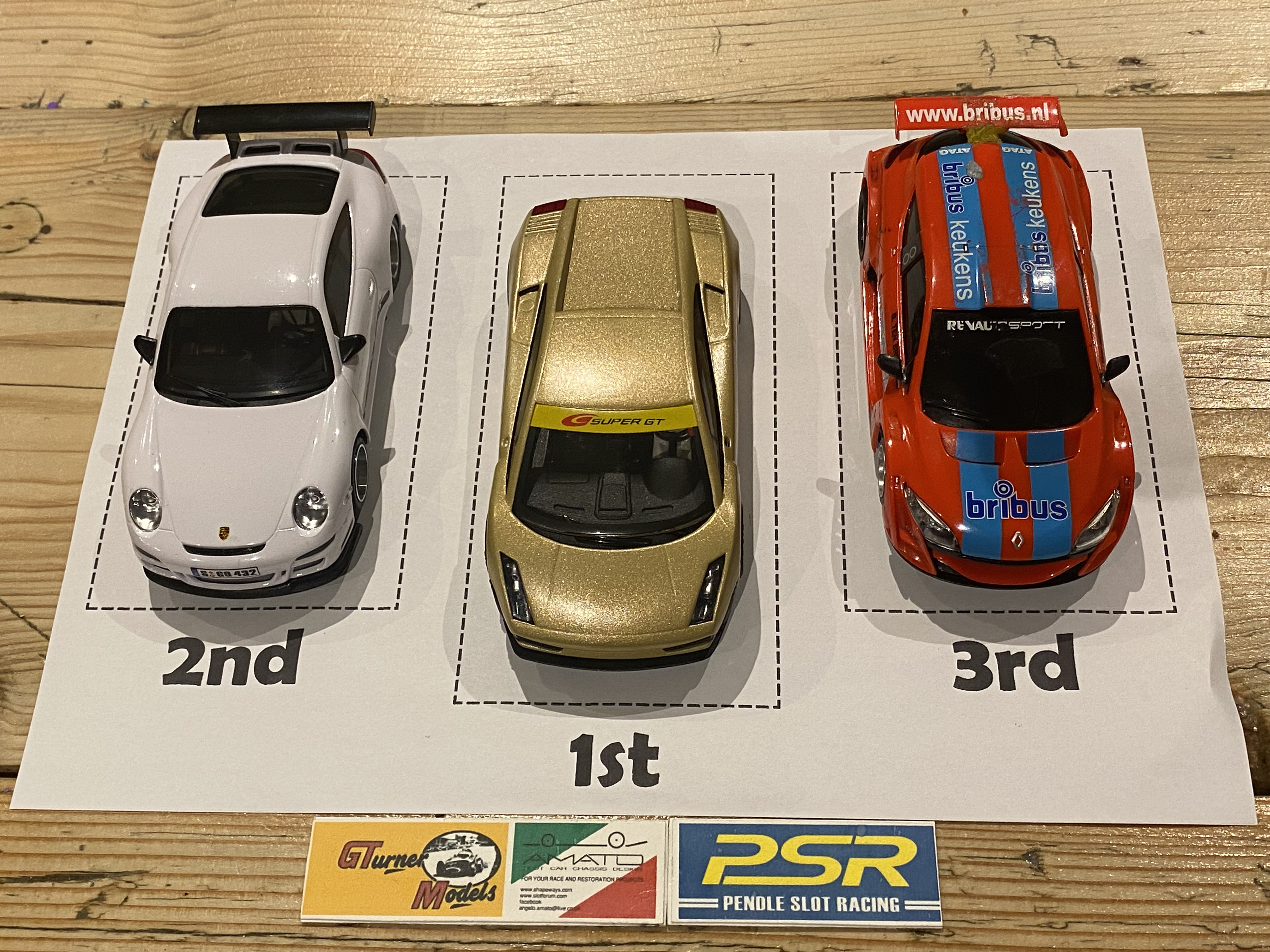

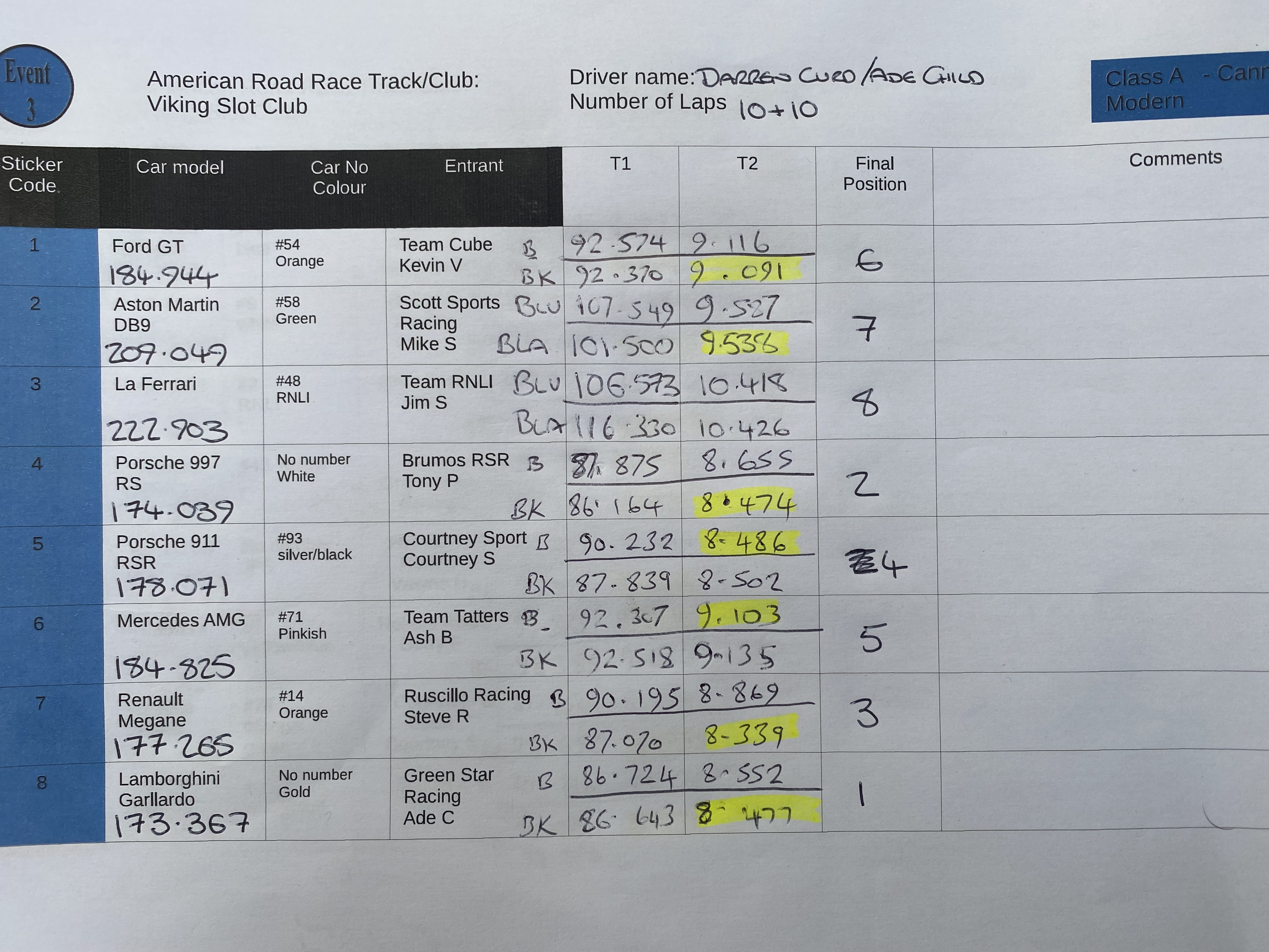

Class A:
Bit embarrassing when your own car comes out on top; but it was built and tuned on this track so makes sense. The battle between myself and Brumos' Ninco's was quite a close one (3 thousandths of a second separate the fastest lap times!)
[+] 7 members Like AdeC's post

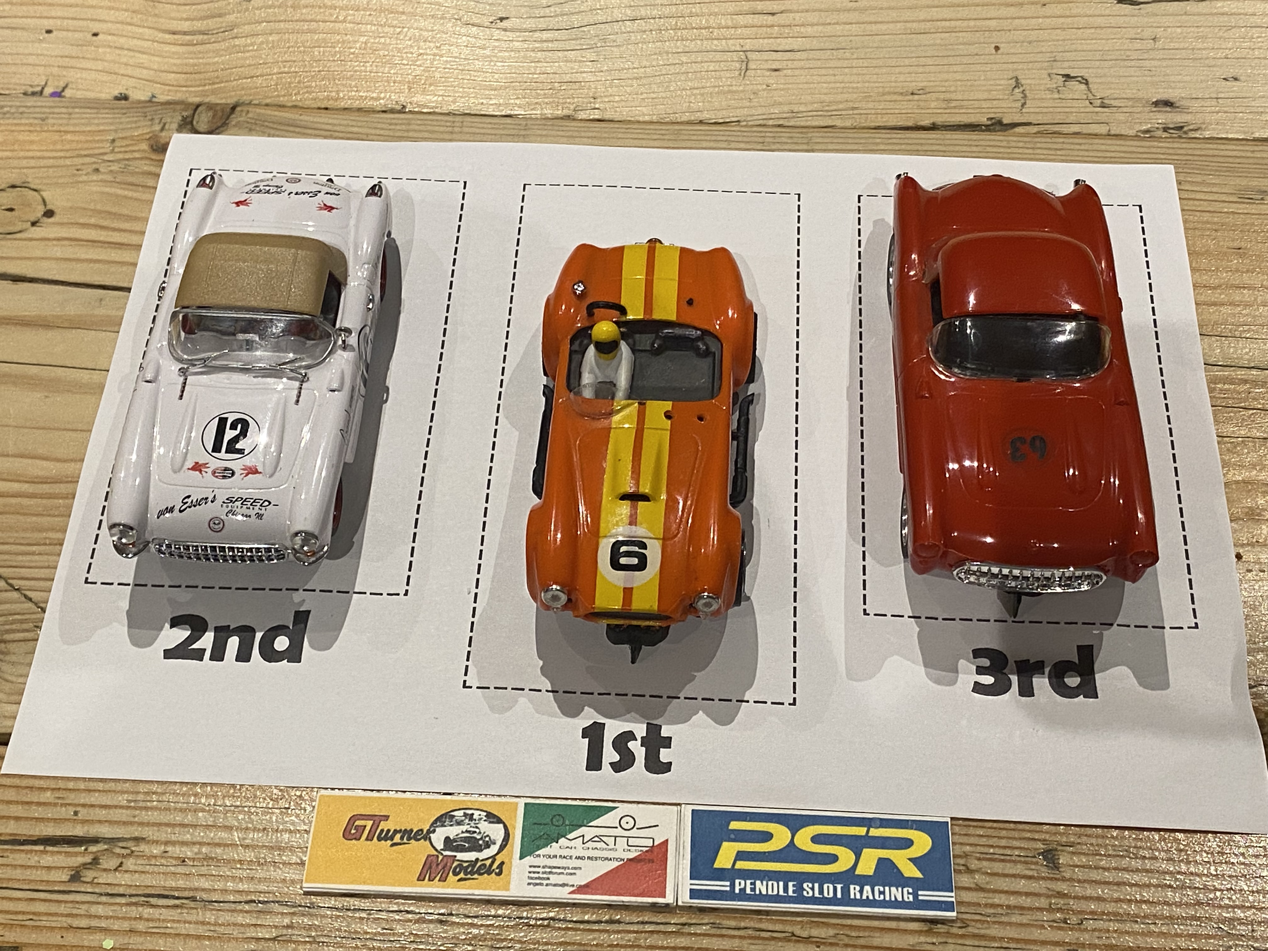

Class B:
[+] 6 members Like AdeC's post

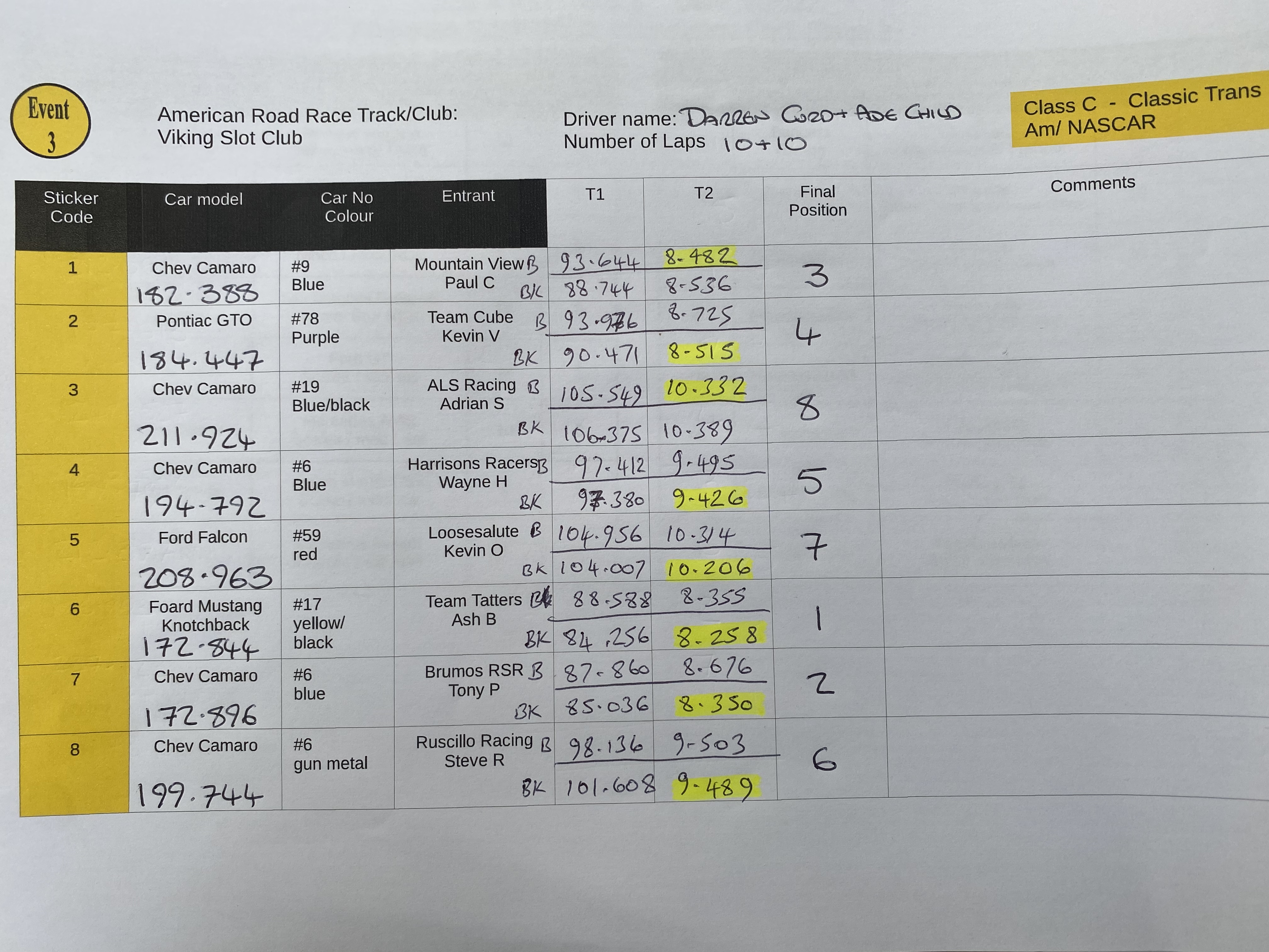

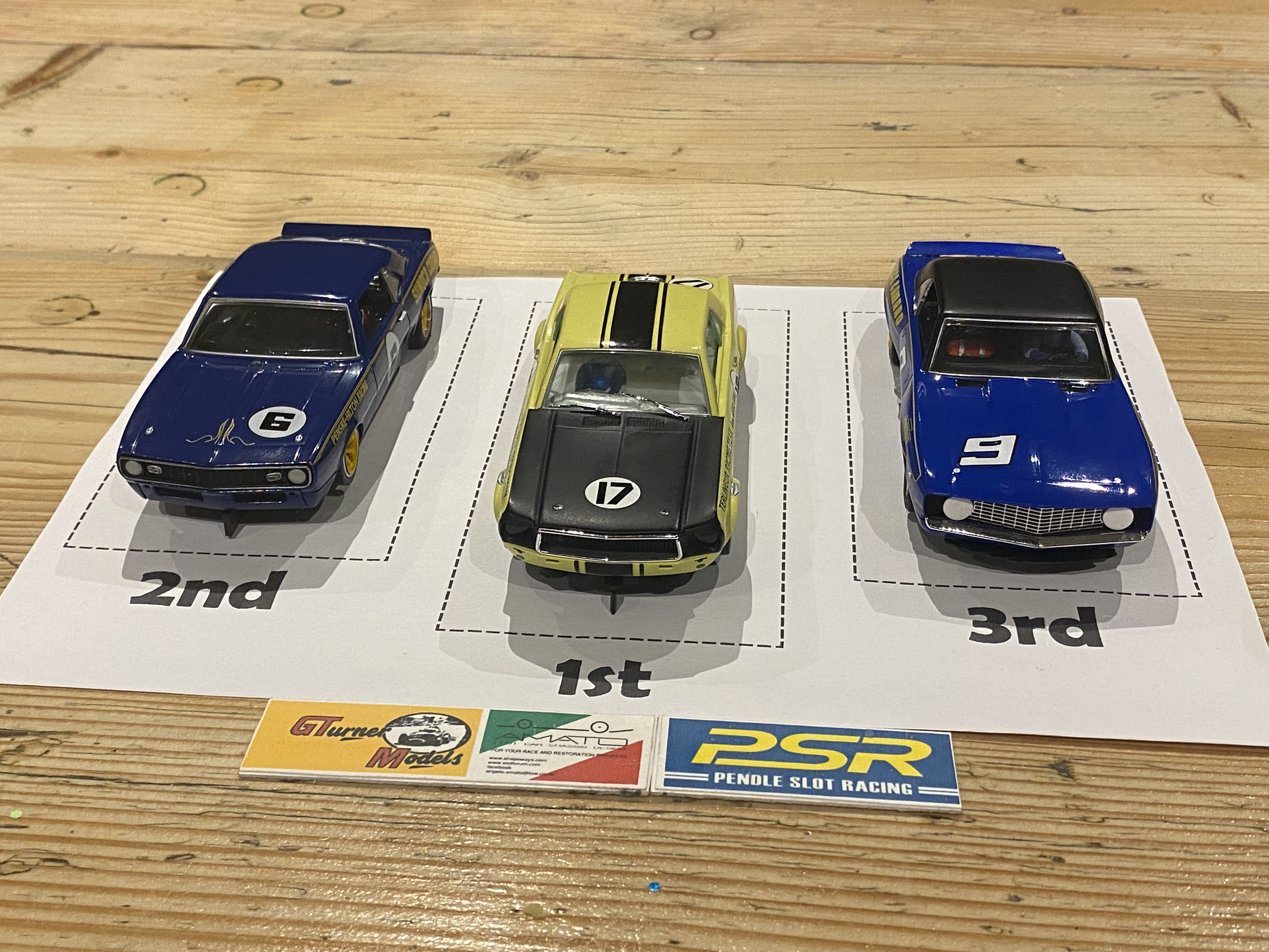

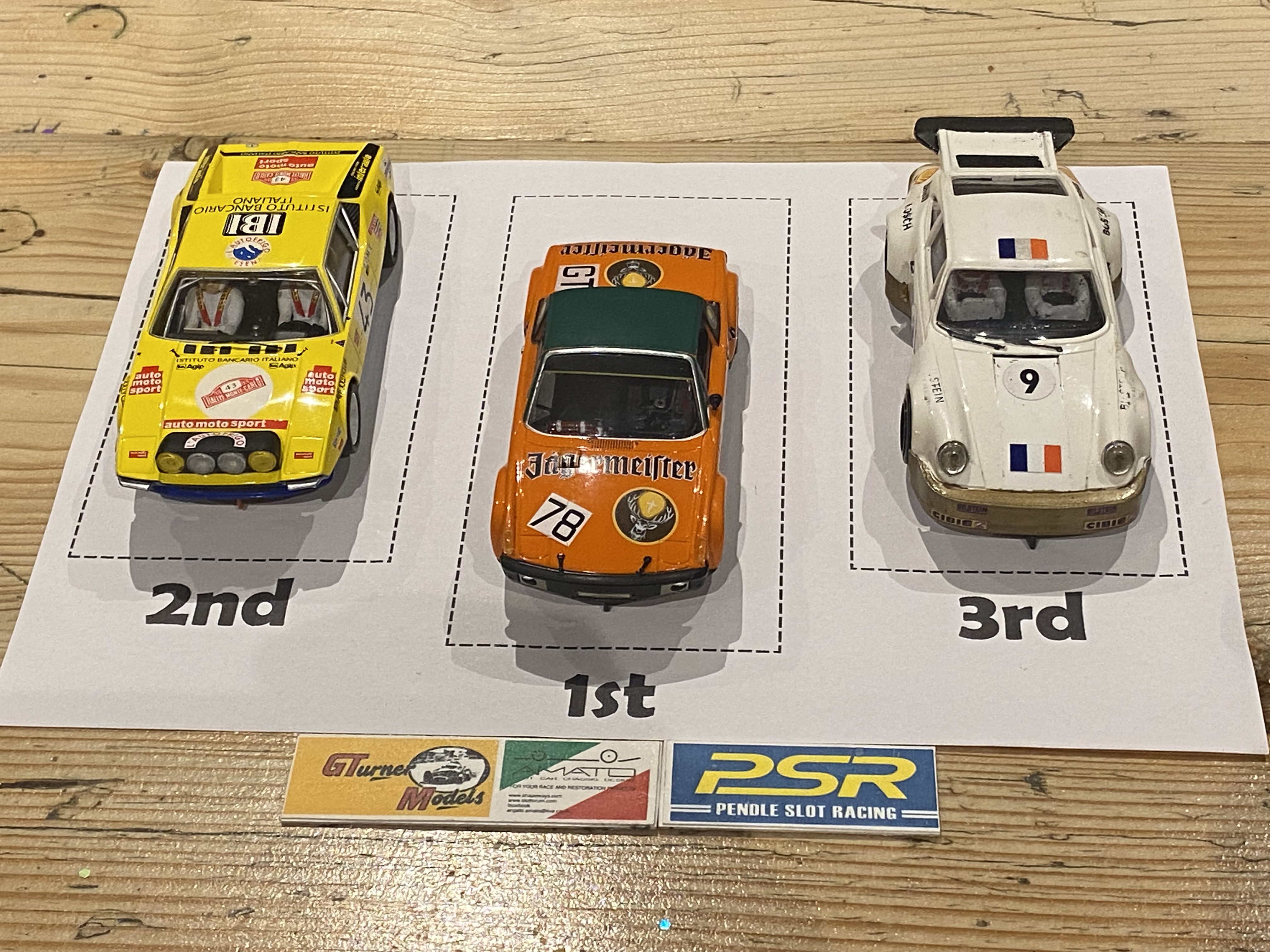

Class C:

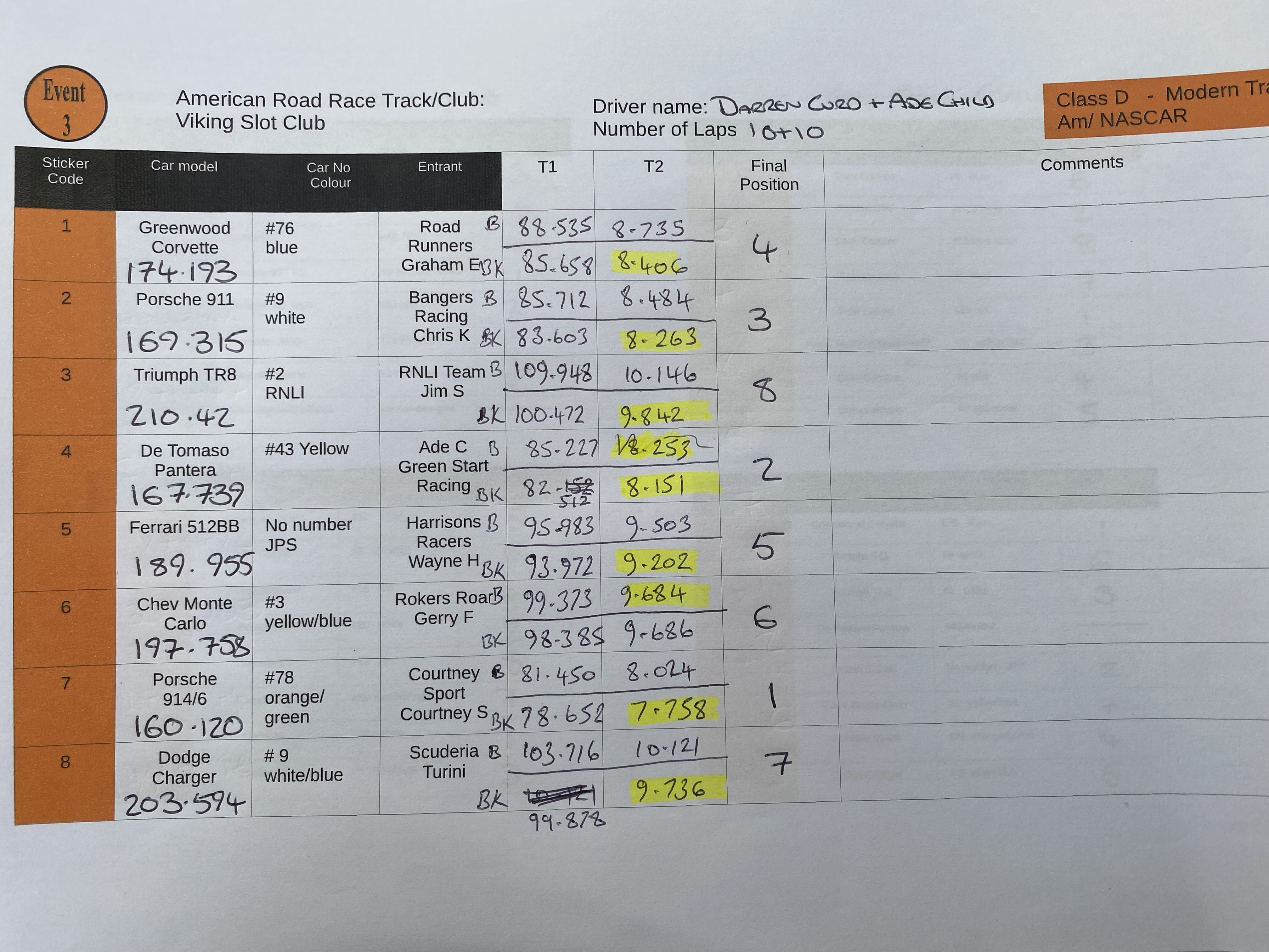

Class D:
Full race report to follow later on... Lot's to talk about!

Class A:
Team RNLI – La Ferrari: It’s a Carrera, which means it’s quite heavy, the motor struggles with acceleration and braking at 12v, and its difficult to find replacement tyres that fit well. Fairly planted, just underpowered for the weight.
Scott Sports Racing – Aston Martin DB9: Nothing particularly wrong with this car, just lacks the punch and grip of some of it’s rivals.
Team Cube – Ford GT & Team Tatters Mercedes AMG: I discussed these two together as they are perfect running mates.  These were so much fun to go head to head with as there was very little between them.  After 20 laps with two different drivers, these cars were separated by 1/10th of a second!
Courtney Sport – Porsche 911 RSR: Surprise result here. This car is fast, smooth and has tons of grip on the bends.  I think it missed out as Viking circuit is a very punchy track with lots of short accelerating sections.  Although this car has it on top speed and cornering, in the short burst sections, it lacked the grunt of its long can motor’d competitors.
Ruscillo Racing – Renault Megane:  Another surprise as this is clearly a fast car.  Toward the end of its first run it developed a slight stutter in certain sections of track. It has extremely long braids and I think these were shorting on something or losing connection somewhere. These were fettled for the second run which was enough to give it the fastest overall lap time in this class; but even after this, it lacked the consistency of the top placed two Ninco’s.
Brumos RSR – Porsche 997 & Green Star Racing – Lamborghini Gallado: Again, these made great running mates. I’d say that the Porsche felt like it was getting faster and faster as the event went on and confidence grew with its handling characteristics. But at the end of the day the Lambo was built to run on this track, plus I think it was a case of the Slot-It P6 tyres being marginally better on this surface than the NSR’s that contributed to the final result… just… by less than a second!

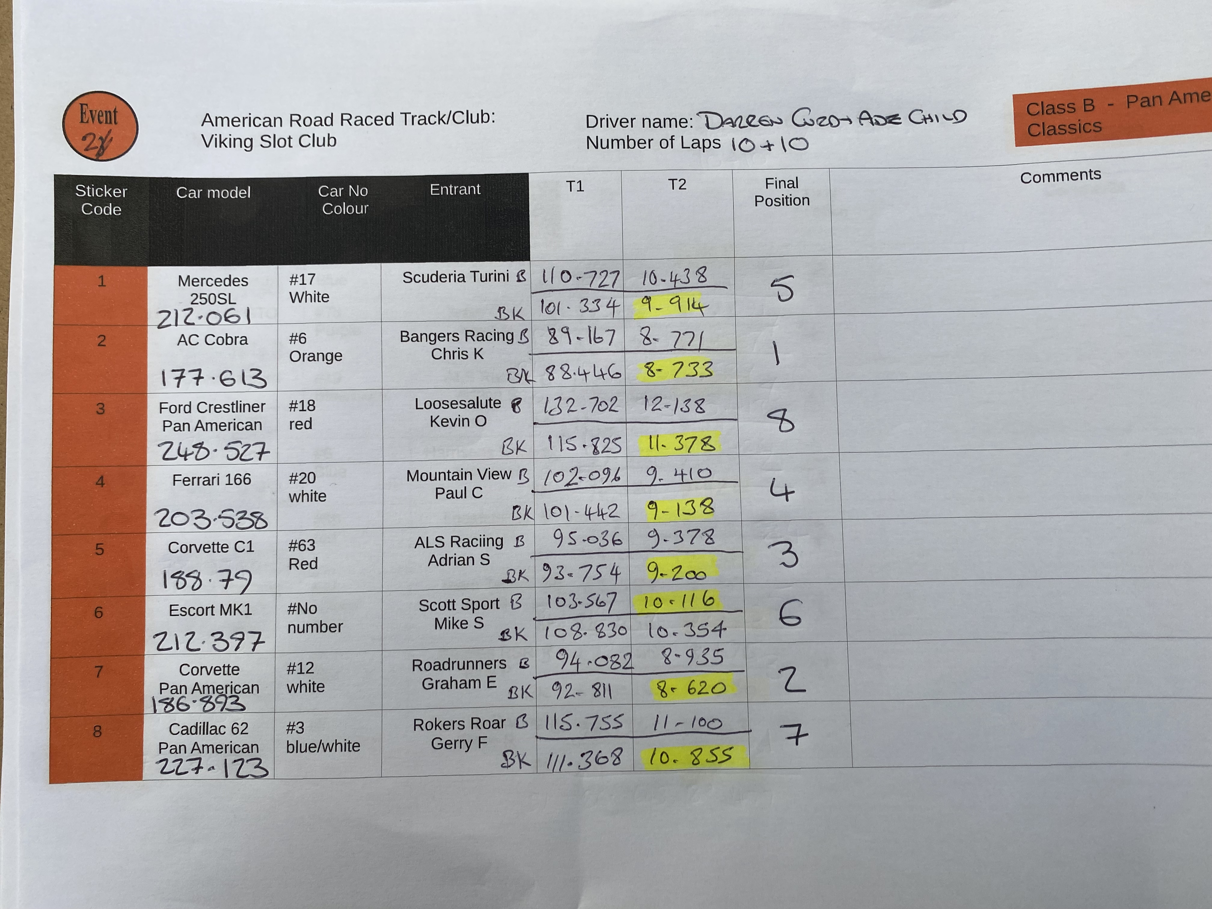

Class B:
Loosesalute – Ford Crestliner & Rokers Roar – Cadillac 62:  What can I say. Thank you so much for sending these in.  This pair were just so much fun to waft about the track.  They are slow, heavy, and a real challenge to get around the corners; and I loved every second of driving these. Other club members were also in awe and filled with nostalgia watching these barges sail their way around. The Cadillac has the edge, I don’t know if this is down to the fact it has more body rock or something else. Either way, great work, both of you!
Scott Sport – Escort Mk1: This car is fun and has a real stock-car racer vibe to it! The huge rear crown gear drags on the track though and the front wheels bind on the body slightly which hampers its performance.
Scuderia Turini – Mercedes 250SL: Very pretty car and crazy fast, a little too fast for the level of grip it possesses. Goes around the track like nervous whippet.
Mountain View – Ferrari 166: Stunning beautiful car, and great performance to match. Only let down by the guide only half engaging in the slot which limits confidence around the bends.
ALS Racing – Corvette C1: Very smooth and a good performer. I’d imagine this would be very successful around a long sweeping wood track. Lacked the punch in some of the point and squirt sections.
Roadrunners – Corvette Pan American: Truly amazing car. Smooth, fast and great to look at. This car had everyone in the room contemplating whether we should be running a tuned classic class at the club.  An absolute highlight to drive.
Bangers Racing – AC Cobra: The results speak for themselves. Effortless to consistently drive quickly.  Great build.
[+] 5 members Like AdeC's post
