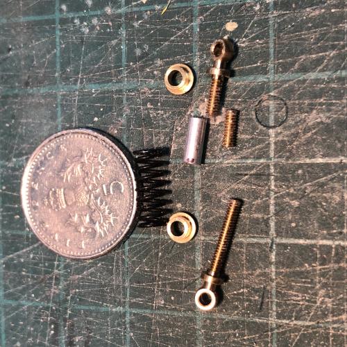

I made the little suspension spring which sits in front of the motor.
I cut a couple of really small eyebolts and a small piece of ali tube, the top bits that sit on the springs were tiny windows for boat modelling.
They even had little plastic in them for glass, there's a model shop closing in Portsmouth and I've been stocking up on small unusual bits. I really dislike internet shopping for things like this as I prefer to have the bits in my hand to see if they're right.

You explained it exactly how I wanted to Leo, you can never tell proper scale by pictures in my opinion.
In the picture of me holding the spring, it looks bigger than it is and yes it did fly across my bench a couple of times fitting it Rofl

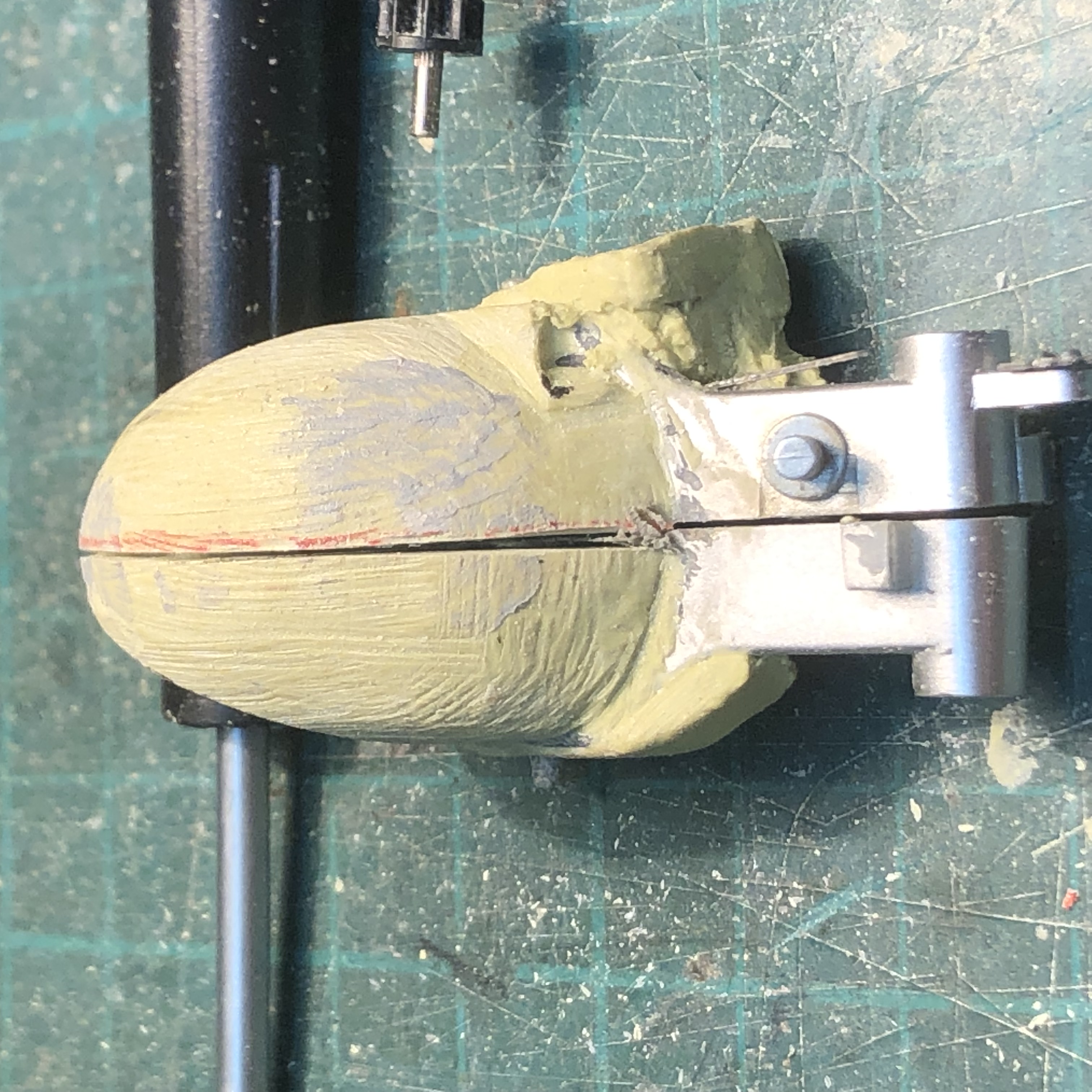

A little bit of progress at the end of the week, had a horrible cold which haven't had one for over 3 years.
Hopefully thats my fill for a while.

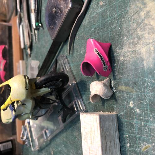

I've made the separate fancy front mudguard.
Cut a slice of balsa and drew the rough shape, then used a carver's chisel to start and then did most of it with the dremel.
It's a bit of a brain scratcher trying to get curve shapes as this thing has subtle curves in all directions.
I've got it to a stage I'm happy and just need to add a bit of milliput on the tip and need to shape it carefully, can anyone recommend small sanding pads that aren't big and cumbersome?
I wanted to remove the motor to shape some of the chassis but realised I couldn't as I've milliput the mudguard as one and the motor mounts are sandwich in between  with two bolts but the problem is there's a plastic nib in the middle of them which I should have grinded away.
So a bit of head scratching and I decided to cut down the middle of the mudguard where the join is and then I was able the use the scalpel to remove the nib.
Filled the cut mark and now I can remove the two bolts and slide it out when I need to.
