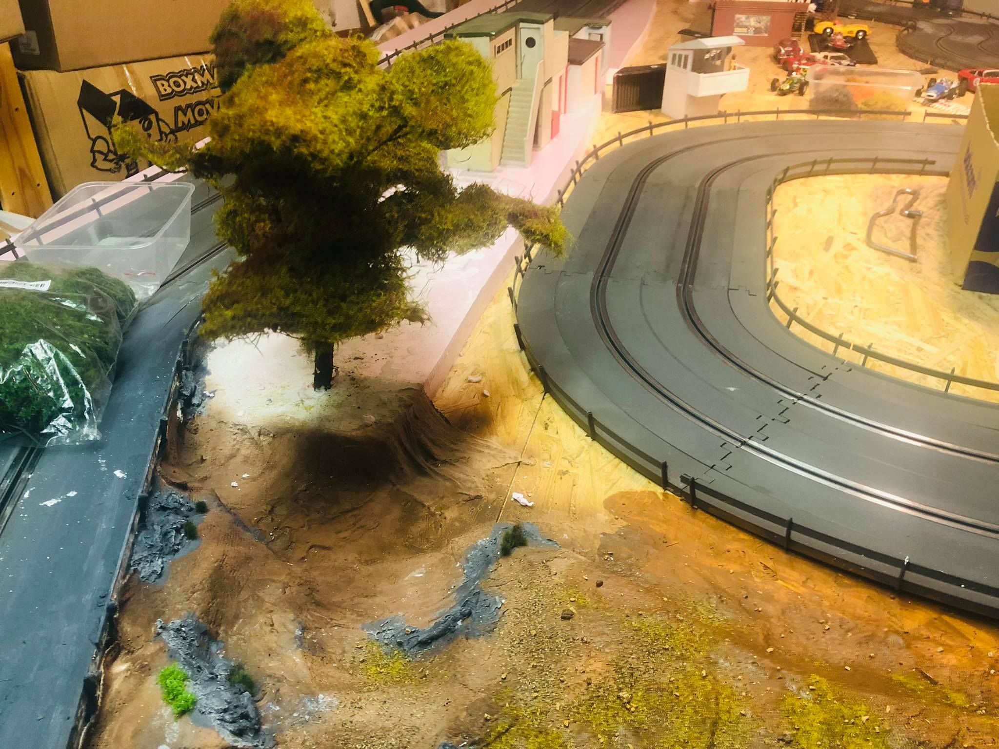

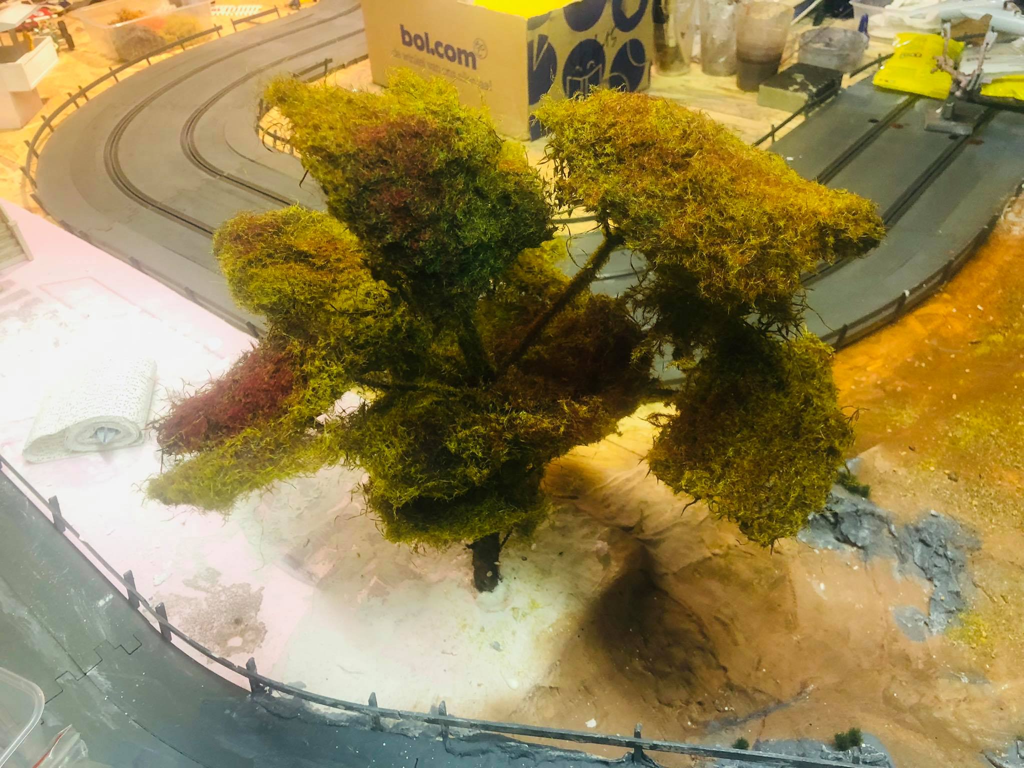

Here is my humble attempt at 2 trees. (the others are store bought)
They are not easy to do.  I now comprehend why you do not use acrylic paint to cover the skeleton including the steelwool - it is WAY too heavy and does not shake out/drip dry easily. And I mixed the paint at a 60/40 water  to paint thin ness. As Hub says - practice does make perfect. I will add 'foliage' to the trees when I get all my stocks sitting with my daughter at the moment. I have wrong colours here at the moment. Nowhere near Hubs class yet  Sun
Tree 1
Tree 2

Anthony, you made a fine base.
If you want to improve your trees, you must first wait for them to dry.
Then you can stretch the steel wool a little in every direction, so that more volume is created.
Use a small screwdriver or a pair of tweezers.
Adding some small stretched dots of steel wool will increase the volume even more.
Use some spray glue and sprinkle the mixture of grits/foliage over the tree.
Shake the tree at the stem and leave it as it is. Don't touch the steelwool again!
I hope this will help you to get more volume into your treetops.
