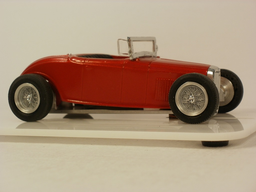

I went the complete scratch built way and still had a hard time hiding the chassis. The front axle almost lines up with the grill on the real car. I had to move the guide behind the axle.
Best of luck with your 32 Ford! I look forward to seeing it.
Ken
That is sweet!! Nice job!
