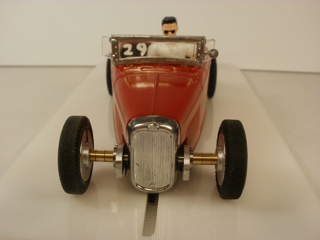

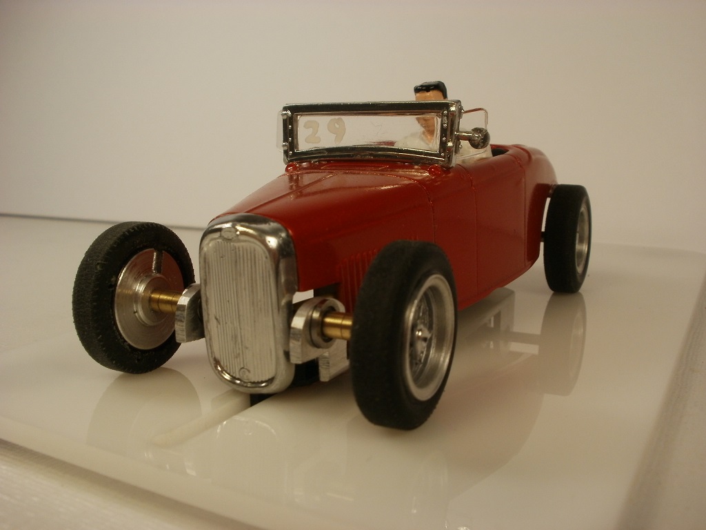

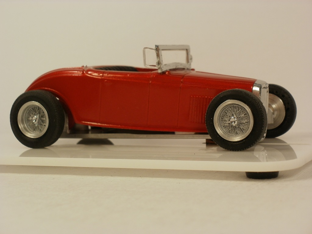

The 32 Ford is very narrow at the front. It's hard to hide a pre-made chassis under it. Policar makes a narrow assembled rear chassis section for F1. It might be possible to adapt something scratch built for the front and fit it to your body.
It's available at Pendle Slot Racing.
https://www.pendleslotracing.co.uk/policar-f1-assembled-narrow-motor-mount-axle-45mm-z16-gear.html
I went the complete scratch built way and still had a hard time hiding the chassis. The front axle almost lines up with the grill on the real car. I had to move the guide behind the axle.
[attachment=14043]
[attachment=14044]
[attachment=14045]
Best of luck with your 32 Ford! I look forward to seeing it.
Ken

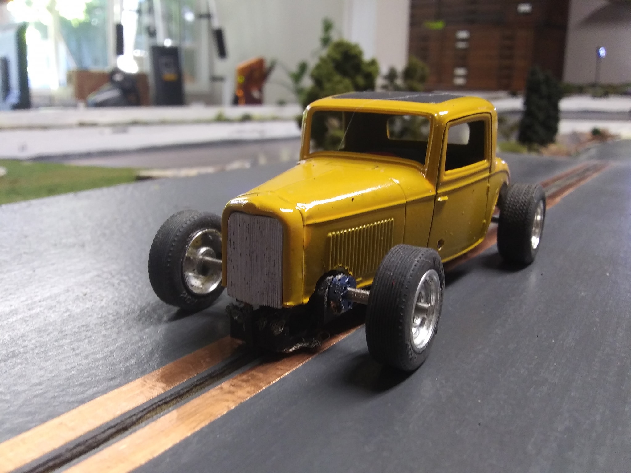

Here is a build thread on the 32-Ford for your review. I hope it inspires you, and you find something useful.
https://slotracer.online/community/showthread.php?tid=1706

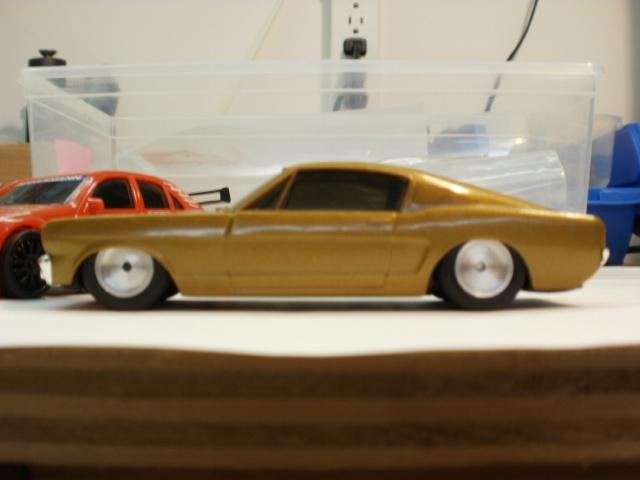

RE: Chassis - KensRedZed - 19th-Apr-21
Mr. LHP,
There is another way to make a static car run. But it's not pretty. Find an old $10 car in your classifieds and chop up the chassis until it fits. It won't break any land-speed records. But it may get your 32-Ford around the track.
This is my first attempt at scratch building years ago. It's an old Eldon body on an outdated chopped up Hornsby chassis. Aluminum wheels were added. The car in the background on the left is similar to the doner. It was a simple solution to a missing Eldon chassis at the time.
[attachment=14076]
