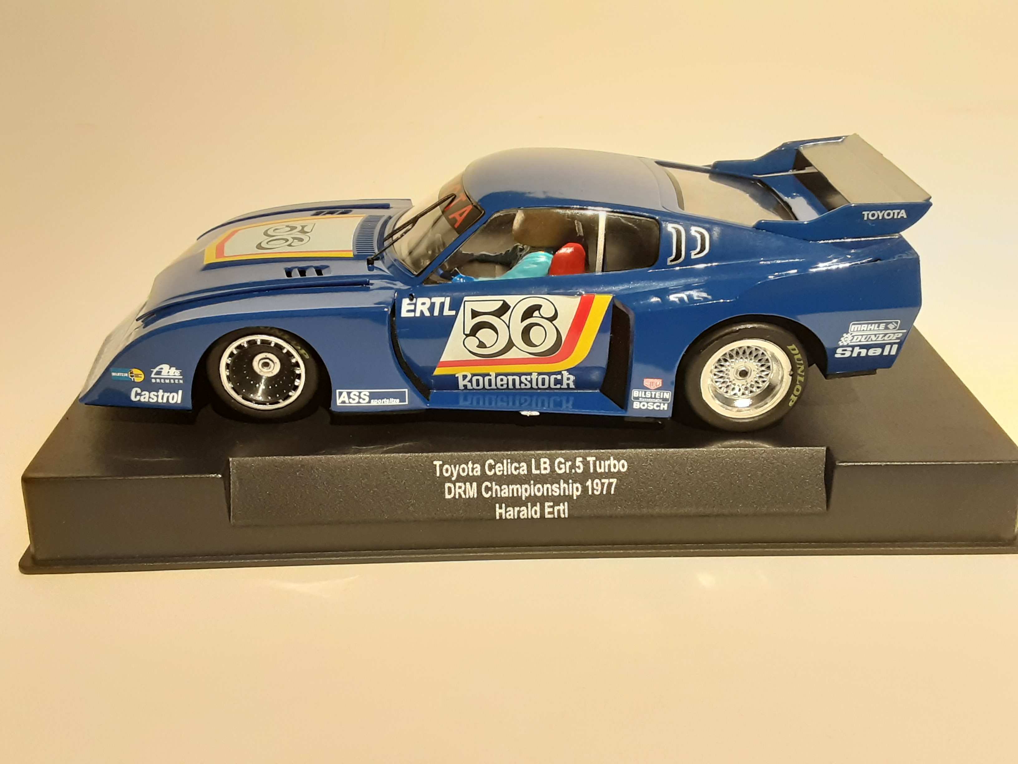

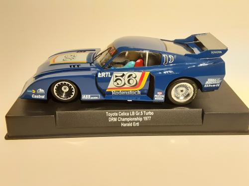

The car:
One of two recent releases from Racer Sideways, the other being the Nissan Skyline.
The pandemic does not seem to have even broken the stride of this company at all.
The question is "Does it have the same quality as prior releases?"

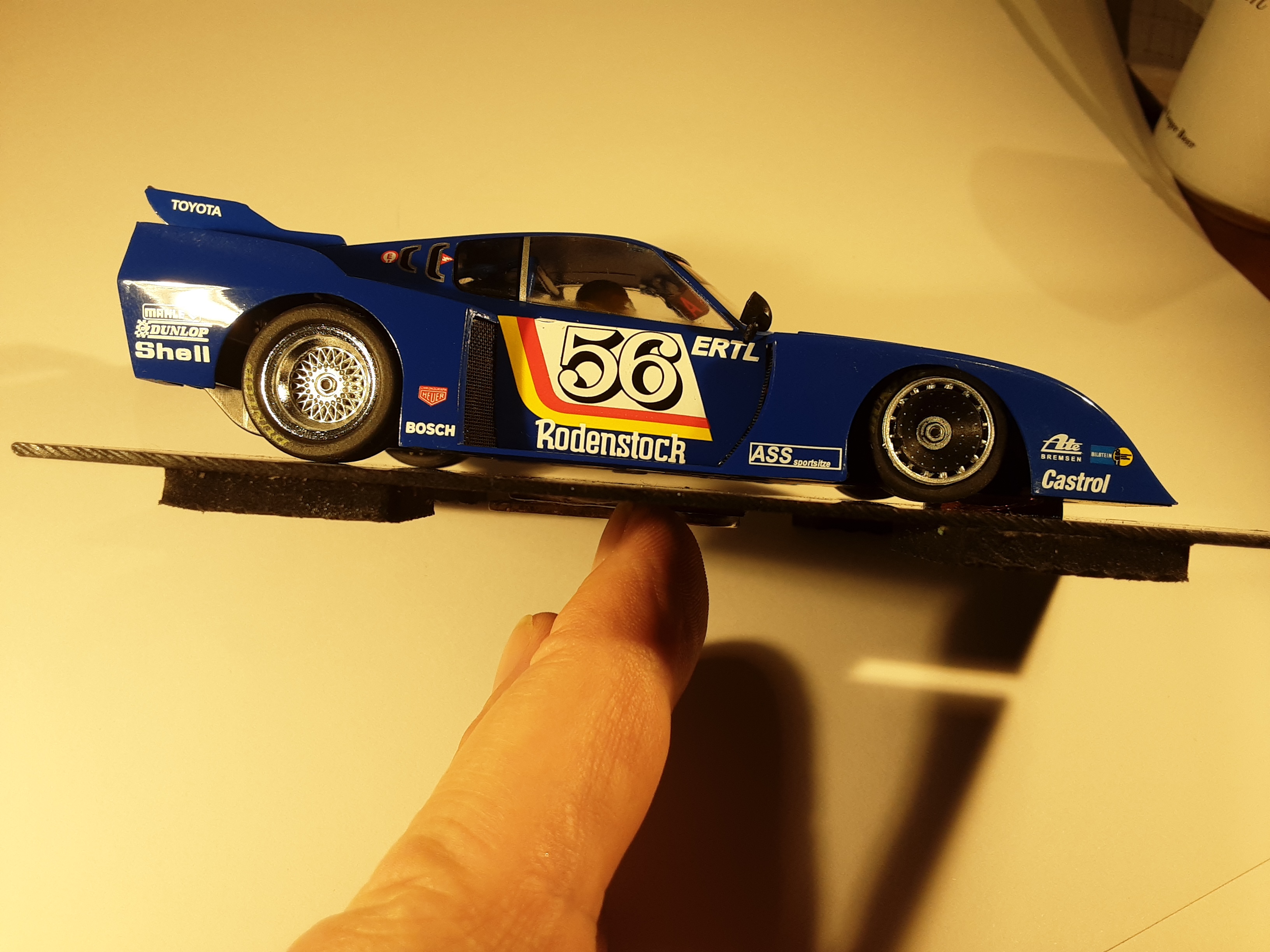

• Flawless paint and decalwork.
• The car was locked up tight when removed from the box.
All screws turned really tight which is a shame considering that the car is factory fitted with collared screws and washers.
The body and pod screws were loosened, but the body was still stuck tight.
The tight body turned out to be a result of the chassis/pod and chassis/body interfaces which interfere with each other.
To set up for racing, trimming and sanding will be required.
• The guide did not self centre.
• The Mirrors were fitted but not glued.
Good if you want to keep them aside for racing instead of them being lost in an on track incident, bad if you are home user who just wants to de-box and run around home track because you are sure to lose these.
• Power, Transmission and Wiring were sub optimal.
The motor wires were not routed through the guide routes or chassis routes except for the front two, see pics.
The motor wire routing was the root cause of the non centring guide. A little additional attention to detail in the build process would have been good here but given that this is a Chinese factory build, the quality of the build is still much better than most chinese builds I have seen recently.
The axle was set too loose with excessive play left and right.
In an angle winder setup , a loose axle is better than a tight one, but setting the the axle up correctly would take no time in the factory build.
The ride height was quite high. For home use, its a good compromise to have high factory ride height because a car that is supplied so that its rear wheels don't touch the track will probably end up in the bin.
For club racers and tuners , ride height will need to be optimised for your track.
The guide did not self centre out of the box.
More about that later.

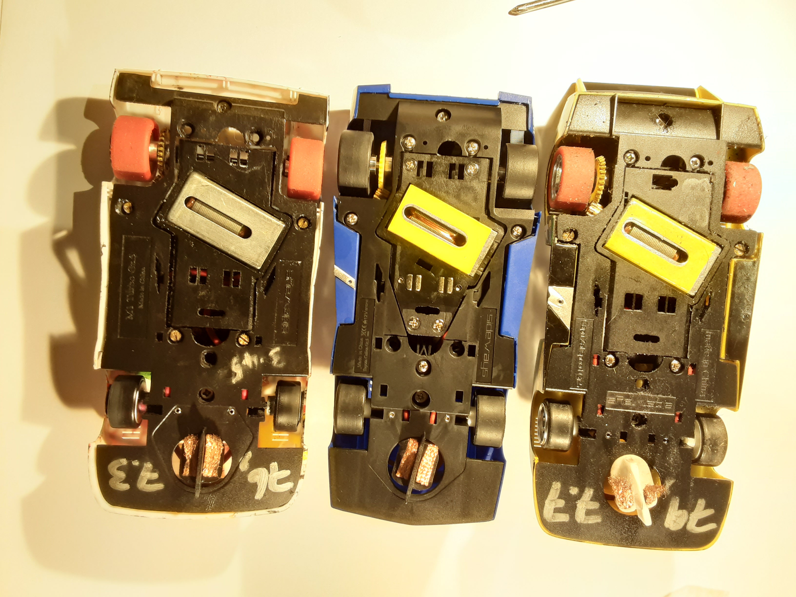

Left to right:M1 Celica Capri
Dimensions, and overhang.
Rear body width
65.5mm
Front body width
58mm
Rear track width
62.5mm
Front track width
54.5mm
Guide length
93.7mm
You can see from the chassis comparison pictures that the celica has more overhang than the M1 but less than the Capri which puts its polar moment right between the two. Both the M1 and Capri are good performers so the signs are good.
