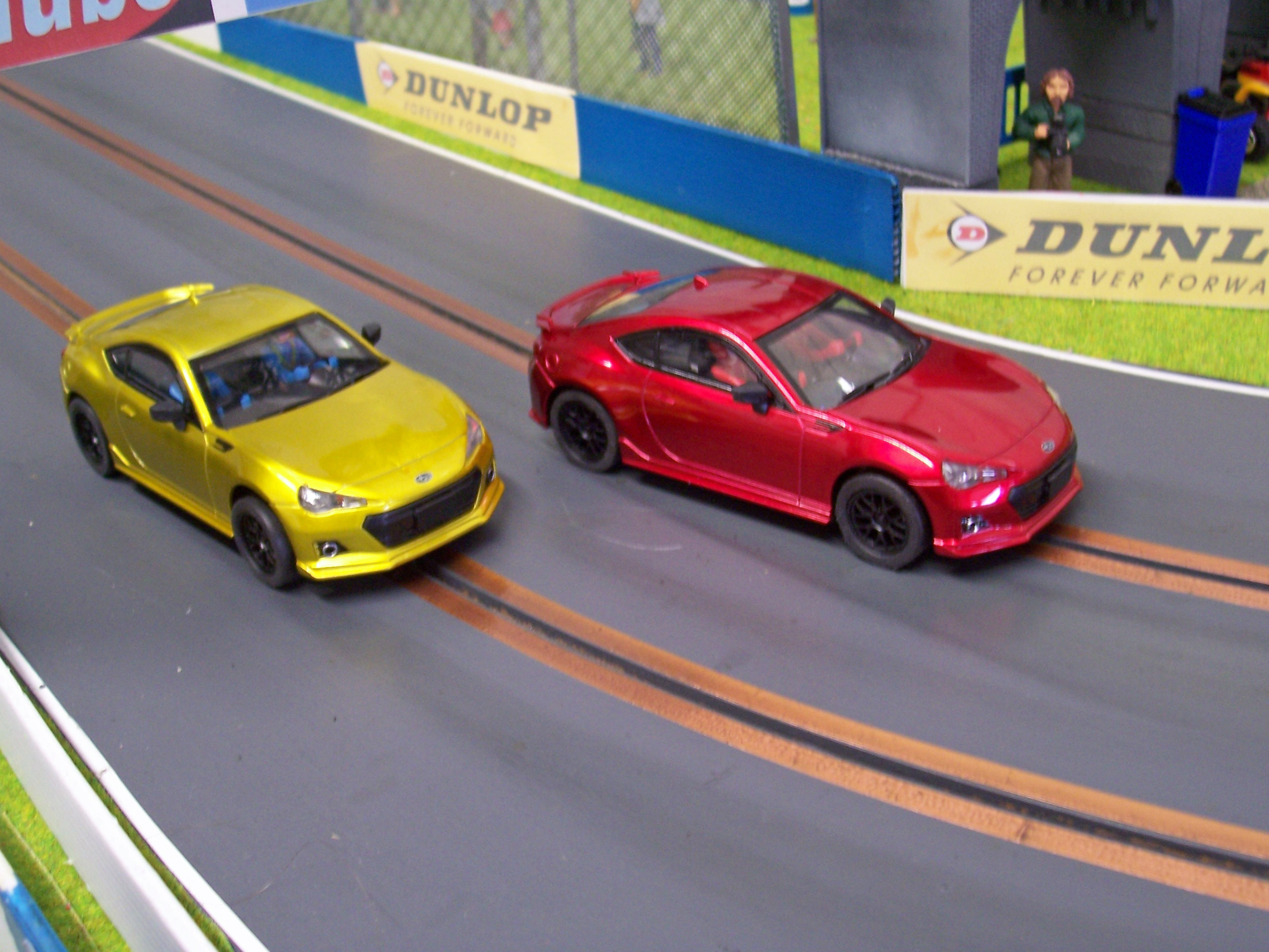

Slot cars are getting bloody expensive with Scalextric, Carrera and SCX priced round the £50 mark and upmarket cars such as Slot.It, NSR etc from £60 upwards to silly money. Now a car that retails at about £22 stands out from the crowd somewhat but that is what we have in the shape of the Policar Home Racer series so are they any good?
At that price level I would expect blacked out windows, no interior and cheap components so it is a pleasant surprise when you discover that they contain Slot.It parts with a full interior and front lights as well. They are undecorated road cars in somewhat garish metallic colours but impact resistant with rubber mirrors and windscreen wipers. There is also a rally version available for a couple of pounds more if you prefer fully liveried items and a Toyota version as well.

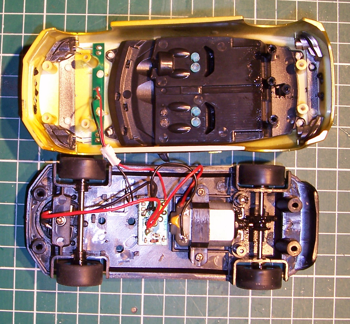

Removal of the usual 4 fixing screws reveal this:
First thing to note is that there is a wiring harness for the lights which is attached to both the body and chassis so you have to be careful removing the body or you can pull the wires out and have to resolder them. Ask me how I know this! Tappingfoot

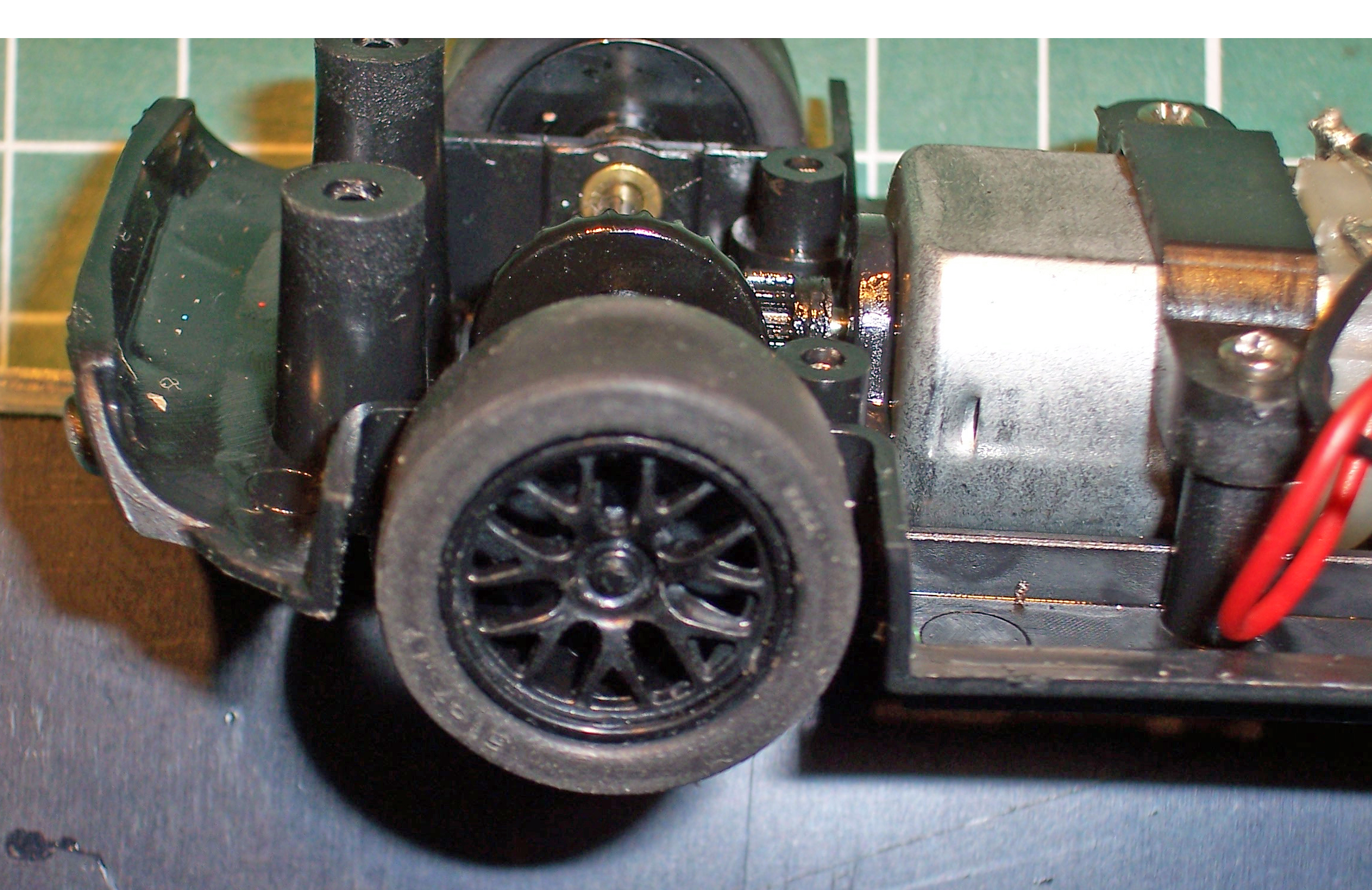

A nice touch is the screw fixing bracket over the motor which avoids the need to glue it in. The rear axle mount is an oddity though, the axles run in brass bushes but they are captive mounted in holes not slots so the only way to remove the axle is to remove the wheels - not ideal with plastic wheels. You can't pop the axle out like you can in other cars which is somewhat strange to say the least.
The driver platform is also peculiar as it includes a passenger reading pace notes which is not something you normally find in a road car. This is a left over from the rally version and is easily altered if it bothers you.

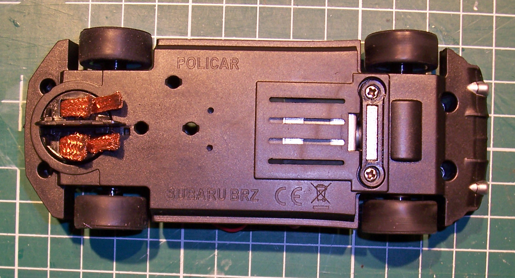

Chassis
Bearing in mind that Policar is wholly owned by Slot.It the chassis is a departure from their normal versions and seems to be a bit of an SCX/Carrera hybrid. The magnet follows SCX practice in that it has a 2 screw attachment underneath rather than being fixed inside so is adjustable and/or removable very easily. This is an excellent system for the magnet racers amongst us and should probably be standard practice across all makes.
The guide/braid system seems to be a direct copy of the Carrera version with bespoke braids which restricts you to manufacturer replacements or a lot of fiddling about each time they wear out. Nothing wrong with the system but an unnecessary departure from normal Slot.It braid replacement I think. If you wish to modify it then Wasp Slot do a Carrera guide adapter that fits in the hole once the original guide assembly is removed. You need to cut the legs off and glue it in position, but it does allow you to use a Slot.it guide (plus many others). LINK
Early versions of these cars were fitted with 13500 rpm motors but were later upgraded to 17000 so roughly on a par with Scalextric.
