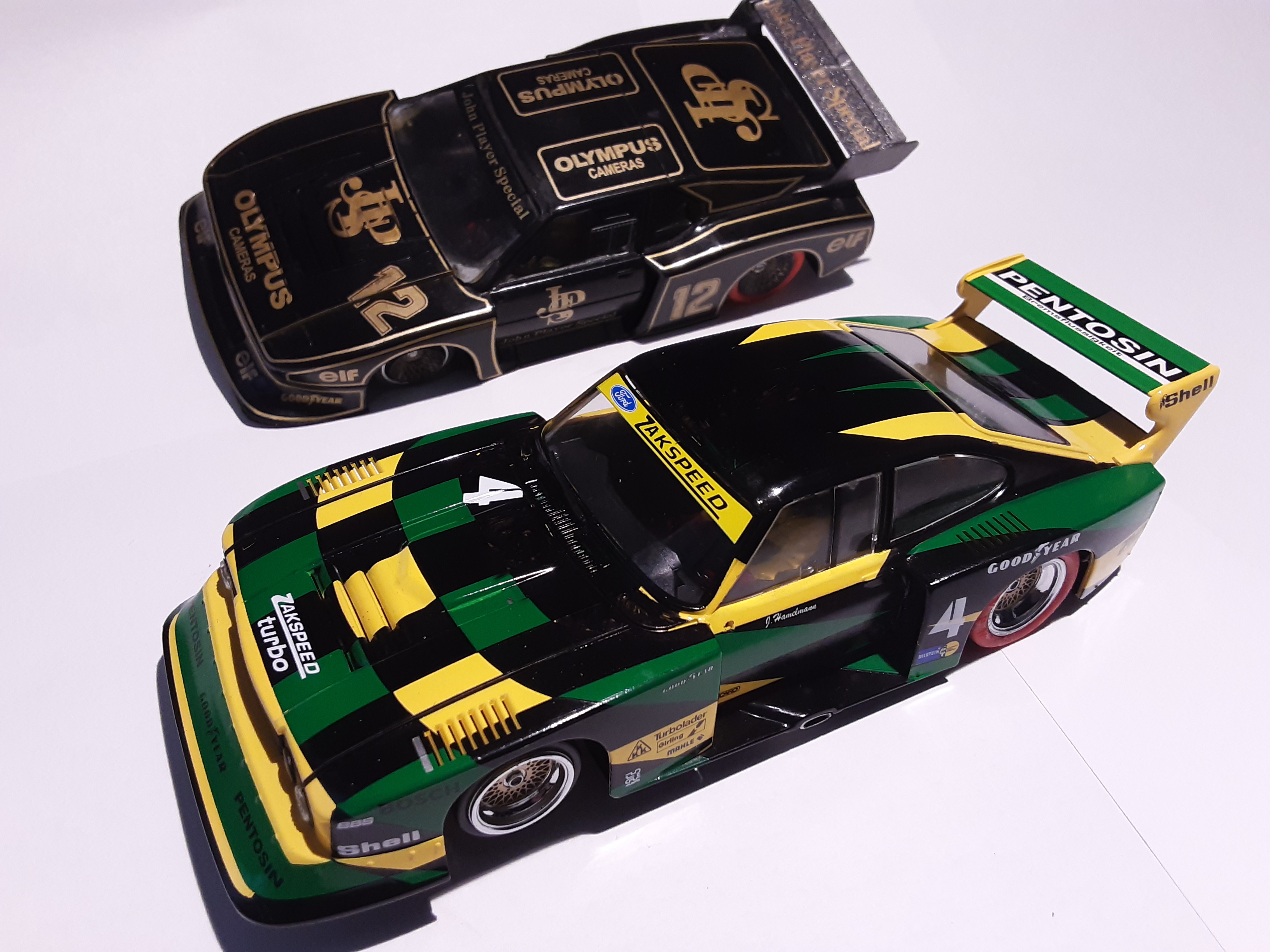

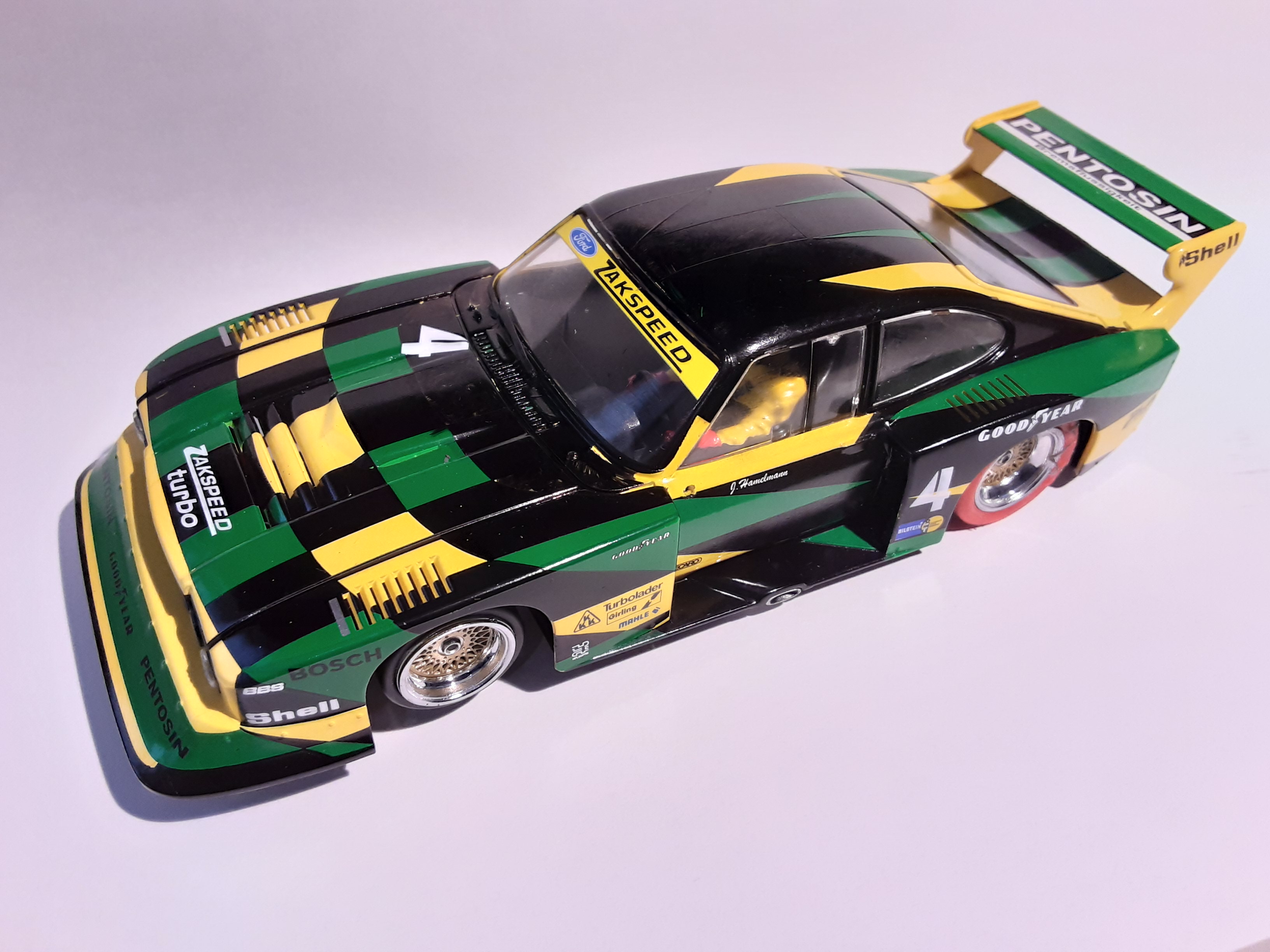

First impressions.
Lovely paintwork, well constructed. Straight out of the box, The car ran on my rolling road without any issues at all. ?
No paint flaws, no binding axles, no rubbing wheels. The guide even self straightened. ??
A quality build. The only issue with the car was a rear wing upright that had broken free (probably through hard handling as it was boxed up at the factory). A dab of super glue, easily fixed.

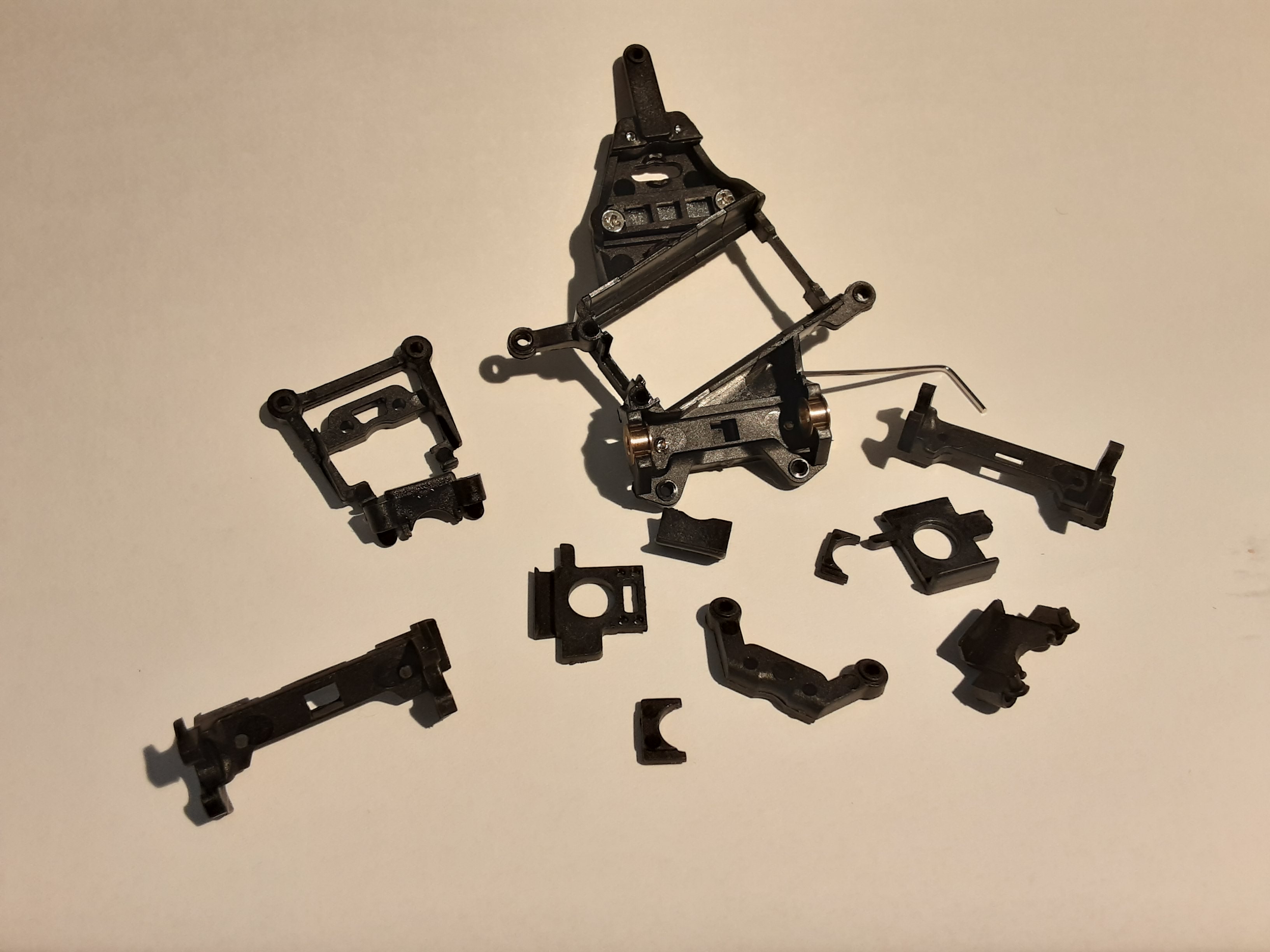

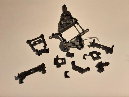

The racer sideways 5point pod (see pic) is perfectly adequate for most needs.
The pod even comes with parts to adjust the ride height of the car, effectively providing two offset options without changing the pod itself.
So... why change the pod? ?
Under high grip conditions the Racer Sideways pod can exhibit tramping, also colloquially known as "Ninco Hop".?
The tramping occurs because the axle is not held rigidly enough in line with the axis of the rear axle.
There are some fixes for the Tramping which may or may not be permitted at your club (if you do club racing)
1. A DIY truss/strut glued in place between the motor can and the right hand edge of the pod ( the non crown side)
2. Resin-fill the trough in the pod between the motor and the axle.
In the pic of the racer sideways pod above, I have pointed the long end of the Allen key exactly at the location of the trough.
At our club, these kind of DIY fixes are not permitted. A Slot.it CH75 zero offset anglewinder pod is the upgrade path.

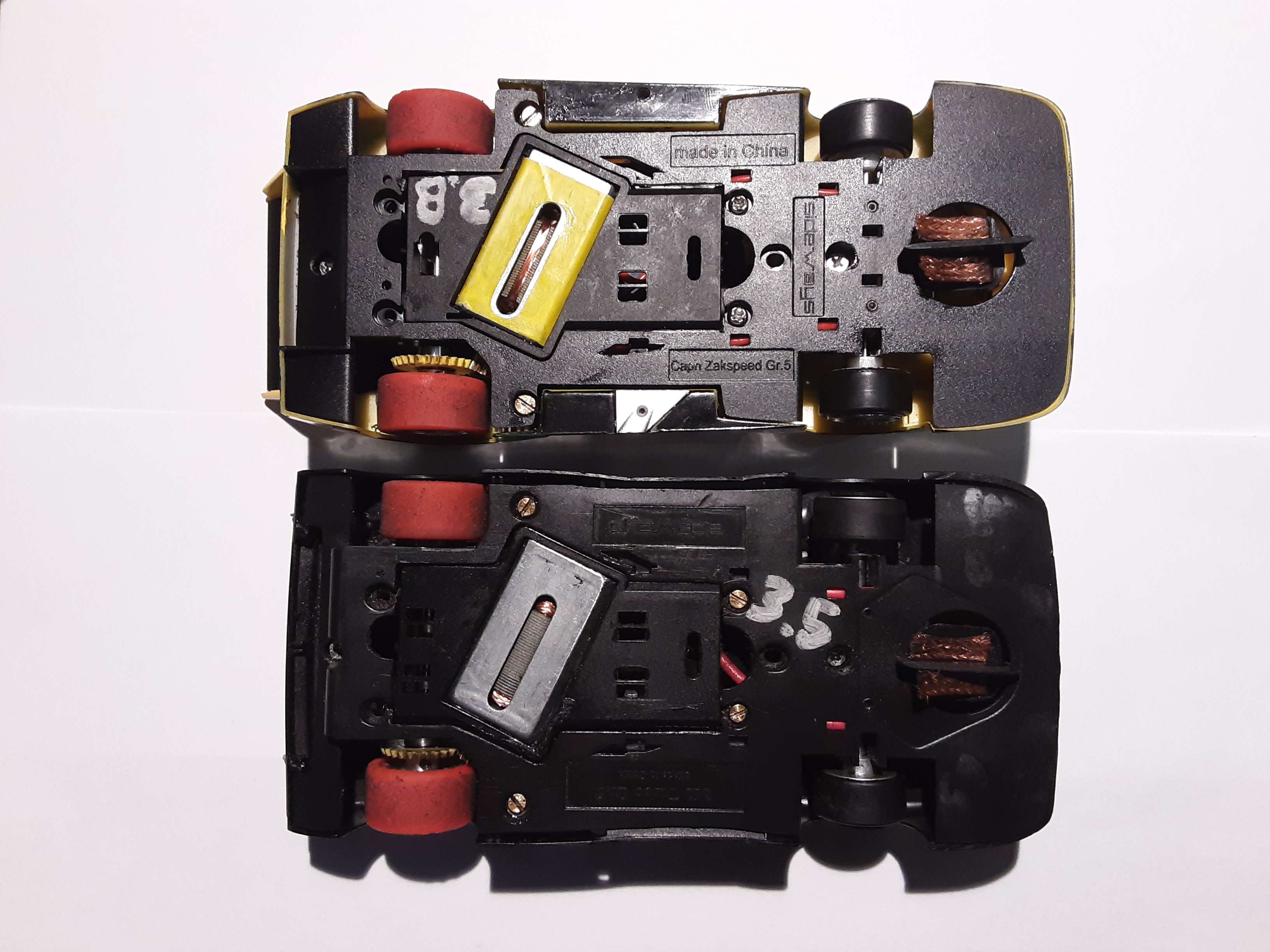

Guide to rear axle length is identical to the M1, maximum rear axle width (before body fouling occurs) is also the same.
The Capri has slightly more overhang at the front and the rear making it a longer car. The length makes the Capri look thinner but its rear wheel arch measurement is identical to the M1 , 65mm.
See chassis pics above.
