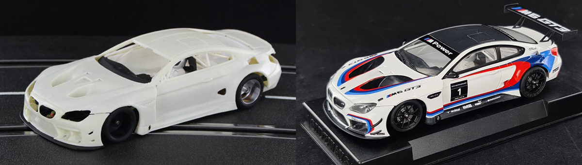

Announced in dec 2015 in a Christmas greeting on FB, restarted twice with 3 different 3D designers, the long awaited Bavarian GT3 racer from French company Sideways International has finally become available to the slotrace community. As has become custom with many manufacturers, the first available iteration of the BMW M6 GT3 has been released is in the form of a white kit.
Meaning that it is up to you slotracers to transform the kit below left...into the slot car on the right.
Time for a first hand review.
