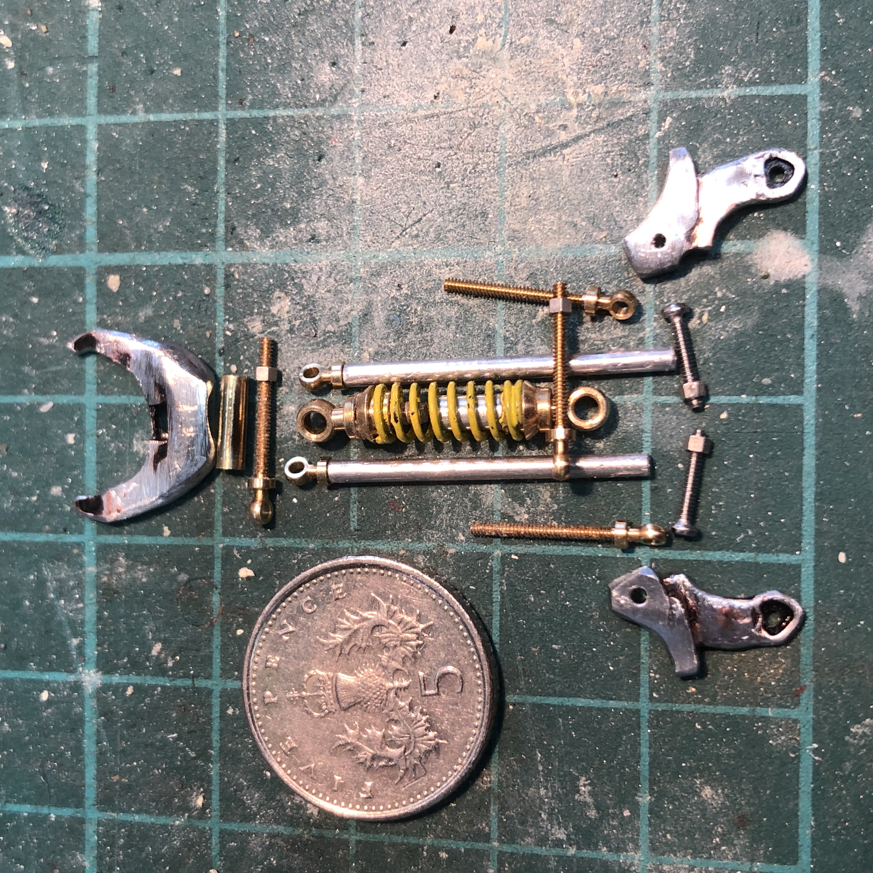

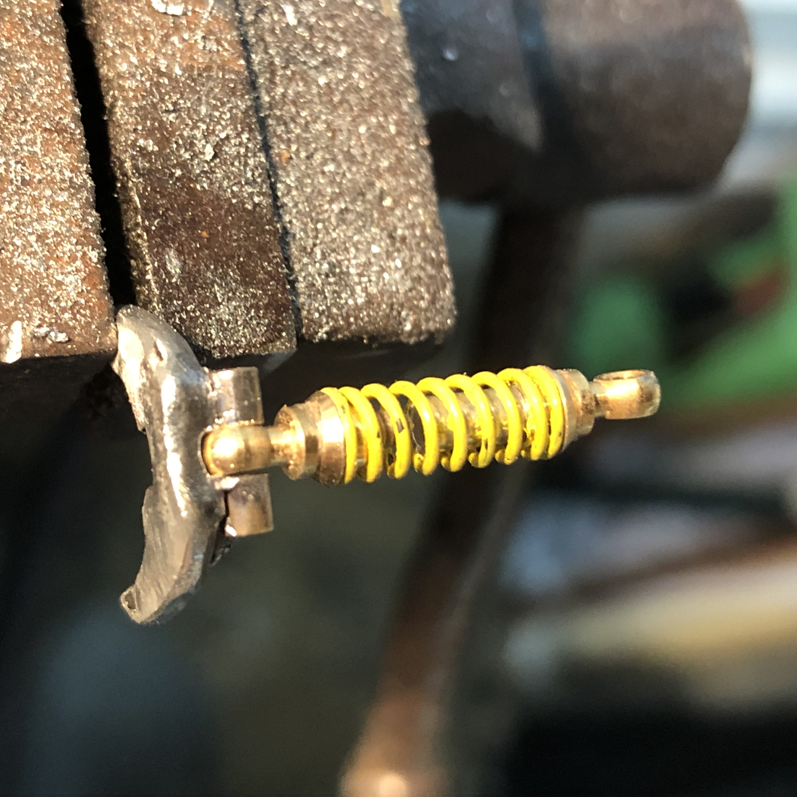

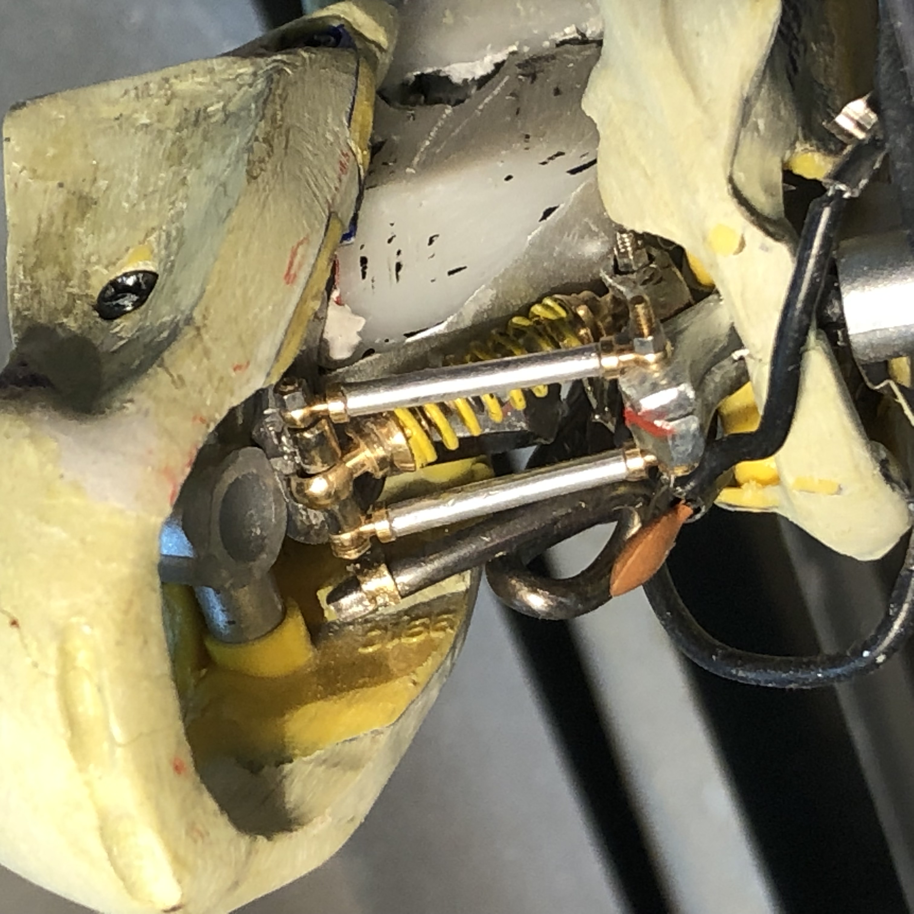

I got the front spring setup almost sorted yesterday.
I used many different little bits I got from the local shop that shut last month.

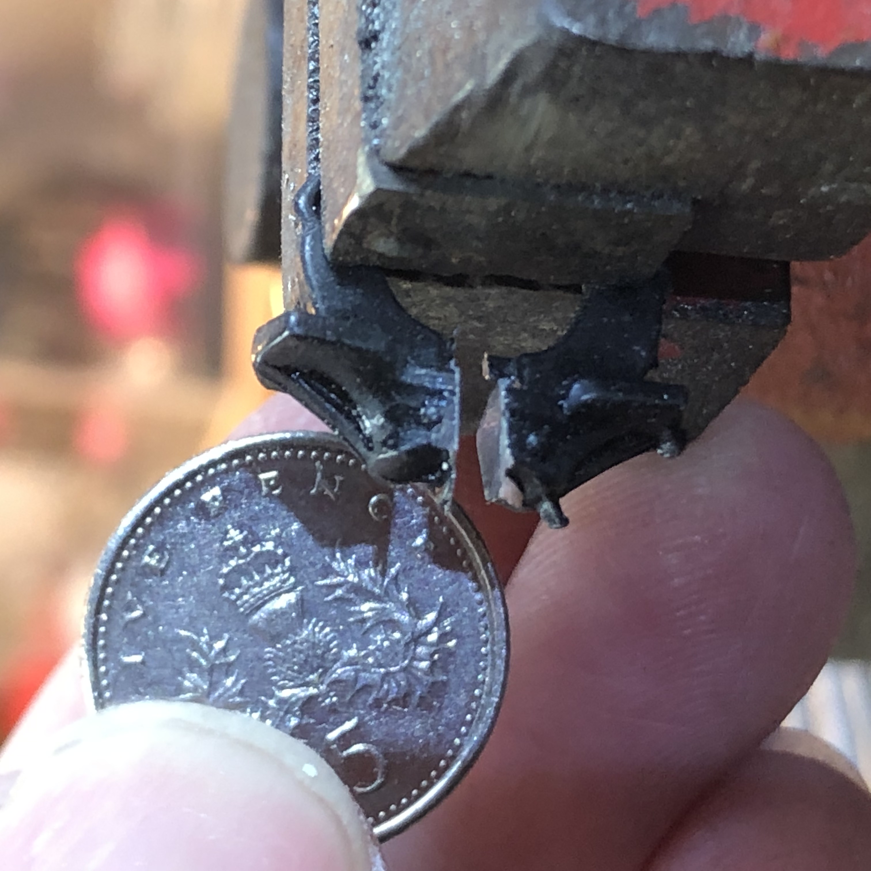

I used these little things which I think are cast anchor's for model boats, I ground the top one and cut in half and ground down the bottom brackets.
The little nuts and bolts are awesome, I got them from https://prime-miniatures.co.uk/home
I can't remember where I found their details but they are fantastic to deal with, it may even have been on here.
I just need to make a little spacer for the bottom right and a little bit of shaping so the front mudguard fits and then I think I'm ready for paint.

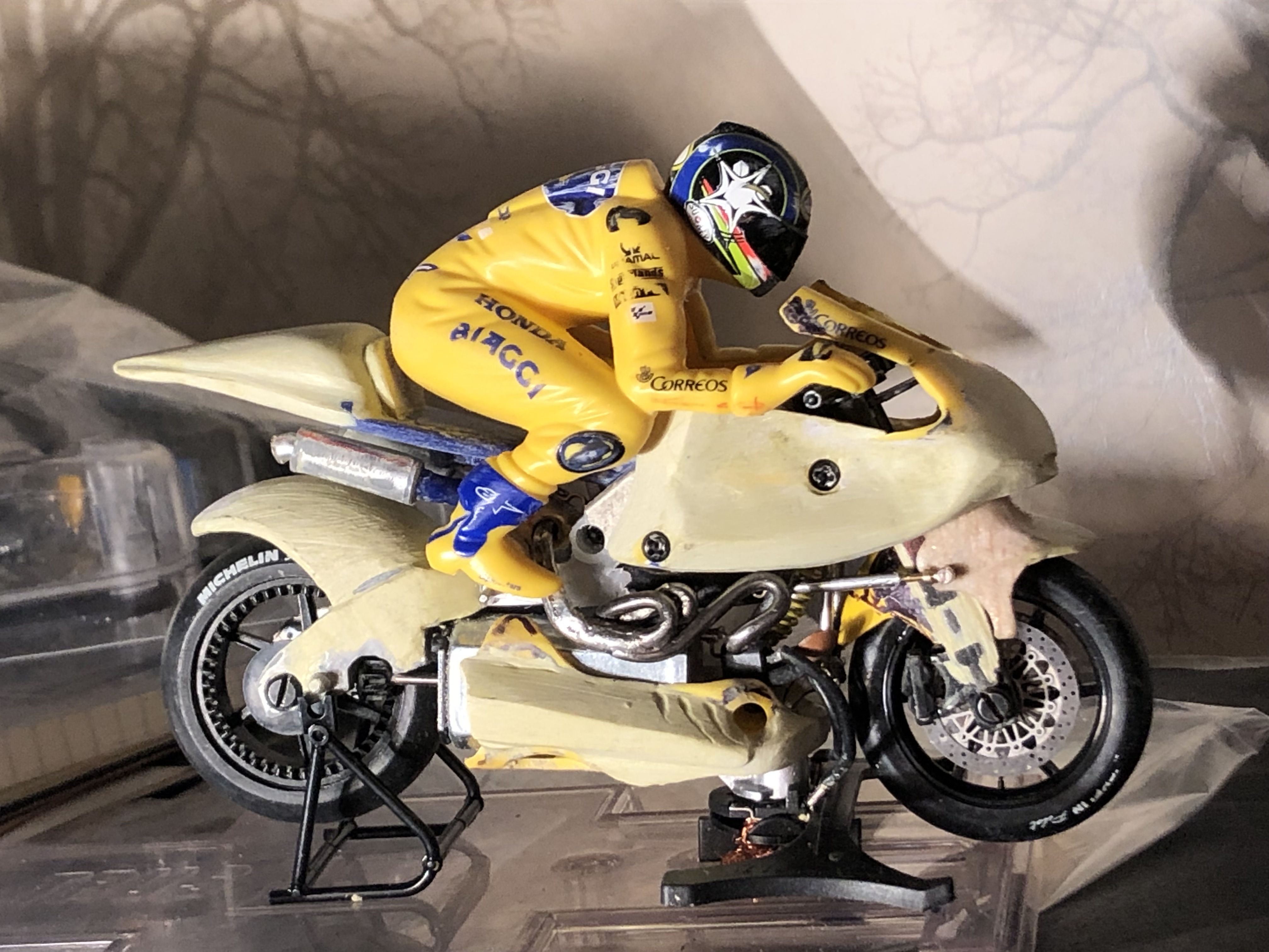

I've done a test run before I start painting and it kept deslotting.
I've obviously added more weight to the back and the power of these little motors jerk forward quite quickly.

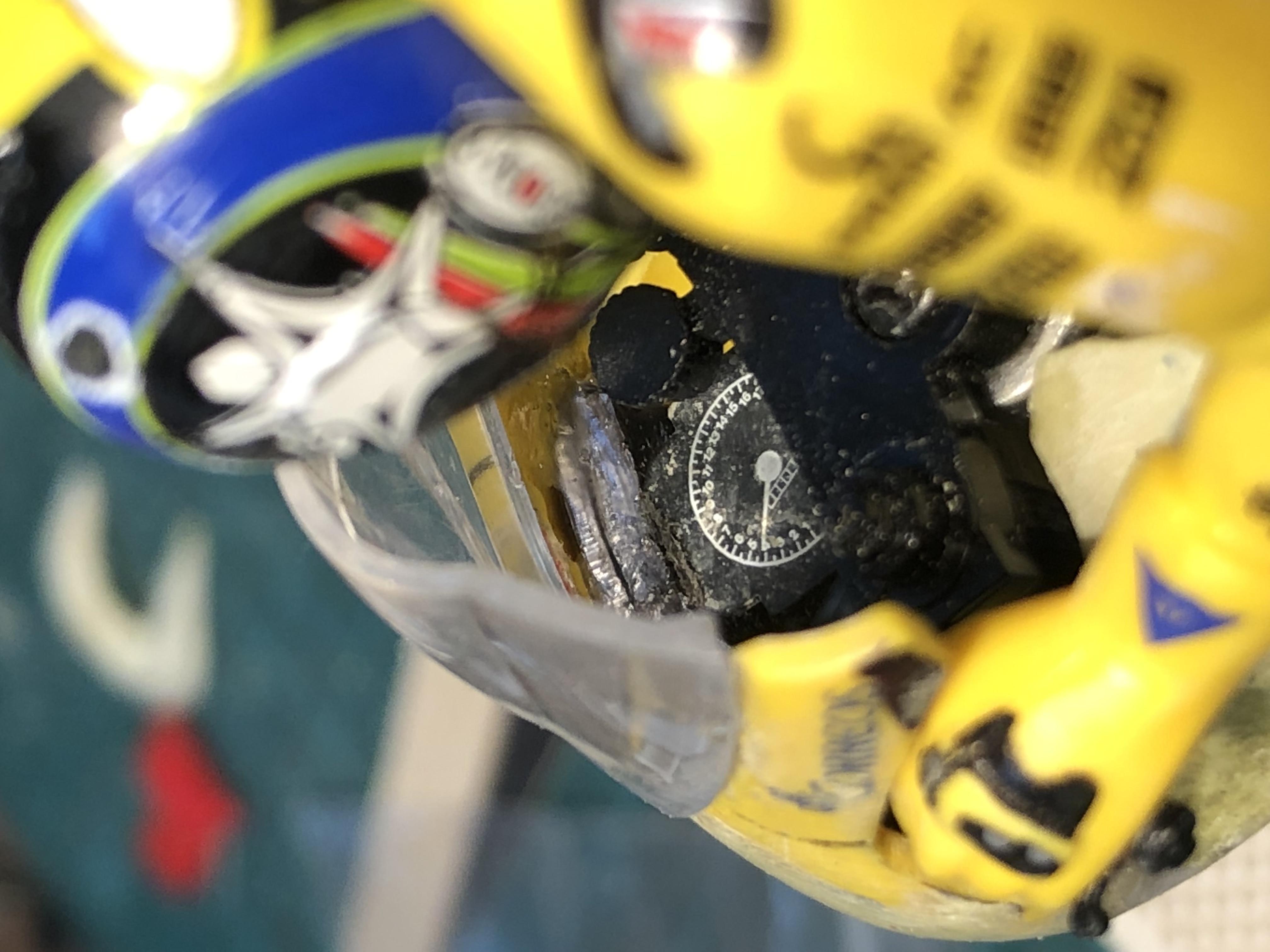

So I cut some lead and glued it under the screen in the front of the fairing.
The guide now sits nice and low and she goes around the track brilliantly.
On the original scalextric bikes they have a little magnet under the back fairing, but I've done test rides with and without and I find it more fun with out as the bikes drift better and it's a little more realistic.
One thing I can't get my head around is the different response from the scalectric controller to the Truspeed one, you only have to lightly touch the truspeed one and the bikes are off, it's honestly like driving a Morris 1100 compared to a Ferrari.
How can there be so much difference in response? or is that just opening a technical can of worms?
Off to the paint booth with a big smile on my diel, I honestly didn't know if this would work properly but am over the moon it has.
