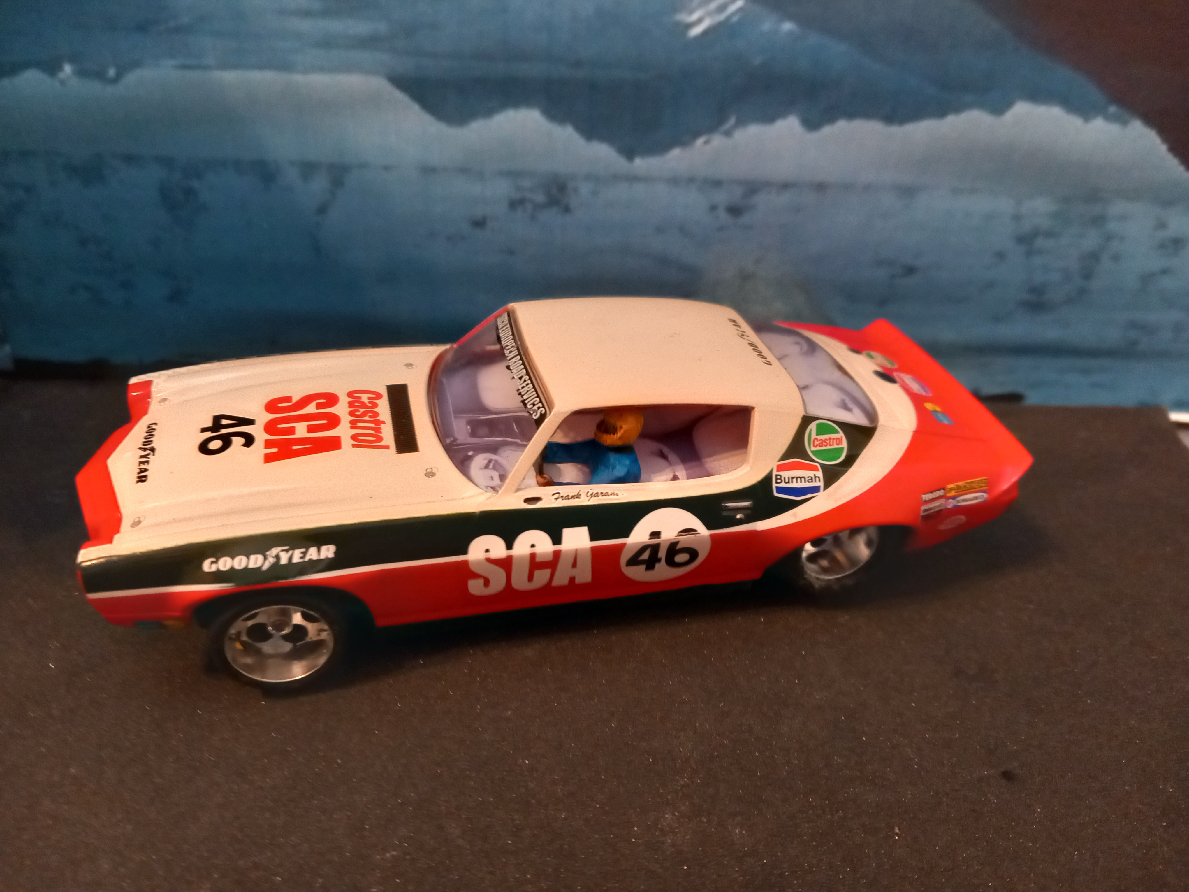

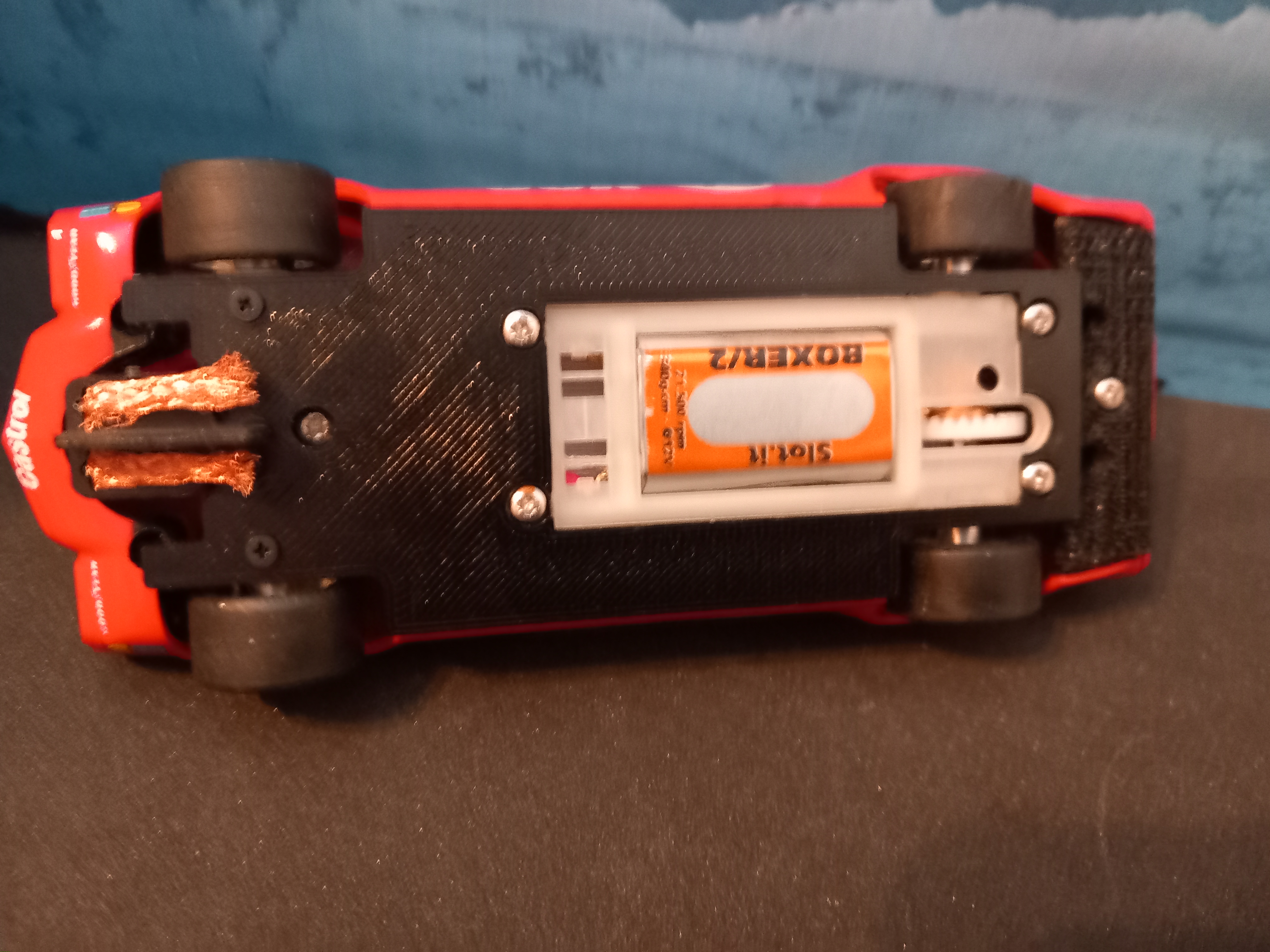

First one ready for track testing, just waiting for my 3D printer man to do some inserts for me.
Frank Gardners Camaro.
Scalextric Shell, Amato Chassis, Slot it offset pod, Boxer/2 21.5 k motor, Slot it 9/29t offset gears, NSR wheels and tyres, Slot it guide.

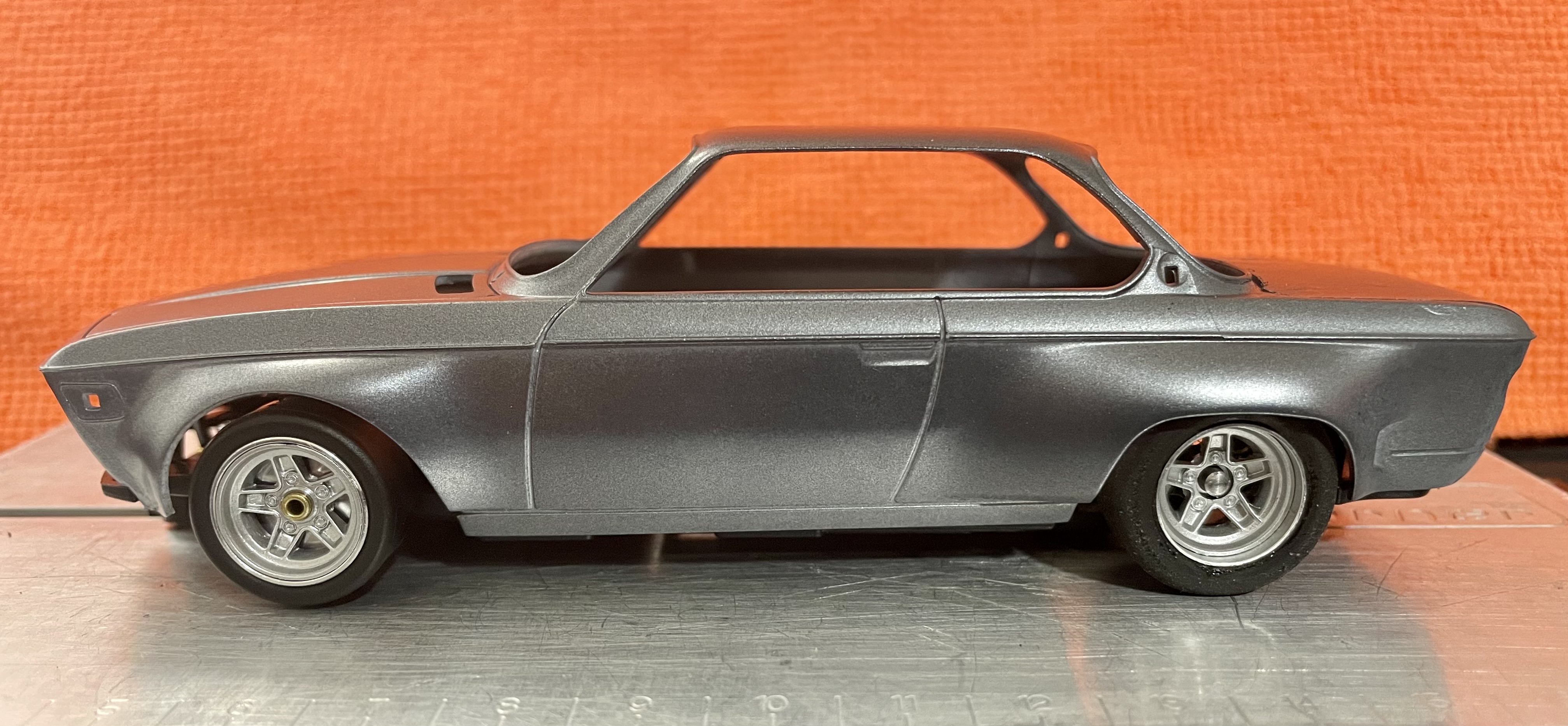

Working on this one with the hopes it shows promise.
