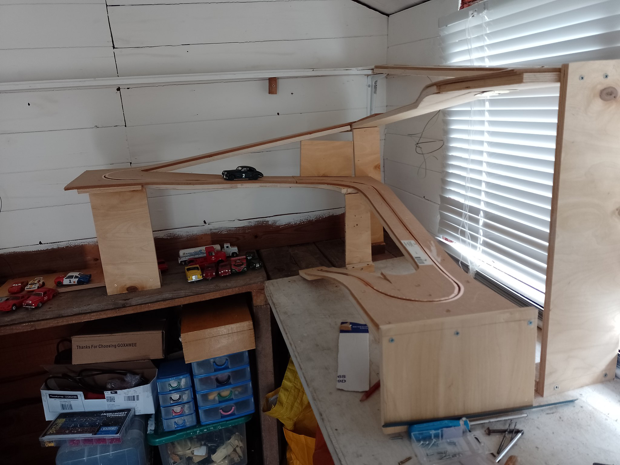

My new 1/43 mountain rally track.

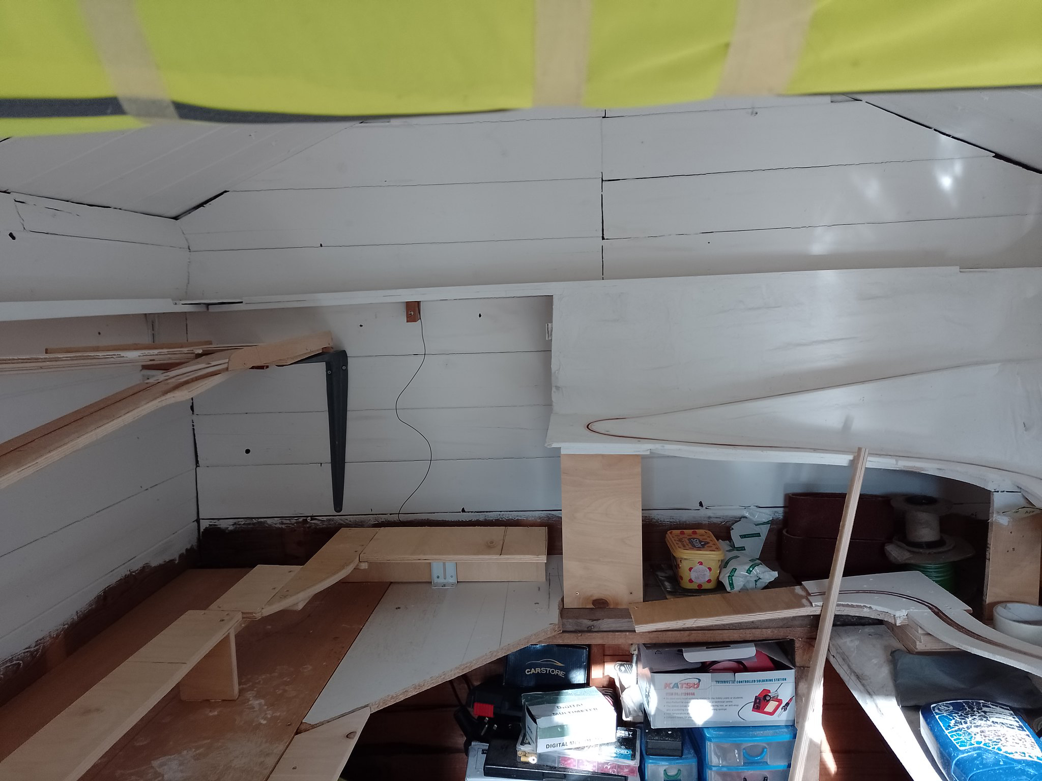

After moving from Norfolk to Dorset, I thought long and hard about building another wooden rally track to replace my old track, 'Little Monte'. Eventually, after doing the necessary decorating in the house, I decided early this year to explore the possibility of fitting an interesting track into my, much smaller, 8' x 6' shed.
As always, this track was to be built on a tight budget, using materials I had to hand or could get cheaply. The track bases were all made out of some 5' x 6" x 12mm plywood boards that I found locally on Marketplace for £2 each. using my old Bosch jigsaw, I cut most of these boards lengthways to give a 3" wide shelf to mount the trackbase on.
With the bases in place, I added the roadway, made partly out of 3mm hardboard, from Freecycle, layed double height, to give a 6mm depth. The rest of the roadway was from 6mm MDF, which I bought from a DIY store in town. All straight track pieces were cut in 1 1/8" wide strips, laid side by side, with an 1/8" gap between them for the slots. These road surfaces were glued and screwed in place using PVA wood glue. The turns were made with the 6mm MDF.
