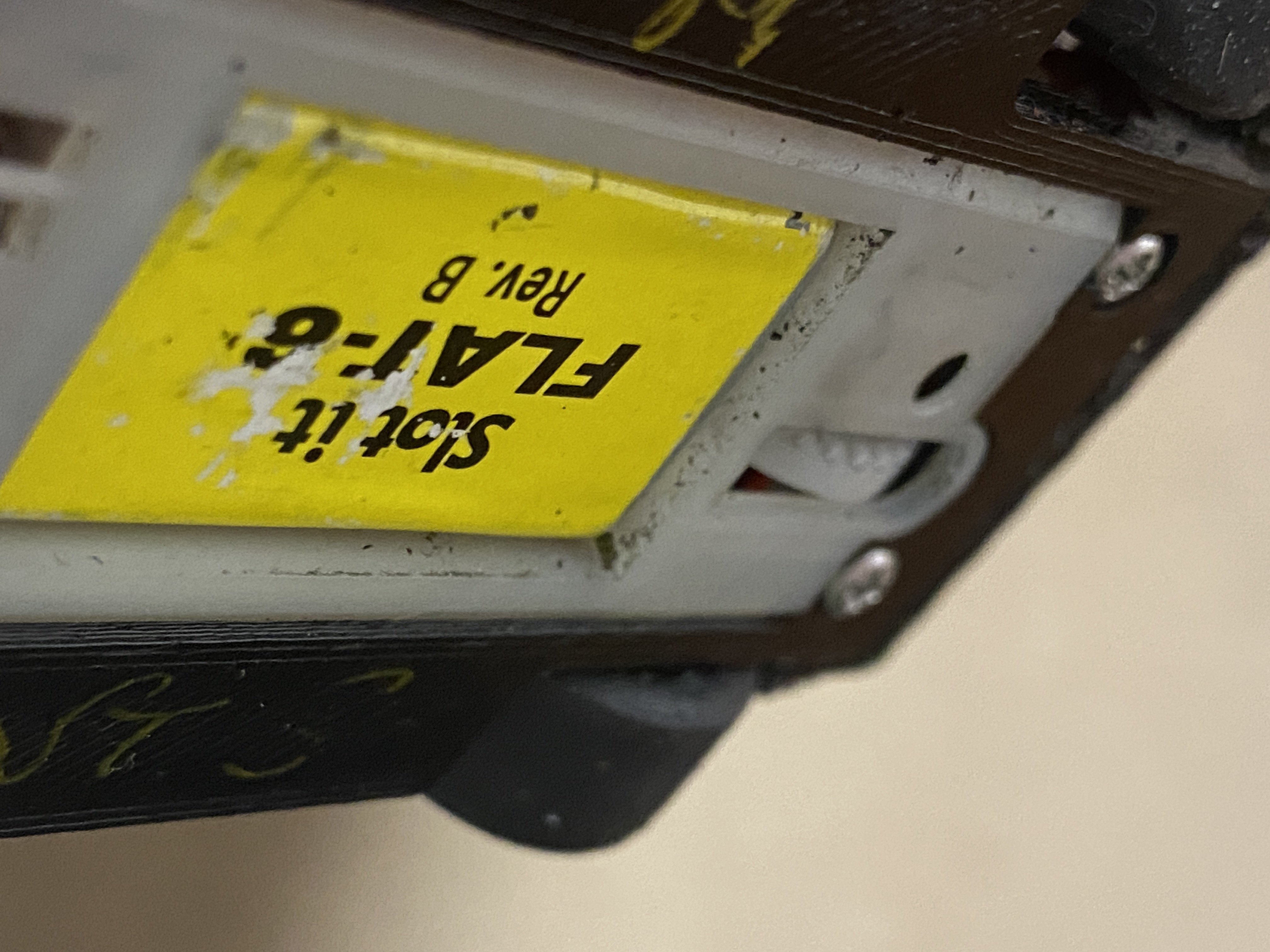

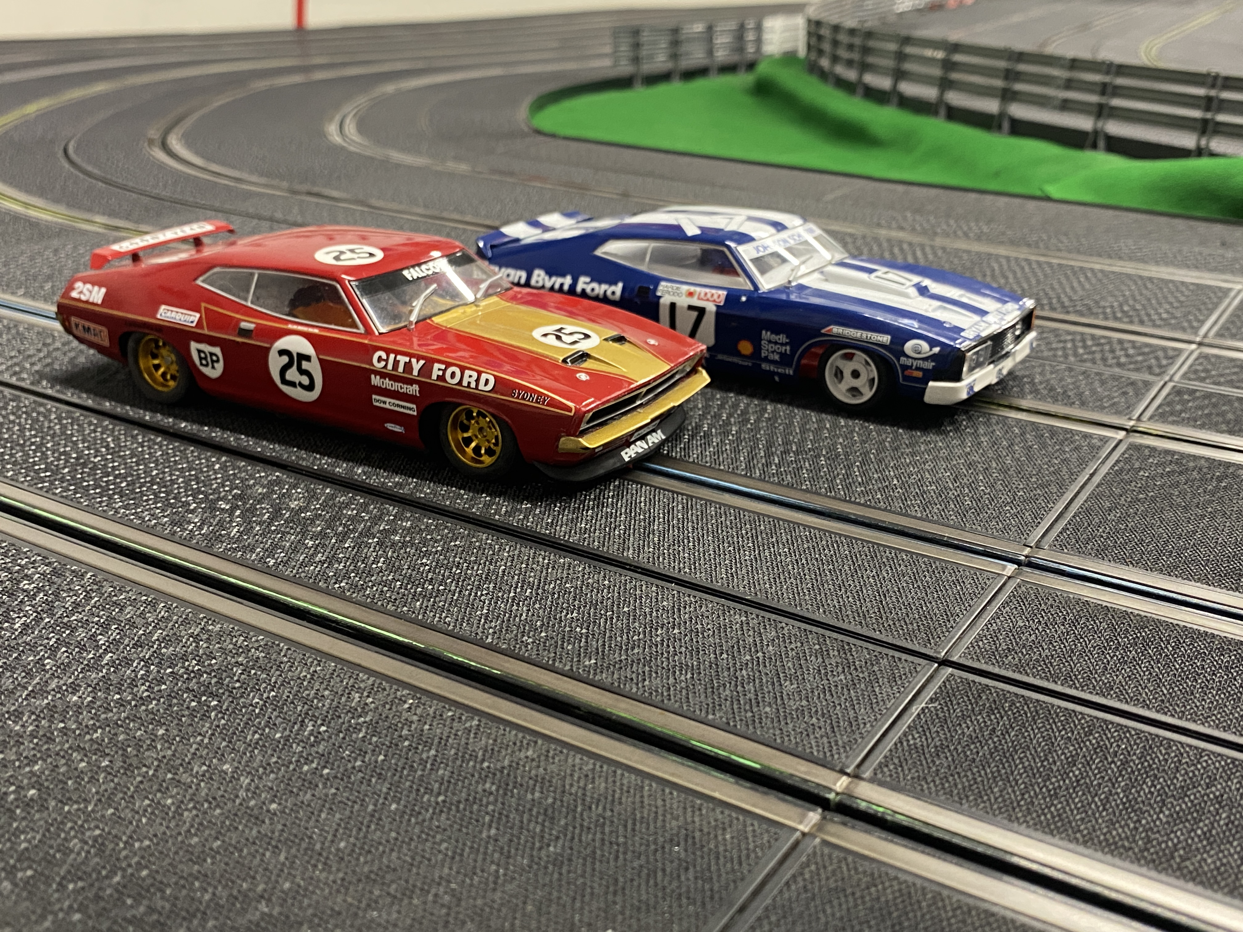

On to the big boys... The Falcons loved it around here and both did very well, although the Roadrunners Falcon had the edge with more grip and stability; definitely one of my favourites.  Brumos' Camaro looked stunning and drove very smoothly, especially on the longer more sweeping turns, it wasn't quite as settled in the tighter corners though.  The big Galaxie was a bit loose at the rear (not surprising considering how much car overhangs the rear axle!) but was quick. Makem's Camaro has the potential to be quick, but the gearing is very tight. The Flat 6 motor isn't sitting in it's lower orientation I.e. flush with the bottom of the pod. It looks to be fitted with an offset crown gear which isn't meshing well. Sort this and there is the potential for a very quick car here...
