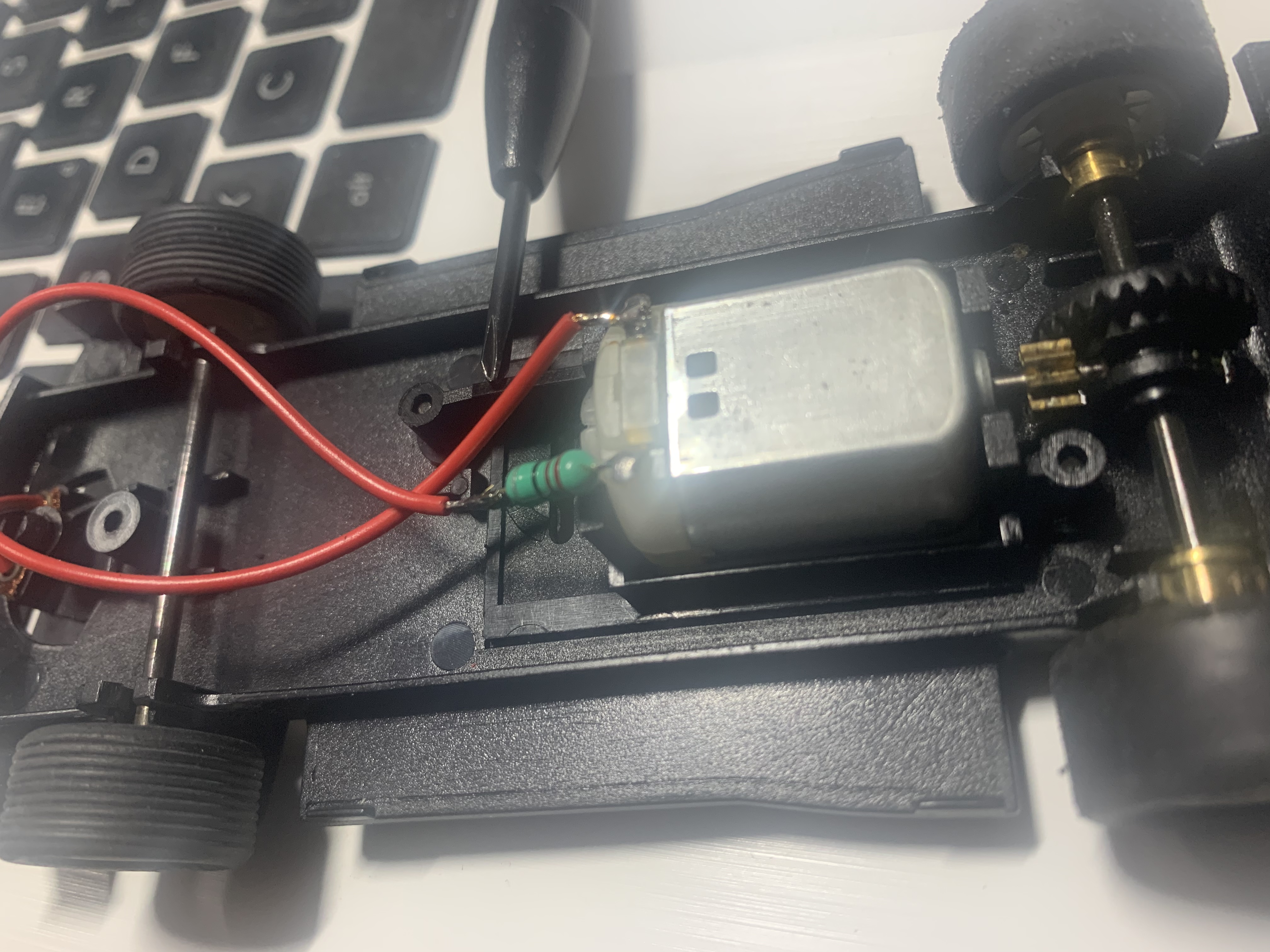

I can’t see what would hold the motor at the end bell ? Presumably I would remove the bit where screwdriver is resting in photo and the snap fit bit ?
First off it's an endbell...bell ends are are what you shake the drips out of after a pee!
Secondly, there's still going to be enough plastic to support the screw mount at the front end of the mount
...and glue will hold the motor securely which is preferable anyway as Ninco motor mounts are renowned for not holding motors securely - hence 'Ninco hop'

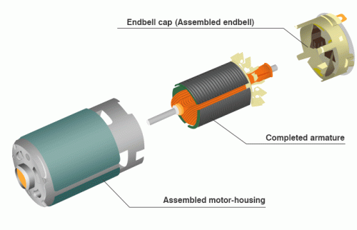

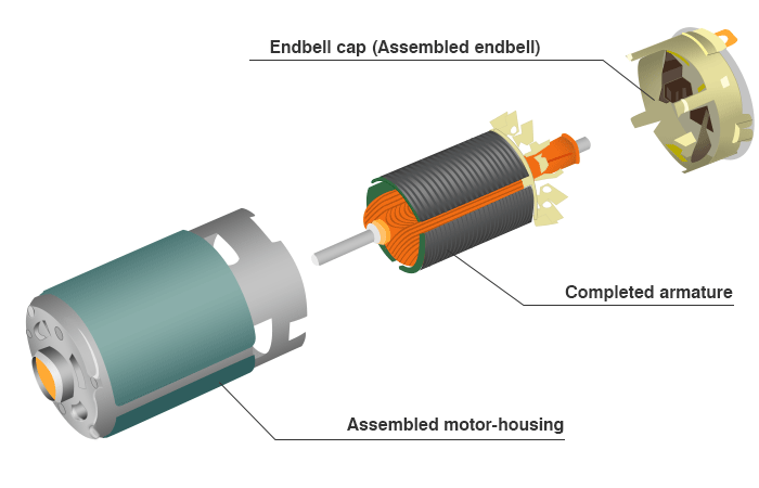

This is from Mabuchi's website
