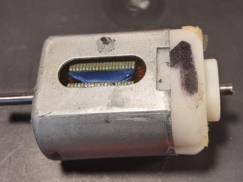

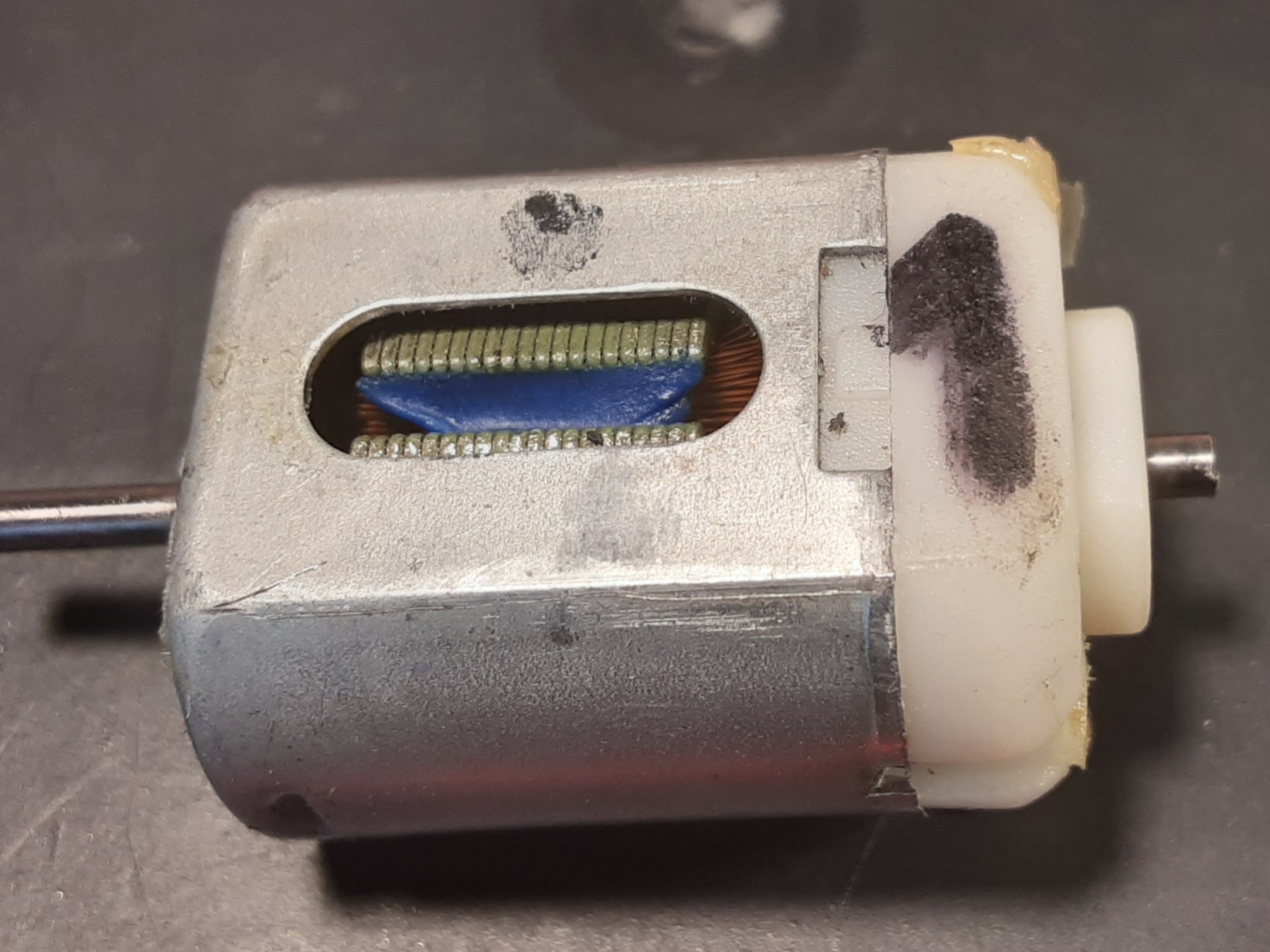

True Kev,
However, the problem isn't fitting the putty , resin or other substance to the armature ,
It's figuring out where to put that weight.
Maybe trial and error would work but something that could be added and removed would probably get spat off during testing.
Of the 5 shark motors I have lying around in boxes, only one shows any evidence of balancing (see blue resin in the pic)
Alan

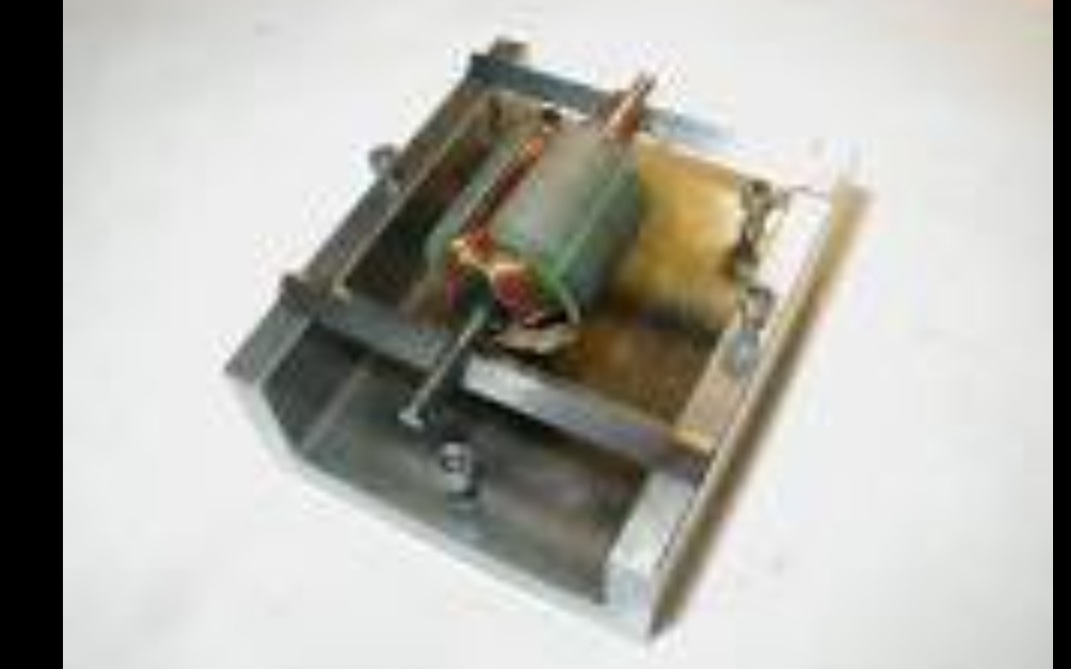

5th-Oct-22, 07:41 PM
You'll need jig like this.
The armature will roll showing the heaviest side.
Add epoxy to the lighter side and keep testing 'till there is no longer a heaviest side.
