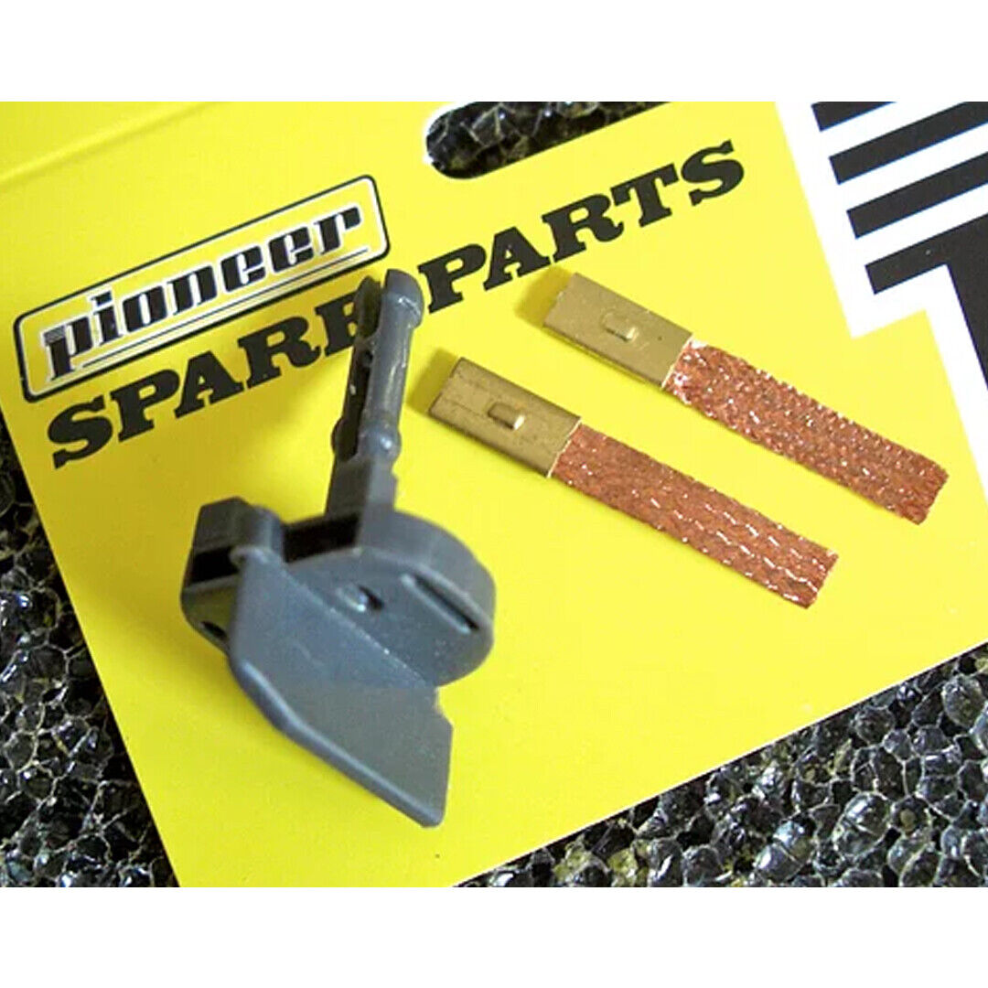

By sliders I think he means the track contacts/braids.
There is a 'right way up' to install them so if they're falling out easily try them the other way up.

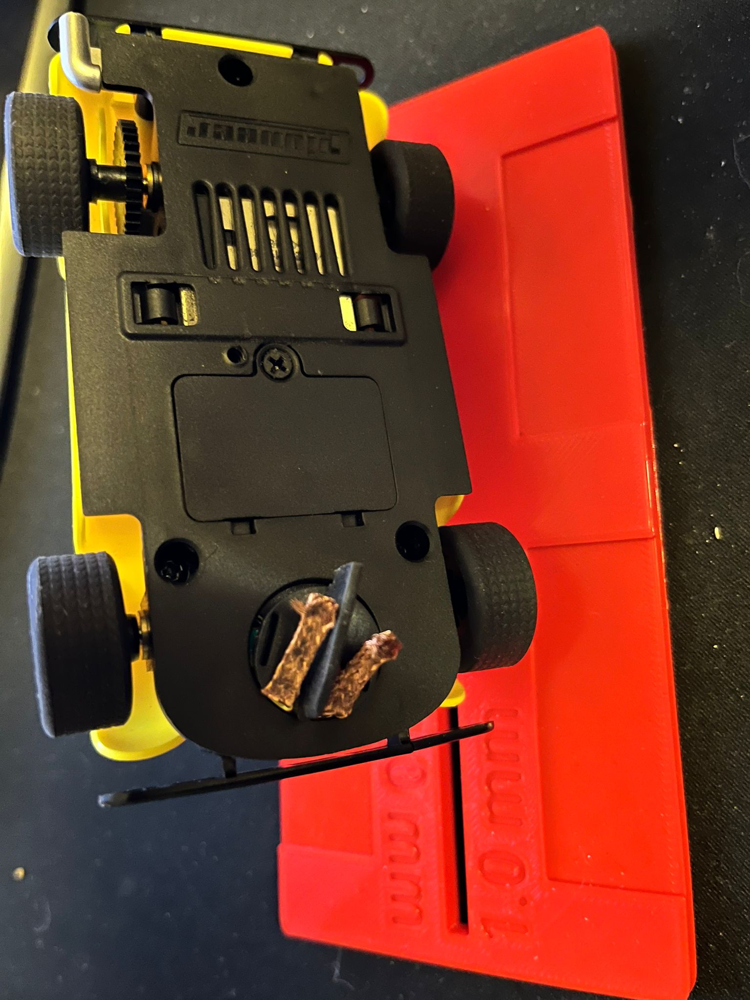

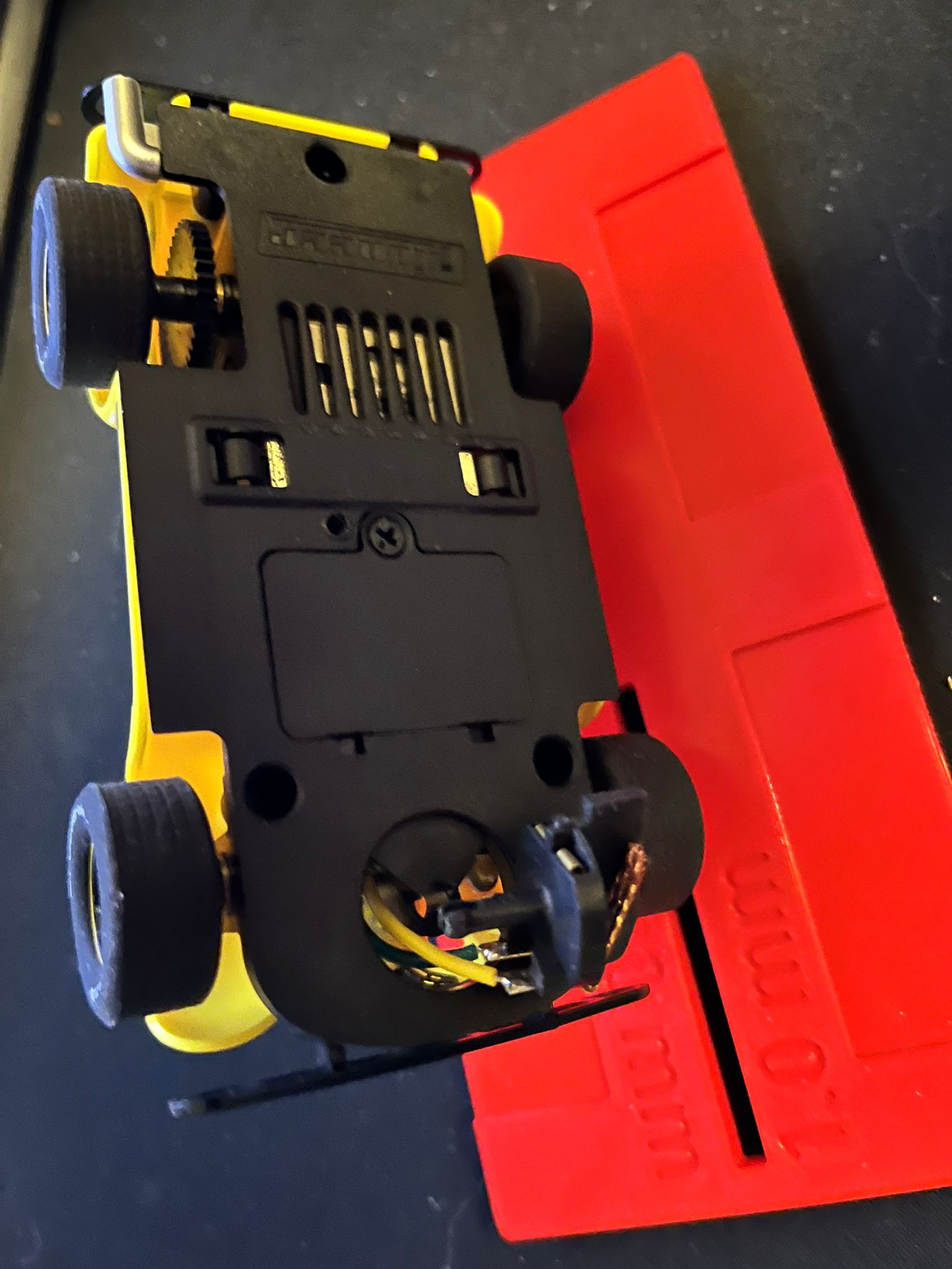

it is about this .
this is so soft.
sometimes it just falls out
. slotcar

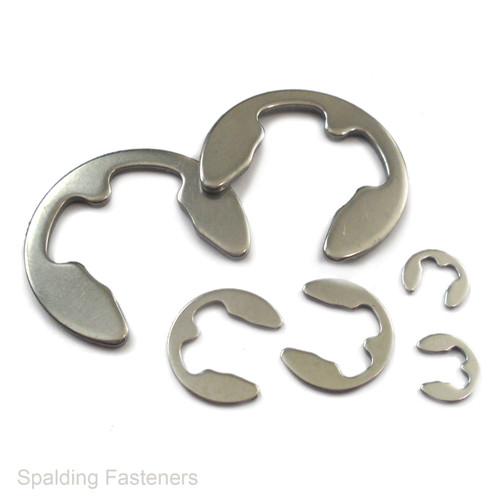

I might try a retaining ring on the top of the guide post. Buy the correct size, snap it on, and it won't fall out unless you take it out.
Available at most industrial hardware stores.
have seen somewhere people use a 2mm grub screw
inserted into the split section of the guide post to splay the post out a little
open the car , place the guide post into the chassis , insert the grub screw and tighten until secure , replace car body
obviously don't screw it in too deep to prevent the guide from turning , but enough to secure it in the chassis

I think he's referring to how the wire and braid are held in, much like the BSCRA cars setup.  I've never seen one but if it's like this you need to tweak the brass strip to open it up a little so it's much tighter in the guide holes...or a dap of superglue  Thumbup
Ken appears to be on the right track and it's the guide flag he's having trouble with, not the braids.
