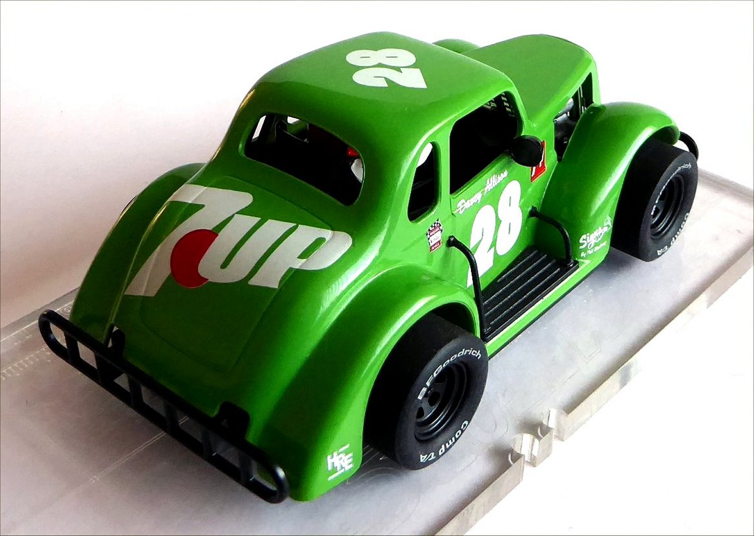

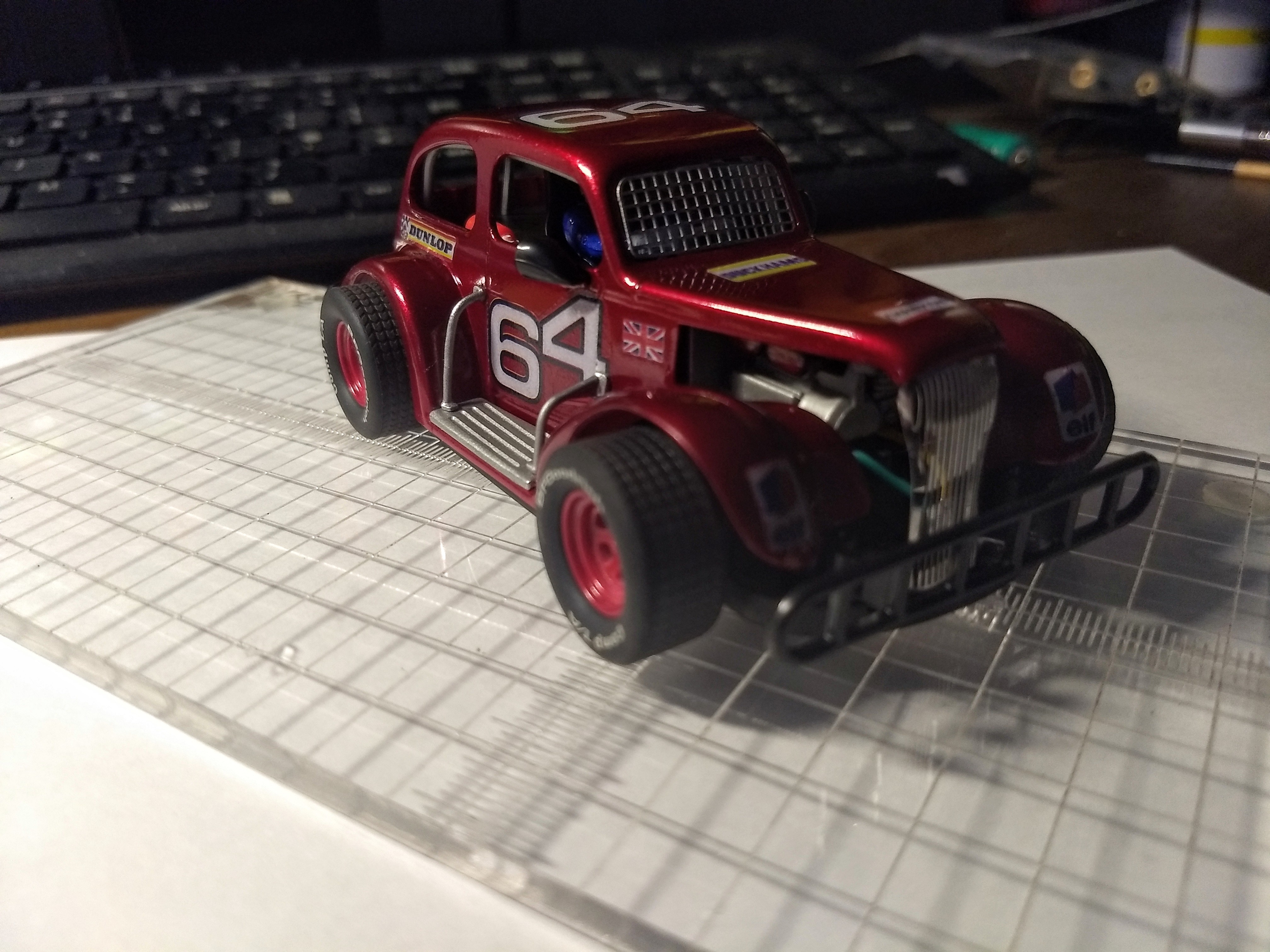

this is my attempt at the pioneer legends white kit
totally stock
was great fun painting and building

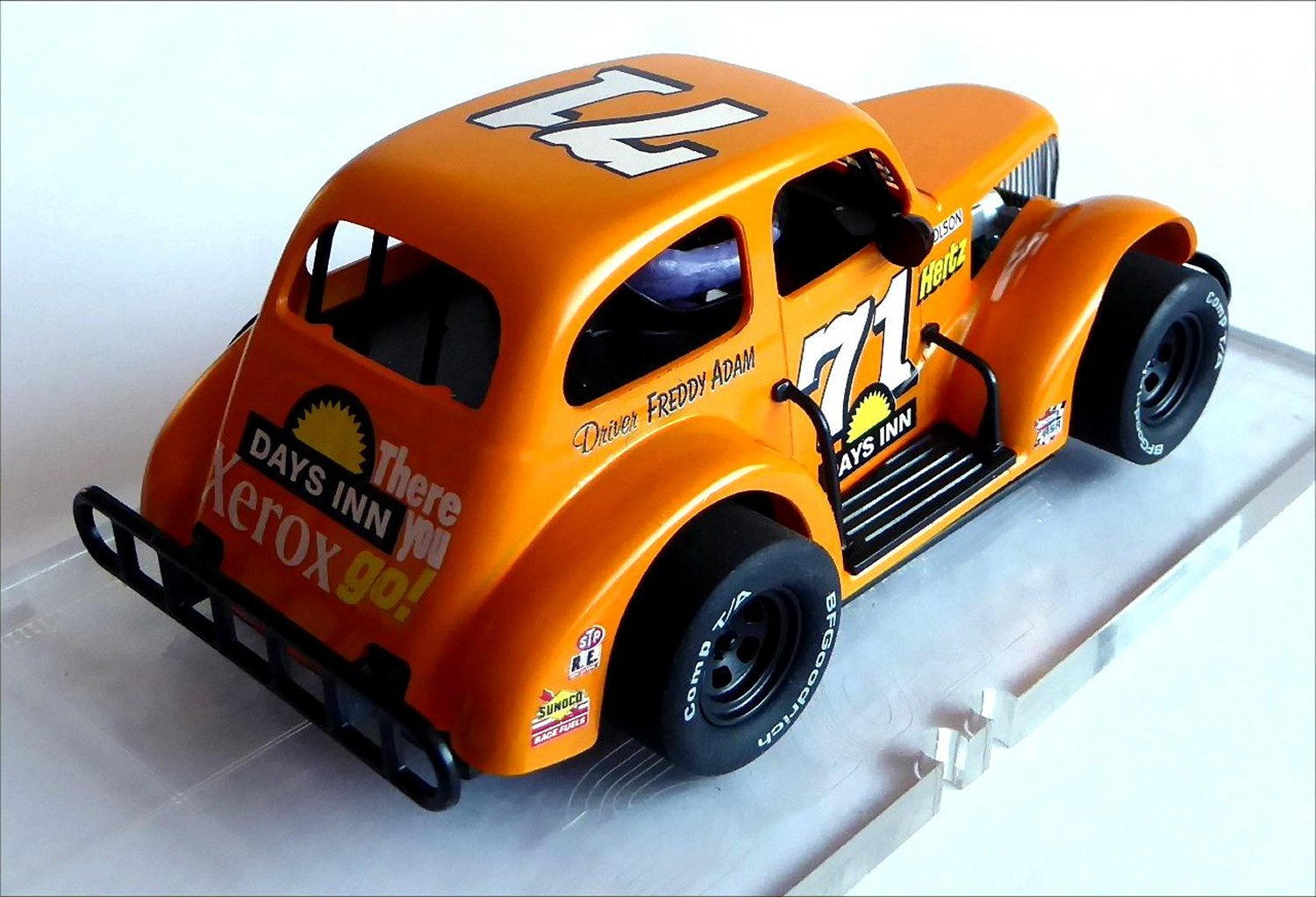

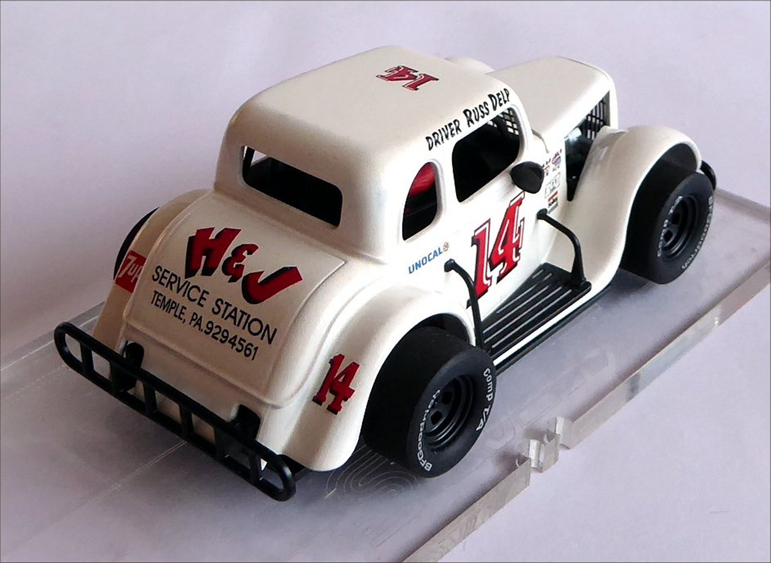

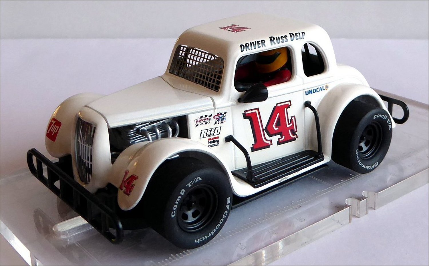

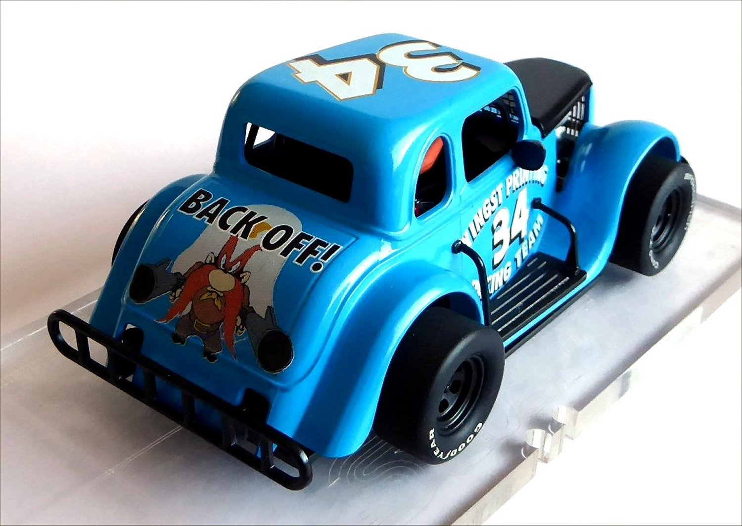

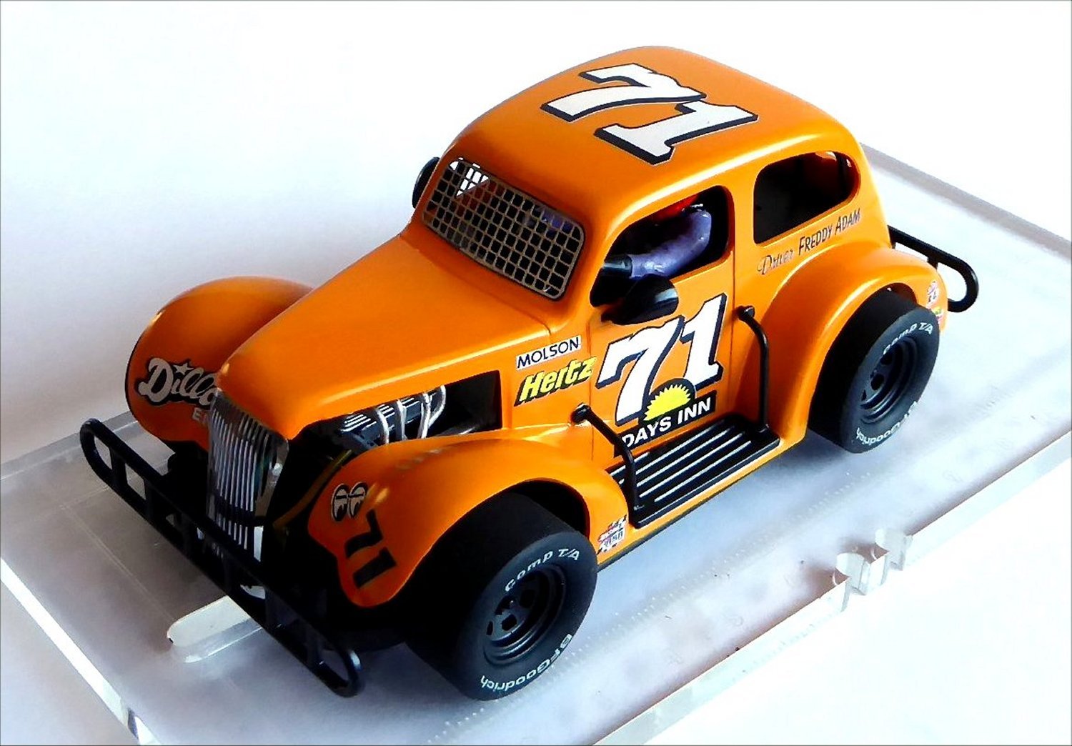

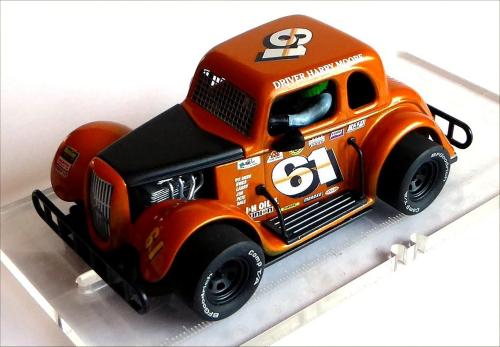

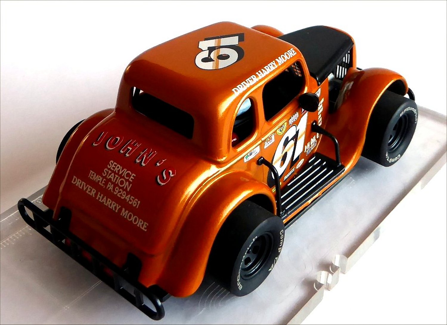

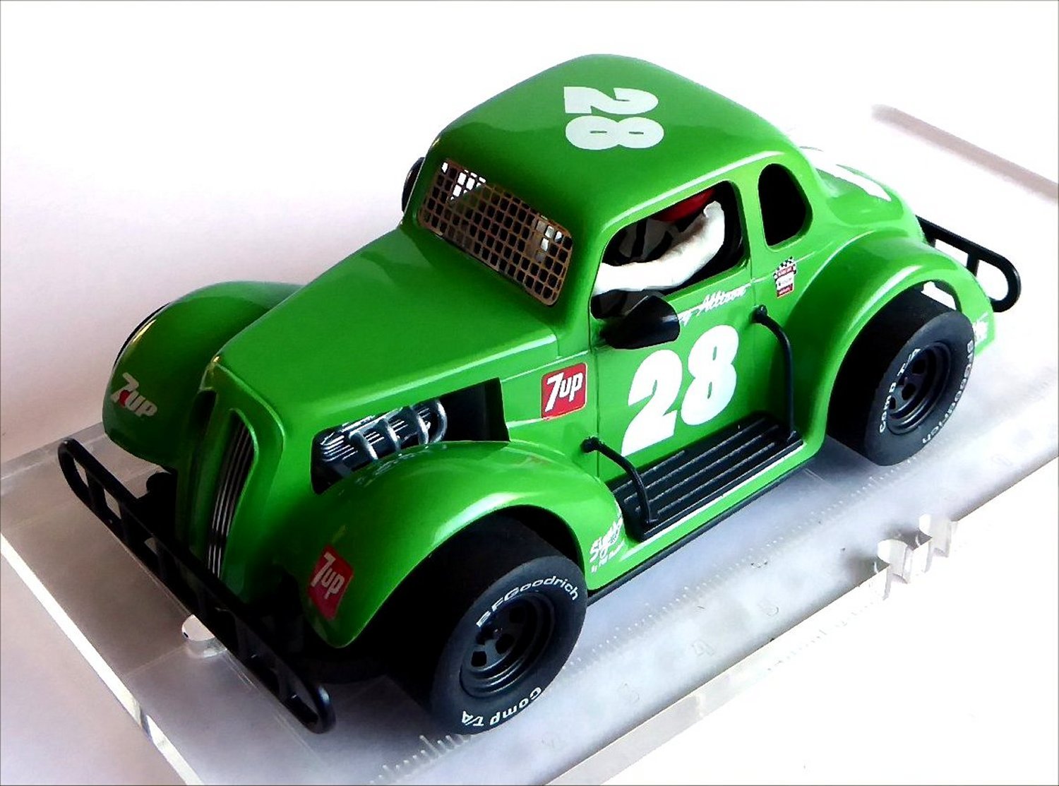

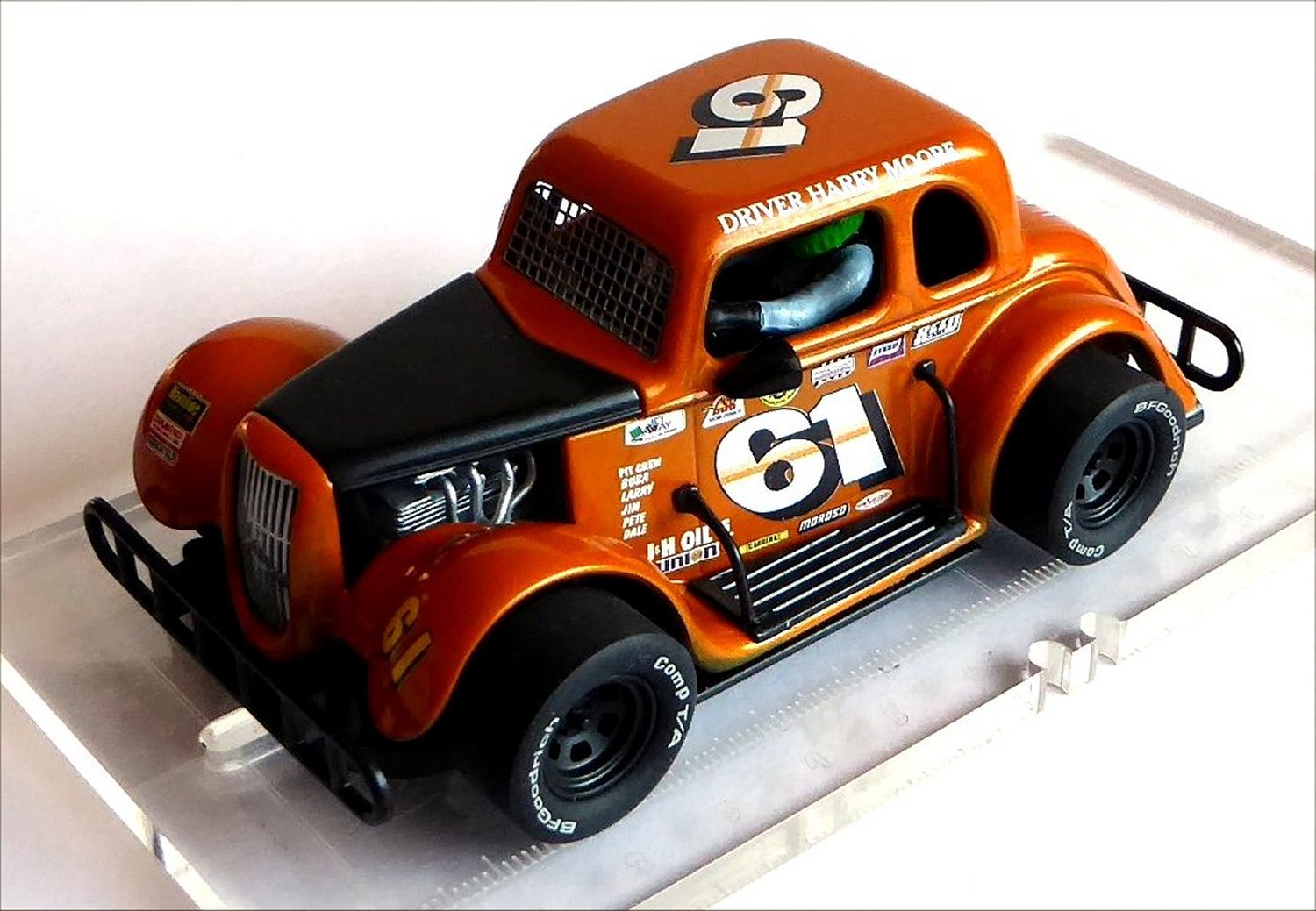

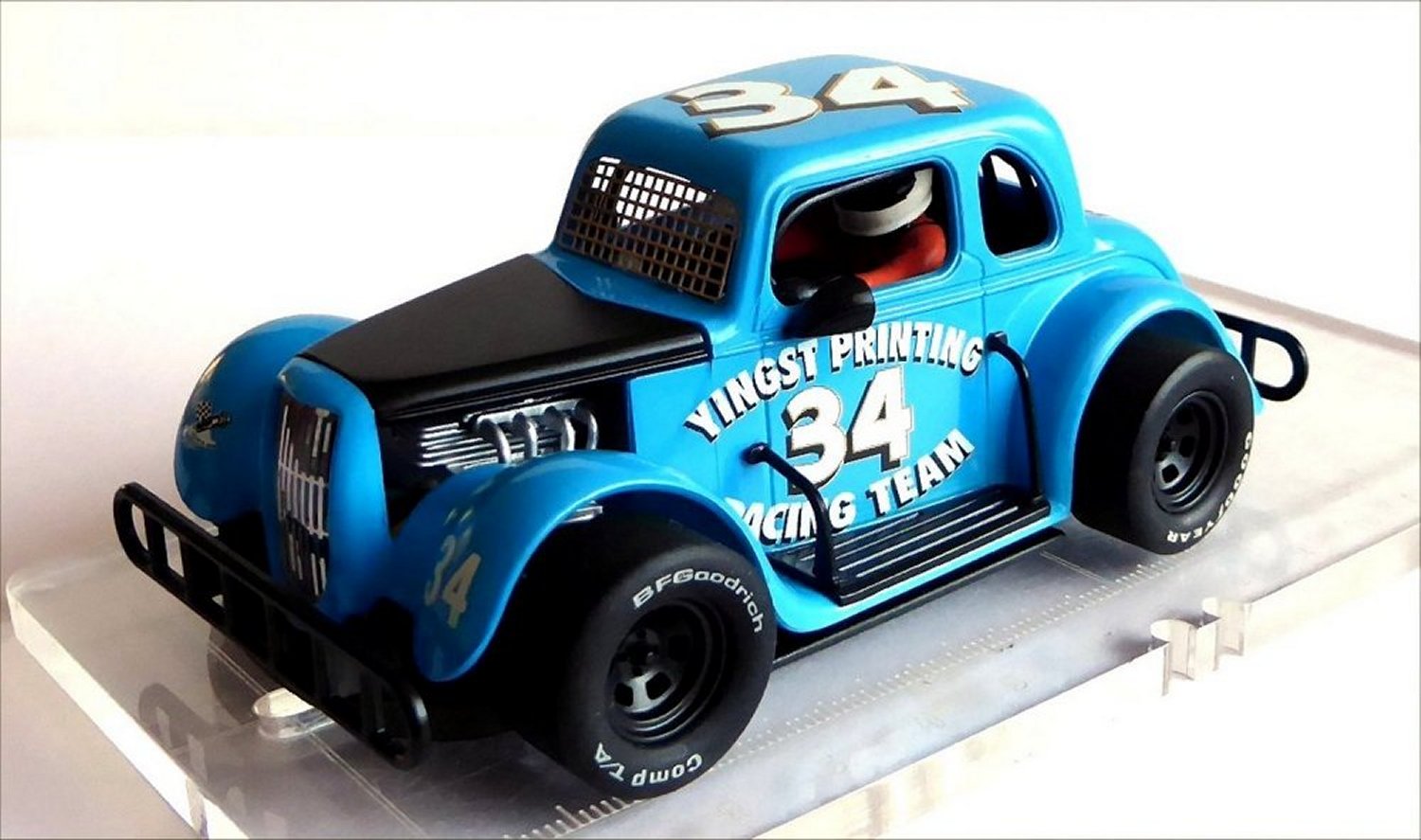

Just off the bench after decalling up using custom-sized 'Polecat Decals' from the States. I'm mightily impressed with them. Tough but ultra-thin, they bore a lot of shuffling about, even removal and trying on another car without grief before I finally settled on placement.
I will be ordering a couple more sets as, having done these five, my original choice of decals for the remaining two, a red Chevy Sedan and black Dodge Coupe (not shown) are not really suitable. Just a poor choice by me, nothing to do with the decals themselves, which are already in the Spares box.
Quote:....this is my attempt at the pioneer legends white kit - totally stock.
Same here. Only added parts were shimming of the guide pillar, plus a nut on the top to reduce slop. Wheels glued to axles. Wheels and tyres trued. Might add a little weight up front but last time they were run - without the guide tweaking but with body rock - they were just fine.  Thumbup
