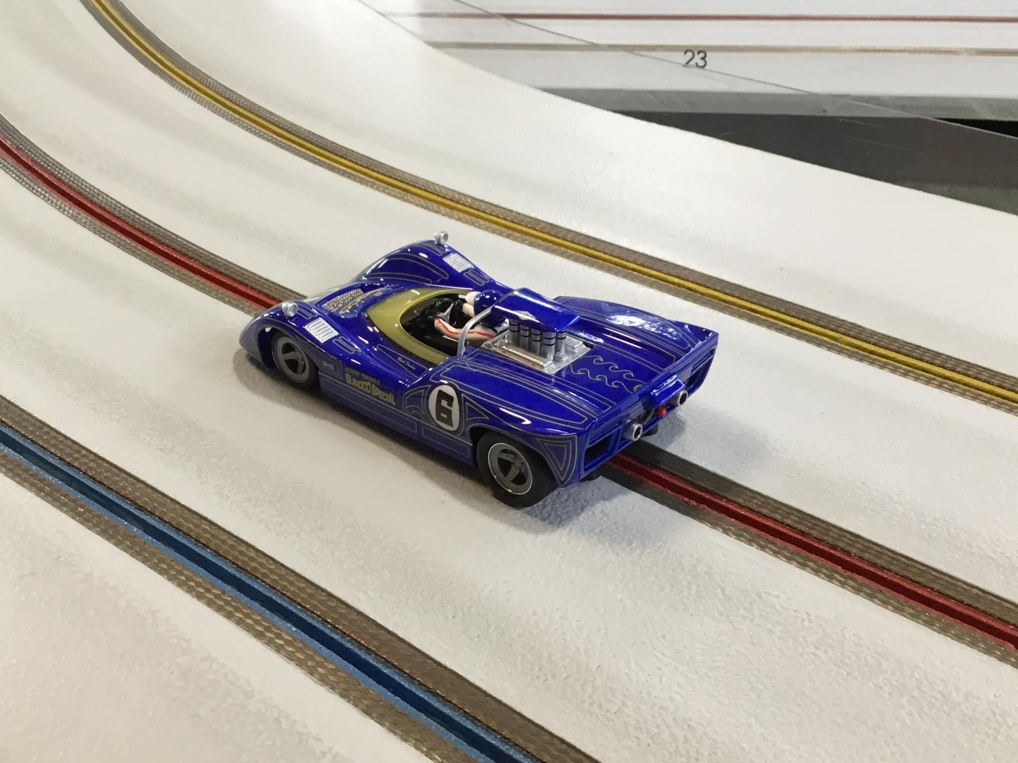

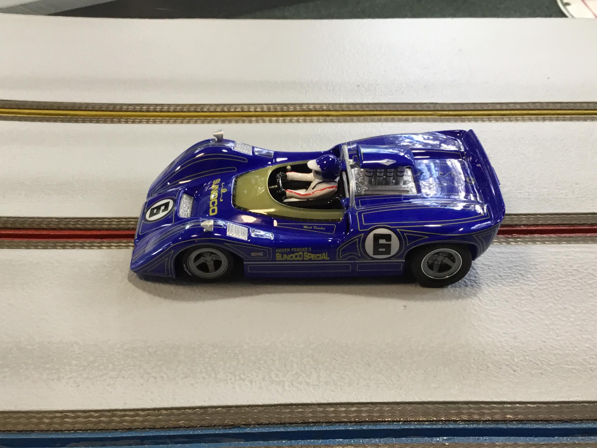

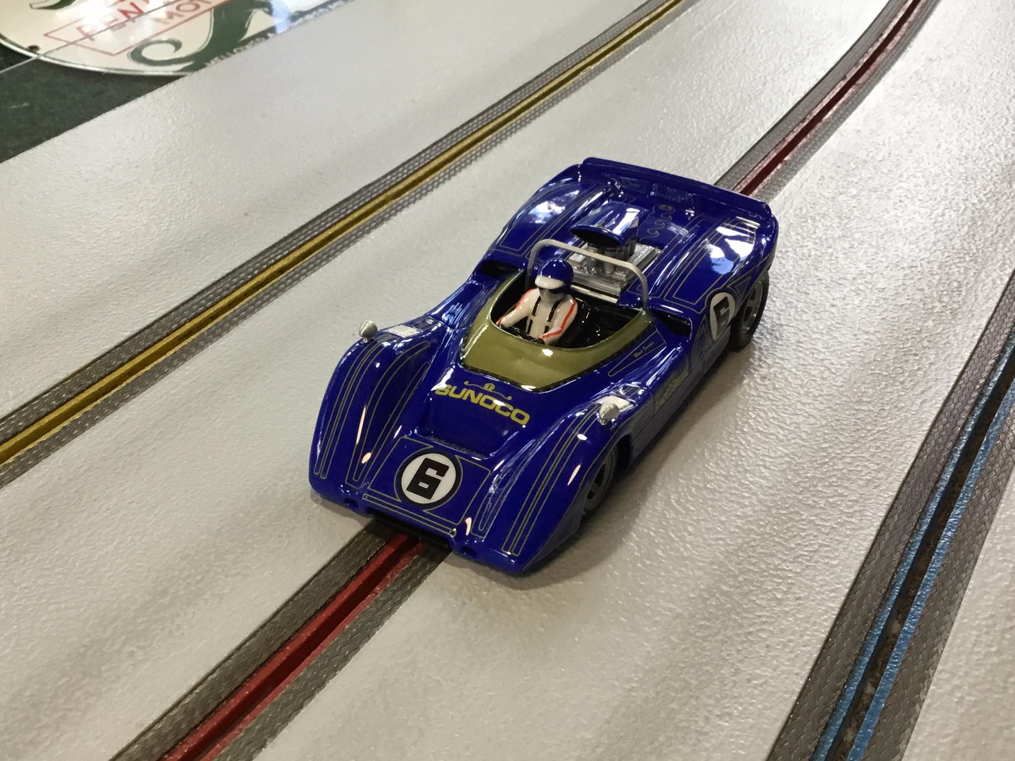

In 1967 Mclaren cars produced and developed the Mclaren M6a whith Chev V8 power, with which he won the 1967 Can Am champioship.
At the end of that year, the works team had developed the Mclaren M8A to be raced by Bruce and Denny, so they teamed up with technical partner Trojan- Tauranac raciing and developed the M6B. This version by thunderslot is of the superb Sunoco petrol sponsorship.As Bruce McLaren Motor Racing moved to developing the M8A, the M6Bs began to be delivered to customers for the 1968 season. Several of the M6As were also sold with Roger Penske purchasing one car for defending the United States Road Racing Championship (USRRC) champion Mark Donohue.
Donohue won several USRRC events that season and earned his second championship. He also later won a race in Can-Am, beating the newer McLaren M8As.
After the cancellation of the USRRC after 1968, the M6As and M6Bs continued to be used into the early 1970s but none were able to achieve victory against their newer competitors.
The M6A and M6B also featured prominently in the early years of the Australian Sports Car Championship (ASCC). Driving a McLaren M6B fitted with a 5.0 litre Repco V8's.
The Thunderslot version is a superb rendition of the original.
