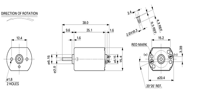

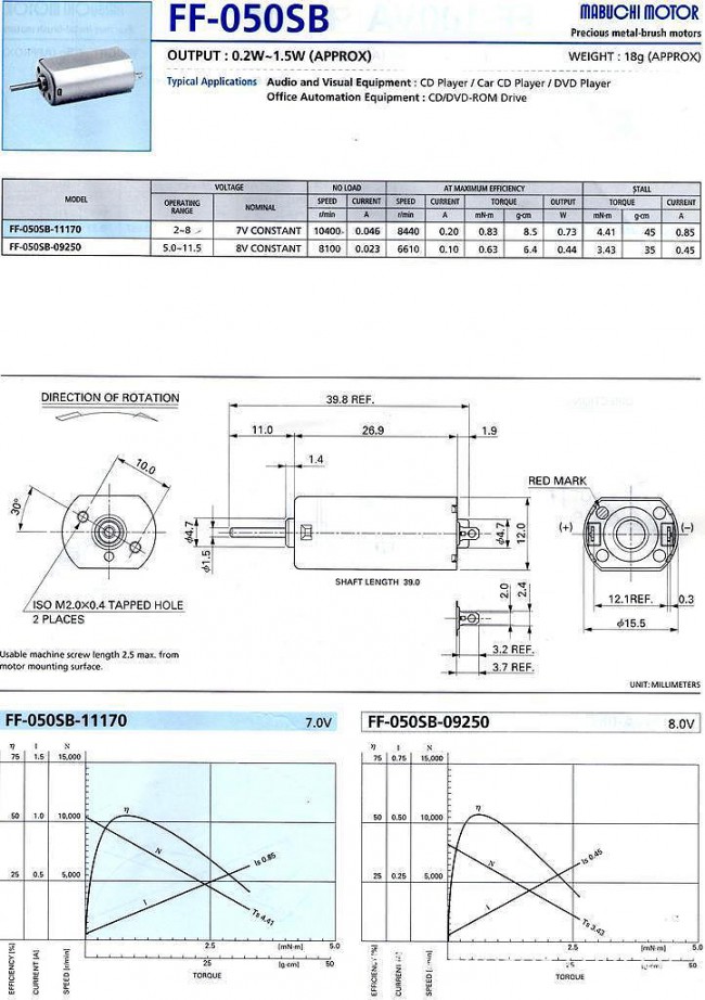

Yet another silly question, but I am still a learner ! Sorry…. How long / wide in cm’s are long and short can motors ? I am trying to identify some to help me make sure I buy the correct gears and pinions , ta
Posts: 4,502
Threads: 147
Likes Given: 4,194
Download and save these
FC130
FK130
FK180
FF050
