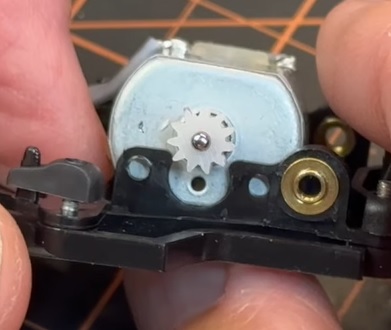

Please see the link showing how Thunderslot has changed its motor and the way they are mounted.

I have drilled & tapped M2 fixing holes in quite a lot of motors, I certainly wouldn't be using this bracket.
Wouldn't it be better to utilise the hole in the can just below the bearing...

(14th-Aug-24, 08:51 AM)Kevan Wrote: I have drilled & tapped M2 fixing holes in quite a lot of motors, I certainly wouldn't be using this bracket.
To me the location of the motor is not the so much the issue, it is the fact that the performance of the new motor appeared to be less than the original one (on the video), but still with the same label on

As for using the top hole Kevan - that would have required a change to the motor pod.

I've got NSR's with a hole in the pod that lines up with that hole under the bearing and a braid eyelet is a nice tight fit and have used it to retain at least one motor in the past.

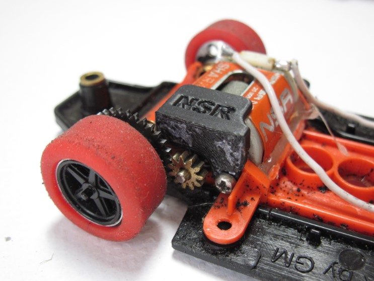

Having spent more than 2 years off & on in China, working with, and validating product suppliers and their key subcontractors, can sympathise with Thunderslot if they were held to the mercy of the motor supplier moving the goalposts or even refusing to supply. Doesn’t excuse not re-labelling or changing the endbell colour of the motor to show its a different specification but they wouldn’t be the first Slot supplier to suffer from changing specifications and not highlight it. Hopefully the motor tested is a bottom specification one and the rest will be more equal to the old motor.
An interesting point to draw out of this is the bracket is quite useful for NSR SW pods and motors without fixing holes as I lost a race due to the glued in motor on my NSR 917 lifting. Not keen on drilling motor cans and liking the idea of an add on part easily accessible without taking the pod out, have drawn up a bracket on CAD that can be printed and fitted similar to the Thunderslot one.
Cheers John

Bent brass sheet is another option, also can be made thinner and would be stronger.
