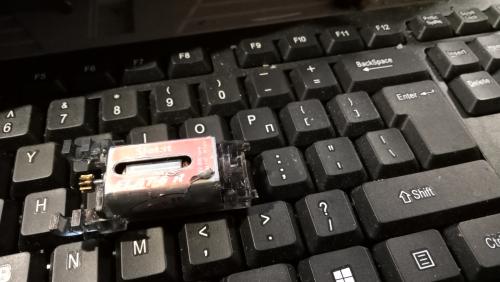

I have purchaced an older but unused SCX Ferrari  360 , it has an an RX42 motor , which is very slow, how can I go about fitting the newer type FR motor? Is an adapter required ?
Thank you in advance .

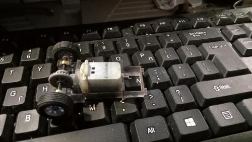

If i remember correctly the SCX 360 has a separate motor pod
If so you can replace the motor pod with one for long can or flat motor
or with one for mabuchi FC130 motor
