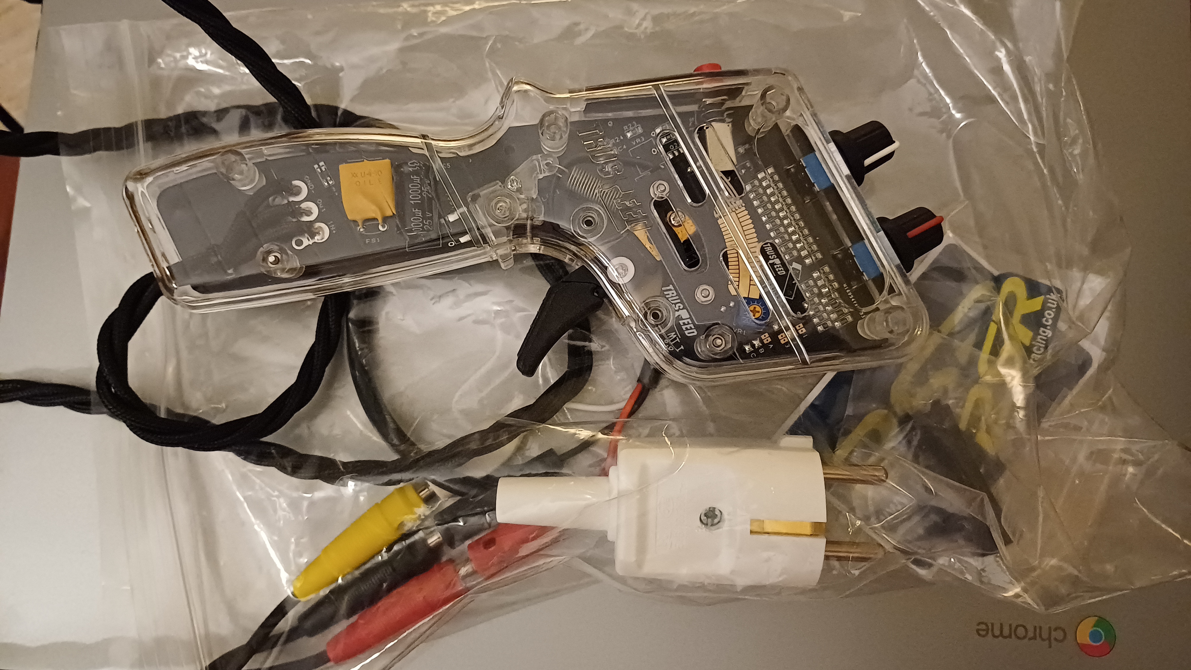

...and it has happened!
Have gone for an MT1 for my Raid/Rally cars.
I just wanted a controller with sensitivity and brake adjustments, so it wasn't a difficult decision.
Chose banana plugs so I can swap between the plug I need for the FDD event in France (in the photo) and the standard UK three pin plug for more local events!
I love puttering with gears
